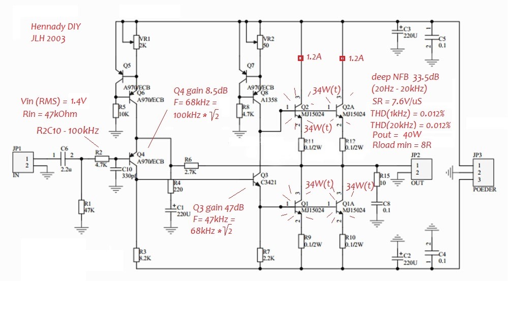

Here (see attachment) is the most comfortable use of this topology with measurements.
They write that someone there set it up for a long time to produce this circuit - in fact, simple mathematics, the next cascade limits the frequency to the root of 2 from the previous cascade.
1 input filter and 2 gain stages
Class A, efficiency - 30%, other characteristics were measured on my version with an output power of 9 watts, everything is shown in the diagram.
at an output power of 40 watts distortion (1 kHz) 1%.

Hi.I need them for 4 ohms speakers.So lowering the voltage and increasing the current to 1,7A each transistor would help IMO
for example, we lower the voltage to +/-18 volts, the current of the output transistors is 1.7A per pair, the total current will be 3.4A
It will be necessary to reduce the sensitivity of the circuit; to do this, increase resistor R4 from 220 ohms to 390 ohms.
The maximum power will drop to 28 watts into a 4 ohm load.
Otherwise, everything is the same, except perhaps for the distortion spectrum, which the closer it is to 2/3 of the maximum power, the more odd distortions will appear in the spectrum.
In the version with an 8 ohm load on the circuit of post # 9586, the even harmonics dominate almost up to maximum power.

The problem with increasing R4 from 220 to 390 ohms is somewhat self-defeating. The open loop gain will be reduced, so distortion will not be reduced as much as might have been expected.
For better results with 4 ohm loads, R4 needs to be reduced, and the feedback resistor reduced too. But preferably the input stage transistor current needs to be increased as well. That could be arranged if an additional transistor is added to make a current mirror before the VAS/driver stage.
You might also consider using linear gain transistors in the output. The MJ15024 suggested by Hennady is an option with a pair for 4 ohms even running at a lower voltage if you do not need 40W. 2SC5200 and MJL3281A have been used successfully, but at 8 ohms in my tests.
One of the problems I have pointed out before is that in many of the older transistors the current supplied by the output transistor which is conducting more is falling in gain. So the driver transistor current has to conduct enough to ensure that it can supply the required current at peak output. The transistor being turned off may not turn off as much, so the current division becomes asymmetrical and second harmonic distortion is less cancelled. That is the problem for lower impedance speakers.
While it is better to aim for 8 ohm speakers it is worth noting that so-called 8 ohm speakers may have a lower impedance at some frequencies.
this contradicts the optimal DC mode first cascade, which is equal to R3/R5= 8.2/2.7=3, it will also increase the gain of the open loop of this stage, which will require additional frequency compensation, because unbalances the correspondence of the cutoff frequencies of the cascades F2=F1* Root of 2
That is why I suggested that a current mirror is added, as a higher current in the input transistor would have needed a lower resistor than 8.2k with increased nonlinearity on the second stage.
I agree that the effect will be to put the open loop gain up higher, which is to bring the distortion down. It may well need some modification to the frequency compensation as you say. The point being whether the overall closed loop distortion can be reduced particularly for heavier loads, which simulations suggest it can be.
you are talking about the overall coefficient distorcion of the amplifier, I am trying to convey to you that you need to understand where the node is where the distortion is maximum and modify it.
This is the node - is the base of the output transistors.

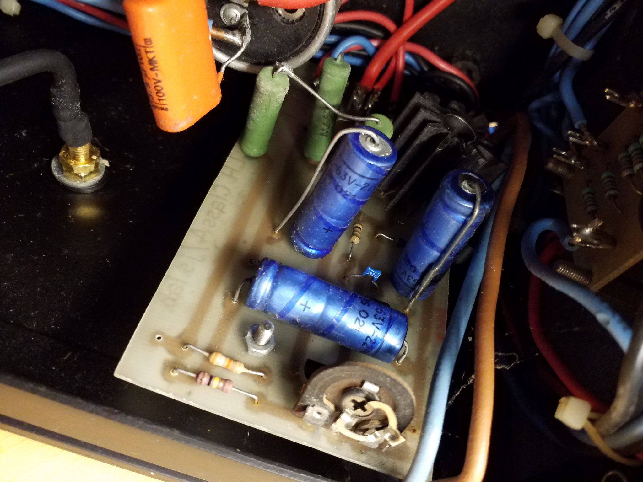

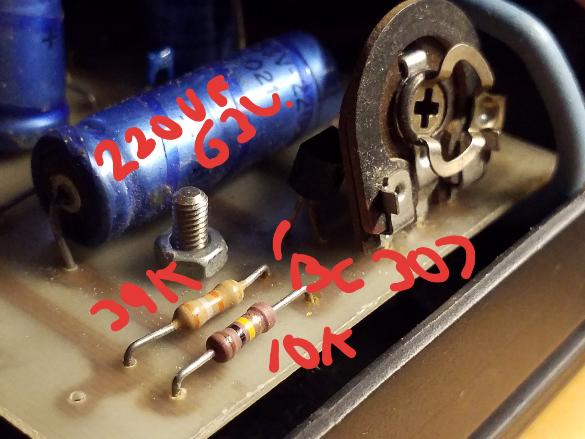

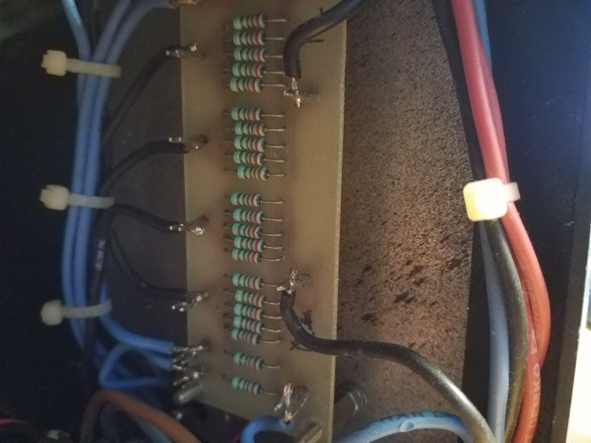

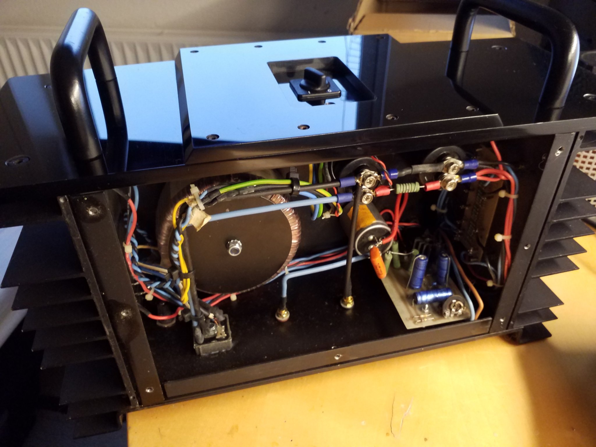

Yesterday my jlh mono arrived, and I have a few questions.
I just bought them without asking any questions, they were that cheap I couldn't pass.
Seller said it was jlh 1969, which I believe, because its single rail, and has output capacitor, the home etched pcb also reads jlh class a, but this one has 4 to3, never seen that , current sharing perhaps?, I will not dissect them just yet, but slowly power them up and listen to them.
Ps I bought 20 Motorola mj15003 because I saw the used ones aren't the same some toshiba, some rca
