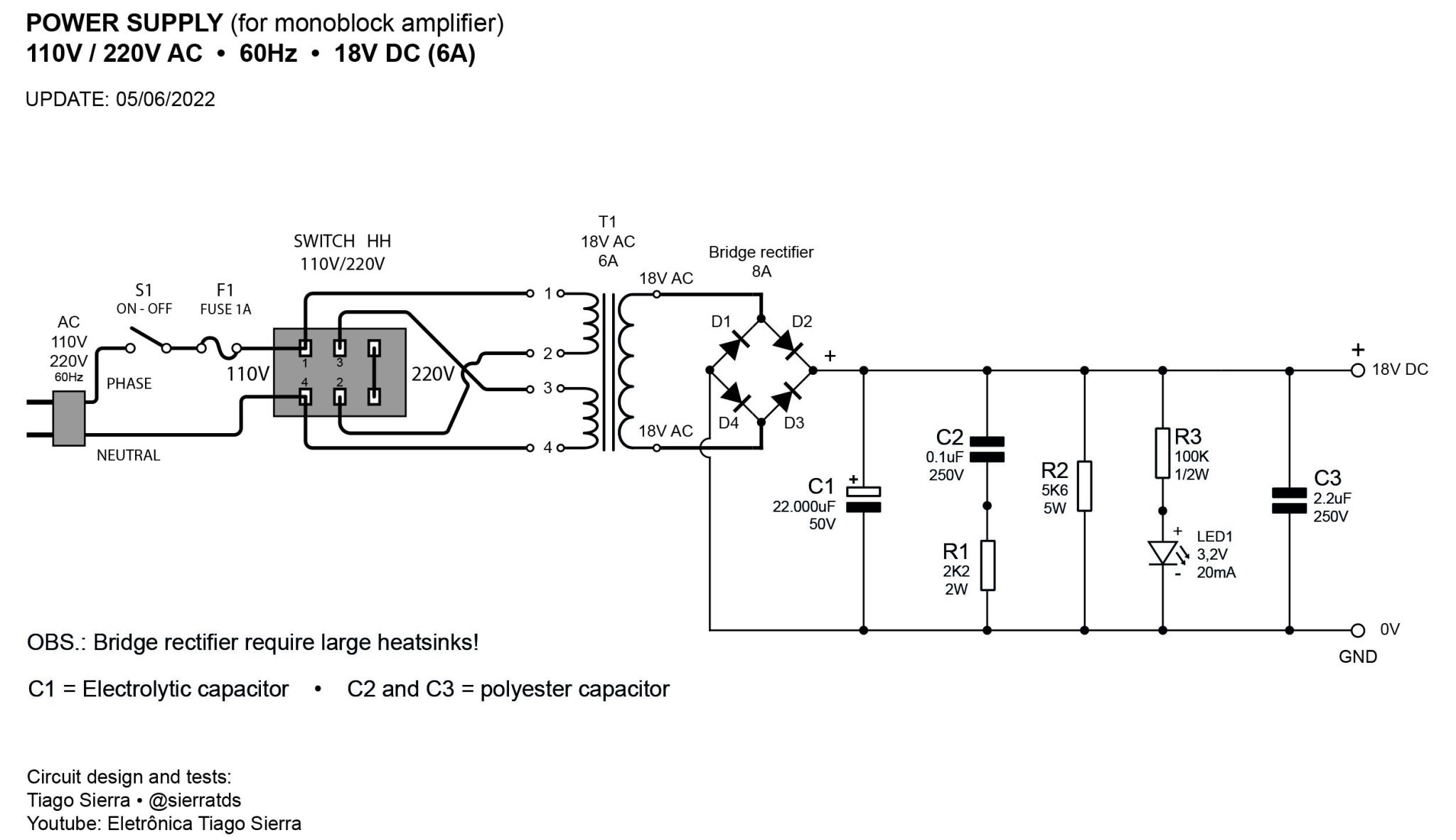

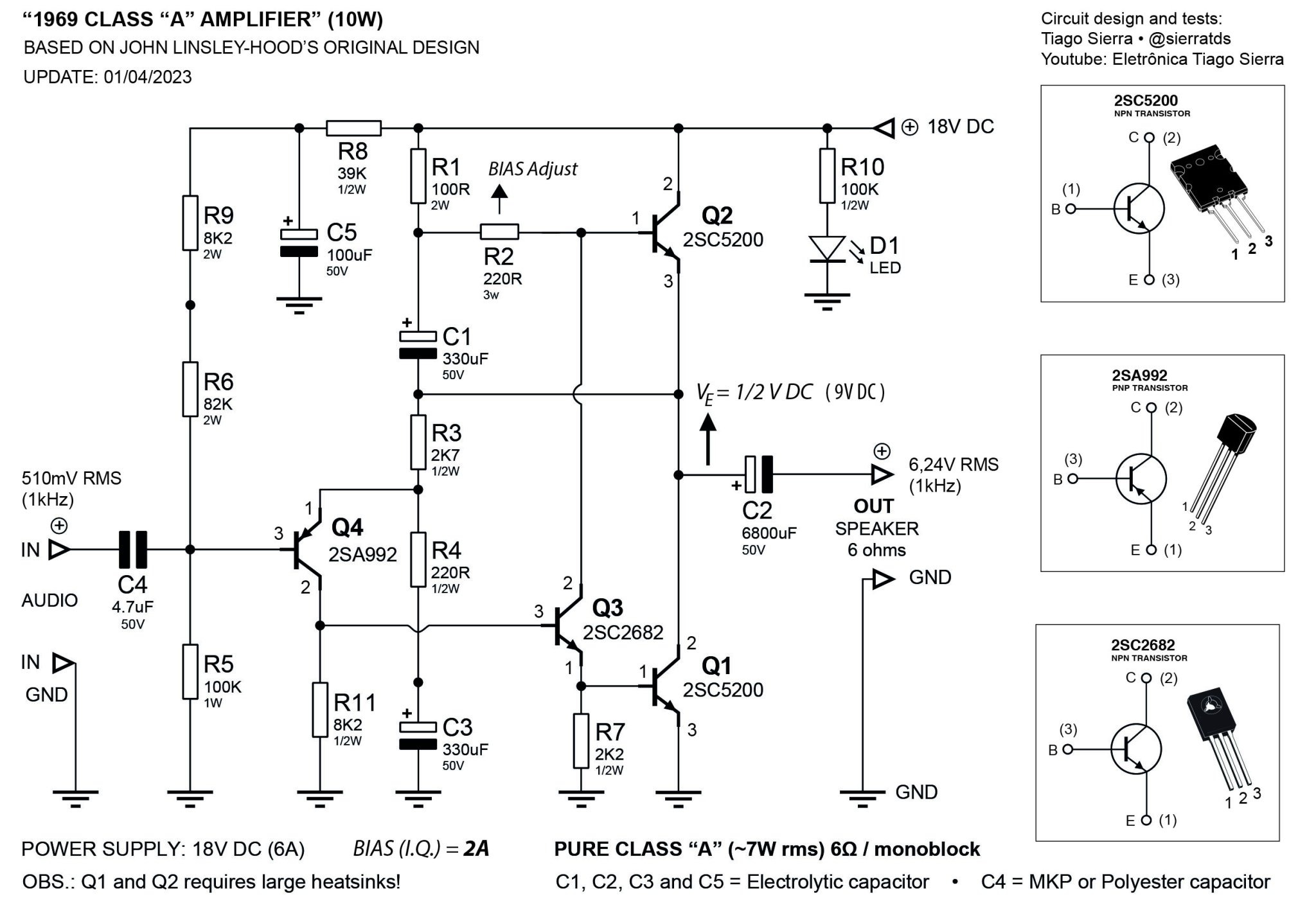

Hello everyone, I built my amplifier with the 2SC5200.
Circuit Diagram:
https://drive.google.com/drive/folders/1hqNqf1LpdyNb26nMPSwo5KOk3z-7M26V
Amplifier I built
JLH 1969 (10W) per channel - monoblock
PURE "CLASS A" monoblock amplifier
6 ohm speaker
Power: 18V DC
I Q. (BIAS) = 2A
Based on Electronics Engineer John Linsley-Hood's 1969 circuit.

Hi.Thanks for schematic. 2sc2682 is hard to find.Any alternatives? And i hope it not oscillates because of high ft of 2sc5200Hello everyone, I built my amplifier with the 2SC5200.

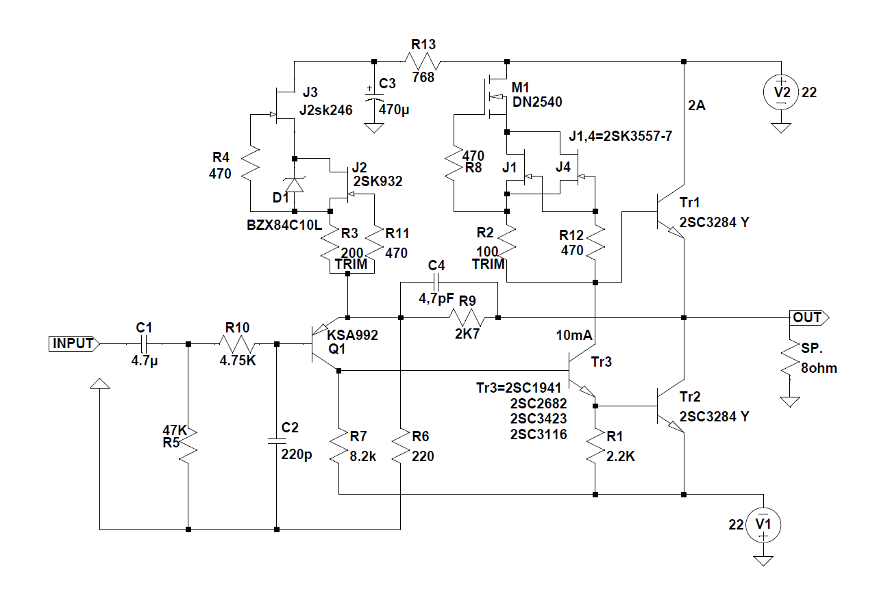

Otherwise, the version without the output capacitor sounds much better and you can easily reach a much higher output power.Is there less love for the version without capacitor output coupling, I see many post on the low powered version
This is my latest version, the output transistor has fT of almost 80Mhz (Y rank) at 2A, C4 is only needed with 2SC1941 which has the lowest Cob of all listed. Soon I plan to make a version with even better CCSs.

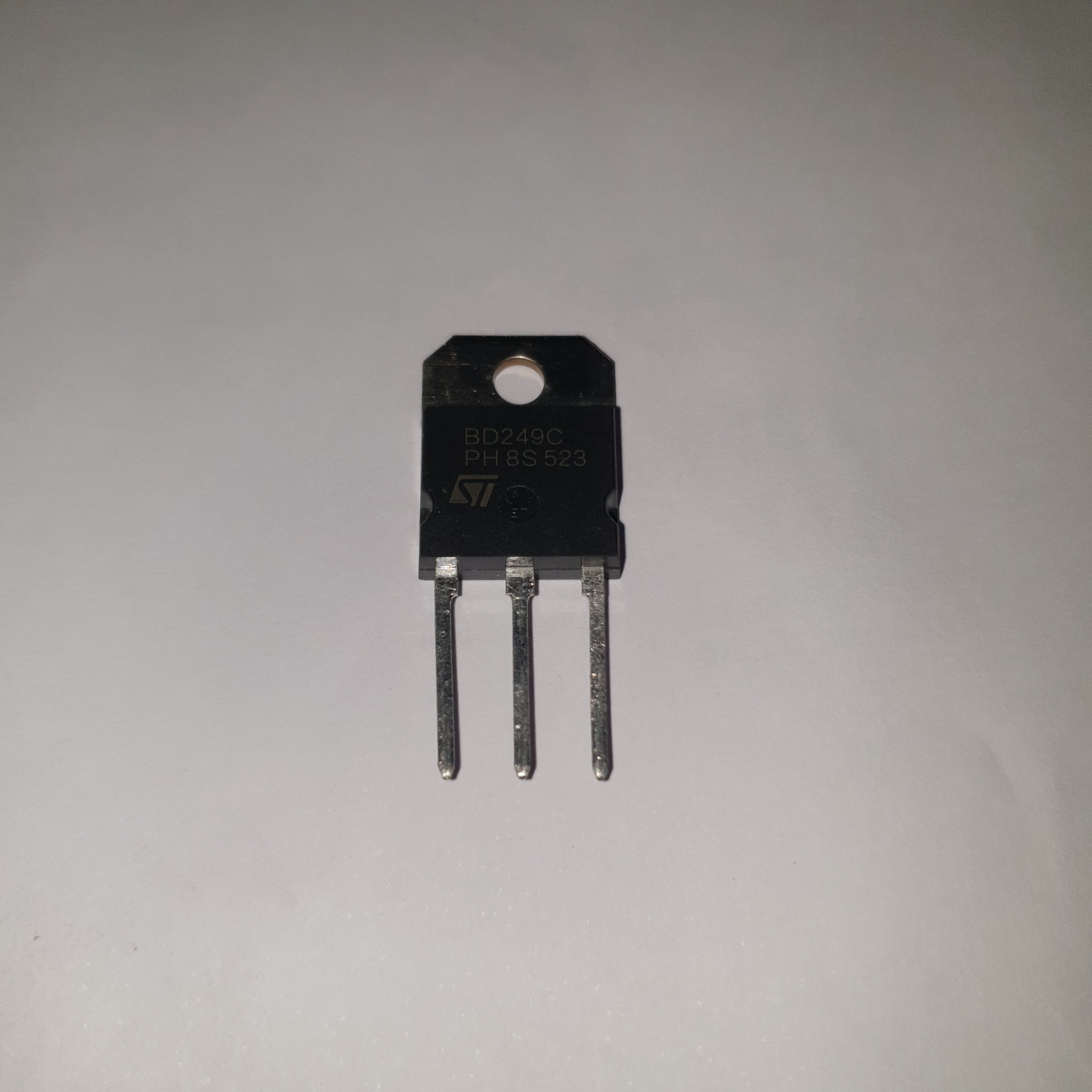

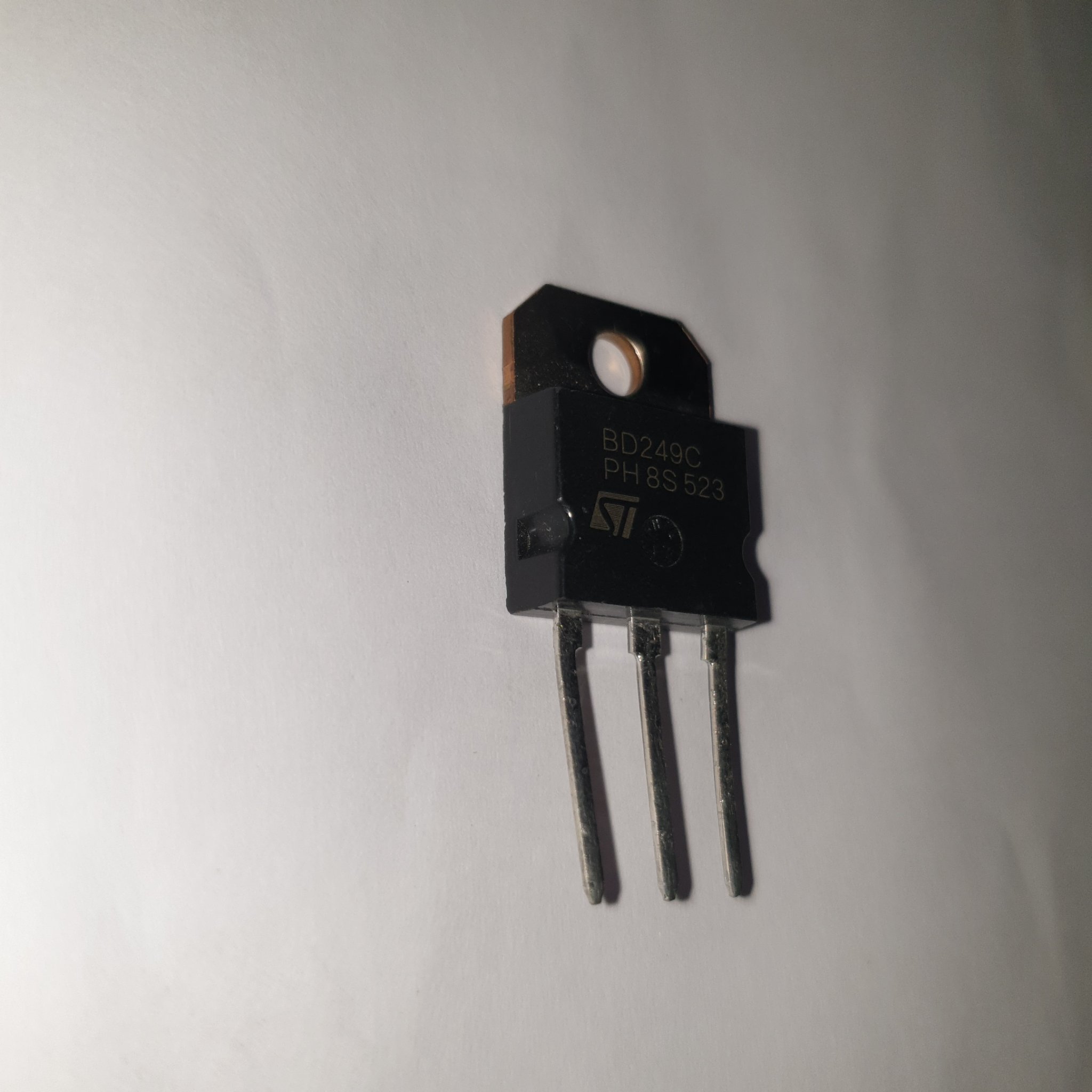

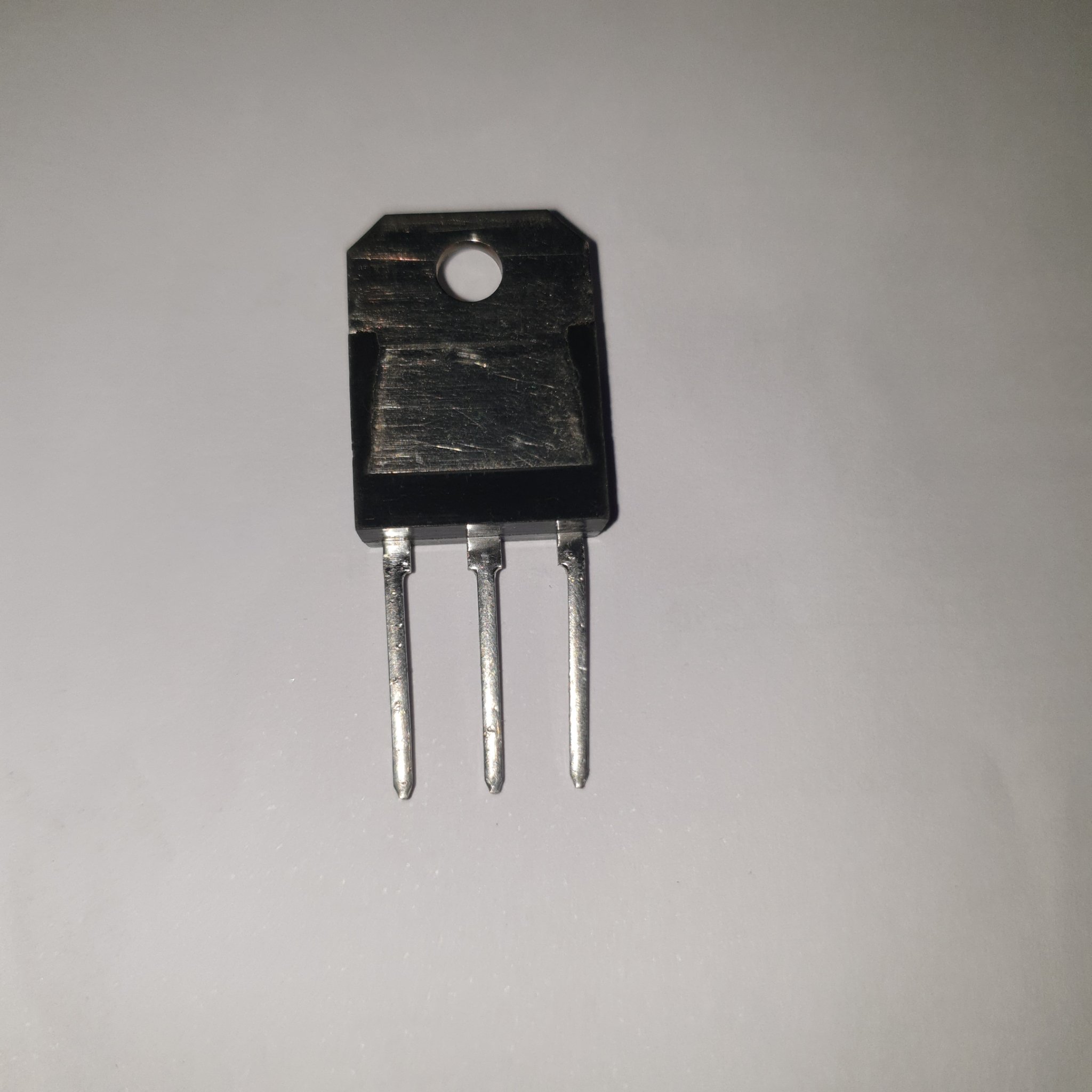

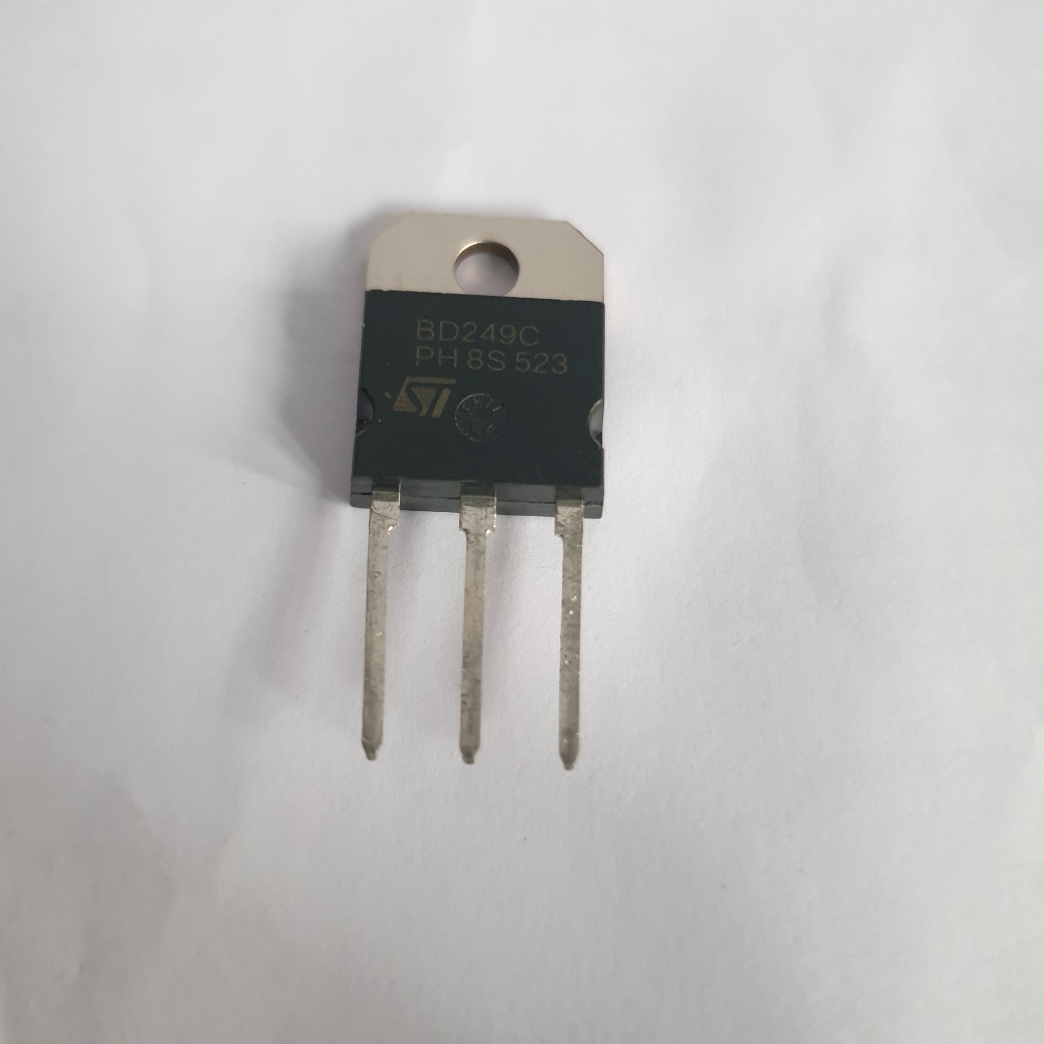

Hi. 10w/pc is enough for me. But for 4 ohm speakers. Here is Bd249c photos. RegardsVeysel - BD249C is a TIP35C equivalent. Should be good for 10W class A but these old high current devices had poor second breakdown limit, (35V) not really usable at their rated voltage (100V for C type), but probably OK for 60-70V rails in up to 50W Class AB.
Are you able to check breakdown voltage (needs to be done carefully). Checking devices for datasheet conformance (fake) is a harder tast than just measuring gain.
Output power level was meant to be a question. What output power are you planning?

Does the capacitor connected in series to the 2200mf 35v output in the schematic. protect the speaker? Also, is there a need for speaker protection?

The capacitors function is to block DC and is needed because the JLH is a single rail design. Indirectly it protects the speaker. AC coupled amps are generally considered speaker safe. No need for any additional speaker protection.

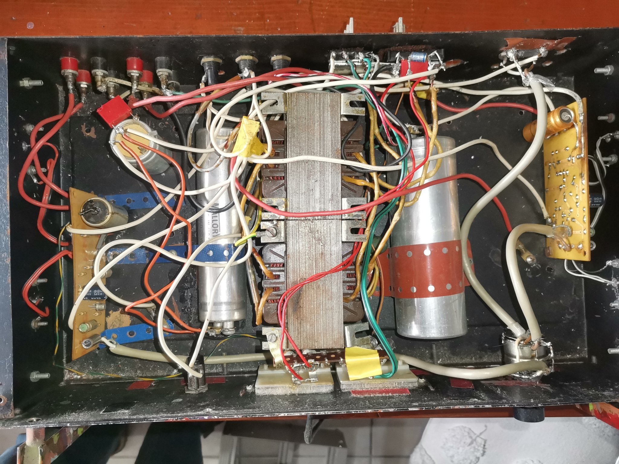

Hi all, just for laughter, I present you the WORST ever JLH Amp clone layout.
It was my first more serious Amp that I bought from some diy'er in late 80's, I was 19 then.
It had a lot of mains buzz and I "fixed" it with capacitors found on scrapyard.
Front pannel design was due to me and my student girlfriend at time being closed in student room for a while, can't remember what exactly we consumed then, but results talk for themselves 🤣.
Probably from sentimental reasons I still drag it in my garage.

Not sure what you are saying there. It is more the type of transistor than whether it is in a TO-264 case or not.For JLH-69 better to use something in TO-264 or TO-3, or build JLH 1996/2001 (2003) with dual PS.
The BD249 has an ft of 3MHz and 125W power rating. In a JLH it should be fine -the second breakdown starts at 30V, but OK for 10W I would think.
It was originally in a TO-218 case, but newer versions (TIP35C?) seem to be shipped in TO-247.
