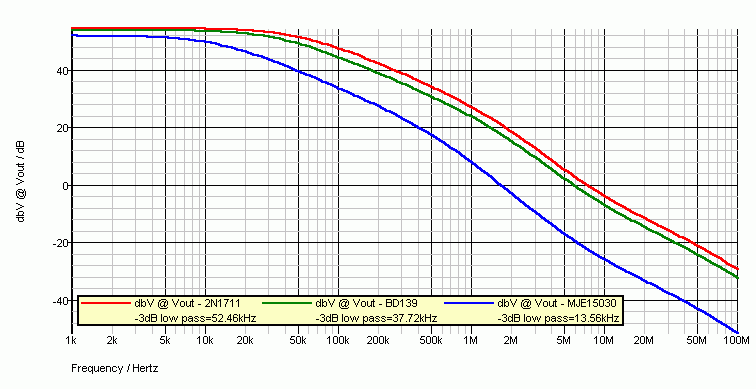

Does a Mosfet version of my circuit have better slew in both directions ? Is it still stable ?
POST 798.
Millwood. I'm having a right laugh here. Is Mosfet your middle name ?
Can you simulate any better transistors in my modified circuit ? With TIP3055 the open loop bandwidth is about 15kHz, and higher might be possible with more modern plastic drivers.
The 10k + 22pF components shunt limit the gain at about 10MHz. I did not think of it as nested feedback because there is much more of that from the base-collector capacitance within the BD139 itself. The BD139 itself limits the positive slew but keeps the amplifier stable, though such internal capacitance might have been a problem within a conventional VAS driver stage.

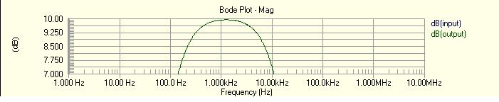

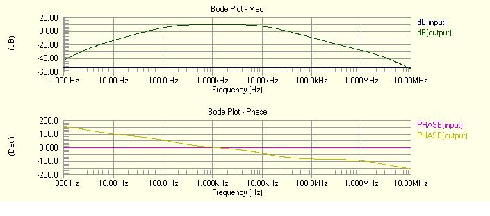

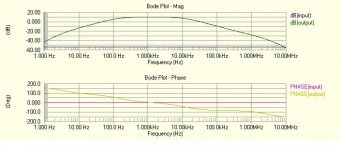

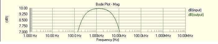

here it is, open loop bode plots for your very modified circuit, using mpsa55/mje15030/mje15030x2.
millwood said:
this is a very promising design. I scaled back some of the numbers: mostly caps. I also used different transistors: mpsa55/mje15030/mje15030x2 as I don't have the original transistors in my simulator (2n3055 in protel dxp / ST Microelectronics library doesn't work for some reason).
It performed very well in both closed and open loop tests:
-3db: about 2-3Mhz.
thd: 0.08% @1k, 0.07% @ 10k, 0.07%@20khz.
I am trying to figure out what contributed to the improved performance. so I altered the above circuitry (a watered down version of Graham's JLH1969). here are some new numbers:
if I sever the input / driver feedback, and ground the 680ohm resistor and increase its value to 8.2k as in the original jlh1969, I got the following numbers:
-3db: about 1mhz;

I have been wondering for a while now why all the simulated open-loop bandwidth figures that you have quoted are significantly lower than I, and others, have obtained. For example, you say above that Graham's circuit has an open loop -3dB point of about 10kHz whereas my simulation gives it as 31kHz.
The answer is the model you are using. The MJE15030 gives much lower open-loop bandwidth as you will see from the attached plot. This was generated using a standard JLH1969 circuit and changing only the driver transistor (Tr3). The difference when this is an MJE15030 is clear.
You have posted a multitude of figures recently, all of which are not realistic because of the model you use. This only serves to add confusion to the debate. Before posting any more results, I suggest you obtain some more suitable models. For example, models for the BD139, and appropriate power transistors, are available from the manufacturers' websites.
You have also made deleterious comments directed towards Graham, based on these incorrect figures, for which I think you owe him an apology.
Geoff
Geoff
Geoff said:The answer is the model you are using. The MJE15030 gives much lower open-loop bandwidth as you will see from the attached plot.
so what model did you use for the mje15030? and why are you convinced that mine (from protel dxp) is wrong?
Geoff said:You have also made deleterious comments directed towards Graham, based on these incorrect figures, for which I think you owe him an apology.
Geoff
