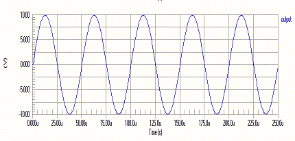

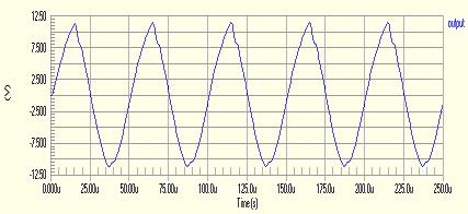

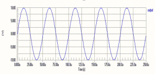

Anyway, I put a 2uf in both circuits, feed with 1vp 20khz sine signals.
THD: 5.50% for BJT, and 0.11% for MOSFET.
gain shoot up 2x higher than normal at 200khz for both amps. The output from the MOSFET remains visually perfect while that of the BJT looks like triangular.
Here is the MOSFET output, taken at the speaker terminal.
