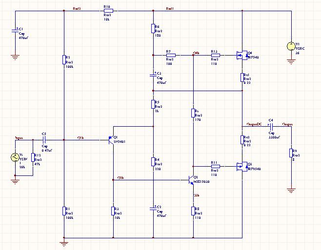

tschrama said:Hi Geoff,
How do you feel about a MOSFET version? Are you allreaddy convinced yet that it can work, be it in a diffrent manner?
Thijs
It seems I am somewhat behind with replies in this thread, sorry about that.
I have no doubt that a MOSFET version can be made to work, and your schematic seems to work well from the limited simulations I have done so far.
When I first tried simulating a MOSFET output stage a year or two back I found the circuit to be rather 'twitchy', that is to say relatively small variations in component values caused a fairly large change in bias currents and voltages.
Also, as you have found in practice, additional compensation was needed in order to obtain suitable stability margins. This meant that the open-loop bandwidth was reduced so that it became similar to many other designs. The standard JLH has an open-loop bandwidth in excess of 20kHz and I believe this is one of the reasons for its superior sonic performance.
Having found these two shortcomings, I didn't pursue the MOSFET option any further, though I'm glad to hear that you and Millwood have achieved some success with this.
Geoff

some preliminary simulation results on replacing the BJT driver with a MOSFET in the mosfet JLH1969:
1) THD at 0.09% with the BJT driver (MJE15030);
2) THD at 0.11% with IRF510 as the driver;
3) THD at 0.94% with IRF540 as the driver.
Both IRF510/540 will work as a drop-in replacement for the MJE. No changes to the rest of the circuitry.
It appears that a small to medium power mosfet with small input capacitance is the way to go for the driver.
The only problem with the IRF510 is that is a little bump at 2mhz with the 510. Needs more investigation.

Complementory MOSFET JLH1969
here it is, on paper anyway.
some performance number per my simulation:
THD: 0.12% @ 1Khz, 0.14% at 5khz, 0.21@ 10khz, 0.39% 20khz.
frequency response dead flat to 700khz, and goes to -3db at 1mhz+.
the Iq is set at 750ma, a little bit on the low side. so there is room for improvement,
millwood said:some preliminary simulation results on replacing the BJT driver with a MOSFET in the mosfet JLH1969:
You do not mention the frequency/power for your simulated THD figures, but the increase when changing from a BJT to a MOSFET is similar to that which I have obtained in simulation.
JLH used a MOSFET as the VAS transistor in one of his later designs (VN1210M) and I believe Zetex make some good small-signal MOSFETs. If I remember correctly, Fred (or it may have been Jocko) recommended a (some?) particular Zetex device some time ago in another thread.
We really should have something better to do on Christmas Day afternoon/evening than spending the time posting here

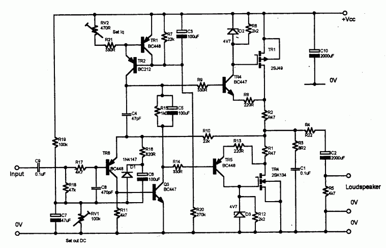

Re: Complementory MOSFET JLH1969
I'm not sure that it is appropriate to call this "Complementory MOSFET JLH1969" since your circuit is more akin to some of JLH's later designs, albeit with the output stage biased into Class-AB (though with a fairly high Class-A bias component in at least one case).
Jlh produced several designs based on the Class-A input stage ranging from the 15-20W published in 1970 to a 270W that saw the light of day in 1975.
A 30W design was published in HFN in January 1980 which was subsequently updated the following December to use MOSFETs in the output stage. I have attached the schematic for this.
You will see that, apart from some protection components, the circuit is fundamentally the same as the one you posted except that the bootstrap ccs has been replaced with a two-transistor ccs and the MOSFETs have driver transistors (a carryover from the original all BJT design).
Note, R7 and C3 were added to remove the switch-on thump. Perhaps you might consider using the transistor ccs, with these additions, in place of the bootstrap in your troublesome MOSFET JLH clone.
well, a little improvement if you short out R8 on the emitter of the driver. New performance figures, while keeping everything else the same:
THD: 0.01% at 1khz, 0.05% at 5khz, 0.11% at 10khz, and 0.22% at 20khz.
millwood said:some performance number per my simulation:

Graham Maynard said:In 700 you say you never heard a BJT version, and then in 710 you publically write about your listening tests, suggesting that the quiescent current should be 1x to 1.3x peak.
Output transistors ? Amplifier ? Speakers ?
Cheers ........ Graham.
Graham, I suggest that you re-read the posts in question and understand under what context the statement was made.
It is extremely distracting to make comments without understanding what you are comment on, to say the least.
