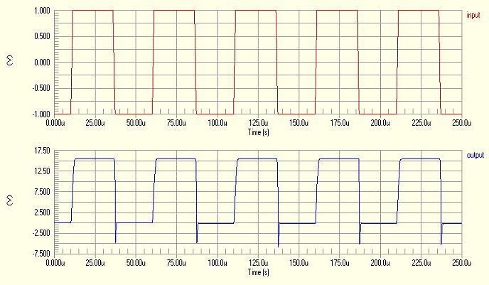

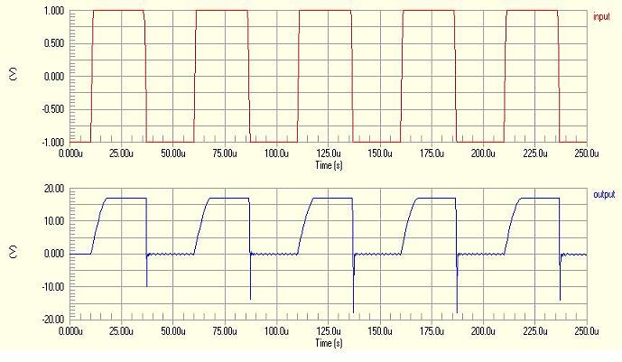

yeah. I got it.
Here it goes, for the mosfet.
asymmetric skew rate: faster upward, and slower downward, signficant overshot on the way down as well.
I will try the BJT later.

without much analysis (any analysis actually), it seems that the mosfet is considerably faster than the BJT, and can drive capacitive load a lot better.
However, both versions have asymmetric slew rates (more symmetric for the mosfet version tho.). Maybe that's due to the asymmetric nature of the phase splitter / driver?
up slew rate for the bjt is about 2v/us. and the same slew rate fo rthe mosfet is about 4-5v/us.

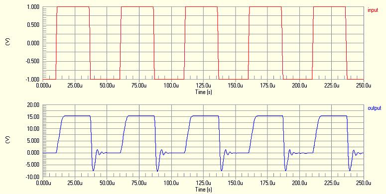

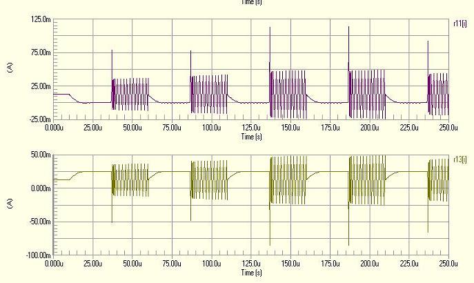

for comparison purposes, I also put "gate stoppers" in the BJT version (value 0.00001ohm) so I can see the base current on the BJT output devices and compare with that on the MOSFET output devices.
here it is. The MOSFEt version, obiviously, has the initiate upshot and pretty smooth thereafter.

I am thinking about the slower up slew rate. The output device, either bjt or mosfet, would be working as an emitter follower and that should have been the fastest. so everything else being equally, the up slew rate should have been faster. but it isn't.
I suspect that the asymmetric Zout on the phase splitter is to blame. The phase splitter works as a common emitter and has high output impedance.
Since the BJTs are current driven devices vs. MOSFETs as voltage driven devices, the Zinput of those BJTs is much lower than that of the MOSFETs, worsening the Z mismatch.
I think if we increase the Iq on the original JLH may help slew rate a little.

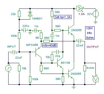

I'm now going to try and attach a slightly modified JLH circuit that Tschrama and Millwood might try to beat with their own four transistor designs. 2N3055s are shown but other types can be tried. Different input transistors could be used like a BC556, but I have not yet ventured beyond the BD139 driver because it not 'too good' and thus does not invoke instability.
Cheers for now ............ Graham.

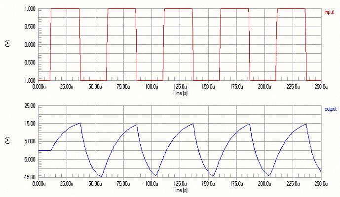

Hi Millward I'm not going to jump through the keypad at you, but it appears that someone called Sloan has suggested 2uF loading.
Lets think about this. Your JLH waveforms with 2uF loading and square wave drive are grotesque, yet the amplifier sounds fine in real life. Is this simulation a valid test ?
I have put capacitors across the output terminal of my JLH's when they are playing music, and all that happens is a cut in treble and the capacitor gets hot; too hot to hold if you keep it there !
Go ask Sloan where, in this world, you will find a loudspeaker that presents the amplifier output terminals with a 2uF load. Again this is one of those distracting 'experts' tests', and satisfying their un-proven requirement could result in the use of un-necessarily over-complex circuitry.
I did the same a couple of days ago, using a 6.7uF cap.. The capacitor got very very hot, both amps (BJT and MOSFET showed higher overshoot, but no sign of instability, it damped very quickly.
this is a very promising design. I scaled back some of the numbers: mostly caps. I also used different transistors: mpsa55/mje15030/mje15030x2 as I don't have the original transistors in my simulator (2n3055 in protel dxp / ST Microelectronics library doesn't work for some reason).
It performed very well in both closed and open loop tests:
-3db: about 2-3Mhz.
thd: 0.08% @1k, 0.07% @ 10k, 0.07%@20khz.
open loop:
-3db: about 7k;
gain: 1500;
thd: 0.44% at 20khz;
it does poorly with a 2uf cap at speaker terminal: triangular waveforms.
However, it is very fast: 6v/us slew rate.
I think the lower feedback transistors and the local feedback between the input and driver resistor did the trick.
Good work, graham.
I am now trying the mosfet version.
