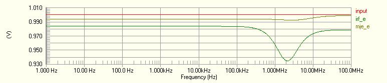

you may have trouble simulating a mosfet output stage at 30v, tschrama.

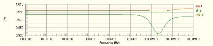

Also, I tried a quite emitter follower circuitry with mje15030 and irf540. here it is.
any thoughts? 🙂

millwood said:
so what model did you use for the mje15030? and why are you convinced that mine (from protel dxp) is wrong?
I don't quite understand you and I stand behind my statements any time of the day. If indeed the model in protel is wrong for the device, I am happy to change it but I need someone to establish for me in a logic way that it is indeed incorrect.
I have no idea whether the protel model is representative of an actual MJE15030 or not. I used the model available at ON Semi's website.
The point I was making is that an MJE15030 (whichever model is used) cannot be used in simulation in place of a BD139 if you expect to get realistic results for a circuit that uses the latter.
any thoughts? 🙂
it was a little odd to me that the protel models will show increasing gains for both devices, kind of counter-intuitive.
so on a 2nd thought, I tried 2n5551 (in protel dxp as well).
it looks normal, with gains decreasing with frequency.
I then went to onsemi and irf sites to compare the models and they are quit different from what protel had used.
so it does seem that protel may not have used the right models for mje and irf. but the irf model in protel doesn't hold an advantage (in terms of frequency responses) over the mje model in protel so directionally those conclusions should still hold.

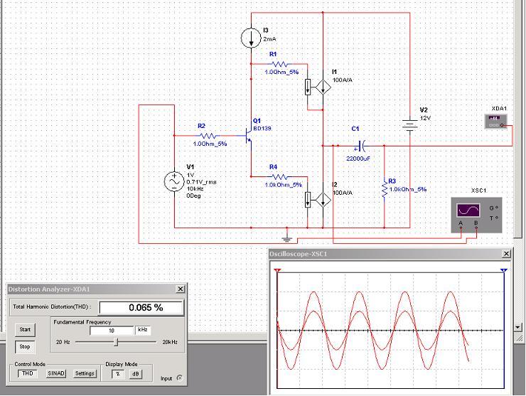

a lot has been said about how the phase splitter works, the current matching on the upper / lower output devices and gain matching vs. distortion relationships.
Here is a very simple phase splitter, driving two perfect BJTs represented as two current-controlled-current sources (CCCSs, with a gain of 100x each).
THD figures and gains for the two devices (simulation done at 1vp /1khz + 5vDC on the input):
upper gain, lower gain, THD%
400, 100, 0.099%
200, 100, 0.081%
100, 100, 0.065%
100, 200, 0.053%
100, 400, 0.046%
it seems to suggest that higher gains on the lower output devices help but I need to understand why.
You can also replace the 2ma CCS with a 2.2k resistor. however, you pay for a performance penalty.
400, 100, 0.104%
200, 100, 0.386%
100, 100, 0.179%
100, 200, 0.099%
100, 400, 0.065%
again, using higher gain devices on the bottom seems to help.
Replacing the resistor with a bootstrap network helped considerably. The network i used is 10ohmx2+470uf. its performance:
400, 100, 0.264%
200, 100, 0.177%
100, 100, 0.101%
100, 200, 0.113%
100, 400, 0.164%
This one does suggest that gain-matched output devices helps.
Of course, this is a highly simplified picture. and if you factor in real life 'characteristics" of the output devices, it seems, intuitively, that matched pairs should help. But having said that, there seems to be a case made for using high gain devices on the bottom.
Exact reasons for that i don't know.
For those interested, you can replace the two CCCSs with voltage-controlled current sources (VCCS) to simulate how a perfect mosfet would work (it works, please allow me to assure you, 🙂). Of course, you will have to provide a voltage source for the bottom device by using a resistor.
my brief simulation with VCCSs suggests performance as measured in thd improved about 2-3 fold. I guess the driver stage is no longer loaded with VCCSs as it is with CCCSs.
