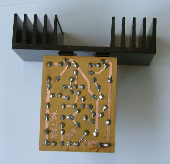

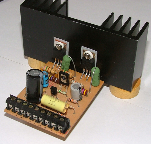

nice work. I wish I could make pcbs as nice as yours, 🙂
One question: do you get turn-on inrush on the MOSFETs? you can check the voltage on the source resistors at turn on and let us know. Mine has large turn-on inrush current and I am not sure if it is inherient to the design or my implementation of it.

Re: Re: Re: Some pics of mine proto
Tube_Dude said:
If you are using a output cap...that inrush current at turn-on is the charge of the big output cap...😉
a little bit more complicated than that. the inrush current is large indepdent of: size of the cap (470uf vs. 3300uf I have tried), with or without a load attached, single rail vs. dual rail operation (thus no cap at all).
and the kicker is that it is the same for the upper output transistor than it is for the lower output transistor.
On thermal stability: I quickly simulated a 1v Vgs drop on the upper mosfet. the corresponding increase in Iq is 20%. and for 0.1v Vgs drop, the Iq increase is 2%.
empirically, I have had no problemw ith irf devices (540 + 240). But it is a little hard to get fairchild fdp mosfets to work stably.

Hi everyone.
There is inrush current. I didn't have much time for cheking the circuit or else. I was very exited about the sound of this project. The components on the board are cheap and old, but correct value. I can say that is sounds very warm 😎 We tried the board on some JBL studio monitors 15" they 're big as house and this small board gave a pretty big sound on them. We were amazed. Realy interesting 🙂
The heet sink is way to small...you can see on foto that one isolator(left) is meltet...we were so caried away with music...the kid got boiled...both IRF are dead now 🙂 :hot:
Input cap...sorry i don't know were i got it. It is 1micro MKT.
I make boards with pen and acid...primitive but working metod.
Well .. just wana say again. Maybe the amp is cheap but the sound is very good 🙂
Good work tschrama, millwood and oll the rest good involved 🙂
pcb and circuit
I am interested in the pcb and layout. I always use hard wiring but this is a lot of effort. I guess more people are interested in this pcb because it is small and neat. Could it somehow be organized that some dozens of these boards are ordered and sold to some people on this forum? Besides that I am interested in the final circuit (or modifications with respect to post 421 for that matter).
Re: it is not post 421
rmgvs said:
Only minor changes with respect to post 421's schematic? For a start there is no output cap anymore, so this is a symmetrical powered version! Not a detail I would say.
I think the big cap in the photo next to the terminals is the output cap. I am not sure if others changes have been made, tho.
personally, the biggest I have done to post 421 is to use a mosfet driver and run it at 40-50ma iq.
by the way, the same schematic can run in rual rails, assuming of course that you can some resistors (the bootstrap resistors).
you can run a DC version out of this particular PCB as well, if you just short the cap termianals and apply two rails (against, use new resistors).
the Iq on the driver is determined by the emitter resistor on the driver and the type of transistors in the output. Once you have that determined, you just need to drop enough voltage on the bootstrap resistors to maintain the DC offset.
the two other grounding points in the scehmatic, the decoupling cap for the input stage and the feedback cap, aren't really important with regards to where they go.
just a word of caution for those of you wanting to do cap-less with the mosfet: the DC voltage does drift more than on the bjt version. over a long period of time (5 - 8 hours), mine drifts about 100mv, vs. about 10mv on the bjt version.
