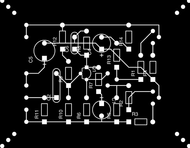

Hi tscharma. I did not change anything in your circuit. I seems to work just fine 🙂 Maybe will play a litle bit when i repair it and get a biger heatsinks.
It is nice idea to use a processor heatsink/cooler for amp, but i pesonally dont like to mix the music with a fan noise
I attached the small JPG of mine PCB. I belive it is good size.

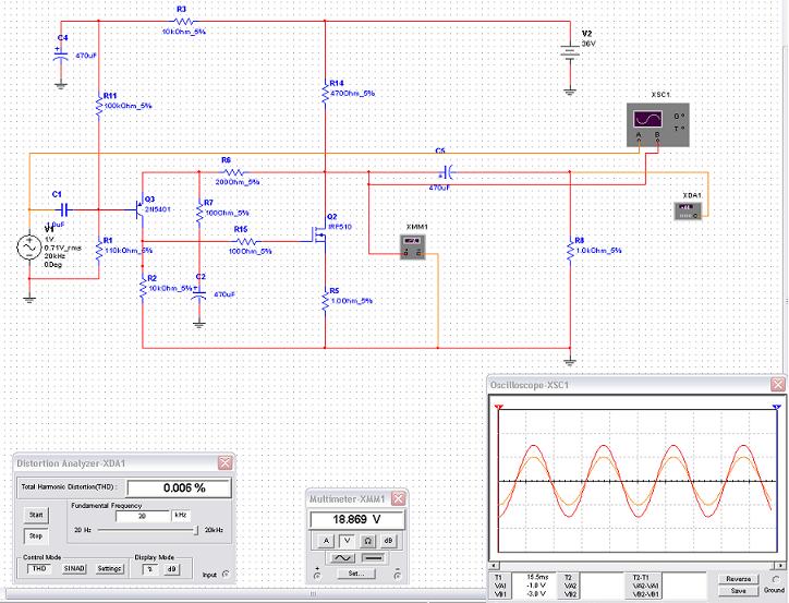

JLH MOSFET preamp?
I was tired of hooking up my php850 as a preamp for testing purposes. so I built a repamp, based on the JLH breadboard I used a while ago to test my JLH1969 BJT version.
Here it is.
some performance number (per simulation, 🙂):
THD: 0.005% - 0.006% from 1khz to 20khz.
frequency response: flat all the way to 10mhz (didn't try beyond that). phase margin at 10mhz is -42 degrees.
the output stage runs very hot, at about 40ma, and R14 dissipates about 0.6w (use 1w power resistor). 470ohm is about the upper limit for R14. You can still run it a little biit hotter - I used a 100ohm 5w resistor for R14 (180ma idle current). Q2 needs a heatsink if you intend to run it this hot. This preamp is also quite stable thermally.
you can replace R14 with a CCS which will turn it essentially into Rod's preamp.
the amp has a gain of 2x, and can drive load as low as 56ohm (for 47ohm load, thd worsens to 0.011%@20khz - not bad). so it can be used as a headphone amp if your headphone has sufficient impedance.
Q2 can also be a medium power BJT but that does not deliver as good a performance as the mosfet. If your anticipated load is high (like 10K or above), you don't need to drive the output stage this hot. R14 can be then set higher, like 1k but too big as it may sufficate current for the input stage and the mosfet.
Here it is.

Tube_Dude said:Do this experience...disconnect the output cap...and without a load see if the inrush current are gone!!
I bet ...Yes!!😉
from my earlier post:
the inrush current is large indepdent of: size of the cap (470uf vs. 3300uf I have tried), with or without a load attached, single rail vs. dual rail operation (thus no cap at all).
to make sure that my memory wasn't faulty, I doublt-checked it today: the idle current is the same, with or without the load attached. thus, the output cap isn't the problem.
Anyway, I couldn't figure out what the cause is for the in-rush current. I suspect the the decoupling cap on the input stage is the root cause.

millwood said:I suspect the the decoupling cap on the input stage is the root cause.
the inrush current appears to be small at turn-on, and then quickly reach its peak (within the first couple seconds) and declines gradually from there. the whole process takes about 20-30 seconds at the outset to stabalize. It is longer for the lower output device than it is for the upper output device.
the center voltage (where the feedback picks up) starts at a couple volts and then gradually reaches about 50% of the rail.
that is consistent with the volt transients on the base of the input transistor: at turn on, the decoupling cap (470uf in my schematic) is being charged up by the decoupling resistor (10k) from the rail, it clamps down the base voltage on the input transistor, thus the voltage on the output cap, causing a large Vgs on the upper output device. as the decoupling cap is charged up, the base voltage appearchs 50% of rail, reducing the Vgs on the output.
one solution may be to use an inrush limiter on the lower output device or on the rail. not sure what it will do to the sonics.

Tube_Dude said:So....You must check the others time constants in the amp.
no kidding, 🙂
yes, it is the input decoupling cap (470u in my schematic). together with the 10k decoupling resistor, the time constant of this r/c network is about 4.7s. at abot 5x time constant (23 seconds), the network is about fully charged up. That is about how much time it takes for the bias current to stablize in my jlh as well.
unfortunately, I don't have a smaller cap so I parallel'd a 1.5k trimmer to the 10k resistor and my bias current stablized now in a couple seconds.
so the way to go is to use a 47uf cap to decouple the front end, rather than the 470uf cap. I originally had.

millwood said:I thought about this more last night and here is the shocker: the 1969 can work under dual rails with zero modification. The two "grounding points" are 1) the decoupling cap on the input stage, and 2) the dc blocking cap on the feedback loop. However, the supply rails are just like ground to A/C signals. so for DC blocking purposes, it doesn't really matter where you tie them (well, unless they are incorrectly polarized). So you can either tie them "properly" to the ground, or to the negative supply rail.
simulated it this morning: it worked;
breadboarded it this morning: it worked.
