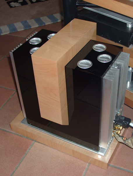

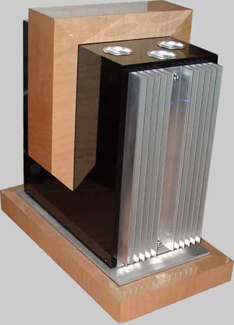

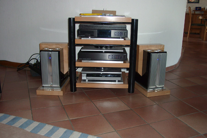

Picture of JLH
until now i build different versions of JLH.
The best one is created with Vishay s102k Resistors, matched 15003`s of ON, Mundorf silver-oil cap as coupling capacitor, Blackgate and Elna Cerafine Cpacitors in Cap-Mult, other transistors matched, too.
Theres the need to say, that JLH is sensitive to parts quality.
With all experiences i and friends of me, made some other amps from Pass, Gainclone, Hiraga...i can tell, that this amp is hardly to beat. Greets to Geoff and the others who helped me...
The Pic is the amp we build with a friend.
Ralf
elaborate please
Hallo Ralf,
very beautiful indeed! Some pictures from the inside would be nice, just curious.
Could you elaborate some more on the differences in your latest version? Which JLH is it? What are the differences you hear with what parts changed? How is the sound different from the Pass and Hiraga etc.
On the site of Geoff some very detailed descriptions can be found on the differences in sound by replacing one component or part of the circuit. You would do many builders a pleasure by sharing this knowledge.
Rudy
thanks..
..for the complements.
since i have no digicam i cannot show you pics from the inside yet - perhaps later.
..yes i made similar experiences like Tim.
its the "update-Version" of JLH, with Capmult as PSU.
the coupling capacitor makes big influence in sound.
first i used very expensive jensen copper-foil, but the mundorf silver oil has much more resolution. But i cascaded the mundorf by adding a Glimmer and a Kp1832. This made the sound sweeter and smoother.
i and a friend who build the same amps wolud like to say, that the JLH beats the Hiraga Monster, Pass X-SOZ, ZEN, Gainclone.
The JLH has more attack, more fine-resolution, voices are more "human", Pinao is more Piano...
at least at my speakers, and i have more than one pair.
Ralf
