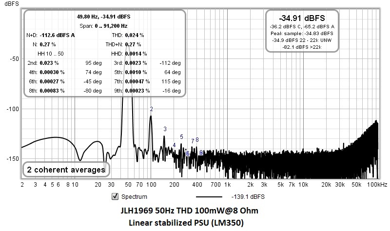

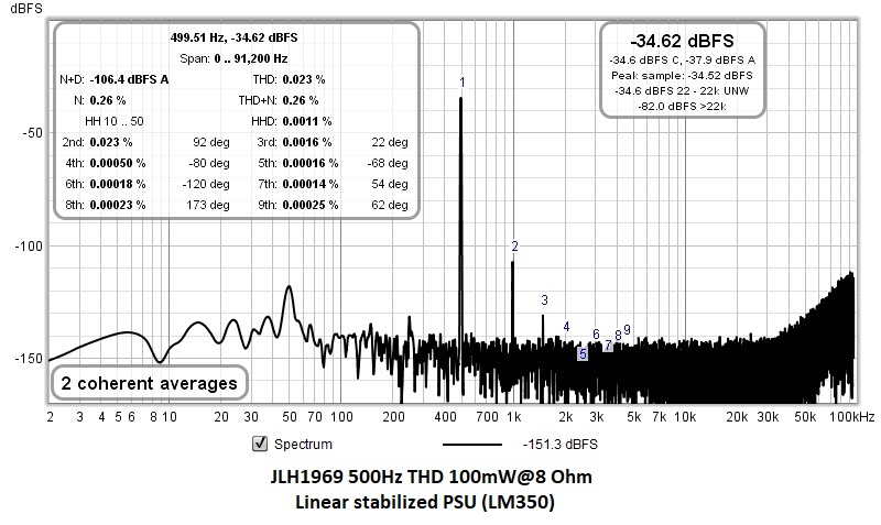

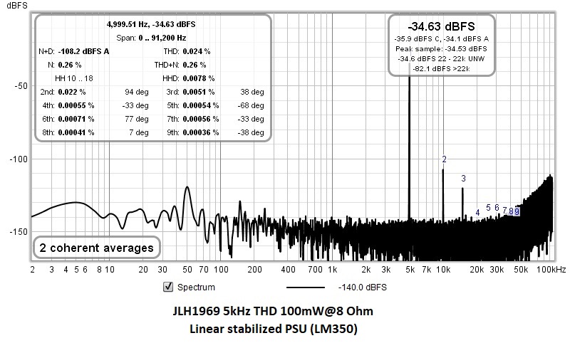

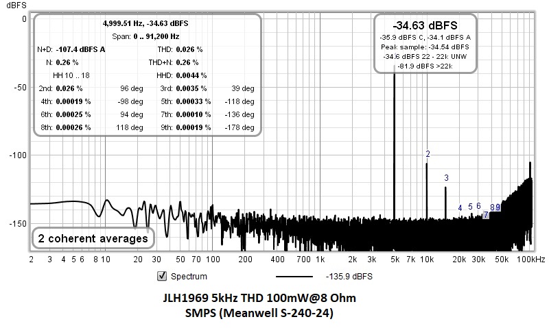

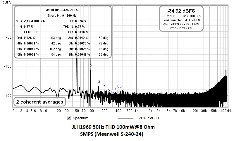

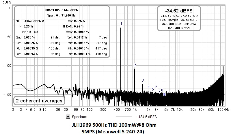

Check the attached screenshots of my JLH1969 amp output.
Three pairs. First in each pair, a stabilized (LM350T) linear PSU, second an SMPS (Meanwell S-240-24) are feeding the amplifier. Noise floor is a bit lower with the SMPS
George, thanks for sharing the data. Very interesting that the noise floor of the SMPS is actually lower than the linear one. Also looking at harmonic spikes, they are also narrower for the SMPS one, suggesting a cleaner output.
This is the first time I'm using a SMPS for an audio amplifier and can't pick any faults with it. The constant current draw of a class A amp is probably also SMPS friendly. You data sure backs that up.
I suppose bulk of the switching noise from the SMPS is beyond the hearing spectrum, plus I think Meanwell makes decent SMPS as well. Used a few of them before but not for this project. I've used a cheap eBay one, but swapped out the caps for quality ones from another new but scrapped SMPS. I'm sure the very faint background noise will go away with a Meanwell one. I initially hooked the amp up to my bench power supply which is also a SMPS and it was dead quiet.

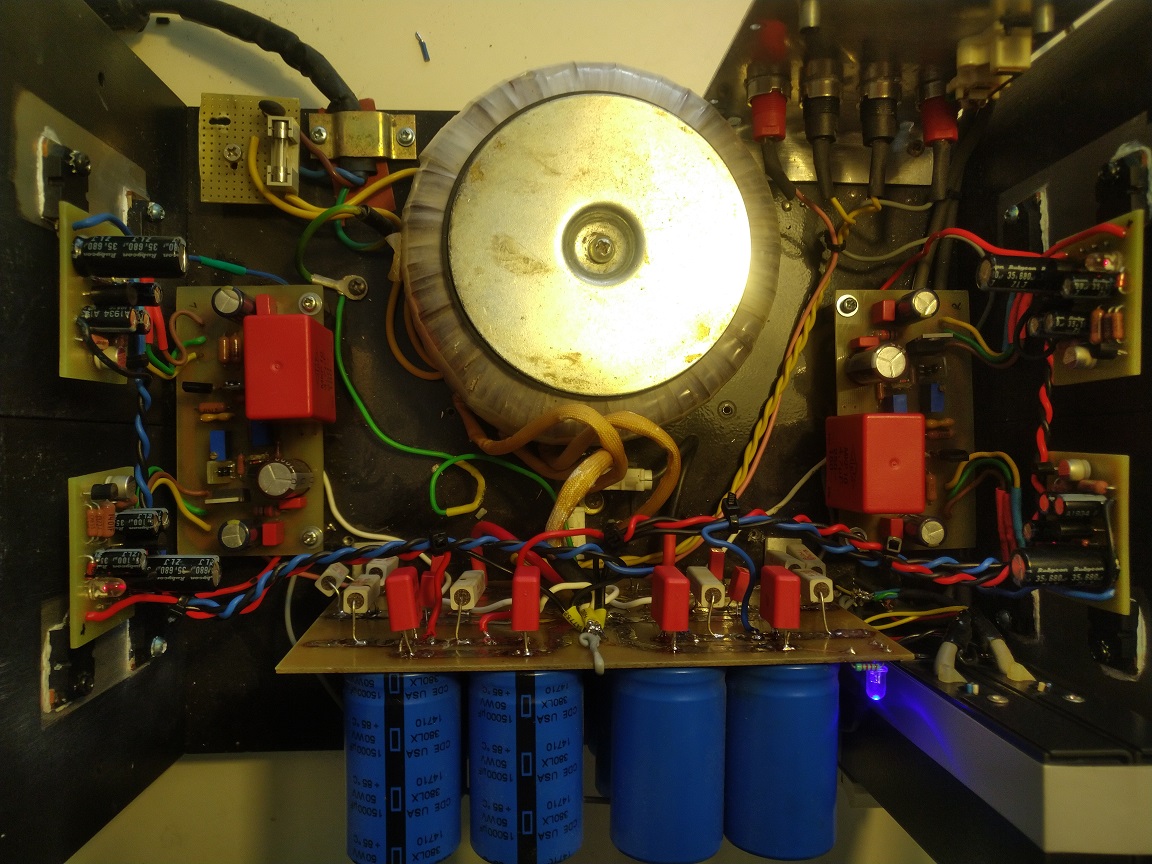

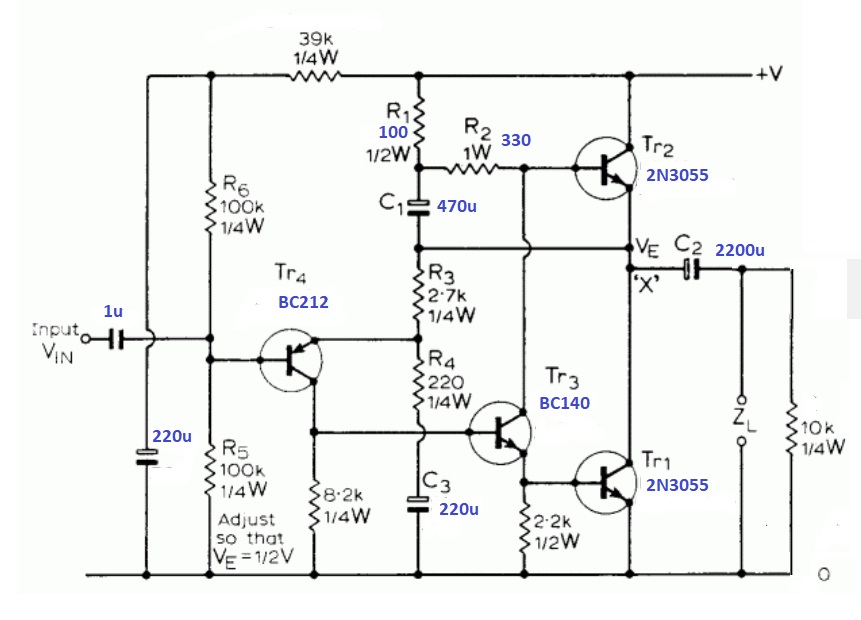

This is how my JLH1969 built about 45-47 years ago measures today (I am in the process of verifying the performance of my amplifiers)
BC212 (Siemens), BC 140 (Siemens), 2N3055 (Motorola).
1uF MKT input, 470uF bootstrap, 2200uF output (capacitors are some 15 years old).
1 Ampere per channel at 24Vdc
George
Hi gpapag,
Do you have the diagram of circuit?
could make available?
Thanks!

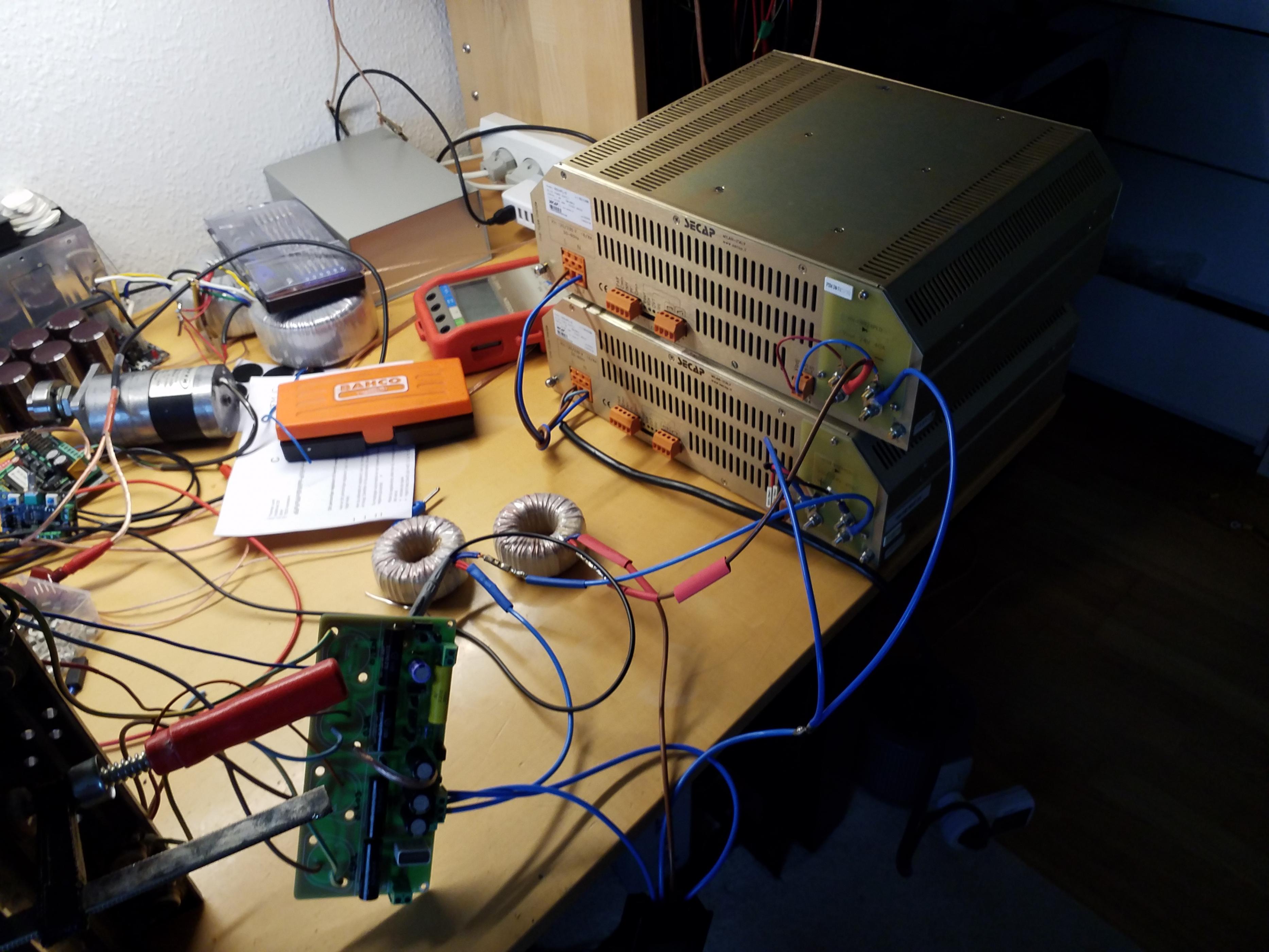

Arctic cooling make 120mm fans with a temp. Probe attacched on a cable, it increases speed according to temperature, very nice silent fans.
The smps works very well, for my jlh and hiraga builds I tested them on two series connected smps, 40 amp each, noise was extremely low, and the smps dont mind common mode choke and 33000uf strapped on.
Only bummer is their size.

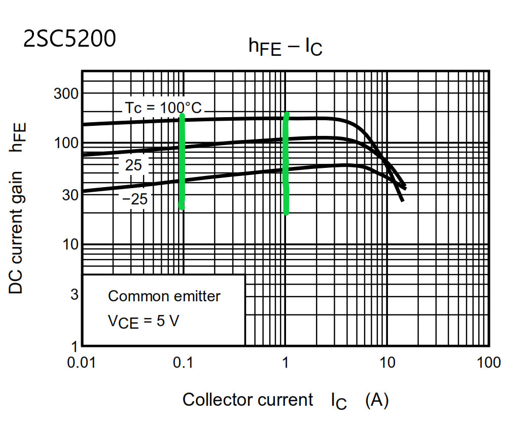

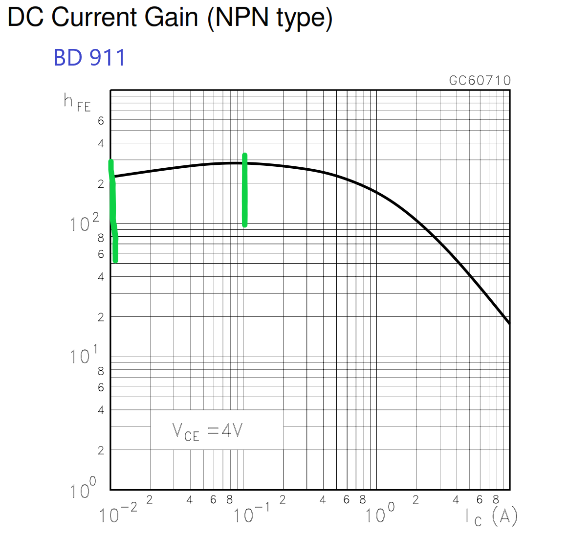

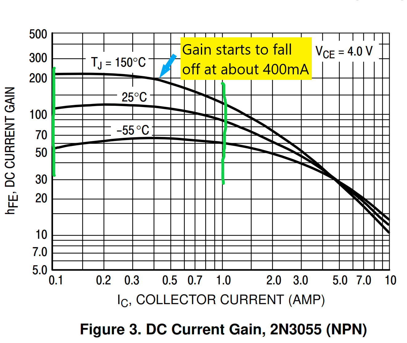

John, totally agree with you. I was looking at the current/gain curve when deciding whether my BD911's would be acceptable for the JLH amp (I did not have any 2SC5200 or MJL3281's on hand).
It's interesting that the 2N3005 actually has some decent gain at low currents, but that starts to fall off very dramatically over about 400mA.
Fine for class AB amps where most of the listening, especially in the sensitive 1-5khz range, draws just a few watts. This probably corroborates with the 2N3055's being behind some famous class AB amps like the NAD 3020.
But using the 2N3055 on a class A amp would be a different story. Even the 1-1.2A current draw of the 1969 JLH will take it out of its linear gain range. I've attached some gain/current charts and highlighted the probable operating area for the 1969 JLH between two green lines.
Linearity is almost flat for 2SC5200 and MJL3281. Acceptable for the BD911 but falls off quite steeply for the 2N3055.

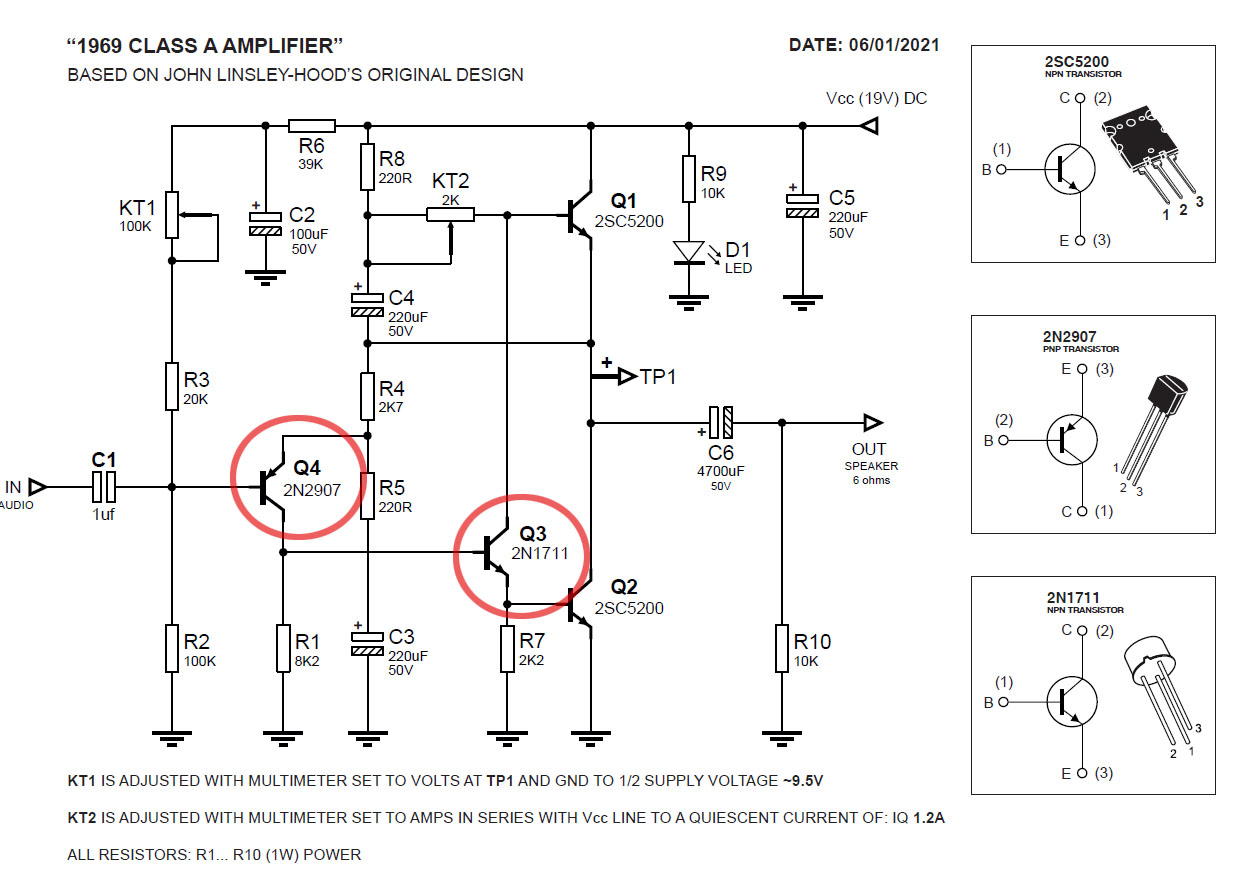

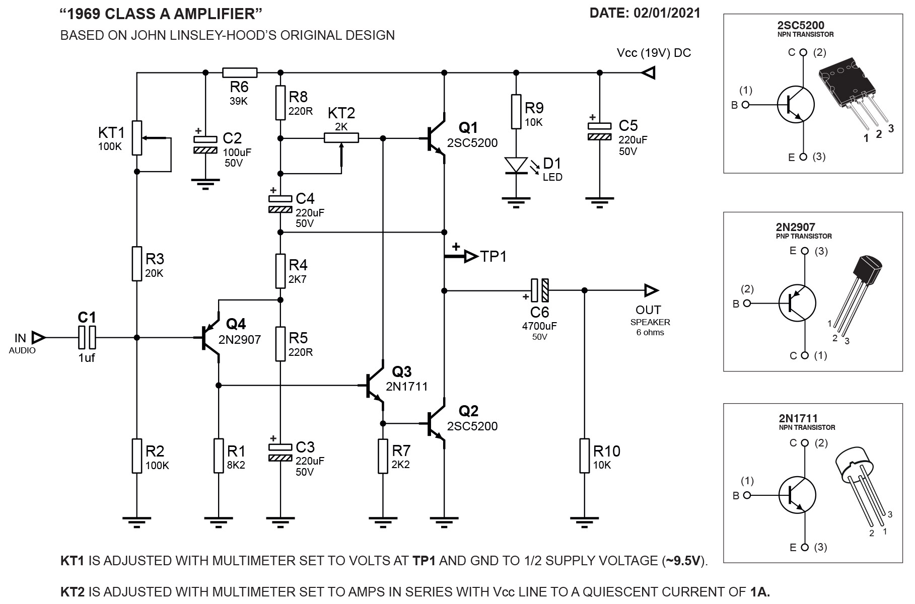

Hi Ian Finch, how are you? In this attached circuit of mine, do you think I better change the transistors Q4 and Q3? Q4 PNP (2N2907), which one to replace? and Q3 NPN (2N1711), replace with BD139?
Thanks for listening.🙂
You could consider replacing 2N1711 with a ZTX450. It has better gain and linearity than both the BD139 and 2N1711. I used it in my recent build and it sounds good.
Some concerns that it comes in a tiny E-Line package, but its specs add up and they were not at all warm when I measured them.
I replaced the Q4 (2N2907) with a BC560, a low noise signal transistor. But original ones are difficult to get these days with lots of fakes around. Apparently BC850 shares the same die as the BC560 but its in a SMD package.
Thanks! Altus Fidelitas!!
I will change the transistors. I will put the ZTX450 and BC560.

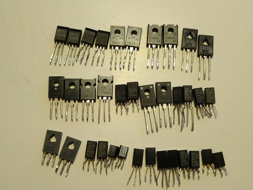

When I was doing my first JLH69 a couple of years ago I tested a lot of transistors on it, especially for the driver and input transistor. I tested maybe about 40 types of transistors for the driver and about 10 transistors for the input stage. Tests were done listening and accompanied by an oscilloscope.
For input, the best were KSA992 (2SA992) and SMD 2SA1312 (2SA970), I also tested BC560 but it is not a shadow of 2SA ...
For the driver, the transistor must have as low a Cob as possible and a higher fT with high gain, old video transistors like 2SC2705 and similar proved to be excellent, I had the best results with 2SC2682 and 2SC1941.
For the output I use a transistor with fT of 80MHz and it works without problems, compensation was needed only in combination 2SC1941 + 2SC3284.
No need to look for transistors that will match those originally used in JLH but should be further explored.
There are a lot of better transistors today and I’m sure they will provide a lot more enjoyment with JLH than with the original transistors.
Why not improve something, it’s a real DIY spirit.

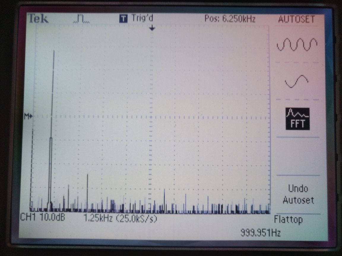

  • 2sc3284_ds_en.pdf
    2sc3284_ds_en.pdf

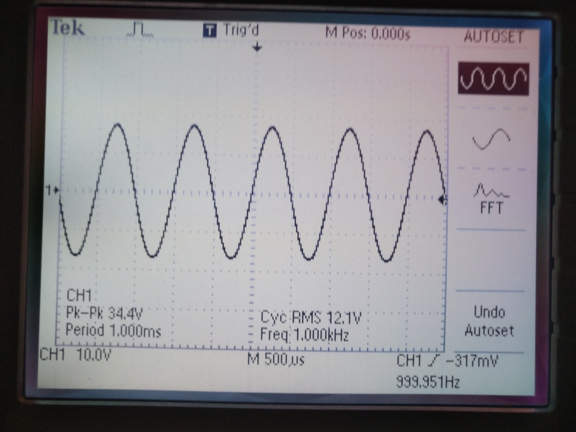

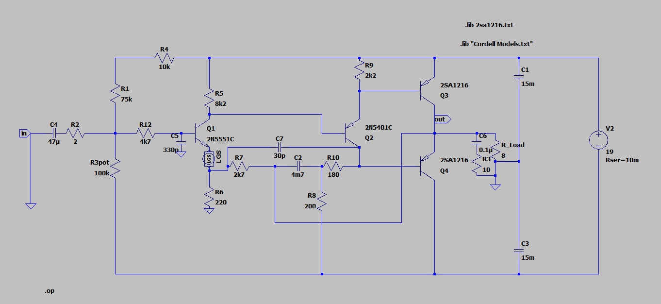

Did you try this compensation? I posted a simulation about it before in the thread, but the value needs to be tuned for the transistors used.
My PNP JLH seems stable without compensation, so I never felt the need to add compensation.
