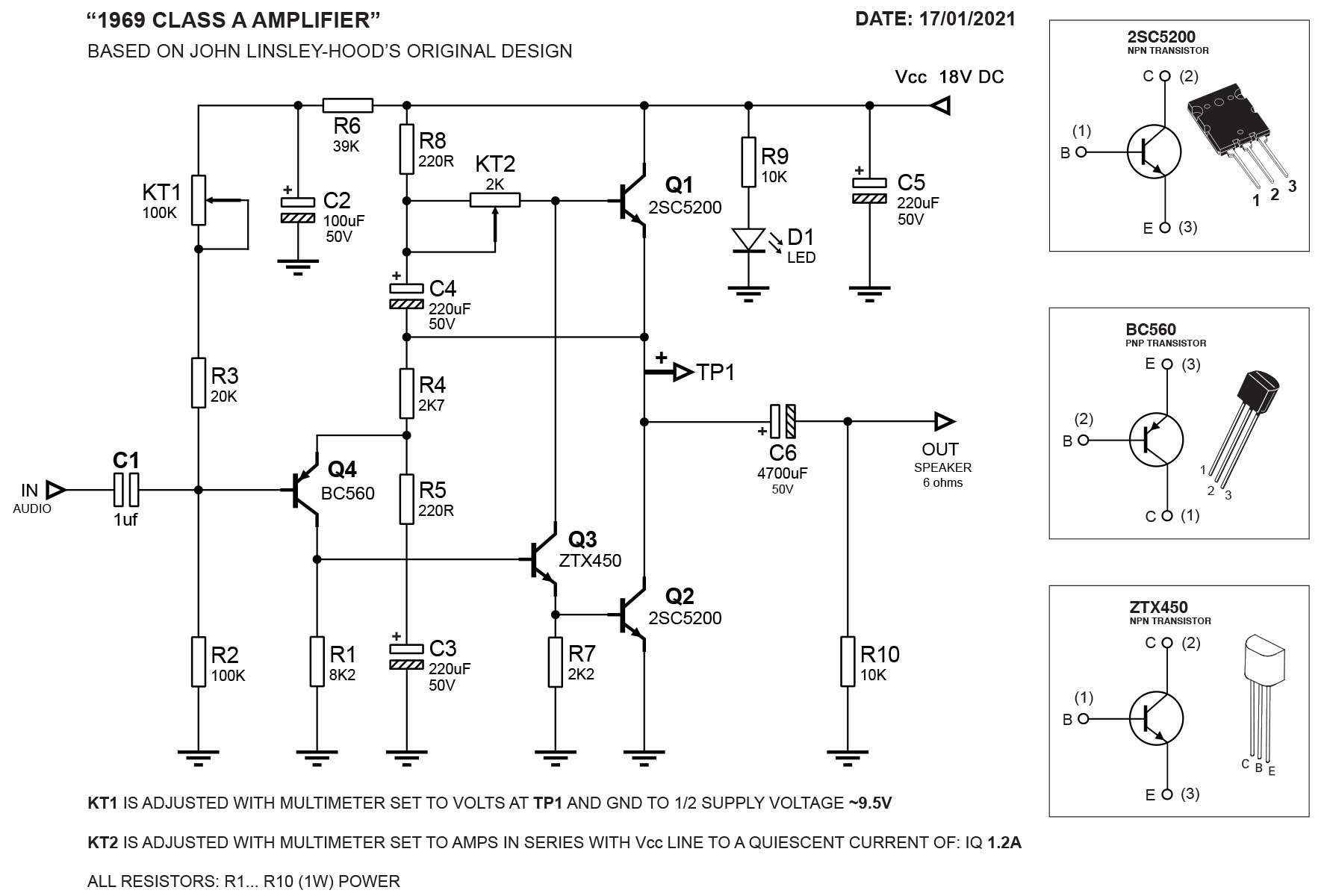

The power consumption is divided equally between the two output transistors and is dissipated as heat on the heatsink.
3 Om 17В * = 2.0A 34W
8 Om 27V 1.2A * = 32.4W
15 Om 36V 0.9A * = 32.4W
Don't forget that those estimates are based on reasonably correct speaker load impedances in 1969, which with currently available loudspeakers in particular, is no longer the case. For example, typical consumer and hi-fi entertainment speakers are now mostly 6 ohm rather than the nominal 8 ohms rating still marked on the rear of the boxes.
It's a marketing trick to increase the apparent output level and hence seem to produce better "sound quality" of certain speakers but as the competition caught onto this, it's game over but now we have a legacy of false ratings to deal with. It means that you will likely need to reduce the supply voltages and increase the bias current capacity in proportion. Perhaps 24V@ 1.6A supplies would be more suitable for current model "8 ohm" speakers.

For example, typical consumer and hi-fi entertainment speakers are now mostly 6 ohm rather than the nominal 8 ohms rating still marked on the rear of the boxes..
Hear, hear! If it's an MTM set up, expect it to be closer to 3ohms. And complex arrangements can add phaseshift, pulling more current than the delivered power would indicate.
You're in the luxurious position of setting up your amplifier to match your speakers.
I'd suggest setting the standing current to leave just a little headroom, if possible (SOAR and all that).

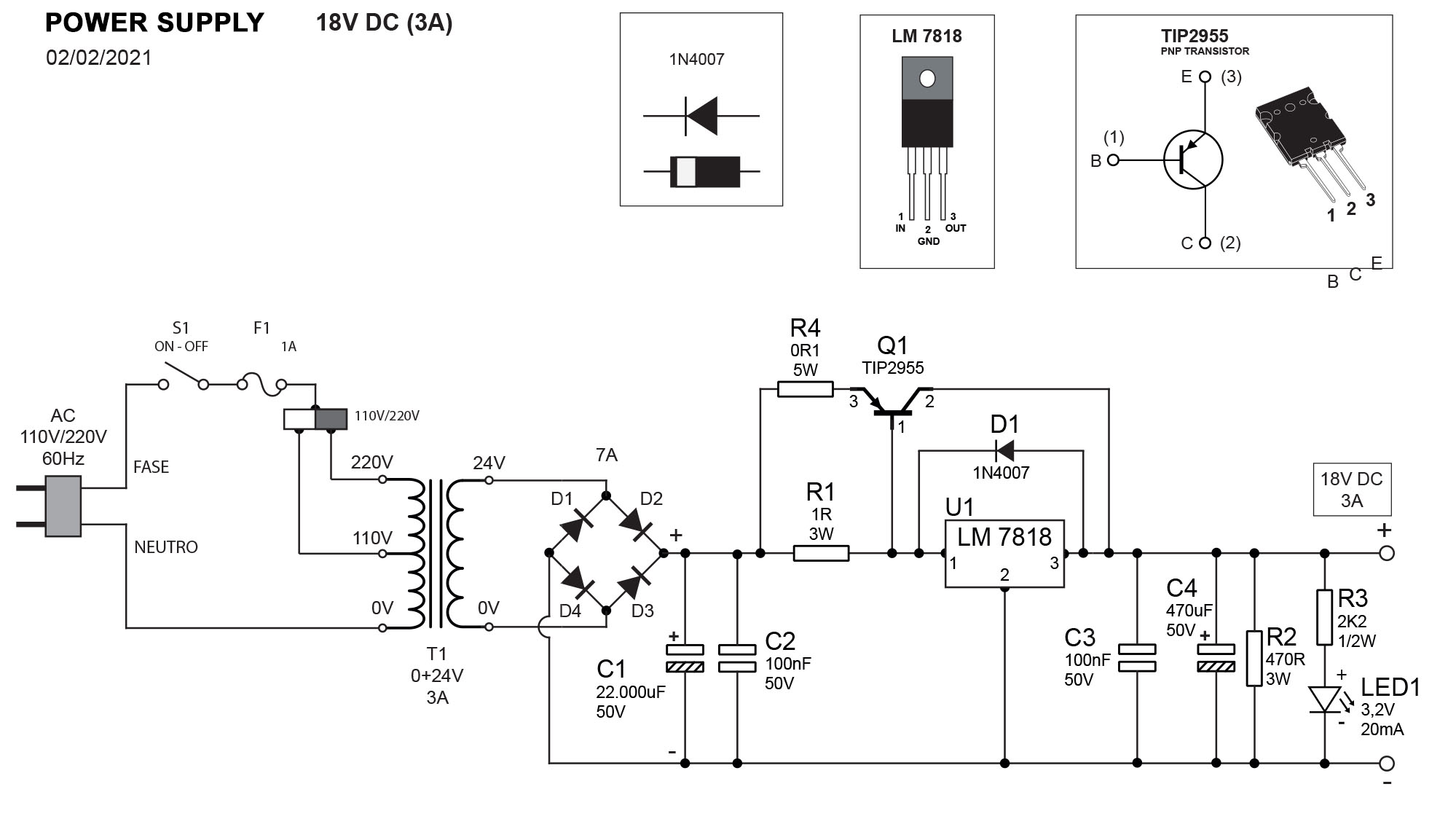

POWER SUPPLY 18V DC

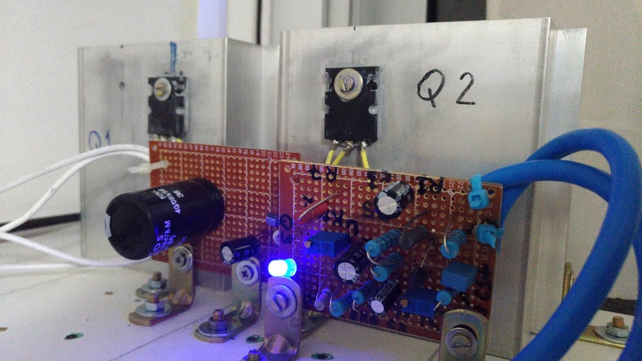

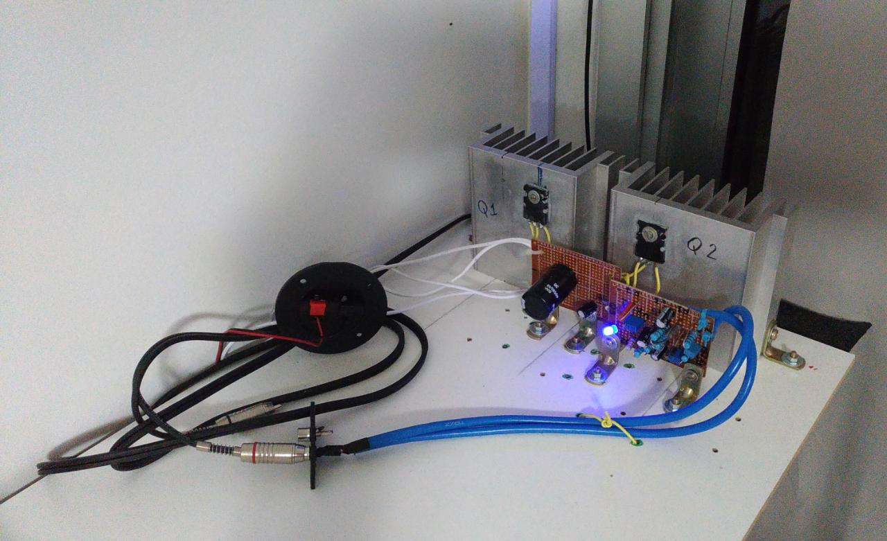

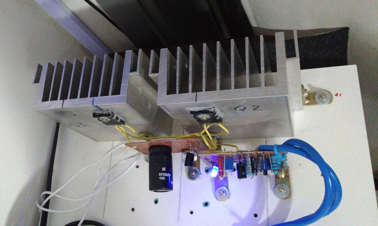

Hello guys, I'm designing a DC source for my "JLH 1969 10W" 18V DC amplifier.
I would like to know from you what you think about this circuit. Today the circuit is connected to a switched 19V DC notebook power supply. But I want to make a source with a transformer for the energy to arrive cleaner in the amplifier circuit. Approved the source circuit, then I would use 2 of these. 1 for each amplifier circuit. L + R. Thanks for listening. Criticisms and suggestions are welcome.🙂
do you want a source with a linear regulator?
Note: The 2955 needs to be mounted on a radiator. Add a reverse diode (like D1). Add a 0.5A fuse on the mains side. Increase the output voltage to 24V.
Perhaps a capacitance multiplier. Perhaps the top half figure 3A from ESP: Capacitance Multiplier Power Supply Filter
From my capacitance multiplier experiences I would add protection diodes to the pass transistor including protection for the pass transistor coming out of saturation. Perhaps a string of three large diodes. (Depending on the saturation voltage of the transistors used.) I say this because I used TIP142 & TIP147 (on class AB amplifiers) and they failed surprisingly easily.
Hello OldDIY, could you draw over my circuit where the components would be? Fuse 0.5A and reverse diode at 2955. Yes, I will put a heatsink on the TIP2955 and LM7818.
2955 may be mounted on a radiator of amplifier's Q1 without isolation.
OK, thanks!!!! MIRALIN.
