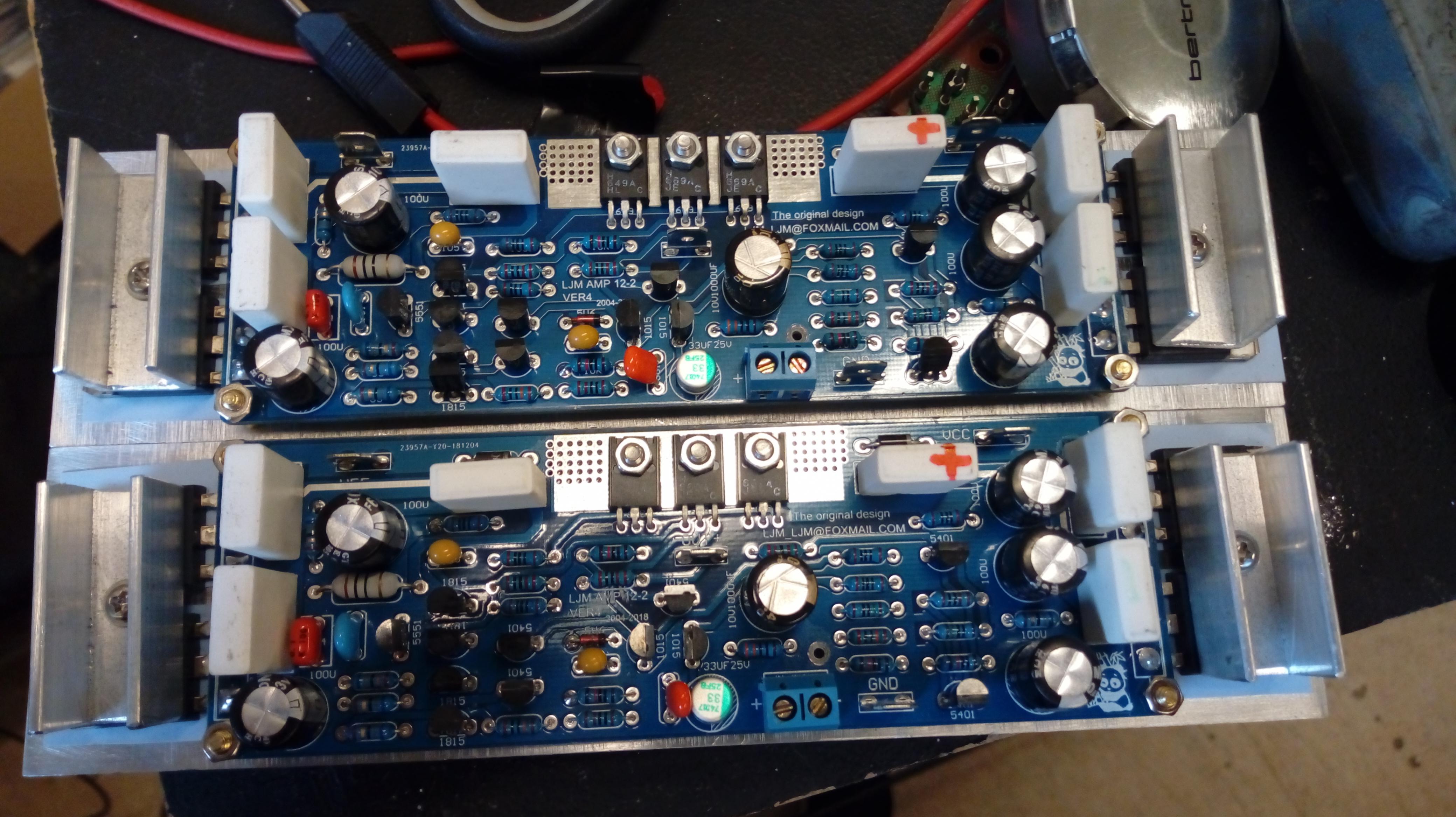

#7588 There are several schemes on the branch. An attempt is made to develop a universal PСB. Can build 1969 Class A, Class AB with Darlingtons, Discrete Darlingtons, Triple Darlingtons and Mosfet. It is recommended to use a stabilized power supply.

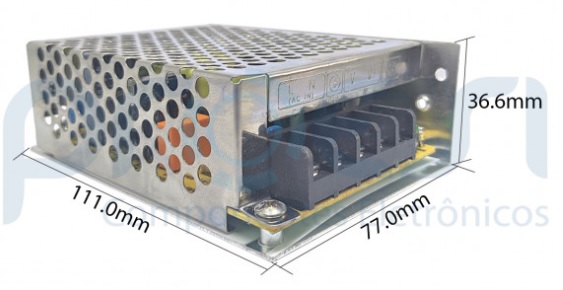

Hello OldDIY, can I connect this amplifier to a switched 24V DC (3.1A) source?
Does my amplifier support this 24V voltage?
And how do I calculate the quiescent current in the circuit?
Thanks.

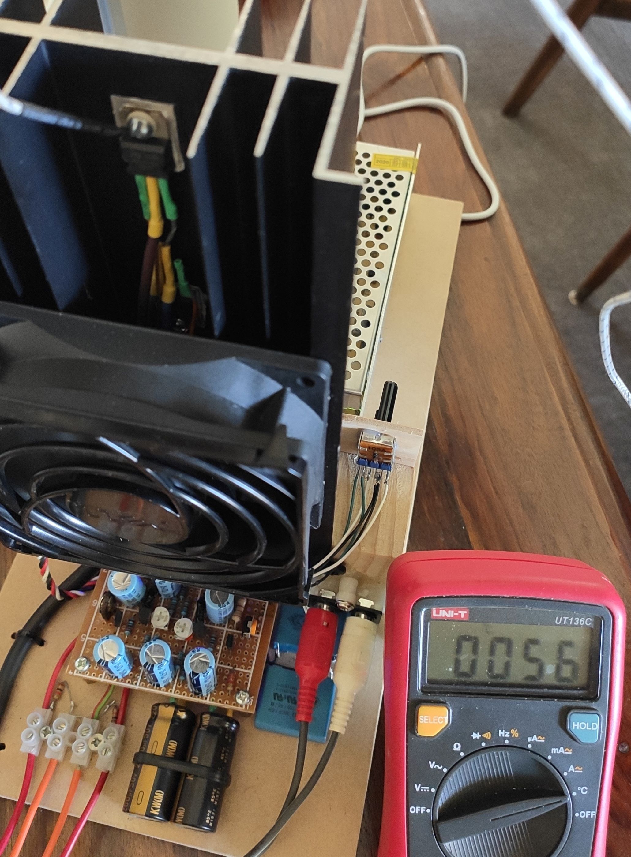

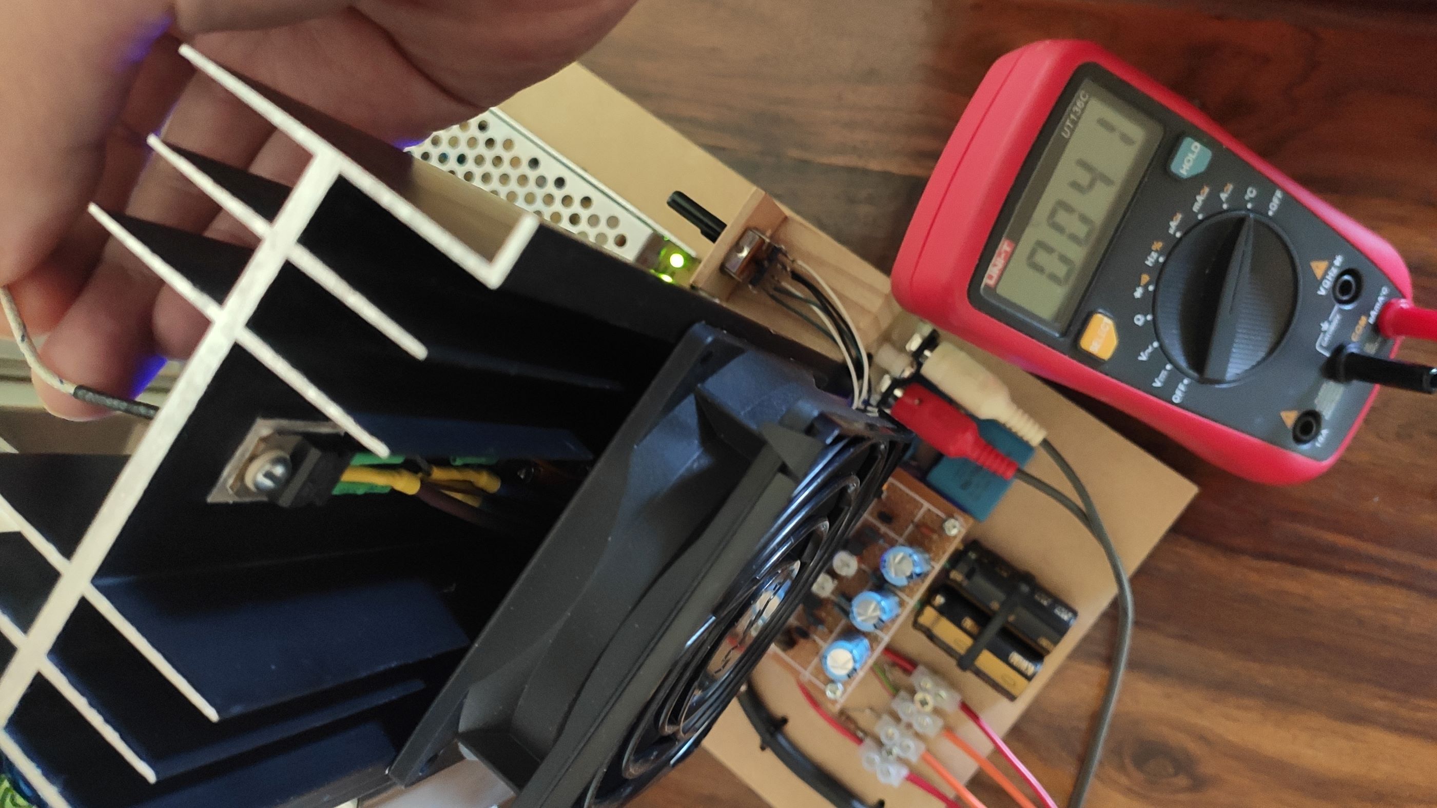

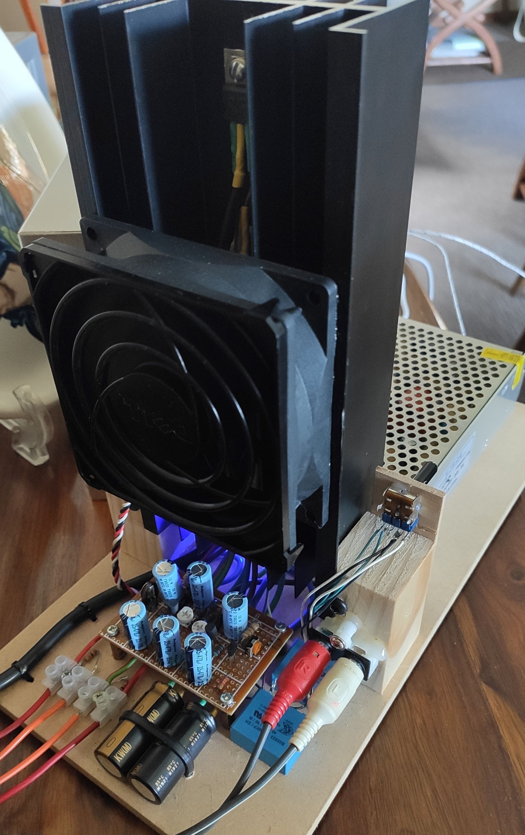

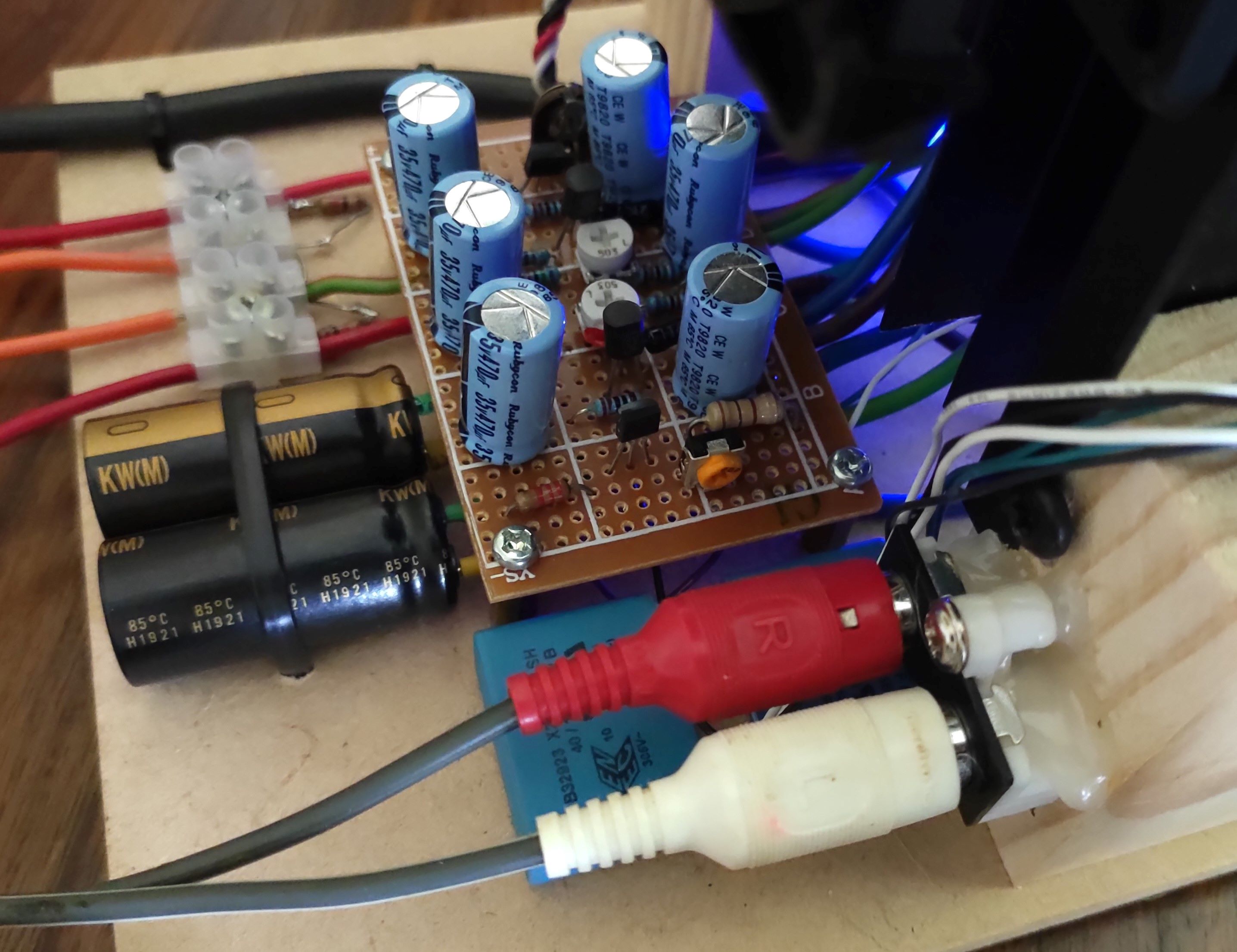

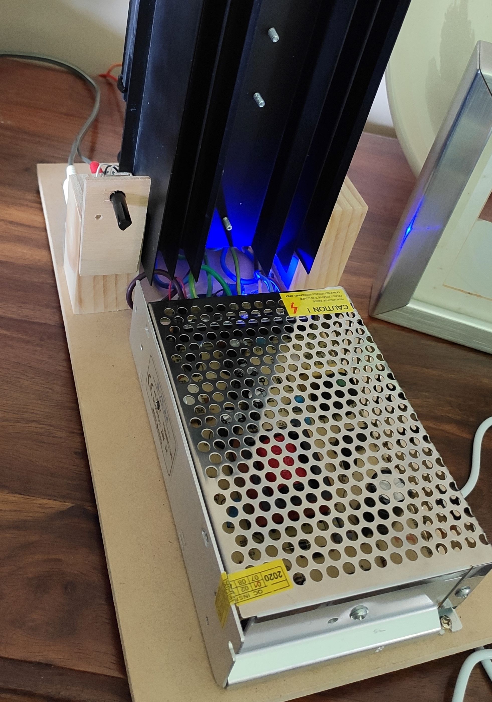

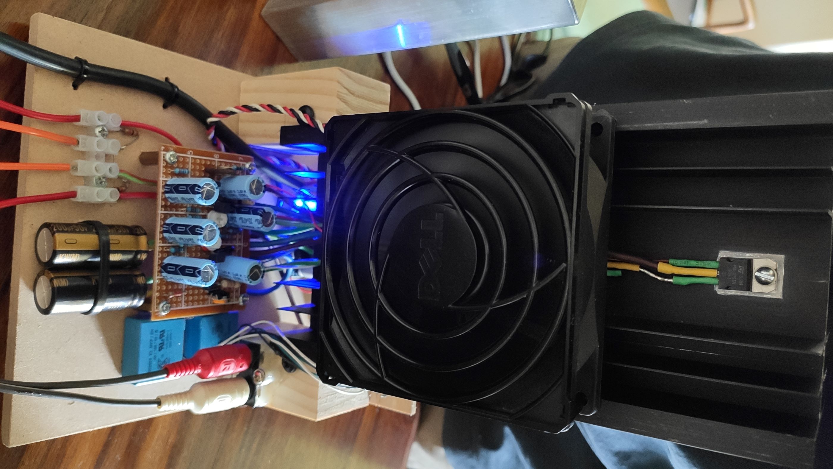

Here's the 1969 version amp I built over Christmas using BD911's, a ZTX450 and BC560. I wanted to build it fast and used whatever I had on hand, except for the audio grade output capacitors I bought earlier.
The BD911 TO220's were mounted directly onto the heatsink using old school mica and white thermal grease. There is about a 15c thermal resistance between the tab of the TO220's and the back of the heatsink.
The heatsink was largest I had at home, bought it a couple of decades ago, so can't remember its rating. Anyway, without the fan, the heatsink came up to about 75c on a 25c ambient.
The transistors were almost 90c, perfectly fine long term and sounded great (bipolar transistor gain increases quite significantly with temperature). I was more worried about the PVC insulation of the connecting wires and nylon washer I used to insulate the mounting bolt, so I put in a cooling fan pulled from an old PC. That dropped the temperatures down to a more reasonable 56c at the transistor tab and 41c on the heatsink directly at the back of the transistor.
I used an 24V/3a switching power supply I had lying around, trimmed it up to 28v and biased the amp to 1.1a/channel. (The speaker I am driving is a shade over 8 ohms).
Very happy with the sound. I thought the switching PSU was going to be noisy, but heard only very faint switching noises with my ears against the speaker. The loudest is the fan, that was pulled from a retired server, so its bearings probably had a hard life. I've got a super quiet magnetic levitation vapor bearing fan on order.
