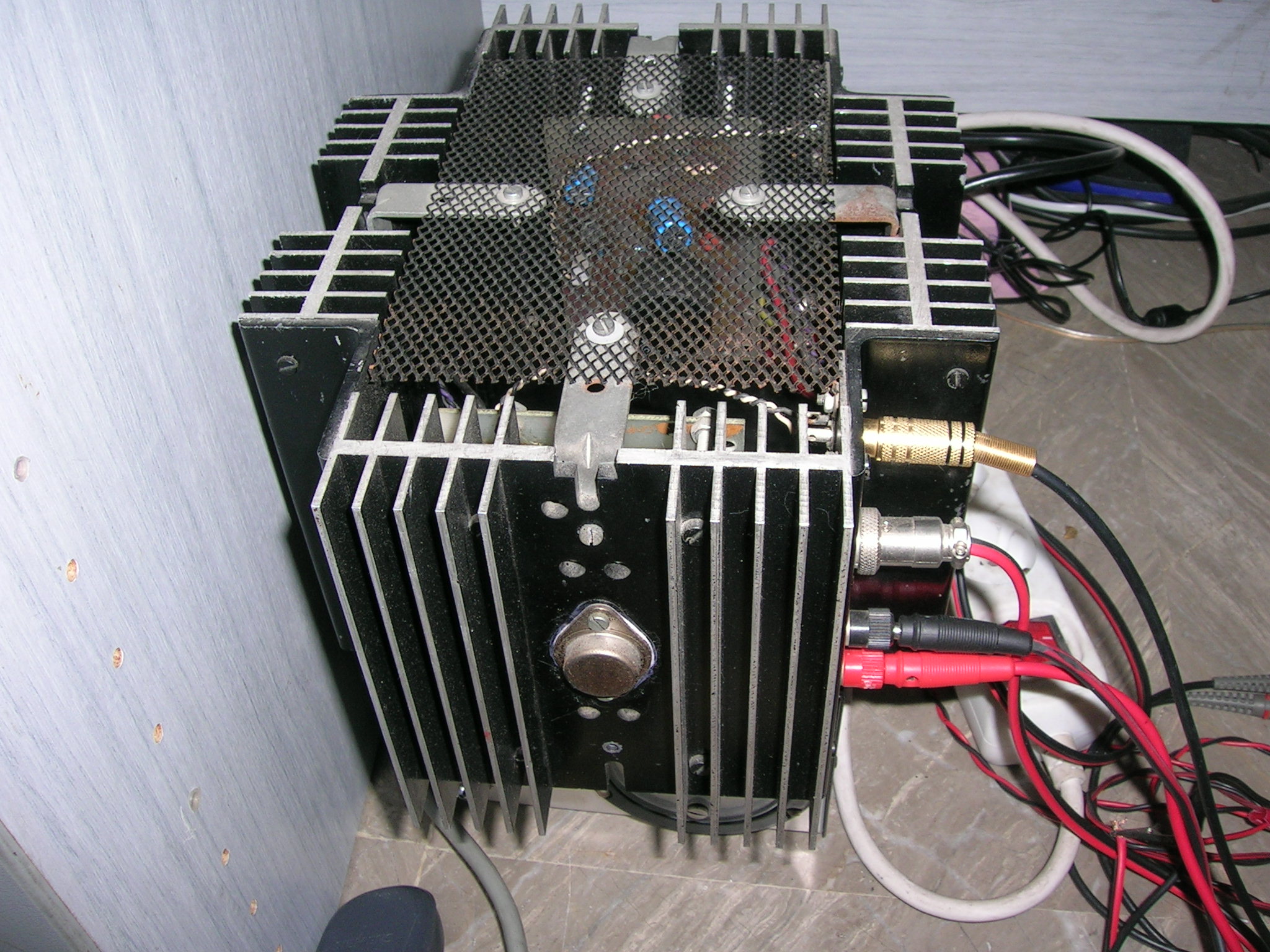

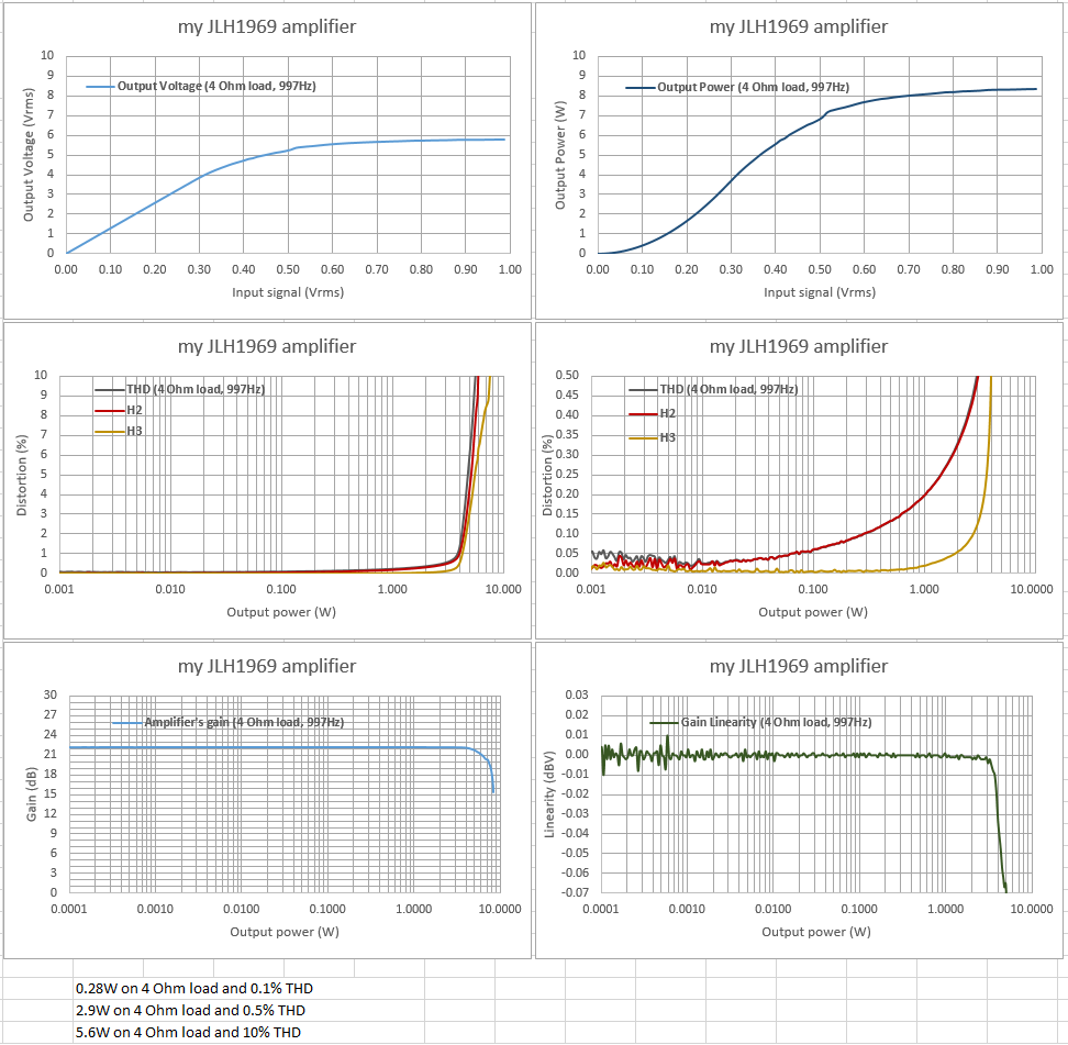

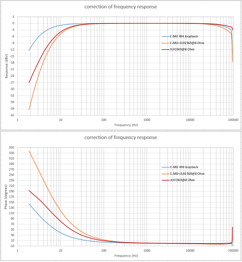

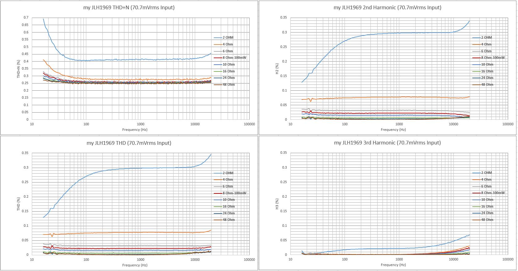

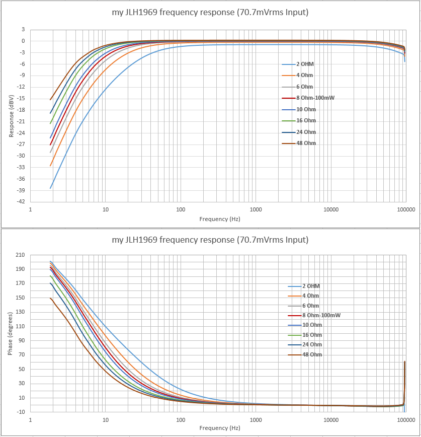

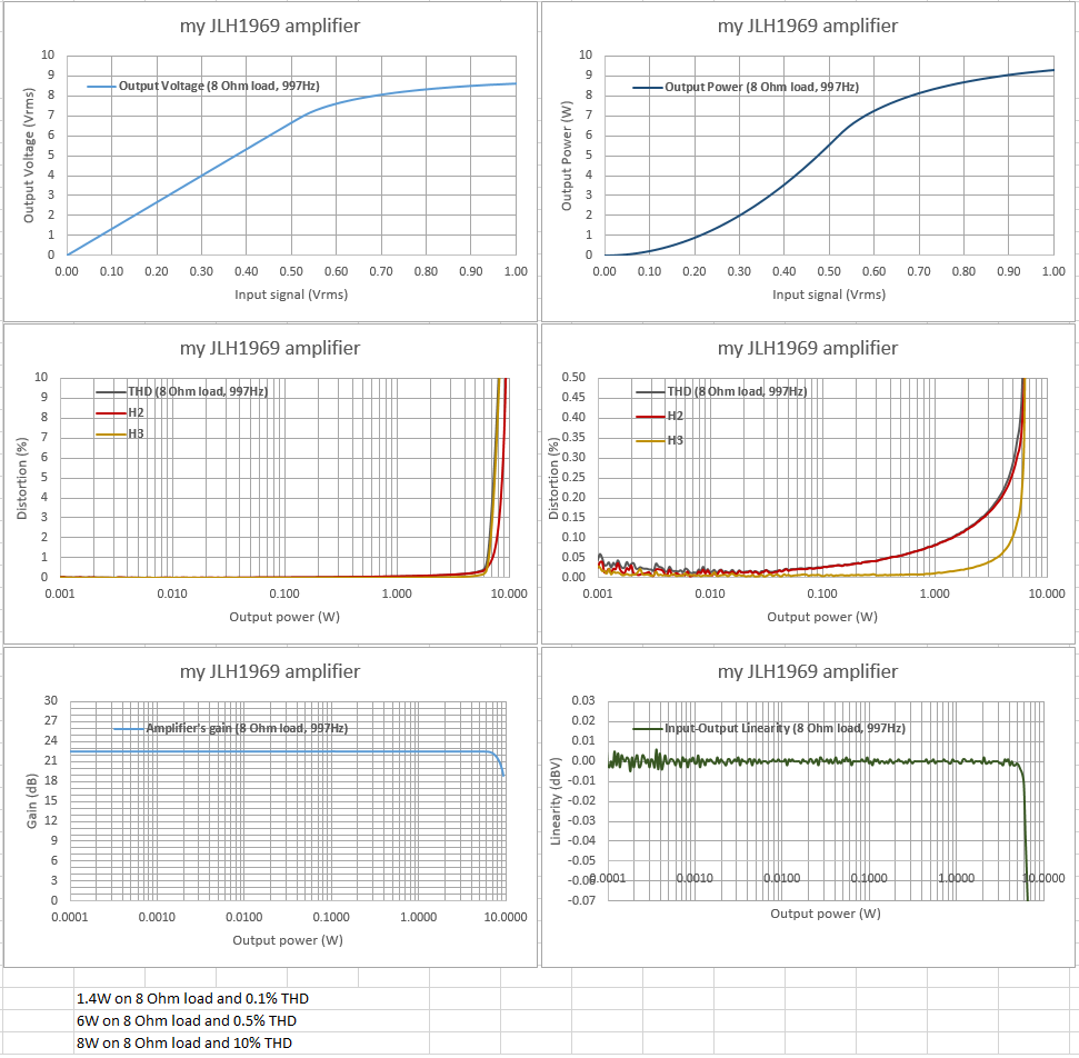

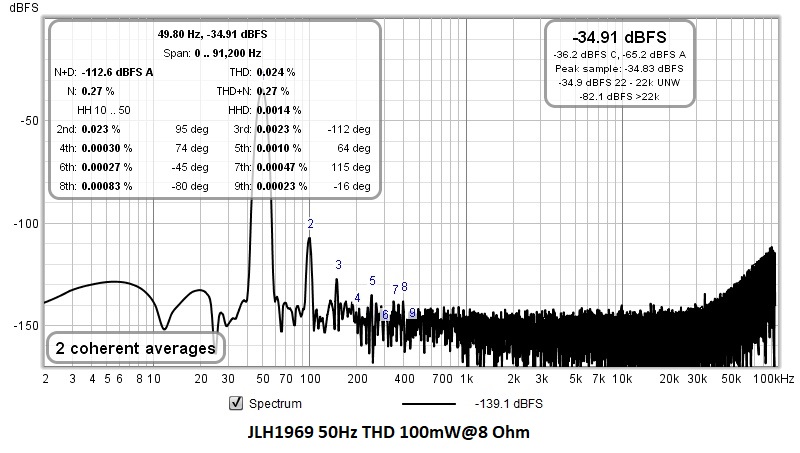

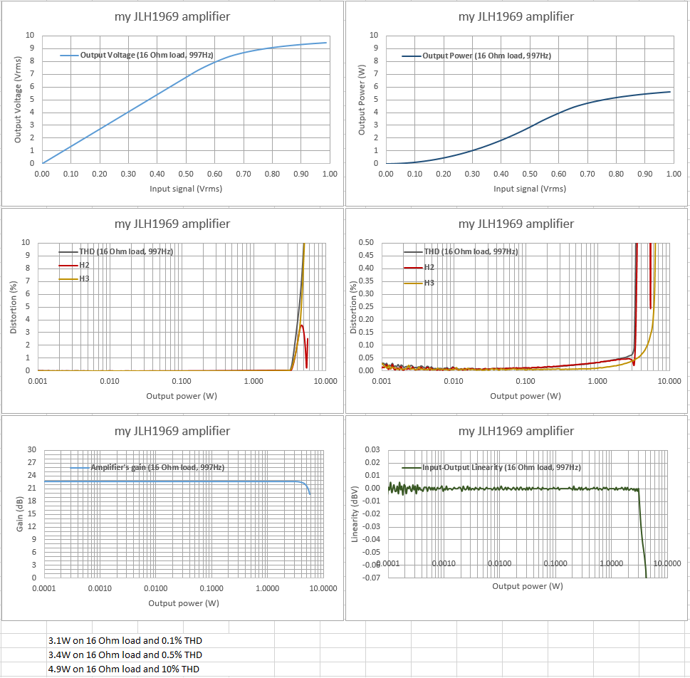

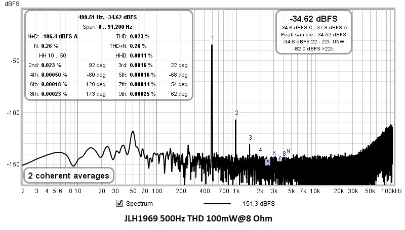

This is how my JLH1969 built about 45-47 years ago measures today (I am in the process of verifying the performance of my amplifiers)Wonderful to see revived interest in J. L-H.'s design and that it has stood the test of time.
Simple designs are often the best!
BC212 (Siemens), BC 140 (Siemens), 2N3055 (Motorola).
1uF MKT input, 470uF bootstrap, 2200uF output (capacitors are some 15 years old).
1 Ampere per channel at 24Vdc
George
