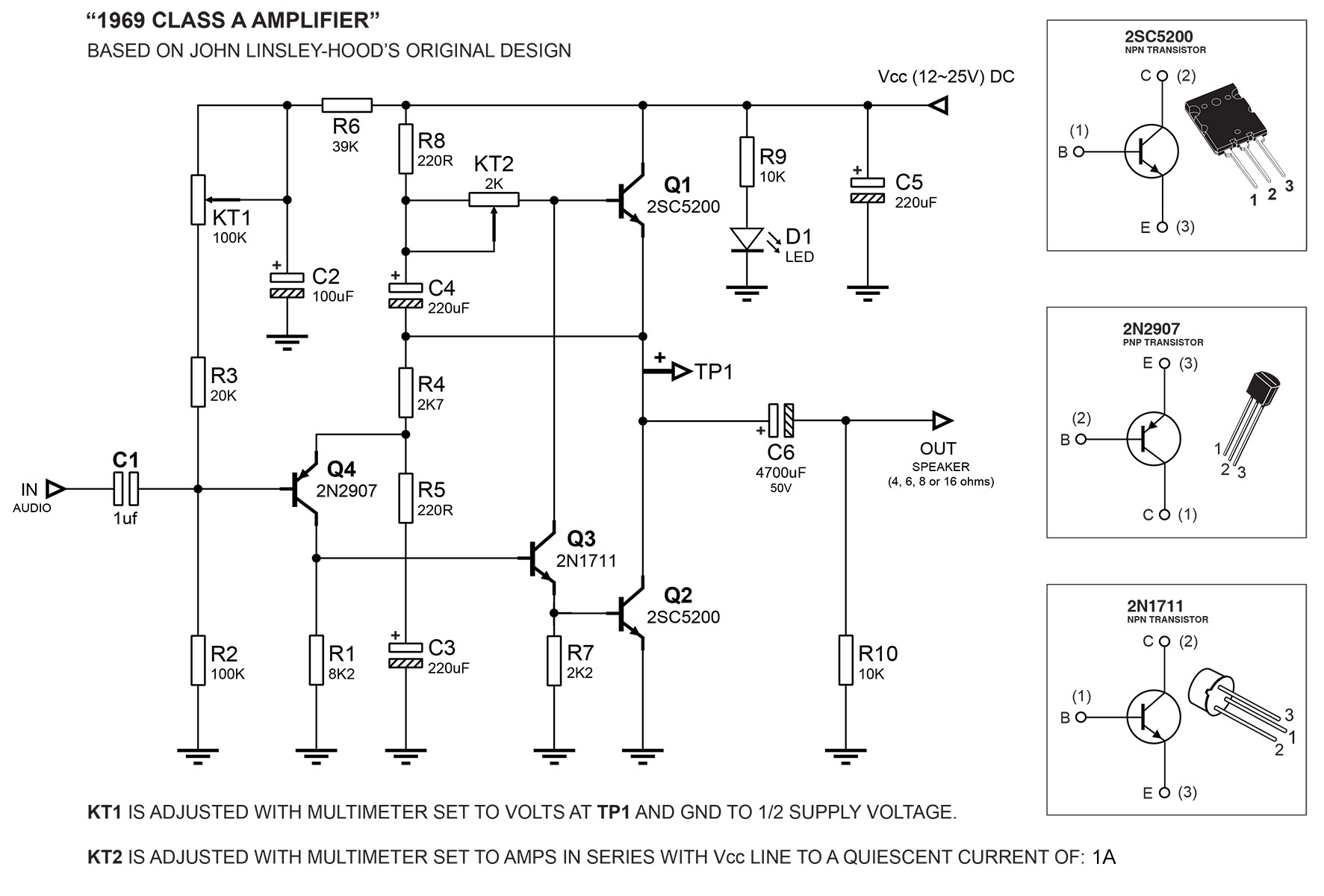

Q3 and Q4 - others components
Referring to the attached schematic for the white board, you mean R8 and KT2?
So with a desired Iq the total resistance of these could be replaced with a potentiometer with this new resistance (let's say it exists in theory), and the wiper on the potentiometer connected to C4?
I'm I understanding you correctly?
So, the sweet spot I'm seeing is not due to the Iq (as I suspected) but due to the balance between the output transistors, cancelling the 2nd harmonic?

Hello Rallyfinnen, I set up a circuit just like yours. but I didn't find the components Q3 (2N2907) and Q4 (2N1711). Can I use these instead: Q3 = BC559 and Q4 = BD139?
Thanks.
Att. Tiago Sierra
I cant remember this circuit, must be some time ago? At least I think the BD139 is not so good to use, I remember I had problems with high Cob using in other applications. BC559 could be ok.
Try to find something that is high Ft and low Cob I think. There is a lot written here, and a lot of circuits published. Have a look at those to see what transistor combinations have been successful.
Others will know more about transistor selection, so maybe they can give you some more advice.

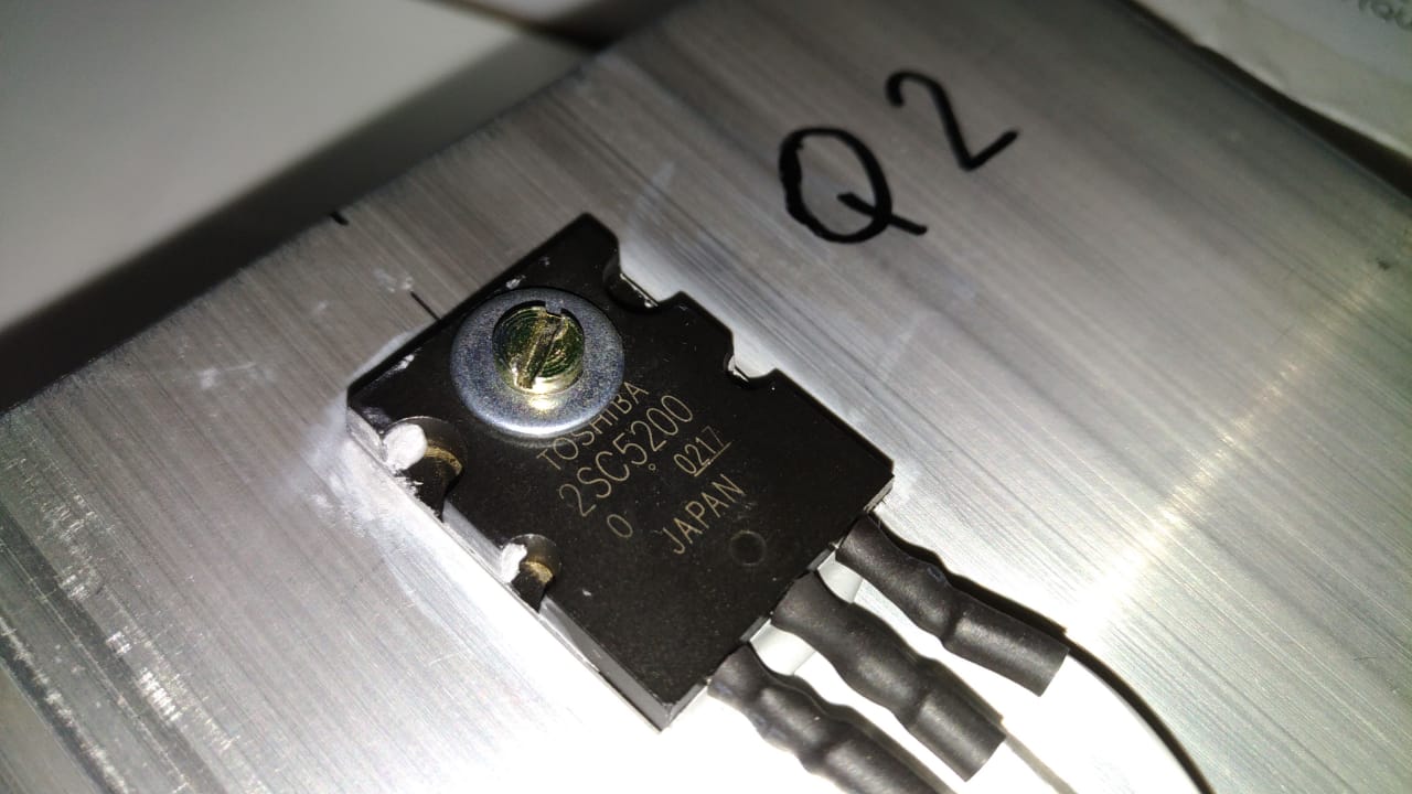

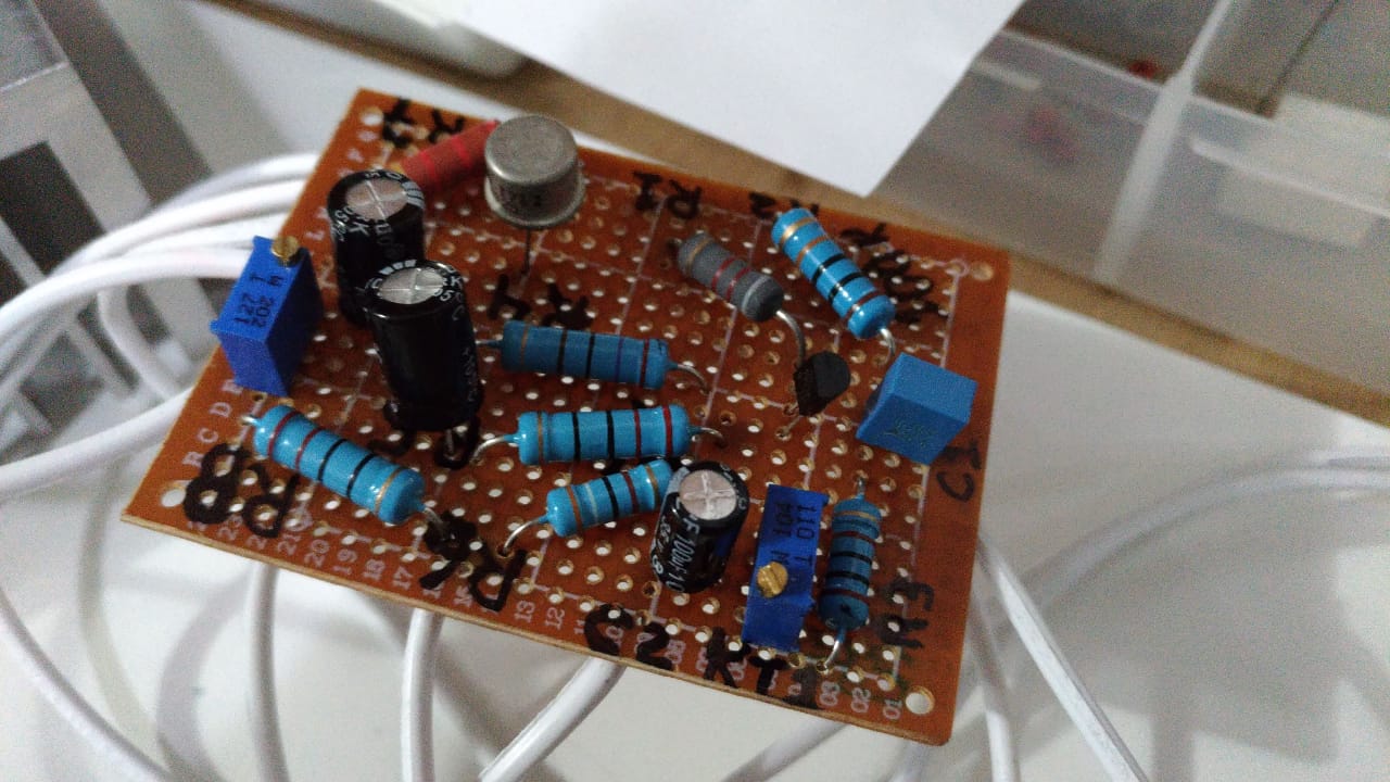

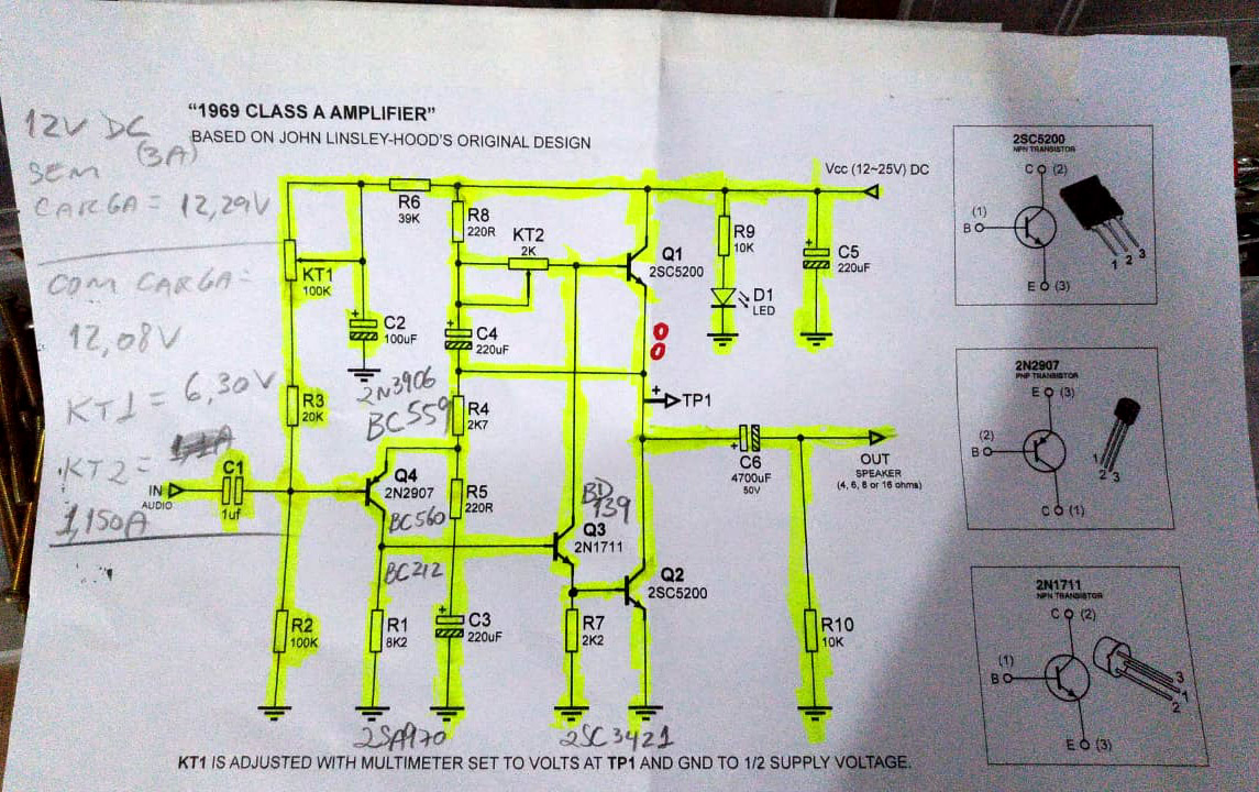

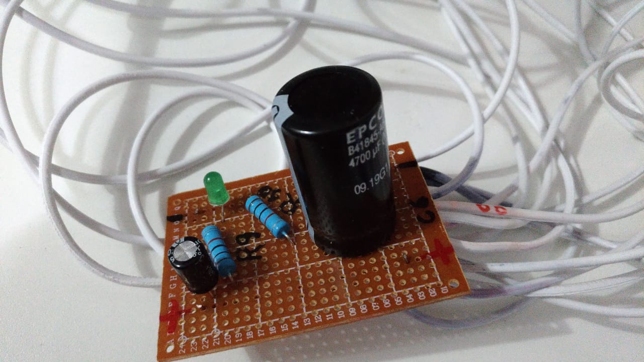

Hello guys, my name is Tiago Sierra, I'm 37 years old. I'm from Brazil. I'm an electronics hobbyist. I'm assembling my 1st JLH 1969 with DC 12V power supply. SONY speaker 4 "(6 ohms).
Follow the attached photos of the circuit and diagram. I still don't know for sure which IQ current: 1A? 0.5A? 1.25A? Can someone help me?
I would like to know if I need to change the transistors Q4 and Q3.
Q4: actual 2N2907. Or 2n3906, BC559, BC560, BC212 or 2SA970?
Q3: actual 2N1711. Or BD139 or 2SC3421?
Thanks.

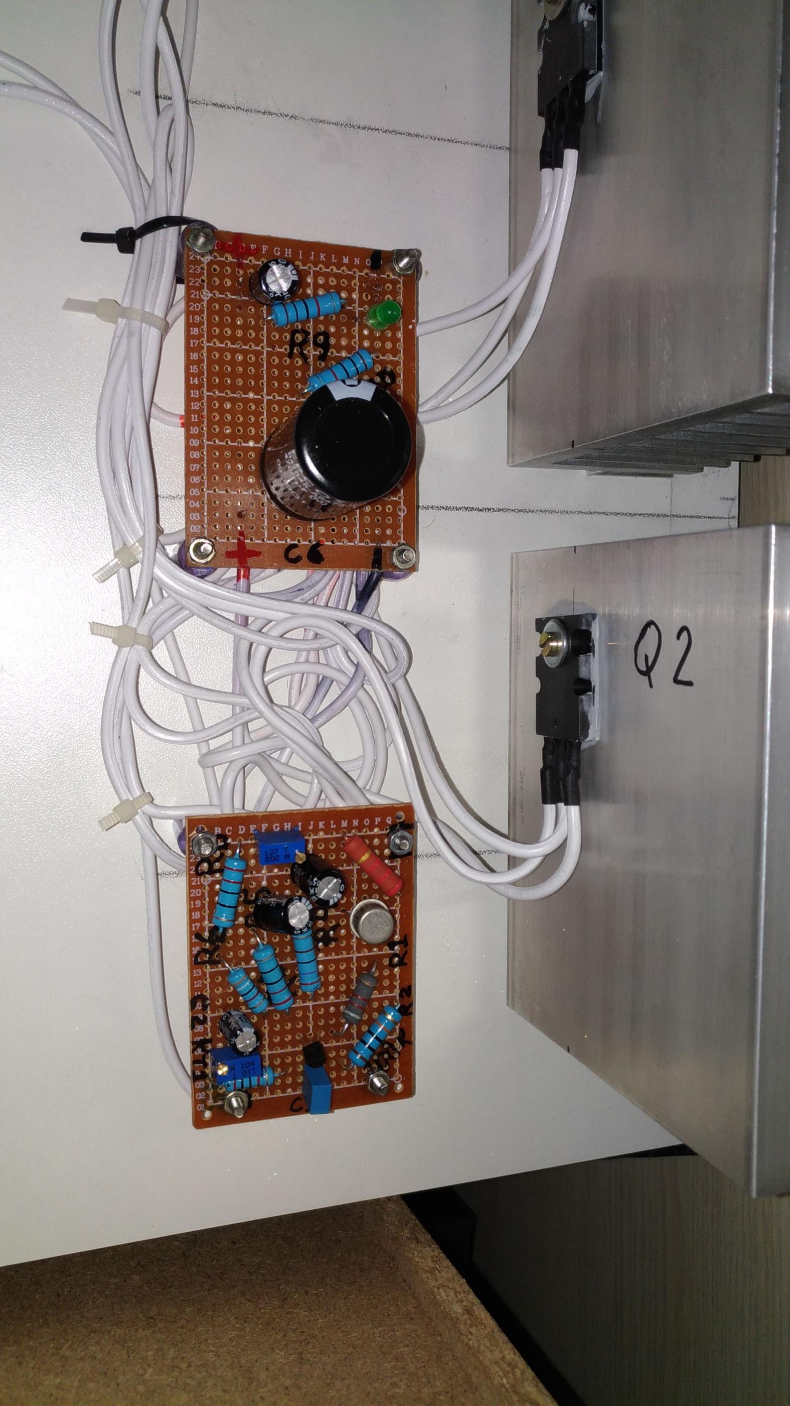

Tiago! Long wires Q1\Q2 - may be self-excited. At 12V, the current is 0.5-0.6A. Output power 2W / 6Ω. Transistor Q4 PNP, Q3 NPN general purpose TO-92. The pinout can be different - carefully. The input wires are separate. Better twisted pair or shielded.
Gold transistors won't give the best sound 🙂
Correct installation, correct positioning of wires, correct setting
Audio Better!

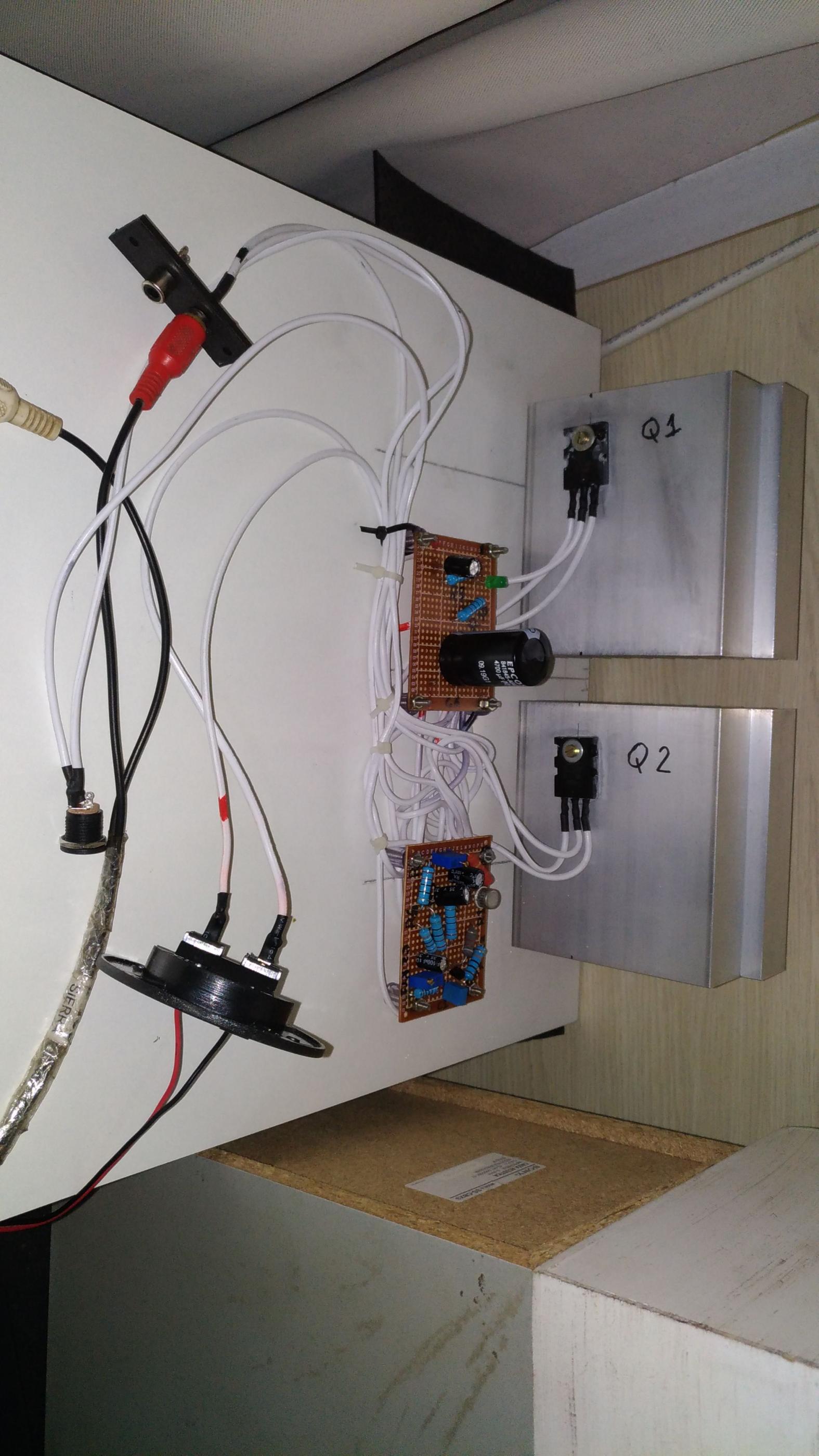

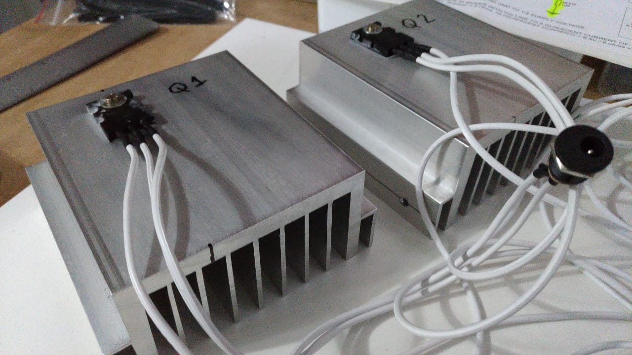

Hi, OldDIY.
I shortened the wires, and organized better.
Sound is cleaner and much less hissing when it is muted.
I plugged the amplifier into a 19V DC source.
KT1 left with 1/2 = 9.5V
KT2 IQ? how much do I put the current? 1A?
Thanks.🙂

Hi, Tiago! Long wires Q1\Q2 - 10-15cm. Current 1-1,2A. Power 6W/6om.
It is better to place the radiator fins vertically. Raise the radiator slightly for better cooling.
Hello OldDIY, I used 1.0mm wires in the circuit. Do you think the thread is too thick for this project? 19VDC (IQ 1A). (JLH 1969 / 10W)
Do you think it would work for me to use 0.33mm wire in the entire circuit?
Thanks.
Tiago Sierra
Hi, Tiago!
There are no wires too thick - there are too thin ones 🙂
Use a shielded twisted pair cable for the input (you can use a cable for a computer network) or a shielded cable (microphone or television or interblock). Avoid an earth loop.
