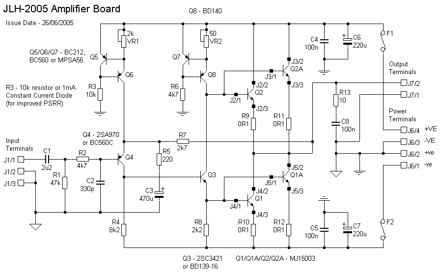

Right now I have completed this little but fine JLH project and, after fine tuning, this amplifier delivers quite a fine sound.
Actually, as I have later found out, the board I have used is an exact copy of Geoff Moss' 2005 design (well, with 2003 variation at R10). If you search this tread you may find Geoffs' post with complete documentation in a zip file.
The designer has included sections intended for PS decoupling and a filter consisting of a capacitor followed by a 10R resistor at the output. I have burnt that resistor twice while performing square wave testing at the maximum power and frequencies. These two features are quite fine and welcome addition. Without a signal on input you may hear just a graveyard silence at the speakers. Nothing, even with ears on the speakers. Like a dead amplifier - so fine it sounds, when silent.
I have performed measurements with 22, 11, 7.3 and 5,5 ohm loads with +-24.5V rails.

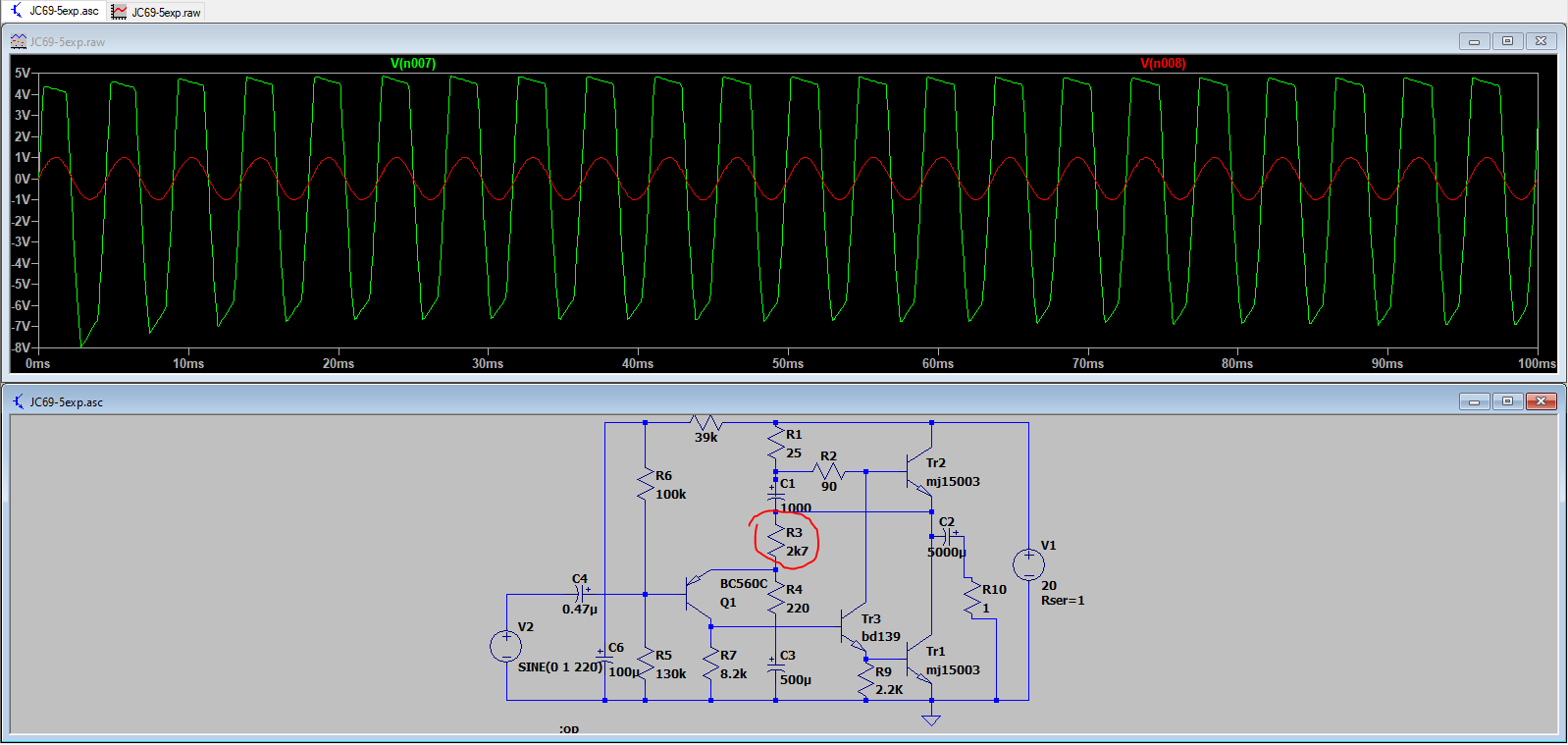

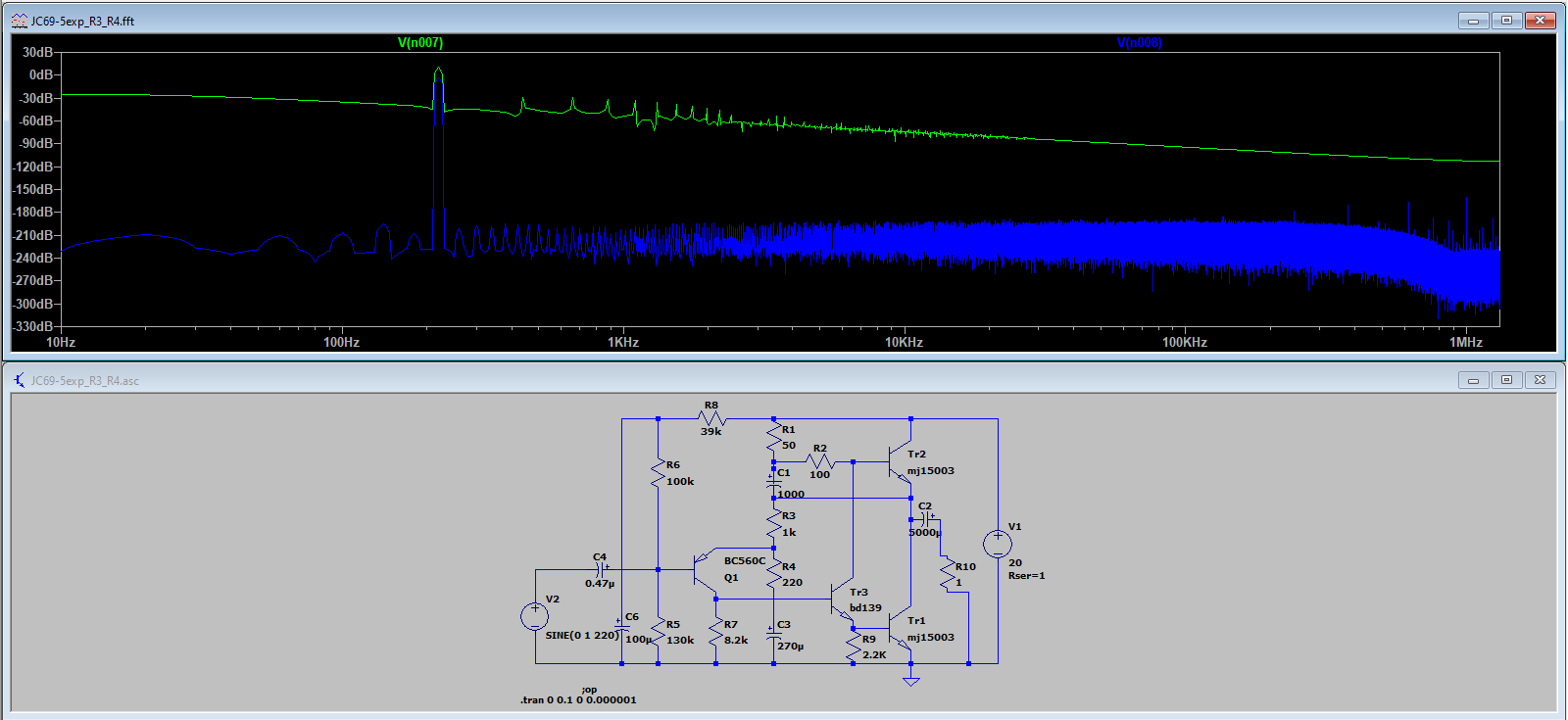

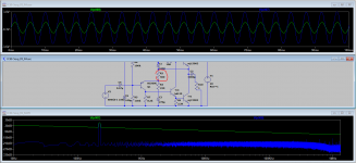

I've done a simple simulation in Spice. Just to visually check, if there is clipping on sine wave imput. red: V(in) +-0,3 V, green: V(out) +-3V, I(out) +-3,2, cyan: I(psu) ca. 4A.
Will build that and then measure if distortion is ok and if it is loud enough (though guess so!)
hope that works for you!
Dissipation very high - at least 20W if not more in each OP tranny.
You may want to increase the output capacitor - your sim shows (sorry to use this phrase) "first cycle distortion" which is just a limited RC response and really more of an attenuation. Perhaps you don't need a particularly low LF response, but for 1 ohm I'd say at least 22mF normally.
You may find that high gain output trannys like MJL3281A a better solution in this case, they're OK up to about 4...5A, but may need some HF compensation.
Parallelling transistors is not so simple though. You will need to add emitter resistors to make sure that the current is shared, perhaps 0.22 ohms to 0.33 ohms, depending on matching (perfectly matched devices might not need any - but then you need to make sure they are thermally equivalent too (same heatsink and mounting thermal resistances etc)).
The emitter resistors introduce additional voltage on the driver resistors (8.2k and 2.2k) which will increase distortion, so they need to be re-routed to the emitter of one of the lower output transistors (i.e. above the emitter resistor).
My guide for choosing the feedback resistor is to set the "grounding" resistor to the emitter impedance of the input transistor. Depending on the current, this is about 80 ohms in the original or perhaps 60 ohms for increased current with low bootstrap resistors. Suggest 56 or 68 ohms. The feedback resistor should then be 560 or 680 ohms or one notch up for higher gain. (Note that JLH's 220 ohms is way above and aids HF stability!)
As this will affect HF performance by increasing the input stage gain - this is not a "simple" change either. To benefit from the lower feedback chain you may need hf compensation once more.
If you can get the power and distortion you need from a single pair that would be my advice, but parallel and lowering distortion may need some tweaks.
Partly why I suggested MOSFET outputs as it seems you could (but I've not really explored this in detail) get the power and current you need - and a better frequency response.

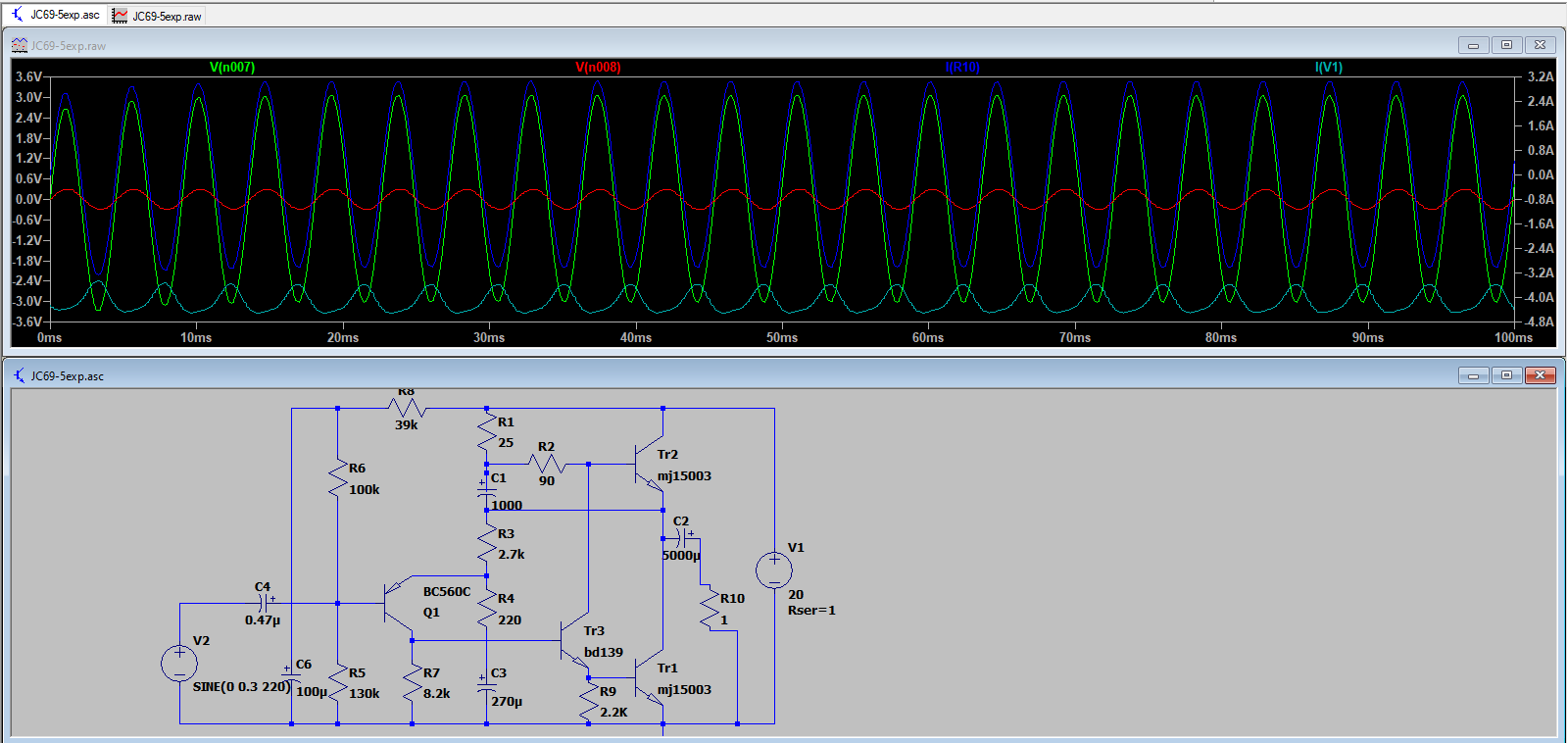

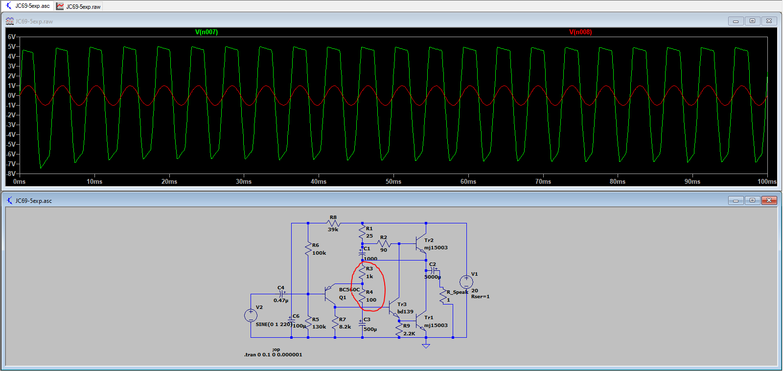

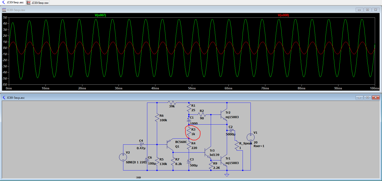

JLH low impendance 1 Ohm Version
Reply: #7516, #7517: Thanks Old_DIY and John_Ellis. I calculate 20V*4A about 80W heat dissipation, mainly through Tr1 and Tr2. Means about 40W per Output Transistor. Thats the amount per OutputTransistor I got with my other JLH GM 2005 build prob. the max. which can be cooled with normal means. I want to avoid paralleling since it is much much easier to match 2 Transistors than 4, and also because of this thermal sharing problems which you mentioned. Also I want to avoid current sharing resistors, since they are already in the range of the speaker resistence and will themselves waste another lot of energy (and lost musical information?). Also want to avoid more parts etc. Want to keep the output Capacitor, to avoid any steady current running through the "ribbon". Want to keep the MJ15003 since I(max) = 20 Ampere and I was lucky and all I got had Hfe > 100.
I will directly attach the amplifier to LineOut of the Soundcard, which has a max swing about little less than 2V. Compared to the last version I've again increased V(in) swing from +-0.3 to +-1V (supposed to be upper normal listening level). See Screenshots: First Clipping, then after adjusting R3, see reduction of voltage amplification and clipping. red: V(In), green V(out).
I just have basic understanding of electronics from school and know what the single parts do, but I can't get deeper into the complexity of the circuit (sadly!).
I've done this change on R3 / R4 just by testing. My idea was, that the bc560c should get less voltage and thus do less voltage amplification to pass over to the other transistors. I think this did increase Feedback? I think anyways it should work. Probably will build it this way!

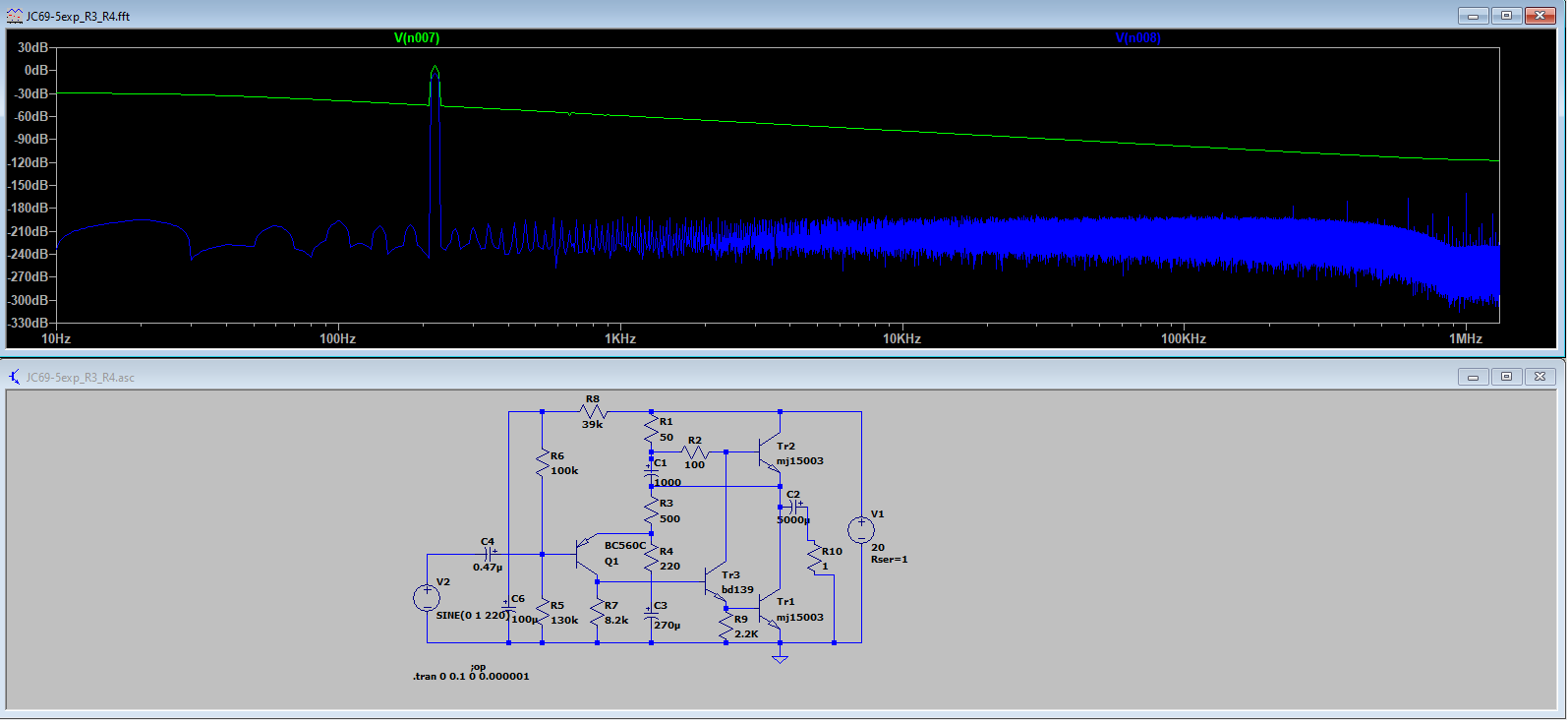

FF Post #7518: so far the simulation. Thought it was more difficult to use LtSpice: right click on the simulated traces: view -> FFT -> select V(in) V(out). Did further adjustment to R3. Anyway this tool helps a lot to try and investigate and make decisions. At least I can better understand which changes will affect the circuit in which way. Surely it will need some adjustments in the real setup depending on the actual values mainly of the transistors ..will see how close it got to reality!
