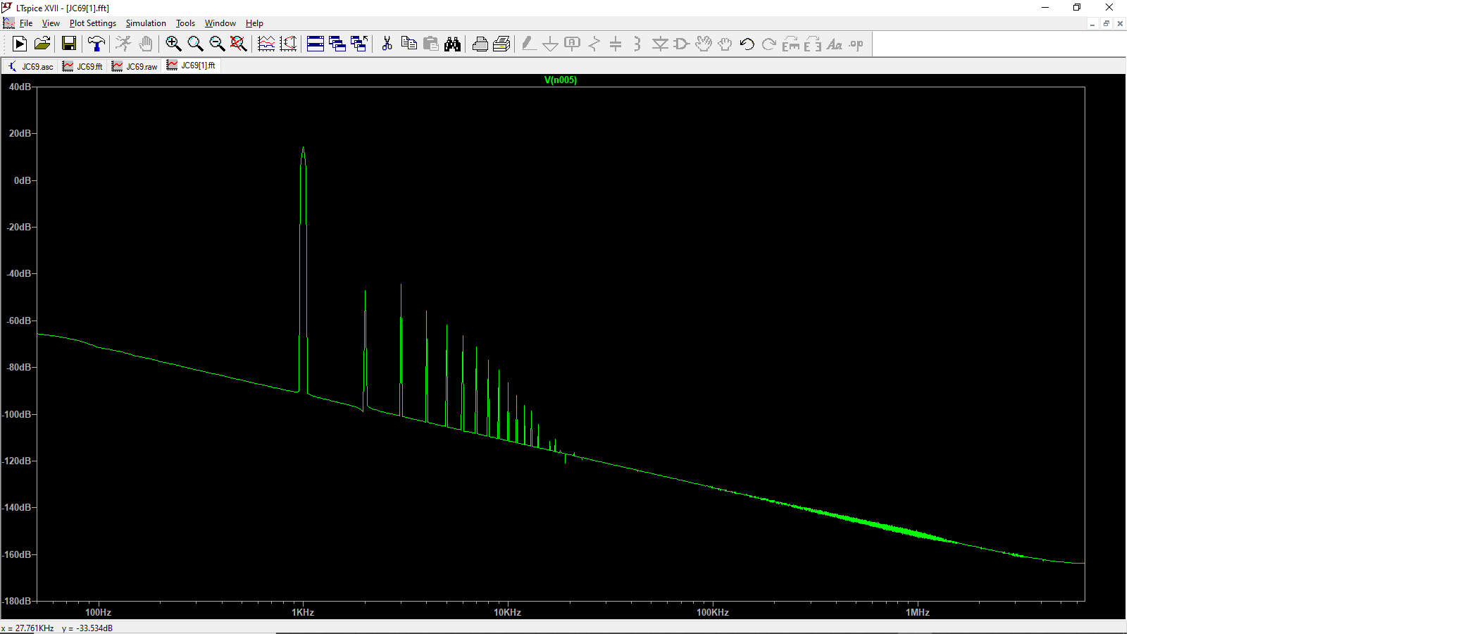

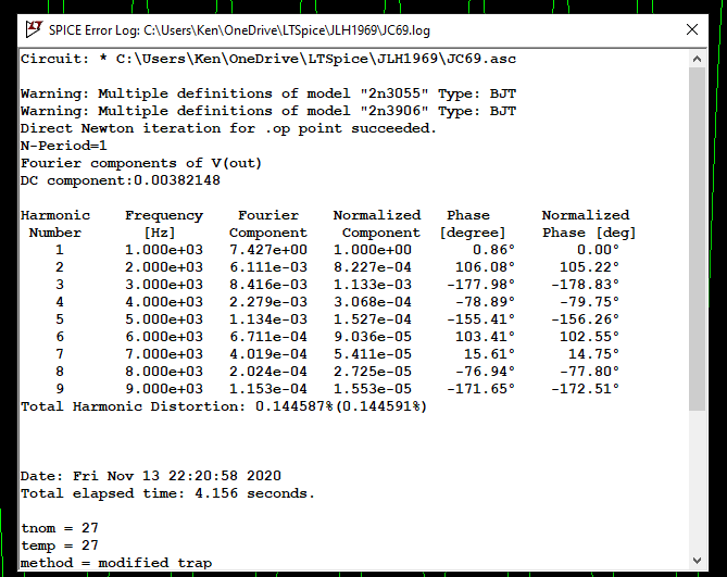

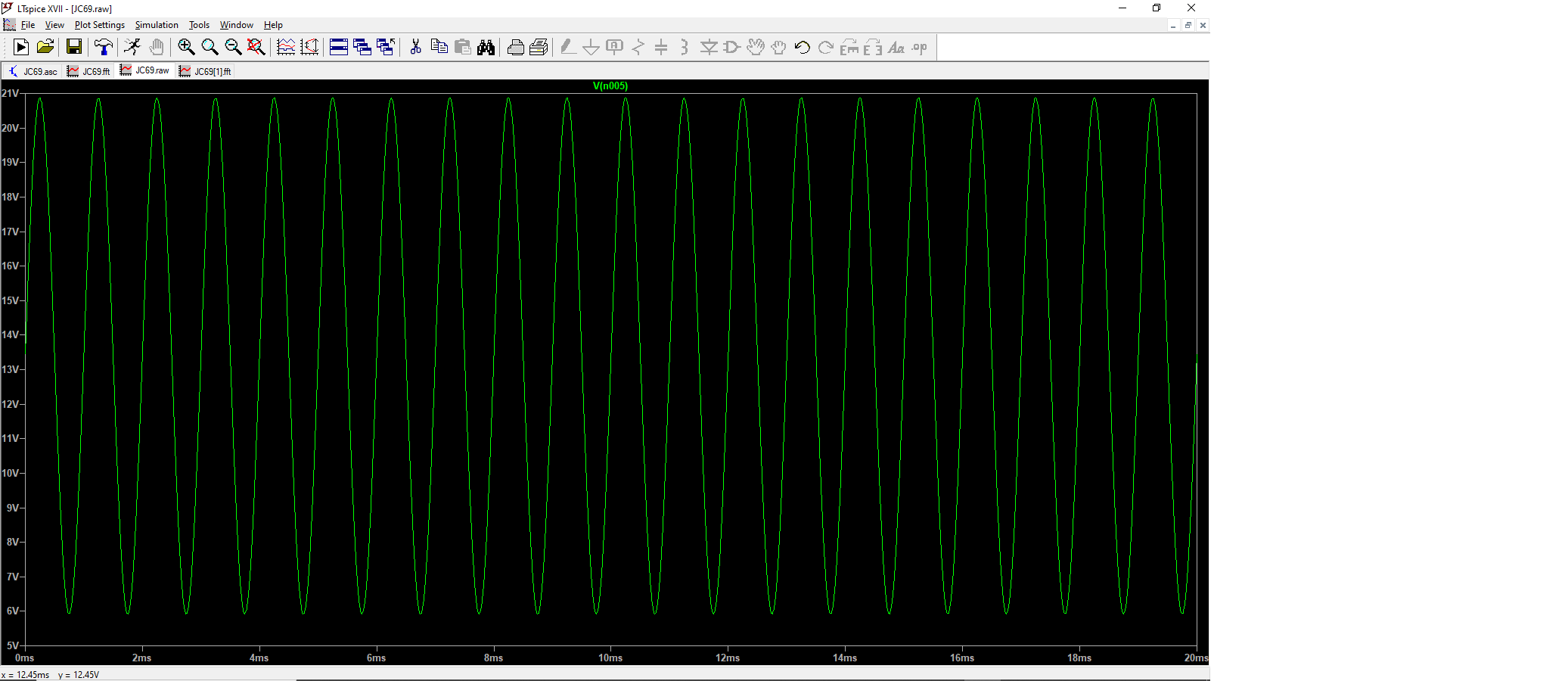

I installed and got LTSpice running today with fair success. It went more smoothly than I was expecting.
What JLH LTSpice simulations do you have that you would be willing to share and post (and models)?
I have built the miniJLH with TIP41C, then TIP35C and another with 2SD1047. When the boards arrive I will be trying the JLH2003.
Some simulations would go nicely with the experiments/modifications. Things like distortion and stability would be nice to look at.
I found a JLH .asc file on the internet and after a few adjustments I have basic Vout and THD simulation results. It is just a rough start to get going with LTSpice today. I will later update to match a real board I have.

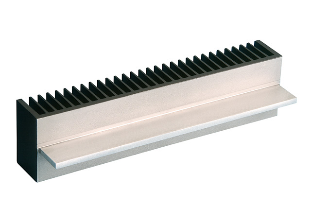

Ian - those heatsinks are ideal tfor TO-3. Also I suggest for plastic packages. If you mount plastic devices on a flat heatsink you need M3 tapped holes. I've never found M3 taps mechanically robust in aluminium. I've found it much more reliable to use screw + nut on the other side. So I suggest that type of sink is also ideal for plastic.
If you prefer to keep devices "flat mounted" industrially, devices are clamped using a metal bar or clamp over the top. For that option I'd probably use a flat alu bar, use countersunk M3 screws to bolt the devices down and then bolt the bar onto the heatsink, using what seems to work for me are M5 screws and threaded holes.

Two Ls back-to-back indeed form T, but at some cost: this forms yet another heat resistance plane between two surfaces thus reducing overall heat transfer.
Aluminium profiles have to be purchased in a shop for metal supplies. They have much better prices and more choices.
Even though not perfect, from the above mentioned reasons, this seems to be the best practical solution. I have found 3m long, 80X80mm L piece, 6mm thick that costs 36EUR with VAT included. Back-to-back configuration does not double the heat transfer but helps a lot to enhance an overall effect. Now, two surfaces cover 180mm of the back of the heat sink and increases the heat transfer. More important, a cross cection of heat transfer doubles as the thickness increases from 6 mm to 12 mm. Such configuration isn't just practical but also aesthetically pleasing.
