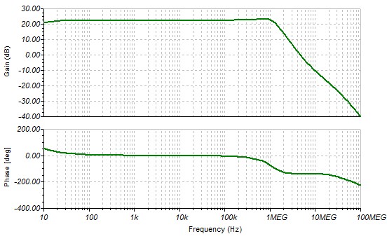

Lately, I simed the Dual cv30 and I was surprised to find exactly the same distortion curves both 1khz and 10khz given in the manual.
Here is Tina file.

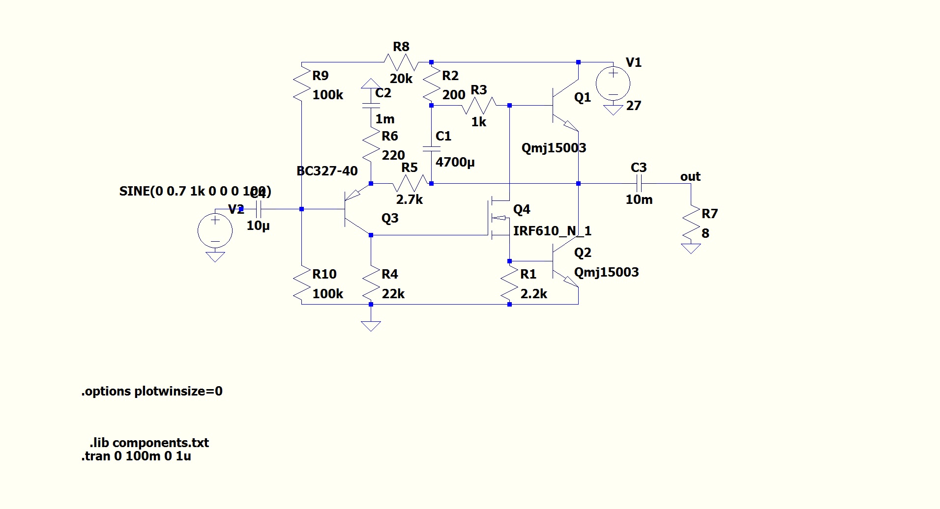

@kokoriantz - I don't get your low distortion figures with IRF610 driver. To get anywhere near close I used a 2N7000. Smaller device, less gate current needed (almost 1/10) and then only with a compensation cap of 10pF to stop a little oscillation. That used the On Semi /MODPEX model MJ15003.
0.09% at 9.5W/10kHz but also 30V rail. Think that the dissipation with reasonable gain transistors is within the power limit of the 7000 (400mW -maybe add a heat clip to it). 15003's in my sim only needed ~8mA in the 7000 = 120mW.

I see IRF610, not 630.
But a 630 is likely to be worse - 540pF gate capacitance instead of 140pF for the 610 and about 50pF for the 7000.
What makes the IRF610 lower distortion is the possibility of higher input resistance 22k instead of 8.2k. Higher open loop gain hence lower distortion.
I tried with C5200 transistors, the distortion is still lower to 0.012%.
I tried to sim with LTspice, I downloaded the most recent models. The mj15003 has too high Hfe, but on Tina it gives 0.015% for 5.5W. The model of IRF610, the LT doesn't read. I am a novice with this simulator, if someone can make it work. A similar but older model was used here IRF610 Class A Headphone Amp.
You have to enter the complete name of the component, as written in the .model = IRF610_N_1

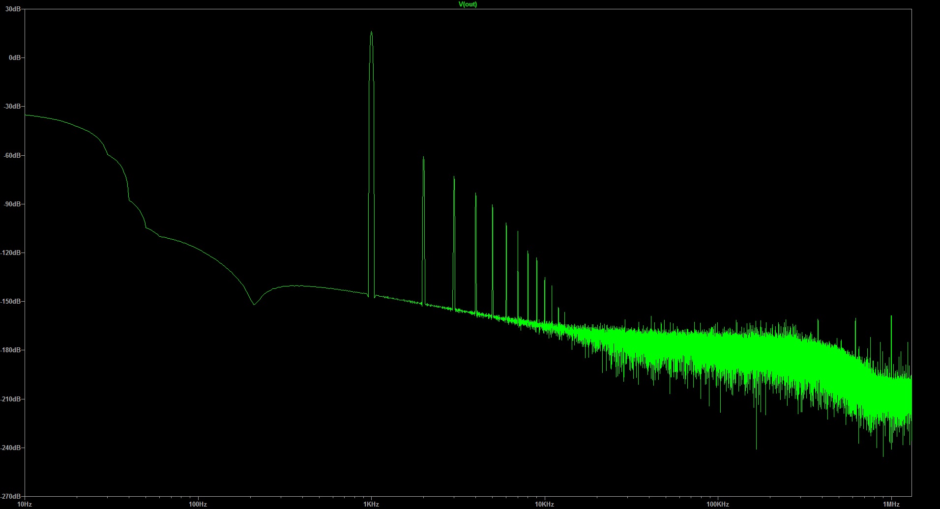

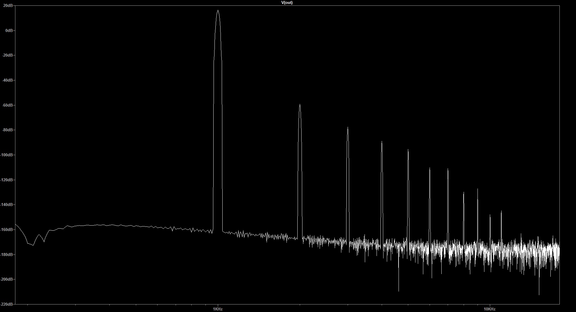

I did a quick test, and get 2nd harmonic @ -76dB like this (falling higher harmonics).
Remember to disable compression in the control panel.
EDIT: calculated wrong, I wrote -86 first. Can probably be tuned to better performance, this was a quick test.

This model is what I got from Tina netlist. Why the long one is not recognized, it saysYou have to enter the complete name of the component, as written in the .model = IRF610_N_1

Here is what I got with your standard circuit. Same distortion performance. I only improved the current sharing between the outputs (and better LF performance) with my tweak, so it should give more output current compared to Iq.

I reran my simulation with an IRF610 at 1kHz and 700mV input, and get -70 something dB second harmonic, and .055% THD. (Default plot is in volts in SIMetrix).
My earlier comments referred to 20kHz and near clipping output (9.5W) with 935mV input.
Yes, I noted the change to 22k and included that in my original FET sim.
That is somewhat high, I think, and suggest it needs to be lower as the average current was about 300uA in the original, but only 220uA in the 610 circuit. Gate current in the 610 at 20kHz is almost all the 200uA (400uA p-p) and that generates the high distortion.
- the subcircuit name also has to match if it is a sub not a .model file.
