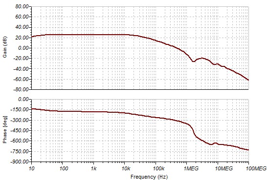

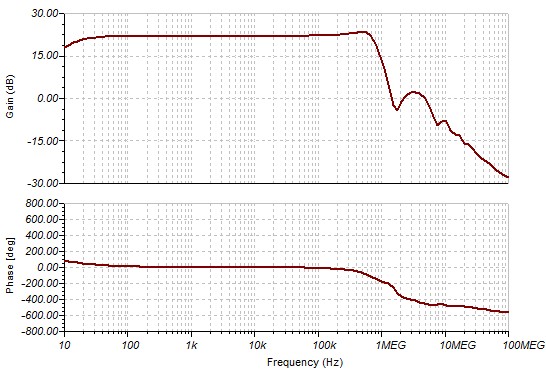

-I posted some stability simulation of my PNP version here a couple of weeks ago. Look at Sandro's tutorial for help how to configure it for your NPN. 3.2. Measuring Loop gain and Open loop gain in LTSpice - Audio Amplifier Design Fundamentals - YouTube

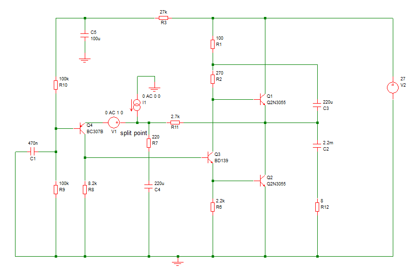

I don't have an LTSpice setup but here is a possible configuration for running a Tian probe.
The component values are set for mid rail (the 39k bias resistor is now 27k) and 1.25A (R2=270 ohms) for the 2N3055 models used.
I'm sure that the video Rallyfinnen refers to will go through the details. Essentially run two sims, first with the voltage set to 1.0, measure the voltage at the split point V1 and current through it, I1; then set V to 0 and the current source to 1.0 and run sim # 2.
Measure the voltage again, V2 and the current through the voltage source I2.
LTspice will perform the calculation - given in the Tian paper or in a slightly more readable form in one of the explanation papers others have presented.
What I do is to run the calculation with a separate program and plot the result in Excel.
If you do that note that the voltages and currents are complex numbers because of phase.

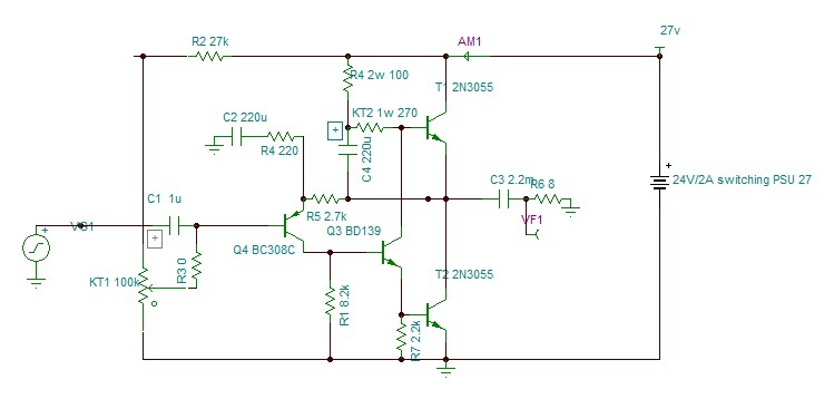

I did sim on Tina the JLH. The 2N3055, I have two models. The Motorola gives 1.5A bias with the given values, so I took a standard model with 1.2A.
I would like to note that at 9W the distortion is 1% at 1khz. It is advertised to be 0.05% 1khz -10khz to 9W , at 5W 1khz is 0.06% but 0.12% at 10khz.
I have also seen higher distortion figures than "it says on the tin".
First of all have you checked the models? If not try running some simple 1 transistor test circuits for output characteristics and fT etc. and see whether they look sensible. Are the Motorola models by MODPEX by any chance? Those are, how shall we say, not ideal.
Have you tried reducing the time step in the simulator? Distortion should reduce until some limiting value which may be nearest the truth it gets to. I usually find something in the order of tens of ns is needed for 20kHz and a bit longer is OK for 1kHz etc.
Given all that, then check the current between the two output transistors. With the old transistors the gain dips at about 300mA and as a rule (2N3055 epi especially) it needs rather higher currents but too high and the gain falls off the other side so distortion goes up again. Around 1.25-1.35A seems optimum for those devices. Ideally the currents should look similar but 180 degrees out of phase.
And also check the driver current. Inside the loop, distortion is higher, and that may show signs of clipping. I normally have to increase the supply voltage to offset that as well as optimising the current.
In real life quasi-saturation will cause actual distortion near full output as the gain drops at low Vce, so that really needs a couple of volts higher on the PSU per half (i.e. 4V for single ended), but depends on the transistor. I suspect most of the models we are using don't have Q-S parameters.

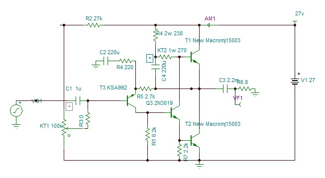

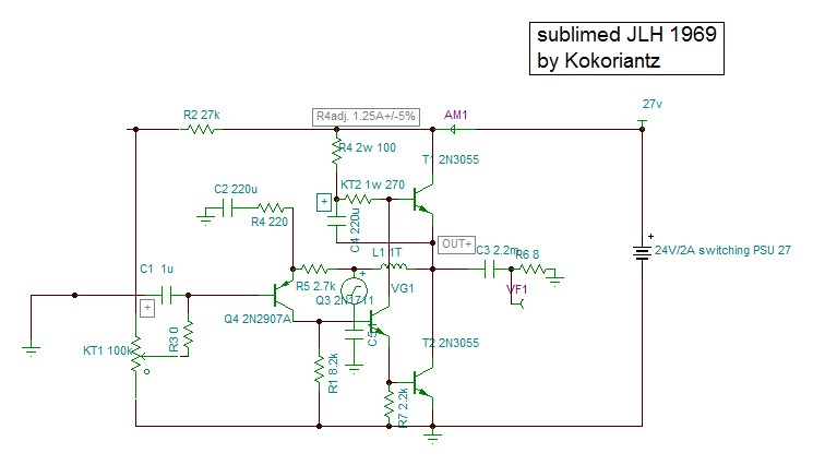

FWIW my simulation gives 0.29% at 9W and 10kHz using a 2N3019 and 0.23% with a BD139 driver, at 27V.

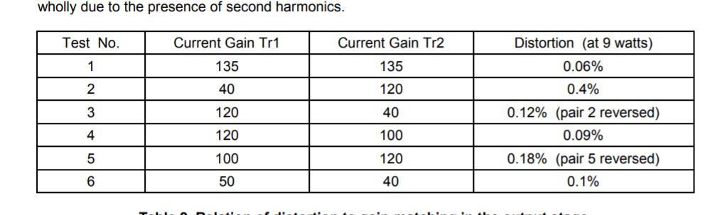

It's a real "classic" design in that second harmonic cancellation depends on the input stages countering the output stage residual.
The driver almost cuts off in my sim with a standing current of 17mA, and going as low as 1mA. 10W shows the need for a higher voltage.
Higher currents start to give a smaller deviation, and therefore are more linear (or perhaps less non-linear is a better description), and has less distortion cancellation.
I have not simulated the 1969 design. The emitter current minimum for the driver transistor in the 1996 version using a constant current load is 10m.A. albeit this runs from +/- 22 Volt supplies for 15W into 8R.
In this setting the 2N3019 performed better than BD139 for THD. The former has a minimum fT of 100MHz with a maximum of 400MHz.
At 20k full power this gives room temperature THD of 0.15%. In operation the power transistors and the driver junctions will be far hotter, increasing loop gain for improved results.
Room temperature Tian stability margin results for phase and gain were 45 degrees and 25dB.

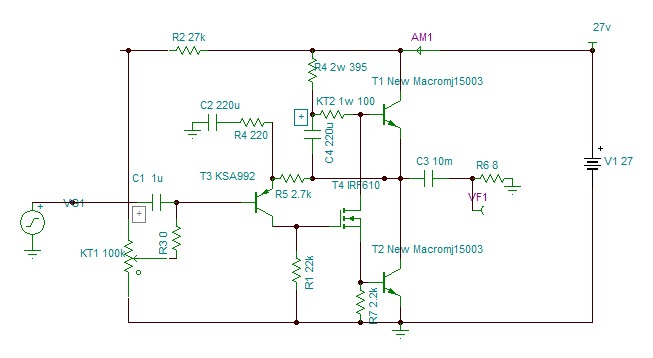

The distortion with mosfet driver passes from 0.08% to 0.017%. At 11w it is 0.05%.
With BC327/40 at the input it gives 0.015%.
Those look useful developments.
My sims gave higher distortion for MJ15003. Not looked into that but strongly suspect a bad model, I'm wondering if that is the MODPEX one. Sounds like the 2N3055 model "out there" is not good either, which will not help designing with that device.
I'm sure there was a thread here somewhere which discussed models and their accuracy. But I hold manufacturers responsible primarily - it should not be up to others (like Andy C or Bob Cordell) to have to make better ones. However model verification is time consuming so I'm guessing some manufacturers aren't troubled too much to allocate resource even though that should lead to more sales, and happier customers, eventually.
just had a first run with an IRF610 driver. Got much higher distortion. Seems to be the gate current which is comparable to the input stage current. As with all designs there is a fair amount of work to do to check.
