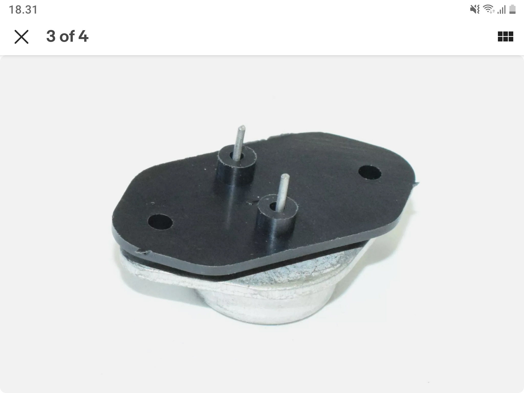

Transistors in TO-3 housing are difficult to install on a radiator. Thermal gaskets and bushings are required. The idea of installing output transistors on the intermediate profile and on the board is not very successful. Hot🙁

I intend to use two flat back 0.3 C/W heat sinks - I have already assembled KRELL KSA-50 in a simmilar manner. This time I intend to make my own plastic plate instead of bushings between the board and heat sink to make connection more stable and rigid.

Not sure yet, but the material shouldn't be too rigid and yet not too flexible, something like teflon or PE should be just fine. Below is a drawing from Texas Instruments "mounting Considerations for TO-3 Packages". Instead of washers between the PC board and the heat sink I intend to use a plate perforated just at the locations of mounting and pin holes.Teflon? Fiberglass? Carbon?
For Krell I have used just ordinary TO-3 bushings but I'm not satisfied because the board can bend.
Thanks Dude.Ebay item, vintage Philips Nos
That's exactly what I want.

Along with alumina TO-3 insulator this seems to be a perfect solution. Thansk again.
