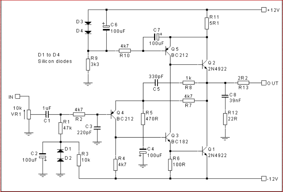

I think JLH may have made a slight error in the design. His headphone amp can be found on Rod Elliott's site The Class-A Amplifier Site
JLH uses a 4.7k in the feedback loop and on the base of the driver device. Since that sees the base-emitter voltage of both the driver and lower output transistor the voltage drop is about 1.2V. Therefore the voltage drop will be a little more on the feedback resistor. Adding the base emitter voltage of the input transistor makes 1.8V plus a little due to bias currents.
Therefore, the two-diode bias voltage ought to be three diodes, I suggest, to get the output rail closer to zero. As it is it would currently be sitting high by a diode voltage or so.

I'm not sure we are discussing the same circuit. My description was in regard of the one to be found on the TCAAS site which is hosted by Rod Elliott, and under JLH Headphone Amplifiers, circuit 1.
There is no tone control in it, and no means of adjusting the centre rail voltage.
What I wrote would, I suggest, still apply. Because the driver and lower NPN output transistor in the circuit I referenced amount to placing two Vbe's across the lower 4.7k base resistor, which is then replicated across the 4.7k feedback resistor. That therefore requires two Vbe's of compensation. Then, added to these is the third Vbe, the PNP base-emitter junction.
That requires three similar voltage drops to balance the junctions. So apart from providing a better balance, that should also provide a better thermal compensation.
I agree though that diodes are not the best match for thermal compensation. Transistors are always a better choice and not much different in price.
I did not see a Darlington device in the circuit I found, so I think that we must be thinking of different circuits. The two transistor ccs circuit you described is more like the updated 10W, not the headphone amp.
Rod Elliott pages JLH Headphone Amplifier
I have attached an image for reference purposes.
What JLH argued in the original article with the tone control was that a suitable input network forgetting the component values for the present would involve C1,R1, and R2.
The trick is to make the base voltages of Q5 and Q6 more negative than the emitters. Let's accept that applies with Q5.
The charge carriers flow from negative to positive ( opposite to the notion of current) thus once a headphone is connected Q5 will turn Q2 on electrons will flow as dc from earth via Q2 emitter to the positive rail if the lower circuit half is not providing enough electron flow.
It looks to me that the values of R1 and R2 were specified to allow a high input impedance for reasonable matching with signal sources including a relatively low value of 1uF for C1.
The voltage drop across R1 at 47k and R2 at 4k7 in series look questionable as sufficient to allow enough negative voltage on the base of Q4 if the reference is earth at 0 volts
That situation would change if the reference ground was below zero volts by the inclusion of D1 and D2.
If that doesn't do enough, since lower impedance reduces noise so one could reduce the value of R1 and perhaps R2 and increase those of C1 and C3.
With 3 diodes in place R1 could well need to be increased.

That was the circuit I was referring to (your post 7349). Before connecting a headphone, the output rail should be zero. Therefore, current will flow (I still use conventional current for general circuit descriptions) from the centre rail through R7 making the emitter of Q4 sit below zero. Since Q3 and Q1 require about 1.2V across R4, the voltage drop across R7 will be similar. Therefore, the emitter of Q4 has to be about -1.2V if the centre rail is at zero.
THerefore the base of Q4 has to be about -1.8V. I neglected the additional voltage drops across R1 and R2, which means we need -1.8V bias. That needs three diodes instead of just two (D1 and D2). Any voltage drop across R1 and R2 will raise the output voltage a little, so really it may need another diode - though I would recommend an adjustable bias of some description to set zero.
The quiescent current is set by Q5 whether or not a headphone is connected. The purpose of R10 and C7 is, I assume, to keep the current constant.
I would not design an amplifier which had a large offset voltage like this (as drawn) whether it is for a headphone or a loudspeaker.
Having seen your later post, 7350, it now makes sense that the Rod Elliott version needs the diode tweak, whereas the original has a tone control, as you mentioned. So it seems we were discussing different circuits.

Further Investigation
I did not build this circuit but waited for the RIAA circuit mentioned at the end of the article. This was able to drive high impedance headphones like the Sennheiser pair I had at the time.
Back on the main subject, I concede that your assertion about there being an issue with the circuit was correct.
For a rethink I adapted the .asc file for my a 1996 Class A power amplifier and tried I tried the three diode approach you mentioned. I found the circuit is finnicky and changing various component values was not making much difference.
In the end I reconfigured the dc offset adjustment and used the onboard library and Bob Cordells range of .models to source semi-conductors from what was available from these. I have not tidied component numbers.
In the new .asc file, R16 is shown as a 5k trimpot, the actual needs to drop around the same voltage as in a signal diode.
For that job 1N4148 might suffice or a collector to base shorted BC547B for that matter, however I think a trimpot will allow a range of adjustment to cover the inherent variations in semi-conductors of the same types etc.
