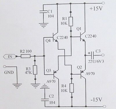

I'd think that the diamond buffer would work well. Though I would be tempted to use lower current for reduced noise, but that depends on the loading required.
Are Diamond buffers particularly picky with regards to supply noise and stability?

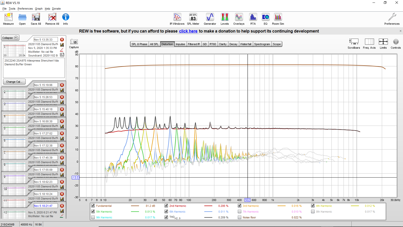

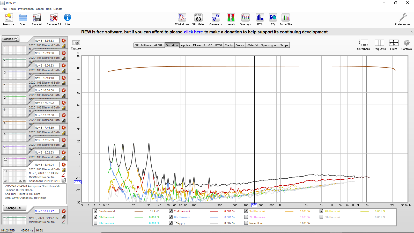

I ask due to the enclosed REW distortion measurements from my in-progress Diamond buffer for my JLH. The first distortion measurements show what I believe was instability and the second shows the improvement when a large (18 nF) cap was added from the 100 Ohm to ground. The third shows a big boost in the local supply bypass capacitors.
There is still what appears to be 60 Hz (showing up as 2nd harmonic of 30 Hz, 3rd harmonic of 20 Hz, etc.) The power supply is LM317/LM337 with bypassed adjustment terminals and large/good quality bypasses on the inputs and outputs of the regulators.
Out of the four types of transistors I have tried so far my best results are from generic 2SC2240 & 2SA970.

20201105 Diamond Buffer Distortion Add 18nF To Ground From 100 Ohm Input.png229.5 KB · Views: 556

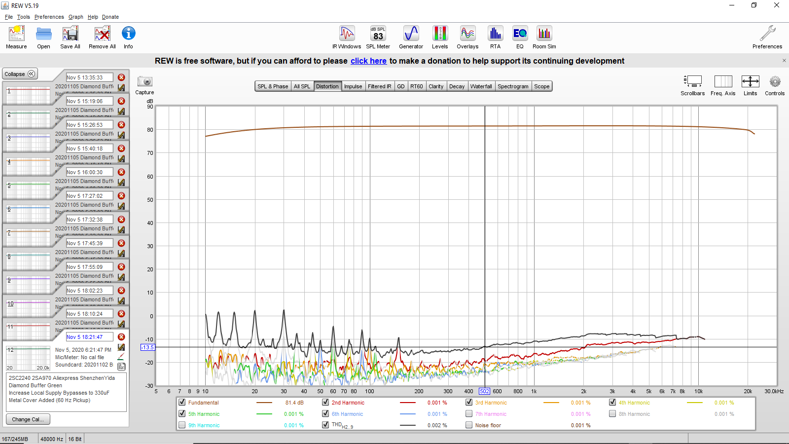

20201105 Diamond Buffer Distortion Changed Local Supply Bypass to 330 uF.png224.8 KB · Views: 706
Since the bias currents are linearly proportional to the supply voltages, I recommend you match the supply voltages |Vposrail| = |Vnegrail| to the same or better degree of precision as the R1-to-R4 matchng.
As you only need to balance the supply voltages, how about just adding a 78L12,79L12 in the appropriate supply rails with a diode or two and bypass caps for good measure. I don't think HDAM circuits have much to offer here in comparison to a diamond buffer and you would still need to balance the supplies.
Since the Diamond Buffer is running from LM317/LM337 already I was suggesting replacing R1 and R4 with current sources.

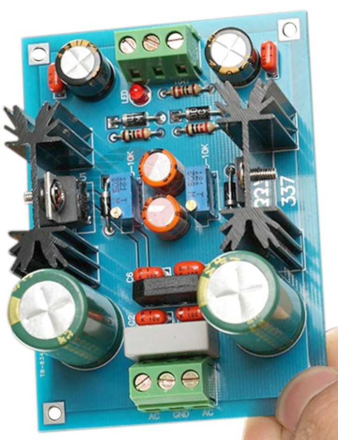

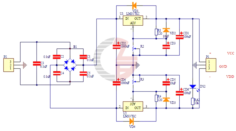

I think the LM317/337 is better than 78L12/79L12. I have attached the picture and schematic of the supply I am using. I originally thought my LM317/LM337 supply would be more than sufficient for this project.
I can try to adjust the 3296W trimmers again to match the supply voltages more closely.
Do I need to go further on the supply and use an op-amp for tracking? If that is the case would replacing R1 & R4 with current sources/sinks be more effective?
I've always wanted to try the famous Jlh 1969 - now it's almost ready in my test chassis. Input transistor BC560, phase split / VA - BD139. Output BD911 - selected from 10pcs 4 with the highest and equal Hfe. (I tried others salvaged transistors too - there is no BD 911 in the picture). The second channel will be completed tomorrow.Bias with standard values = around 1,1 A. CRC filter - NOS 20 year old daewoo 3x4700 1R 3x4700 + 2200 on the board. Output C = 4700uf. input C - 3uf3. 24V power supply. No hum - silent amp and sounds nice even with one channel. 😀
......then I guess you have no problem with adjusting the supply rail balance, assuming your settings are stable over time/temperature.Since the Diamond Buffer is running from LM317/LM337 already......
The hum and noise residuals appear to be higher than I'd hope for though. Are the LM317/337 genuine parts?
I don't know if they are genuine since it was a DIY kit. On my next Mouser or Digikey order I will add a couple to be sure.The hum and noise residuals appear to be higher than I'd hope for though. Are the LM317/337 genuine parts?
Have you heard of poor performance "generic" or clone LM317/LM337?
One of the TO-220 tabs is rather thin looking. Thinner than I have ever seen out of an authorized distributor.
@kozard- diamond buffers are subject to transistor noise as are all transistor (and other electronic) circuits. But perhaps that was a bit of a red herring as it will be operating at a fairly high level (maybe around a volt) so added noise would probably not be too noticable.
If anything, I think the effective parallel operation of the NPN/PNP pair should reduce the noise (by a factor of root 2) compared with single devices, but having two stages would counter that, so not much different from a single stage, perhaps, though I haven't investigated.
I notice that you have no emitter resistors in your circuit in post 7364. They may help to linearise the circuit and allow you to operate with some current gain which may help to keep noise low (by allowing the front pair to operate at a lower current).
Maybe help with stability too.
Indeed. A quick sweep of problems goes back decades and the craziest fake example is a TO220 shell with just a resistor inside. Others usually have undersized power transistors and short-form opamp circuits based on a simple pair of opamps and good for less than half their expected ratings but for audio, the more important good regulation and PSRR properties will be far less than expected.......Have you heard of poor performance "generic" or clone LM317/LM337?
Regarding thin backplates, I now see this is with a number of TO220 transistors too. I also read a supplier doc. recently that claimed this was to facilitate soldered, surface mounting as well as through hole, bolted assembly and more or less asked the question "who needs a thick backplate anyway? That just made me wonder what you do when you pull down on a silpad insulator and buckle that thin backplate or ask yourself just what were TO252, DPAK etc. packages meant for? 🙄.
Well I dug through my boxes of parts and found some genuine National LM317 from about 30 years ago.
So what I will try to do is use REW in RTA mode to plot a spectrum of the power supply (only) output noise with the DIY supplied regulators and then a second LM317 supply with one of the genuine National LM317 installed. If that does shows a problem with the LM317 or LM337 in the power supply I will get genuine Ti LM317/337.
