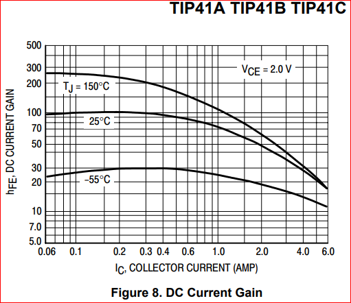

Also the "F" marked TIP41C that came installed on these boards measure with hFE of 210 which is over twice the datasheet. So I have serious doubts about the authenticity of the stock transistors. Might have no relation to real TIP41C.
The Hfe of standard types of power transistor at a few mA test current is not going to be the same as at 1A or even 6A, as the TIP41 is specfied and Hfe typically falls to only ~20. Unfortunately, the little parts testers are only suitable for small-signal transistors. You have to get serious by using heatsinks, clamps, a regulated power supply and solid connectors to test power transistors for conformance.
And those TIP devices I always considered as "low gain" types. At a useful current, of say 3A, the TIP41 has a minimum gain of 15. The TIP35 minimum gains are 25 at 1.5A and 10 at 15A, but if run in the range of 2-4A the gain is about the 20 mark and OK ish.

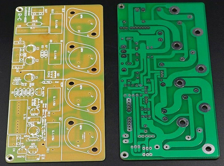

The pictured JLH2003 boards have the current sources (and I would like to listen to the improvement from that) and I could assemble a polarity reversed version with PNP too. The only problem with those is that I don't have dual supplies in that voltage range. Only 50V dual supplies and 24V single supplies.
So I was wondering whether or not it makes any sense for me to make a little perf board current source with the two transistors and a trimmer to experiment with that aspect of the JLH2003 update on my existing mini1969 boards.
Does anyone have positive/negative experiences and/or recommendations with regards to the pictured JLH2003 boards? I think I should be able to figure out TO-3P D1047 mounting on those without too much trouble.

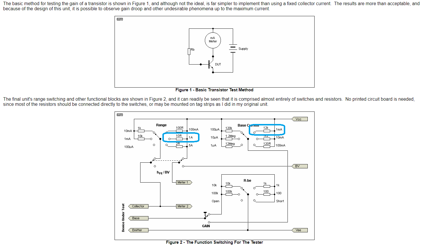

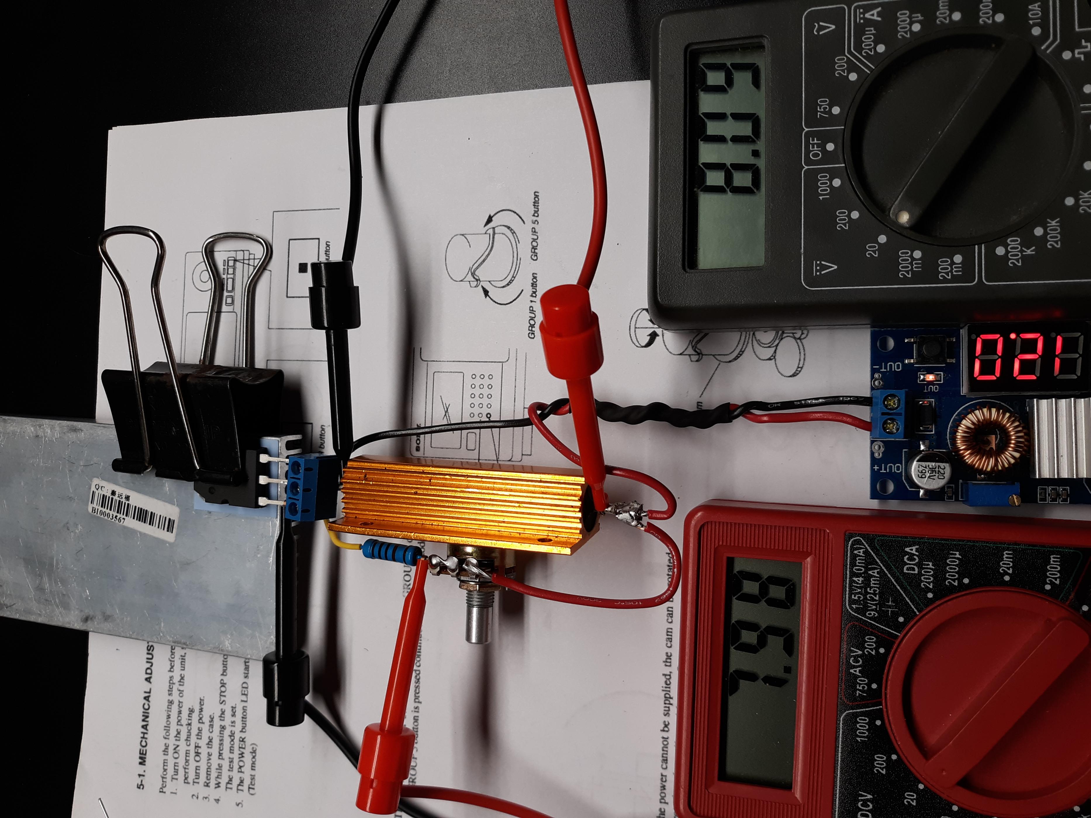

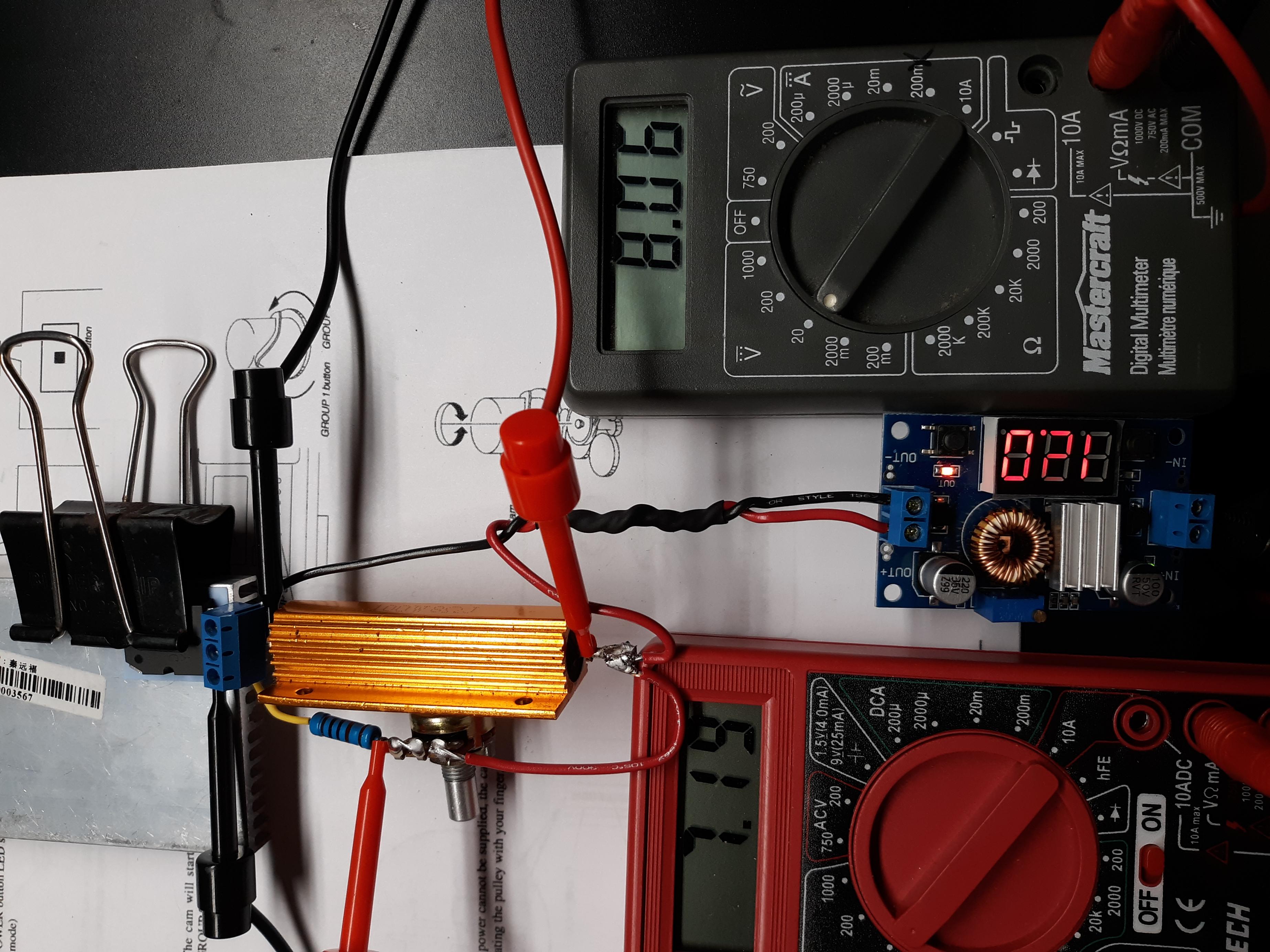

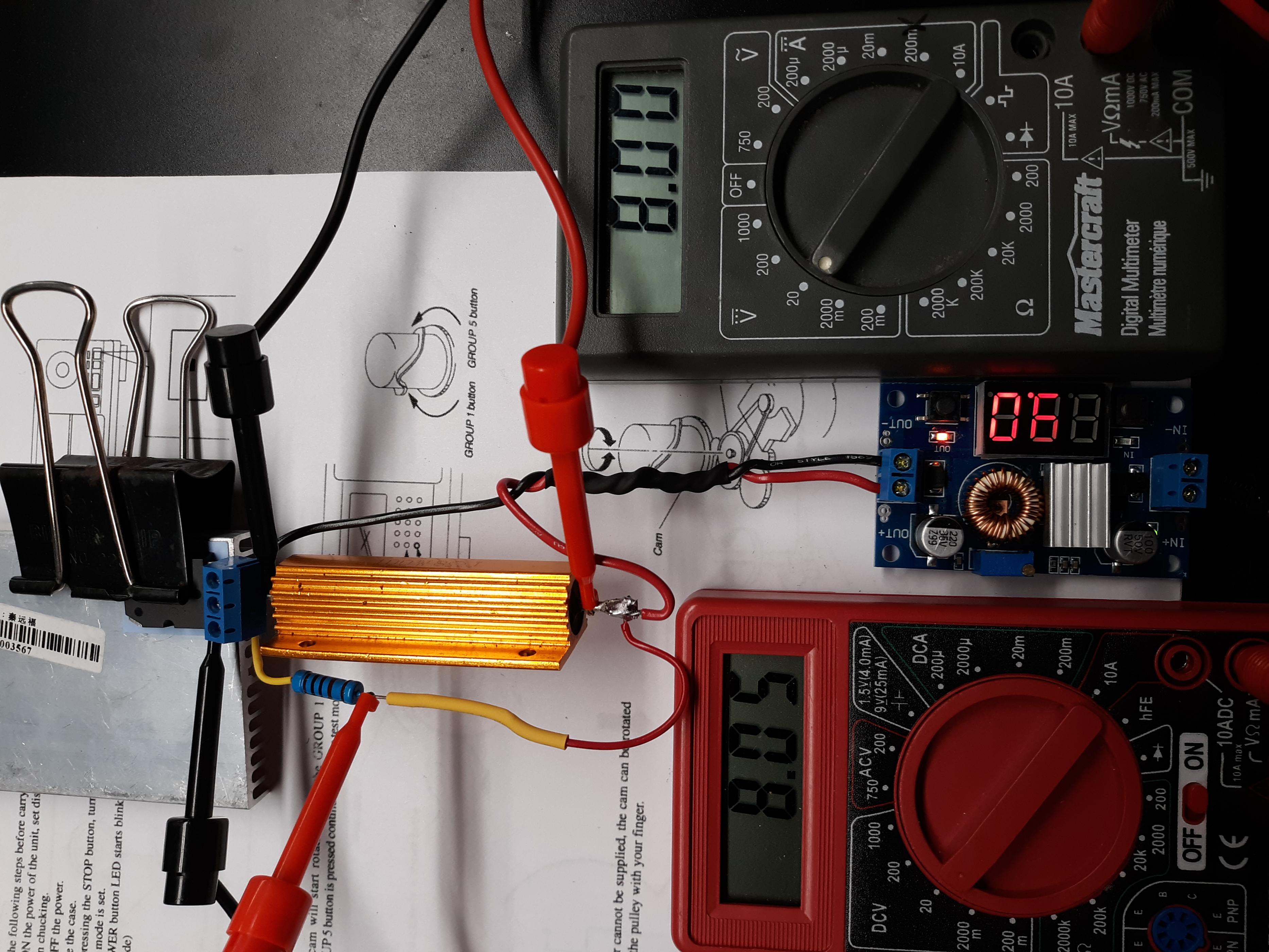

I am using a very simple setup of an 8 Ohm resistor (collector to supply) and 1k Ohm (base to supply) and adjusting the supply voltage until the collector current reaches 1.0 A (8.0V across the 8 Ohm). I have attached a photo.
It is a bit like the Elliott Transistor Tester except it is just one of the base resistors (I had 1k not 1.2k) and one collector resistor (I had 8 Ohms not 10 Ohms).
I have attached a photo with 8.05 mA into the base of a D1047 and 8.0 Volts across the 8 Ohm collector resistor (1.0 Amps). So (8.0V/8.0 Ohms)/(0.00805 mA) = 124. By the way, the M328 measures this transistor at 127 with Ie = 6.2 mA.
Do you see any problems/issues with this very simple setup?
Edited- didn't see the direct path from meter to power supply. Should work OK but I caution again about measuring breakdown voltage. I would only test to spec.
Always start with the base resistor on highest, and check the collector current. If you see the current increasing, it means the device is getting hot, so keep the test duration short or use a bigger heatsink.
Enclosed are photos of a slight modification which allows for Vce = 4.0V (or 5.0V if you want) for more direct comparison to datasheets. A 1k potentiometer is added in series with the 1k base resistor however the base current sense (voltmeter) is still just across the 1k.
This modification prevents Vce getting too low and thus gives a higher result.
Results for LJM Kit D1047 at Vce = 4.0V:
140 = (8.06V/8.0 Ohms)/(0.00719 A)
Results for Toshiba 2SC5200N (authorized distributor) at Vce = 4.0V:
127 = (8.09V/8.0 Ohms)/(0.00798 A)
I would prefer a 10 turn 2k potentiometer for ease of adjustment to 1A but I do not have one.
The goal is an accurate and comparable result that almost any DIYer could perform on their real or fake output transistors with equipment they are likely to already have.

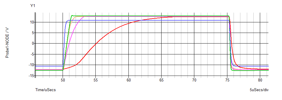

Some time ago I posted a comparison of the slewing rate of the JLH with various output transistors. With the recent interest in the MOS version, I have updated this comparison.
In the simulation results, the risign slew rate is shown for the following devices, in order of speed from slowest:
(1, red) 2N3055H
(2, purple) 2N3716
(3, orange) 2N3055 (epi)
(4, green) MJL3281A
(5, blue) MOSFET
Not convinced that the 2N3716 is really as good as a MJL.
So given that these models are "representative" rather than absolute, I'm pretty sure that the overall conclusion is right , in that the MOSFET wins, and if the circuit is adjusted so that the input stage does not cut off during the transient, this ought to be the best sounding one too.
(Note that the MOSFET design is a little limited in swing due to the higher gate voltage compared with a Vbe)
The MOSFET variant was operating in Class A and offers a (simulated) low distortion too.
All negative-going slews were similar.

Regarding the Millward design the circuit I simulated is virtually identical. Except, as noted in the following post (see OldDIY's ref) the simulations revealed that (a) you need gate stoppers and (b) an additional "stopper" of 1k in series with the input transistor base. And a compensation capacitor!
