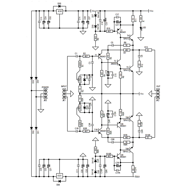

Hmm, a 5 transistor JLH? I don't think you want to get involved with that design as there are a few HPA designs that follow the original JLH design and you wouldn't enjoy having to defend this particular variation unless you had compared it with one similar to the original, yourself.

Yes, I found the Chinese kits sch.
JLH 1969 Class A Power Amplifier Audio Board Dual Channel Preamplifier Headphone Amplifier Single Ended Pre AMP| | - AliExpress
