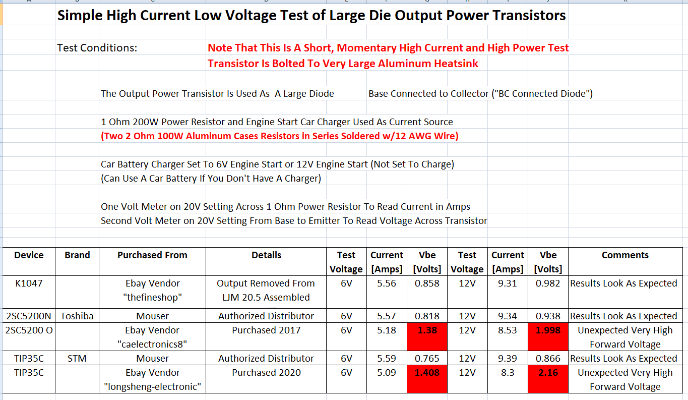

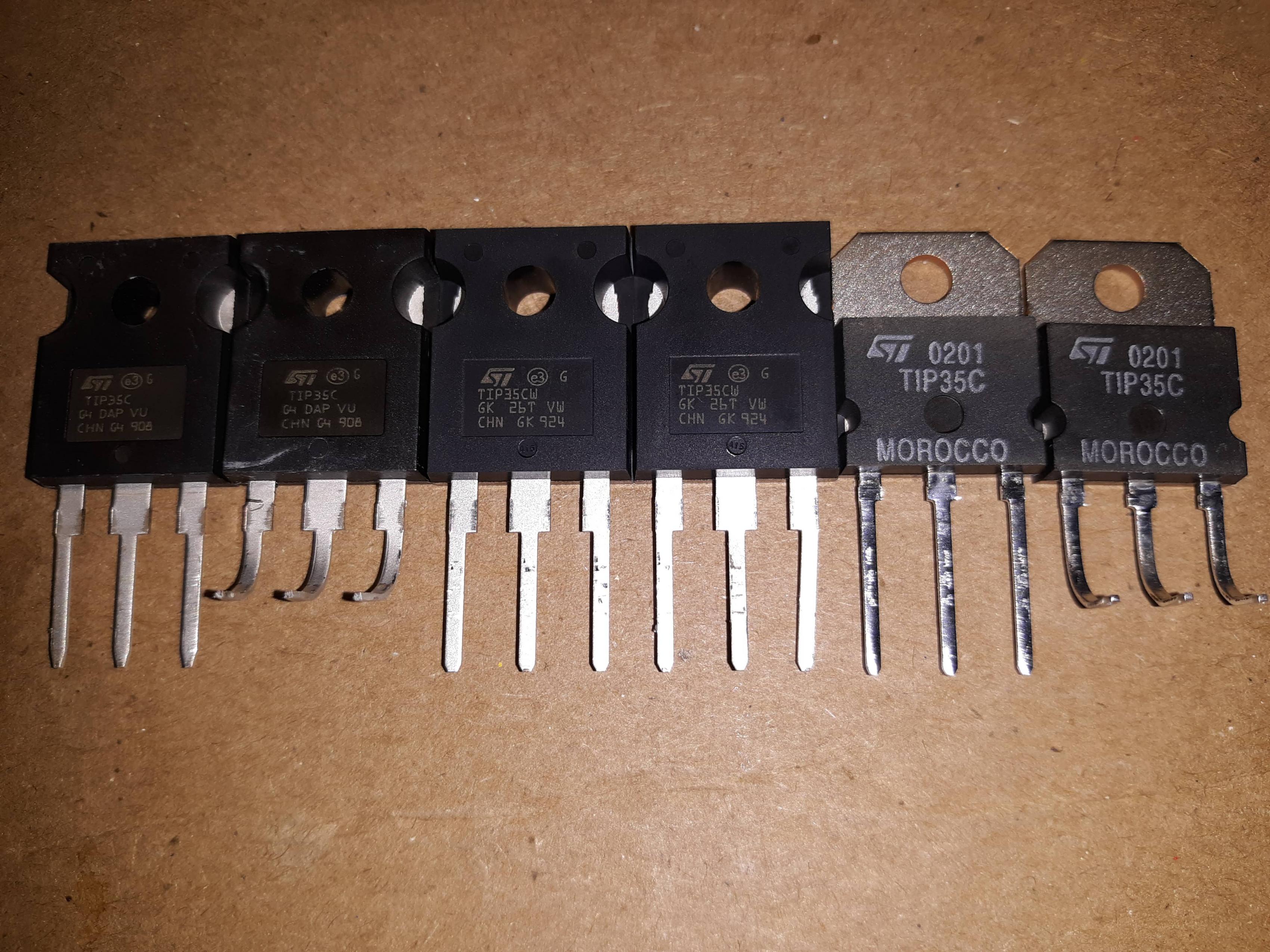

I listened to my first JLH amplifier last night. The left channel has the stock transistors marked TIP41C and the right channel has genuine STM TIP35C from Mouser.
Before soldering in the genuine STM TIP35C I read about fake transistor testors and decided to build a slightly different one oriented towards high current (Class A/JLH).
I had read about another one that tests near the second breakdown region (and I might build that later) but I made a very simple one that is intended to be sensitive to the size of the die and the high current capability of the die.
I did this because many of the fakes seem to have small die with low current capability. And by using a 174V supply and 1M, 100k and 10k resistors it appears to me that many of the small die in the fakes have fairly breakdown voltages.

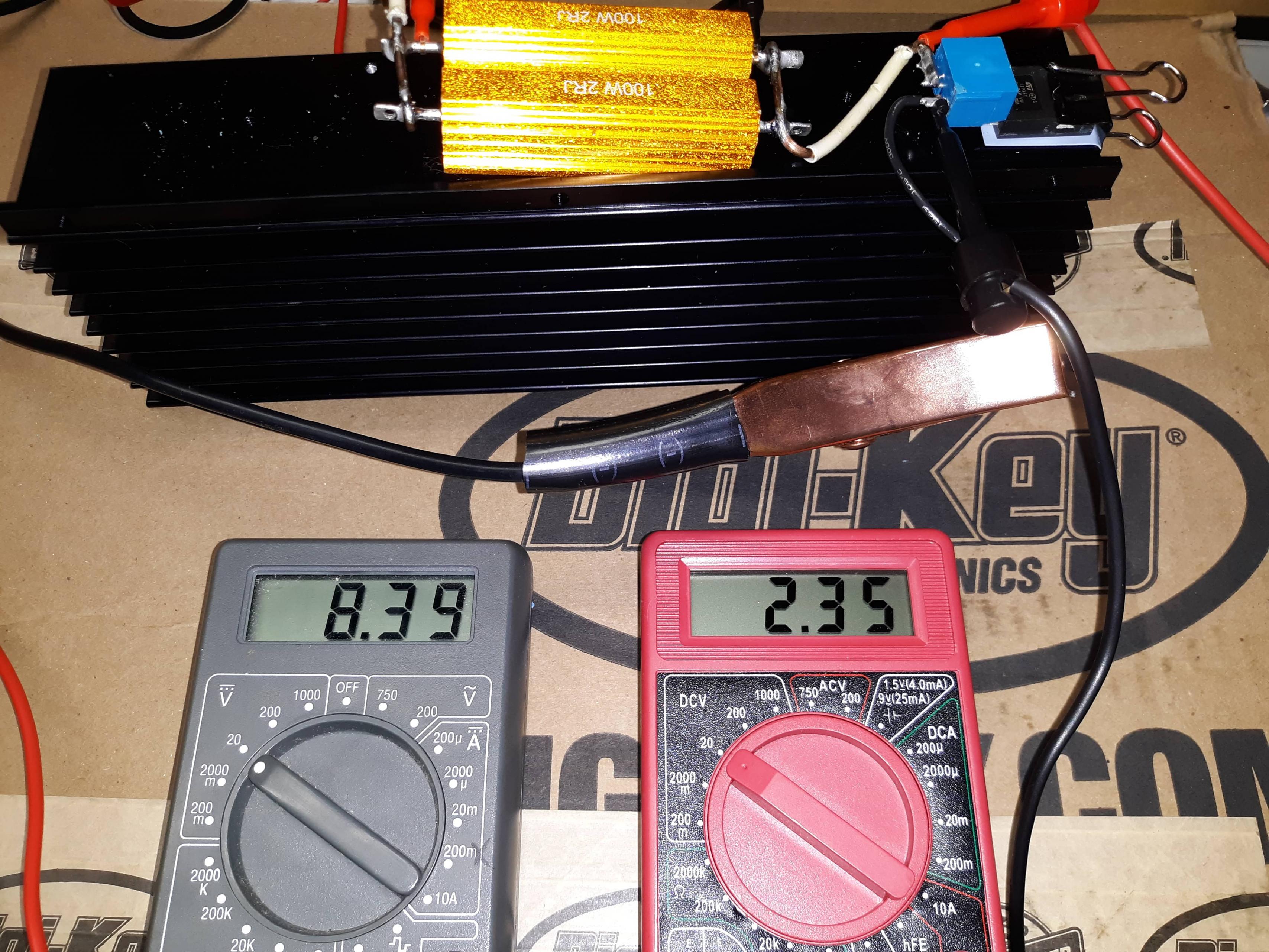

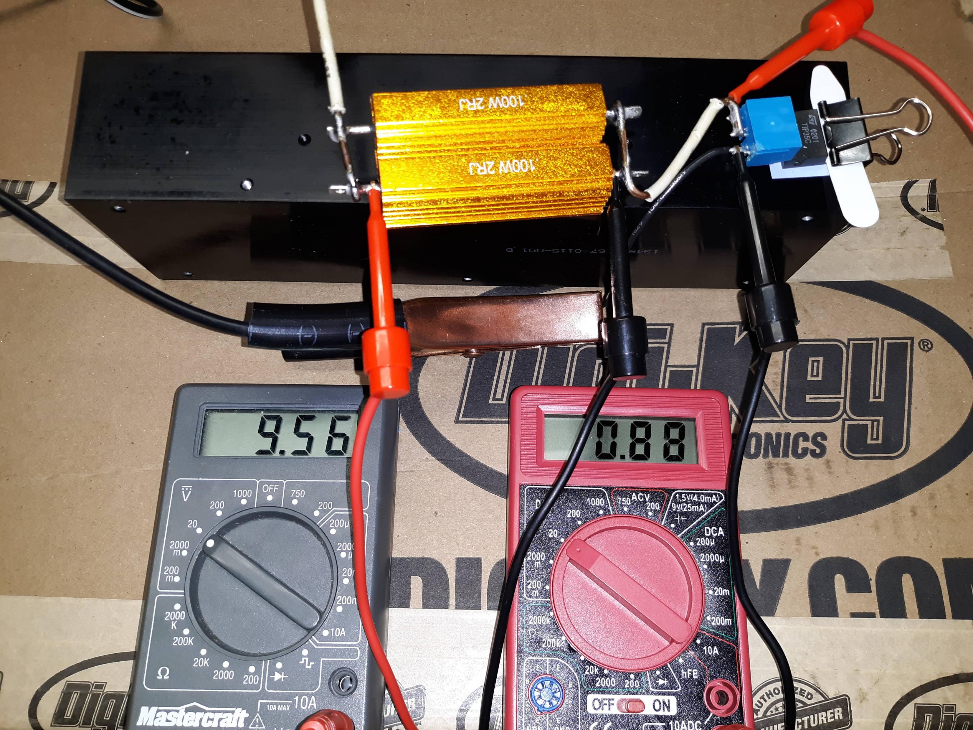

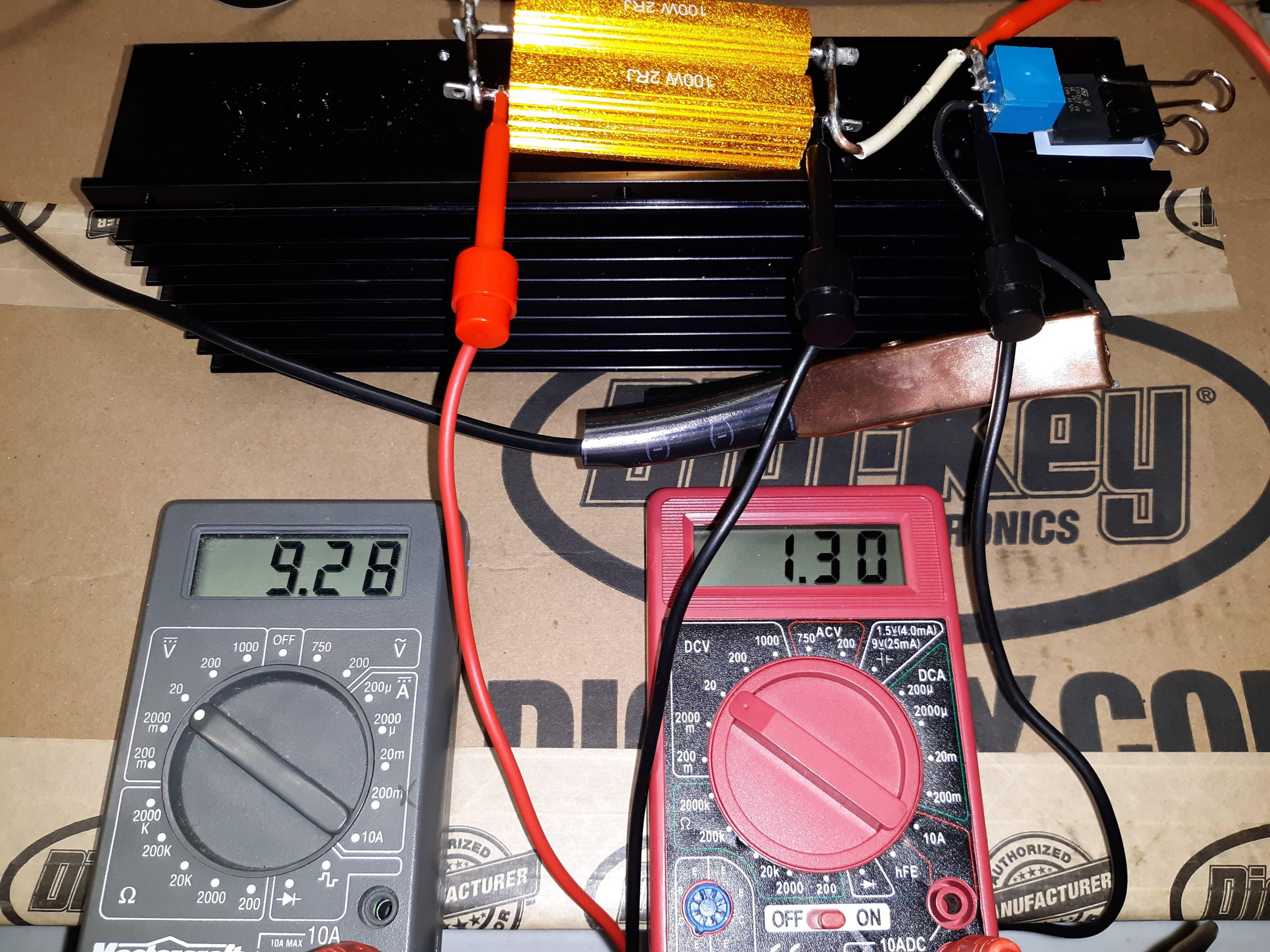

The tester is very simple. The transistor is connected as a Base-Collector connected diode and I use a 10A current source to measure the voltage across the transistor.
Construction only required a large heatsink, scrap 12AWG wire, two 2 Ohm 100W dummy load resistors in parallel (for 1 Ohm resistor) and a 12V power source. A car battery could be used but I used a 12V/6V engine start car charger set to start (not set to charge.)
I have attached pictures of the test and results for genuine TIP35C and 2SC5200. And also for others marked TIP35C and marked 2SC5200 but I suggest you examine the test results... I guess I can't even buy cheap TIP series from anywhere except authorized distributors.
Photos of the TIP35C from Left to Right are: Ebay (Qty 2), Mouser (Qty 2, 2020), Mouser (Qty 2, 2002)

I think ST have changed the package recently from The TO-218 to TO-247.
I think you are on the right track for measuring die sizes. But I would not use the BC diode connection, because of quasi-saturation which puts a lot of additional hole current into the base and modulates the conductivity. While the B-C connection gives you a comparative measurement on device resistances, the device will be under extreme operating conditions.
A measure of the thermal resistance might be useful. To measure the thermal resistance, I run the collector from a separate (e.g. 5V) power supply (typically an ex-computer 20A type) and bias the base separately through a resistor. The transistor is directly mounted with thermal grease on a large heatsink of known thermal resistance. Measure the base voltage at a given current, and allow the device to warm up (can take an hour). Measure the base voltage again, and that gives you an indication of the temperature change. If you measure the heatsink temperature that should correlate with the total input power on the device.
You can also get an idea of the actual Vbe: temperature if you also happen to have a power resistor on the heatsink, which you can use to increase the heatsink temperature by a controlled amount and compare the new Vbe.
A measure of the actual saturation voltage may also give a clue to the die size, if you allow the collector voltage to reach saturation using a separate current-limited supply.
And, another clue to the die size are the junction capacitances. Perhaps we need a thread to indicate genuine device Cjc's and Cje's measured at, say, 0V, 5V and 10V (not Cje - max reverse voltage 5V!)
Lastly, I would caution about measuring BVceo/BVcbo using high voltages. Transistors should be able to withstand avalanching BC junctions but in the past, there have been examples of (genunie) devices exhibiting permanent damage presumably because surface states of the device (e.g. in a passivating oxide) around the base-collector junction have become charged, leading to lower breakdown voltages, which are unrecoverable. While I have tested recent devices to be in spec, I've only nudged them on a scope to where the collector starts to increase current significantly, but stopped short of actual breakdown.

Ok. So in keeping with trying to use very simple and readily available components (that what other DIYers might likely have) how about I modify my simple test setup to supply the base through a separate large power resistor (such as an 8 Ohm 100W aluminum cased dummy load) and still supply the collector through the 1 Ohm (two paralleled 2 Ohm 100W aluminum cased dummy loads)?I think you are on the right track for measuring die sizes. But I would not use the BC diode connection, because of quasi-saturation which puts a lot of additional hole current into the base and modulates the conductivity. While the B-C connection gives you a comparative measurement on device resistances, the device will be under extreme operating conditions.
Would that be better? A "roughly" 1.5A current source into the base of what are supposed to be huge D1047, 2SC5200 and TIP35 power transistors?
Then I can add a third volt meter to measure base current and also calculate current gain. I could use an 8 Ohm dummy load in series with anther 2 Ohm dummy load. Then with 10 Ohms into the base and for base current sensing it would make the math/meter reading more intuitive. (Just look at the voltage across the 10 Ohms and divide by 10 to get the current.)

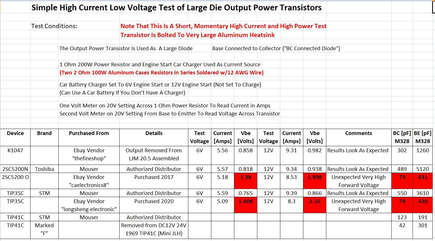

I have been examining the capacitance in a crude fashion with the M328 transistor tester that I have. I simply bend one lead away and first measure BE like was just a diode and then I bend the other lead away and measure BC like it was just a diode.And, another clue to the die size are the junction capacitances. Perhaps we need a thread to indicate genuine device Cjc's and Cje's measured at, say, 0V, 5V and 10V (not Cje - max reverse voltage 5V!)
To measure at 5V and 10V should I try a crude "bias tee" with a 1M resistor to supply bias (such as a 9V battery) and then a 0.1 nF capacitor as block to the capacitance meter?
I am trying to come up with simple tests using everyday DIY equipment such as common volt meters and popular tools such as the M328 transistor tester.
I have included capacitance in the attached updated results.
I am happy to measure, tabulate and update with other devices (genuine and fake) but I doubt there is anyone out there who wants to donate and mail the genuine devices. Especially since the genuine devices of true interest are often expensive unobtainium.
As ever, Rod Elliott has done some work in this area. He has a design for a simple but effective transistor tester (Project 31 - Full Featured Transistor Tester).
I built a version that measures with Collector current up to 7 Amps that works very well.

I was ok with the idea of getting something like a UTC or ISC (Inchange Semiconductor Company) clone if they were done reasonably well and if others reported good performance. And I do mean a true clone or generic that is properly and honestly engineered. Not a fake.
However it seems like the 2SC5200 I bought in 2017 and the TIP35C I bought this year are both small low current/low power die. It is interesting that the test results for the 2SC5200 are so similar to the TIP35C. It would have been fun to have a lab to decap and look at the die under a microscope.
What is particularly bothersome is that both the 2SC5200 and the TIP35C came from "top rated" vendors with 99% positive feedback.

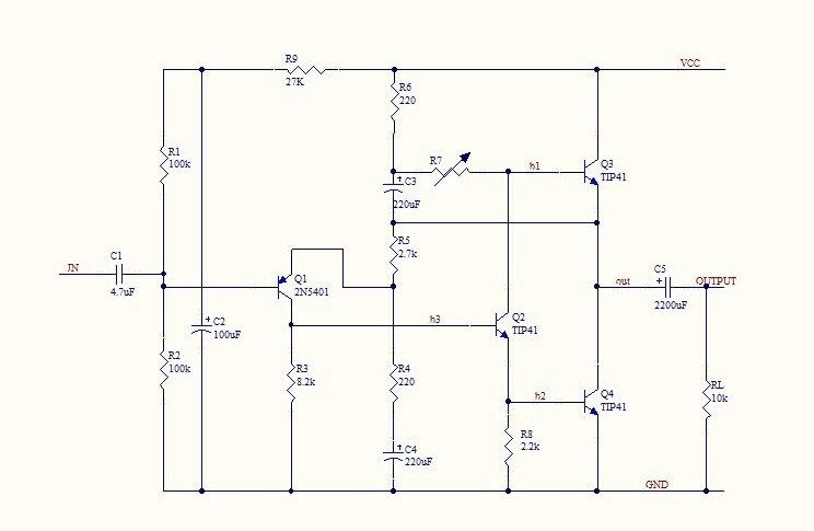

So it is the most basic version which I believe is called the mini1969. I have attached the schematic. It is the tiny little board in the attached photo. Does anyone else have this tiny little JLH?
I have already replaced the stock outputs which were labeled "TIP41". I replaced the right side with two genuine STM TIP35C from Mouser. For the left side I used two 2SC5198 labeled Toshiba from Ebay. As far as capacitance and high current base-collector connected diode characteristics go they might actually be genuine devices.
For initial impressions I think it shines on female vocals and piano as two examples.
However for dense/louder mixes such as hard rock I think there is too little power and/or too much distortion.
I am currently considering modifications and upgrades to this mini1969 first. If I end up suitably impressed then I can invest in a better JLH version. So far I have changed the outputs and next I can look into improving the power supply (there are no power supply caps on these little boards) and the output cap. I should also investigate the biasing soon, I think. Biasing might involve replacing two resistors on this particular version among other things.
I will also ask for suggestions on what improvements can be tried on this little board before I consider a more expensive JLH. (A large board Zero Zone with on board caps and Sanken PNP outputs was one that was recommended to me.)
I might go as far as reversing all component polarities on one of these little boards and installing two 2SA2223 Sanken (from Digikey). If I like that then I might try that Zero Zone board.
But I was also wondering if I should try a JLH version with MOSFET output devices next. (Too many choices to explore 🙂)
This week I plan to work on the caps (mainly adding solid Vcc bypassing on the board and a larger output cap).
I don't think that's quite the right type of driver/splitter transistor (Q2) there either, which casts serious doubt on those alleged TIP41 transistors, if they also work satisfactorily in the role. The genuine articles are or rather were, good for up to 4W as output and current source transistors but I don't think there is any sure way of predicting the performance or likely problems among the many and various types of fakes out there.
It would be prohibitively expensive and time consuming to track down the original semis and specific component types to compare the original design with whatever we can concoct today but at least we can work with known spec, genuine semis as substitutes and that can give indications of what JLH was actually talking about, back in the day.
Genuine TIP41 are cheap enough items to start with and Q2 could be any of a number of small, fast audio drivers, as it happens. FWIW, I had good results with obsolete but genuine Hitachi 2SD669 and there are specified Chinese copies of the latter available quite cheaply in T092L or TO126 outline from profusion PLC (UK) Transistors (Buy Online) | Profusion.
Profusion supply professional audio repairers with original and substitute parts so I don't think they will be selling you the same trash as the retail platform kit sellers in China.
Well I have a few genuine Toshiba TTC004 left over from fixing the MX50x2. Are those suitable?
I also have two genuine STM TIP41C I purchased from Mouser in 2002 for a different purpose.
Finally I have a bag of 2SD669 but I can not tell you what is really inside the package for those.
Which one is the best choice?
By the way I just added a 1000 uF 50V Nichicon VX and 0.33 uF MKP to the Vcc and GND screw terminal pins on the bottom of the board since there are no Vcc caps on these little boards. I think that improved the sound a bit. Tomorrow I plan to put a larger cap very close to the board with a short wiring harness. The 1000 uF is about as large as can be mounted on/under these tiny boards unless I get a different series or lower voltage capacitor which is physically smaller.
