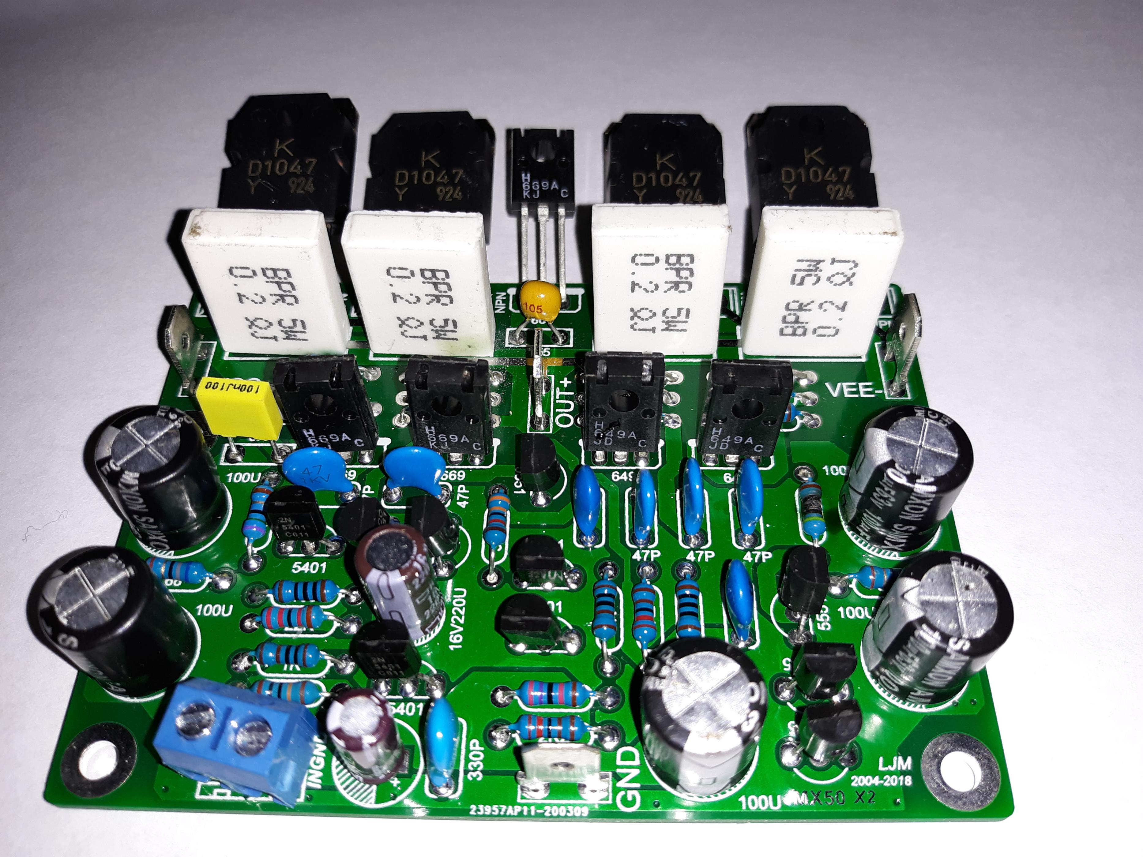

I have noticed that the MX50x2 output devices are not biasing evenly. So this evening I hunted down my IR thermometer (spot) and found that at idle with a pretty much cold heat sink the power transistor cases over the die are at significantly different temperatures. One is 40 degrees, two are 30 degrees and one is 24 degrees C. (Molding side over the silicon dies.)
Advice on next steps?
Tomorrow I might try triple checking the transistor to heat sink mounting.
If that results in nothing perhaps I try tossing out the kit supplied Silicon Rubber pads and use the few mica insulators that I have to see what happens.
If that results in nothing... ...perhaps I remove all the drivers and outputs and measure their hFE and Vbe???

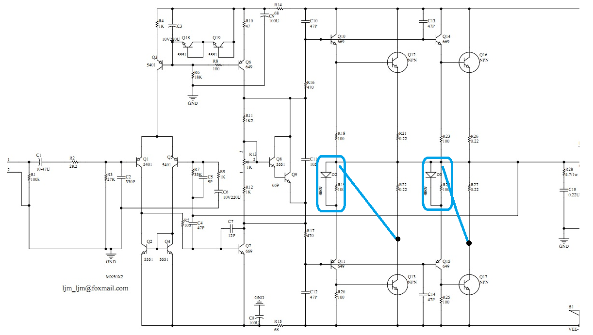

Do you mean like I have drawn on the attached schematic?Well, having just seen this post, my first reaction is that the lower PNP driver transistor emitters should be fed through to the collectors of the lower NPN output transistors. That will put the quiescent current into a feedback loop, which is in the present circuit open ended.
Move the connection of both the 100 Ohm resistors and the 1N4007 diodes to the collectors of the lower NPN's?
Yes, that's it.

Photo attached. (Of the one that burned at +/- 50V). I am debugging the second board at +/- 25V but the bias is very uneven through the K1047 outputs.
Hmm. I suspect the designer thought he could match the thermal heating of the drivers on the PCB with one device also on the PCB, and the output with the other on the heatsink.
I've found that the most stable arrangement is to have the drivers and output all on the same heatsink. Next best would have been to at least had a small aluminium plate on the PCB which the drivers and on-board thermal tracking transistor are connected. It's not a good idea to use free air and expect them to be thermally coupled.
Not sure how easy to mod this but possibly the drivers could be attached to a heatclip of some sort (even if the legs have to be extended with wires) and similiaryl find a way to attach the 5551 to the heatclip too. Even a small strip of aluminium might be enough.

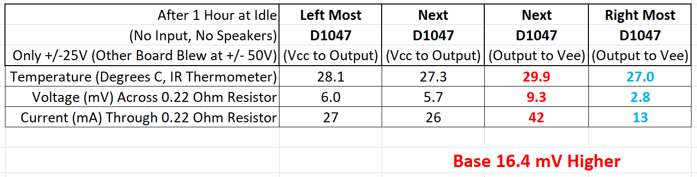

So one board burned up at +/- 50V (idle, in seconds) but I have made a few measurements on the surviving board. I have attached a table of my measurements that show that the lower D1047 transistors are not biasing up properly. You can see that the currents (and base voltage) are very different between the two D1047. This is at idle with no input and no speakers. This is after one hour at idle with very very low +/- 25V supplies
The bias through one D1047 is over 300% of the bias through the other D1047.
What do you think is causing this problem? The base voltage is 16.4 mV higher on the D1047 with the much higher current.
Very large mismatch between the two 649 drivers? And/or outputs?
I was thinking my next step would be to pull the drivers and outputs and measure Vbe and hFE. At this point I would not be shocked to find that they are not matched at all at the factory. Soldering was quite messy. (See attached photo. Kind of looks like it was reworked or repaired?)
I suspect this is related to why the other MX50x2 burned up. By the way, the D1047 with the higher bias current gets much hotter than the other three when music is playing, even at pretty moderate volumes with only gentle +/- 25V supplies.
One last comment, the hot K1047/2SD1047 is dissipating only 0.042A * 25V = 1.05W. Yet the front of the transistor case/molding over the die area has risen 6 degrees C relative to the heatsink. That seems like a very poor thermal resistance doesn't it??? Best I can tell is that the metal tab of the transistor is close to the heatsink temperature so it looks like the majority of the thermal resistance is between the metal tab of the transistor and the silicon die.
Well, it could be that you don't have matched transistors. But in the original circuit, again, there is nothing to ensure the currents in the two lower devices are properly shared. The resistors in the collectors in fact do nothing except add an IR drop and may as well not be there.
If you rearrange the circuit as discussed, this will address the problem. 1A through 0.22 ohms will generate enough of a voltage in one driver emitter to generate at least a nearly equal current in the other.
The other alternative would have been to add another pair of 0.22 ohm resistors in the emitters of the lower NPN's, but that means still needing a solution to ensuring that the current in the drivers is balanced i.e. still having to re-route the emitter resisotr/diode or adding extra resistors to ensure a current balance.
Once an unbalanced transistor gets hot, the Vbe falls below that of the other and that can lead to increased current.
This may be the problem you are seeing and the solution is the same as above.
I would also think that 0.22 ohm resistors is a little on the low side. I would normally select higher resistors, but that rather depends on the total load current expected.
If you are driving many amps into 4 ohms say, then 0.22 may be enough.

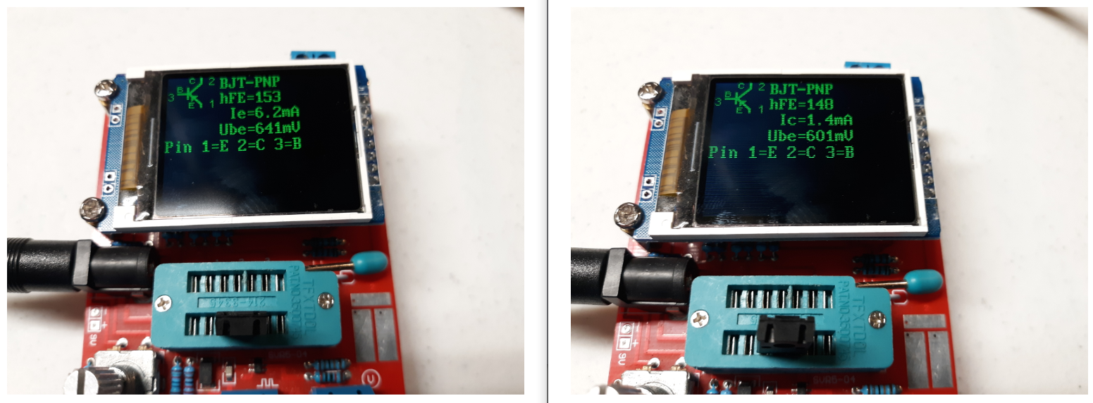

I just pulled the drivers and they are very badly mismatched. 40 mV is quite a mismatch. Pictures attached.
1st measures Vbe = 641 mV and hFE = 153.
2nd measures Vbe = 601 mV and hFE = 148.
The mismatch in currents has improved but it looks like I need to pull, measure and replace the outputs too...
I replaced the drivers with ones that were matched in both Vbe and hFE as close as my meter reads after measuring every one I had.

JLH was correct in his overview of converting the input stage to LTP. Using an LTP changes the nature of the design, and is often compensated by a Miller capacitor. Which as Old DIY reminds us, is the concern JLH had.
The designer has chosen to split the Miller capacitor into two, one small one (C7) and a larger one (C4) which is fed from the output rail. This is clearly an attempt to reduce distortion, but would be more appropriate for crossover distortion in a Class AB amplifier.
I assume this design operates in Class A.
In circuits JLH designed which used LTP input stage he usually chose to use inclusive compensation (RC series pair from collector of VAS to base of feedback side of LTP. Bailey used this successfully for a DC coupled amplifier, but that did not have a current mirror in the input stage, which adds more phase shifts and higher OLG. As probably pointed out in Bob Cordell's book, and earlier by Cherry, if the input stage LTP is degenerated the slew-induced distortion can be avoided. The loss of gain would need a Darlington VAS (emitter follower buffer if you separate the collectors I suppose).
Also the current mirror in this design ought to have small emitter resistors to balance the current a little better between the two devices.
This circuit seems to have overlooked a few things which have been learned in the last decade or two.
OK- just catching up with this. On another MX50 thread, it describes this as a 100W class AB design. This topic should probably not be in the JLH class A thread.
In which case, I would say that the input stage should be degen'd, the mirror pair have a small resistor (dropping a few tens of mV) to offset any Vbe mismatches, and the compensation capacitors should work, but whether tested properly I don't know. As mjona suggests, a single cap for C7 would be almost certainly guaranteed to work, but still needs degen input, I suggest, since the Re.C7 sets the upper frequency unity gain point.
The LTP current seems to be 0.6mA nominally. That is too small I think. Slew rate with 100pF is 6MV/s and most amps these days try to be 30MV/s or higher.
