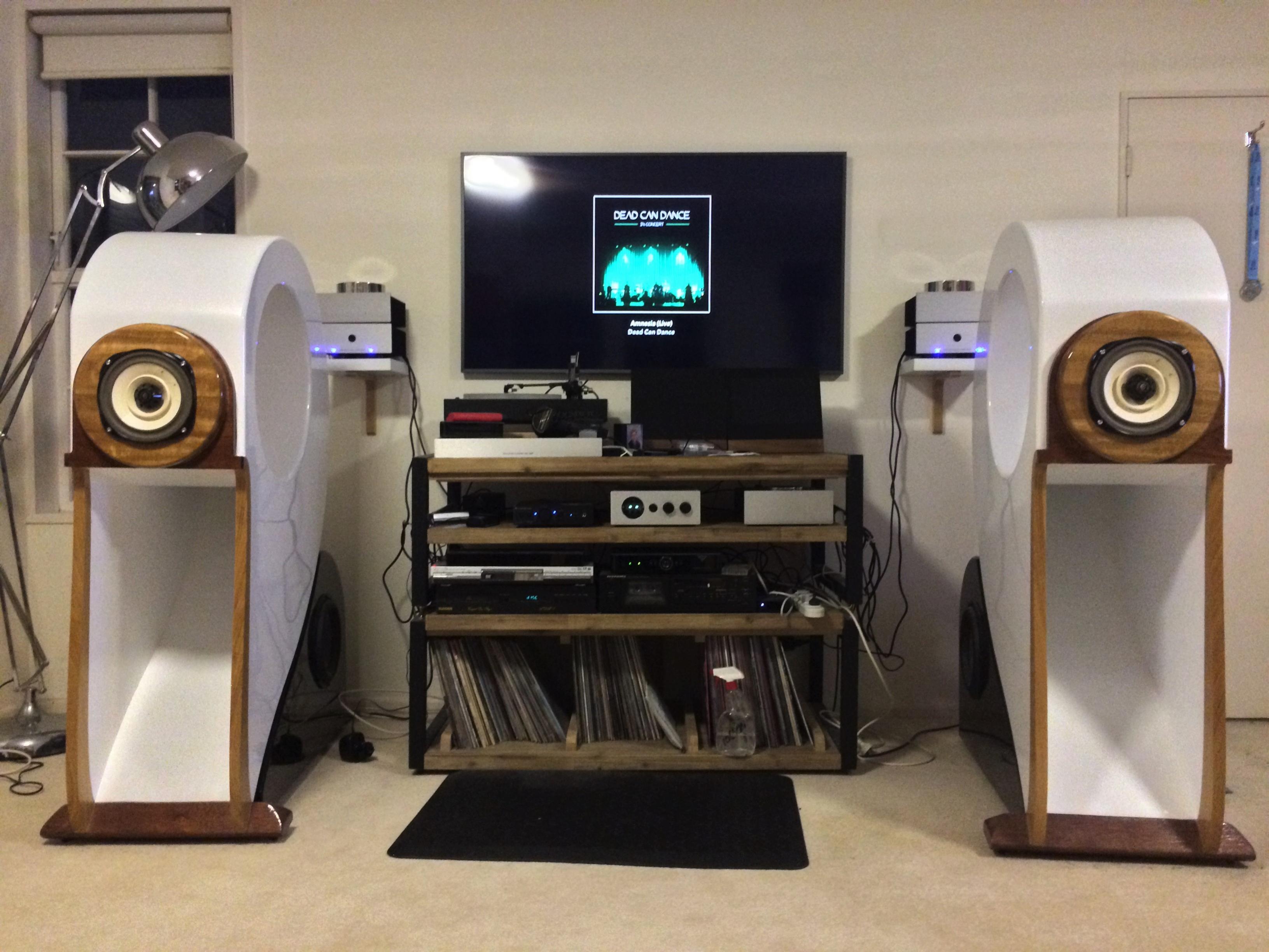

Will try it out on the horns for a laugh -106db per Watt and powered subwoofers in each to boot 🙂 In common with Decaware ones - no crossover the subwoofer is just adjusted to cut off at the overlap.
