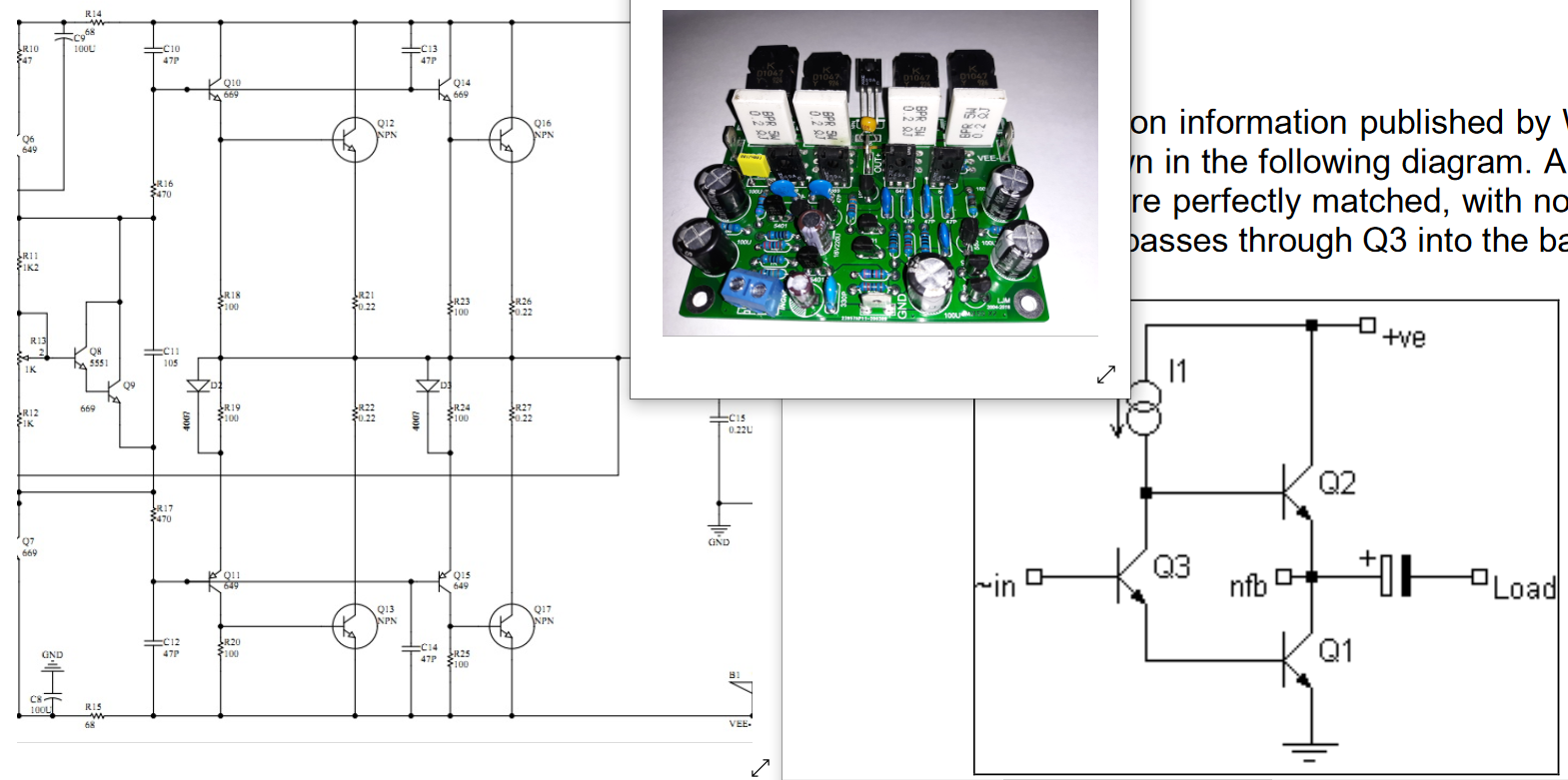

Can someone comment on the thermal stability of a quasi complementary output stage relative to the JLH output which can obviously be biased quite high? (With four NPN output devices on the heat sink along with the Vbe/bias device while the four drivers are mounted on the PCB without any heat sink)?
Would it be improved with the four drivers mounted to a little common heat sink?
Would it be improved if the drivers were mounted on the main heatsink?
I ask since I am dealing with a quasi complementary output stage that seems to have pretty poor bias stability at bias currents far below class A. One indicator is that the inner pair of the four NPN outputs biases much higher than the outer pair. The outer pair biases at about +/- 30 mA and the inner pair at +/- 50 mA. Emitter resistors are 0.22 Ohm.
Would it make any sense for me to disassemble this amp and measure the hFE and Vbe of the outputs and drivers? (It was purchases assembled on eBay so I did not have the chance to measure the hFE and Vbe like I did with my MA9S2.)
Perhaps I should replace the drivers and outputs with hFE and Vbe matched parts from an authorized distributor?

John Ellis has covered this. Hopefully he will join in. All I know is that the heatsink must be large enough. The driver might benefit by being close to the outputs. Large seems to be twice as large as maths might suggest. Even for the more modest version 0.25 degrees per watt stereo.I didn't have to calculate mine as I had some heat sinks like that.
0.22 at the emitter is 7-10mV across the resistor. Ube spread can be larger. We need a selection of drivers and output transistors in each leg.
In class A, the current is 1-2 A. Base current limited. With the heating of the transistors, thermostating occurs (stabilization of the collector current).
Try to set the current to at least 50mA. The radiator should be of a large area with sparse vertical ribs and a thick base.
Use thermal grease and pads with good thermal conductivity.
There may be stability issues (generation).

I suspect that the devices were not selected and that I have mismatched Vbe and/or hFE. Perhaps I should just disassemble it and pull (and measure) the drivers and outputs. I guess I should stick with kits instead of assembled boards in the future.OldDIY 0.22 at the emitter is 7-10mV across the resistor. Ube spread can be larger. We need a selection of drivers and output transistors in each leg.
But I do not know if there is a design related issue, such as perhaps the lack of any thermal connection between drivers, no driver heat sink and/or no thermal coupling between drivers and the output heat sink.
What is the mechanism that results in thermostating instead of runaway?OldDIY In class A, the current is 1-2 A. Base current limited. With the heating of the transistors, thermostating occurs (stabilization of the collector current).

The layout is for one common heat sink - you can look up the temperature rise per watt specifications in relation to the needs - power rating of the amplifier module.
There has been some recent discussion about staggered cross-over points having advantages where one set of outputs is still in moderate conduction where the other is in transition into cut off.
This discussion might have been in the thread on Bob Cordell's book.
