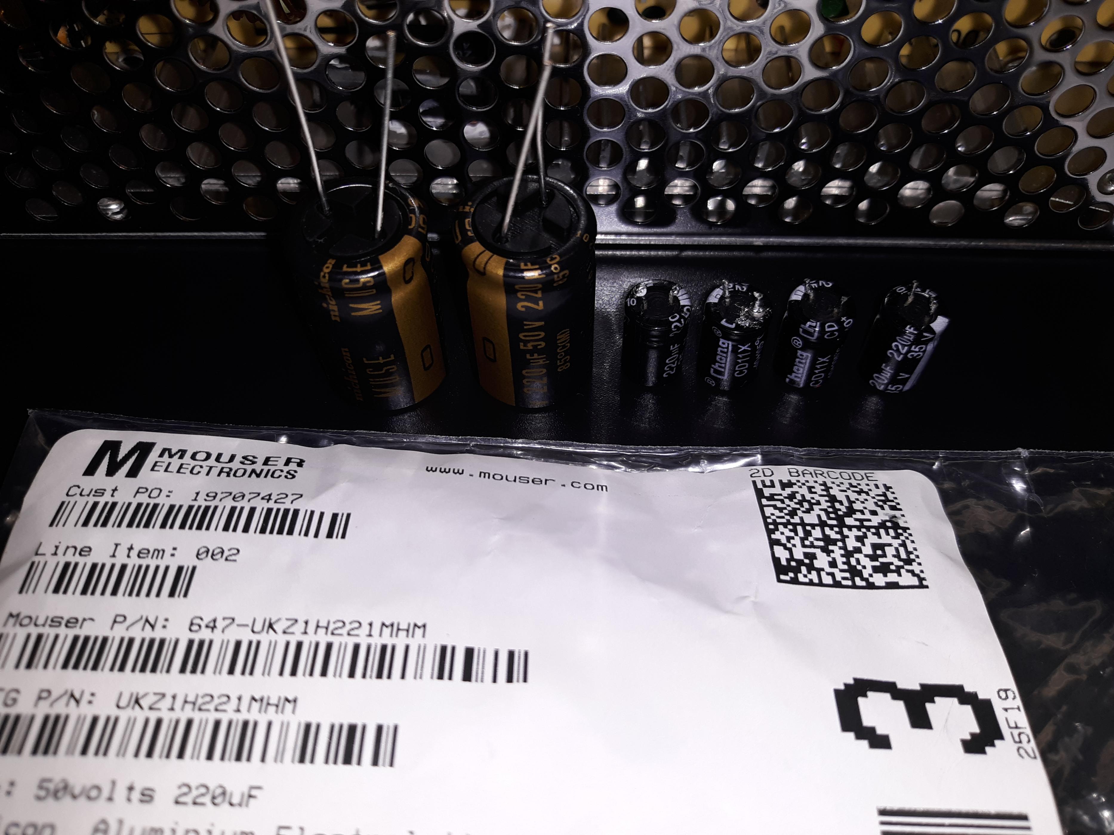

I next removed the two 220 uF 35 V "Chang" capacitors and replaced them with 220 uF 50V Nichicon Muse capacitors that I had left over from upgrading the power amplifier capacitors inside my Denon AVR-3805.
Now the sound quality has improved again. The unpleasant mid/high distortion and the "slightly plugged ear or mild cold" characteristic is gone now. I have marked the two 220 uF capacitors on the attached schematic. Are these considered critical components in the JLH? Replacing those made a big difference. (One of the clearest examples I have found of capacitor quality making an audible difference.) I have attached photos. The original capacitors are very tiny compared with the Nichicons.
What are your experiences with these two 220 uF caps? What has worked best in that location? (Capacitance, brand and series?) What brand, size and type are used there in a "high end" JLH?

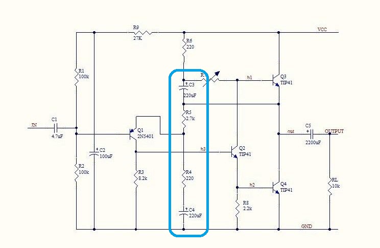

I've lost track of what transistors you are actually using now. Your diagram shows TIP41's as both driver and output. They have two time constants about the same, and that combination does not need much of an additional phase shift to oscillate or at best have some overshoot in the response (marginally stable).
You should use a fast transistor for the driver stage similar to the BD139 if you do not have that one. With two fast stages, the output stage provides the roll off needed for stability.
With three fast stages there is opportunity for oscillation, which is why I suggest a compensation capacitor should be used, but it could be that differences in Cjc may explain why some builders do not seem to need it. Not looked into that in any detail. (add to the lengthening list of "things to do sometime"?)
What compensation capacitor values have you used and with what transistors types?

Thanks for the reminder. For simulation, the KSA992 seems similar to the BC556, and the TTC004 not too different from the BD139. There may be small differences in capacitances, and they will affect the results, but broadly the BC556 is a lowish noise, high frequency small signal device, and the BD139 is a medium power 100MHz-ish device.
I've used a 33pF across the feedback resistor, not BC "Miller" connection. Though for slightly better stability it maybe should be connected between the collector of the driver and emitter of the PNP. The Miller connection is of course a widely used solution as it is robust, but I prefer not to use it unless the input stage is degenerated enough not to overload (as Cherry did) or has a high enough current to be able to drive the capacitor at high frequencies (like Stochino's design).
