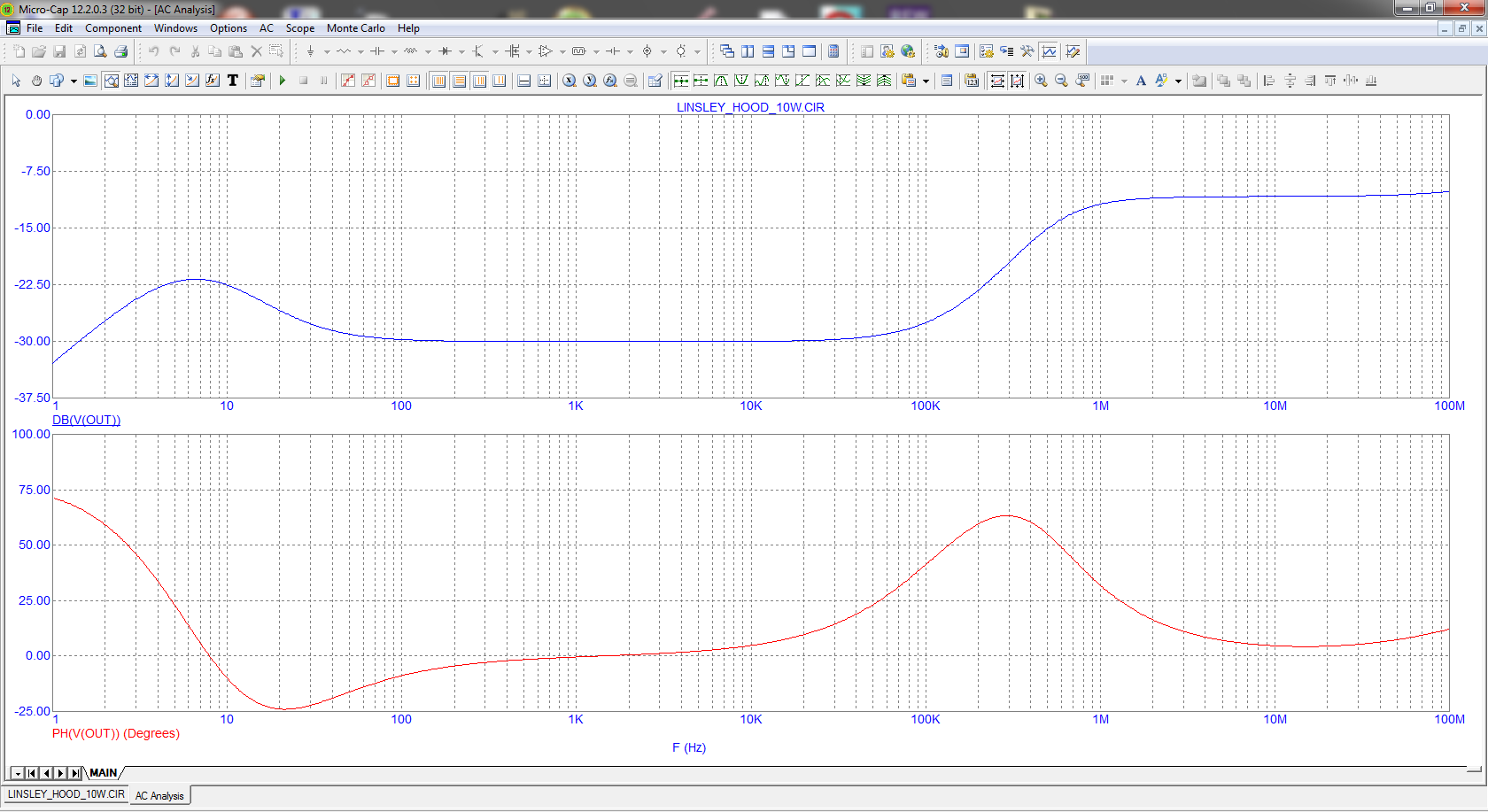

There is a sample circuit of JLH amp in the Micro Cap 12 simulator, i did a PSRR graph, it may be useful.
