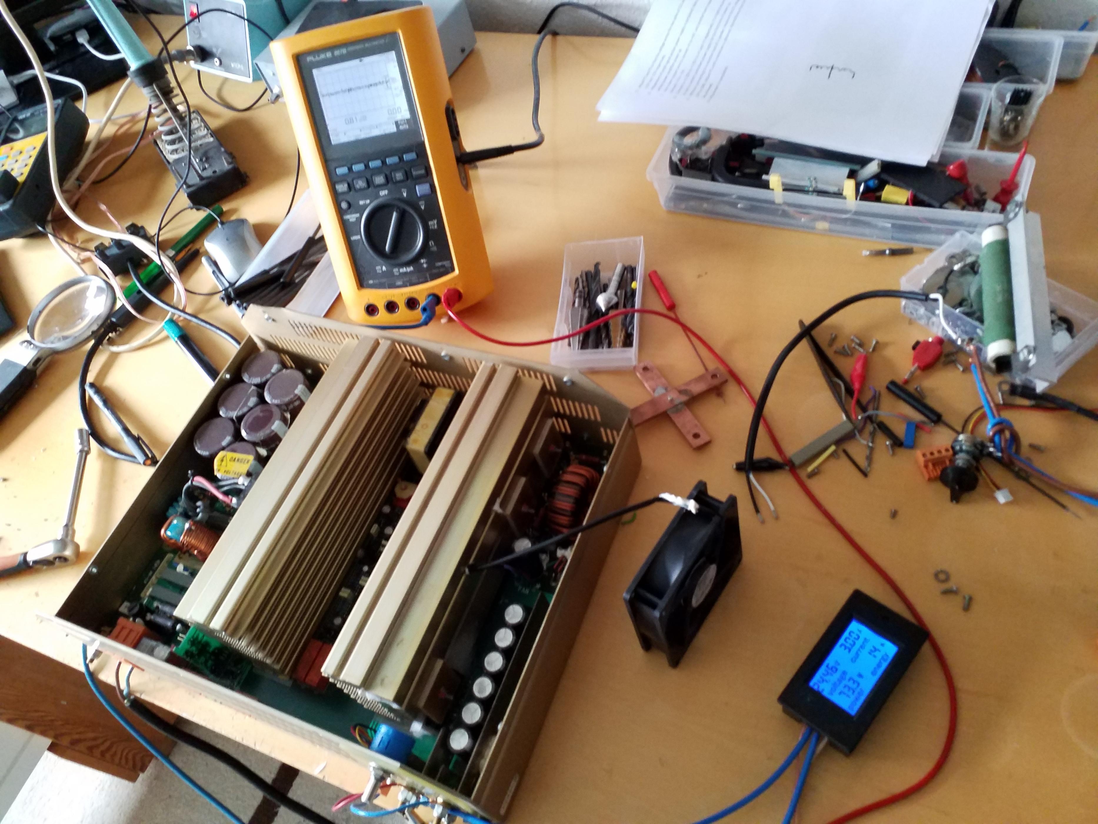

I have theese two, noise is low, my fluke cant pick up any switching frequency, I added a pi filter with some nice big chokes.
Will do some measuring as soon as I find a new oscilloscope.
They are fully floating, 24v 40a ,adjustable with +/÷ 15%.
Only problem is that they are big!
Without pi filter and loaded with 24.6 volt 3 amps, my fluke says 0.81Mv rms
