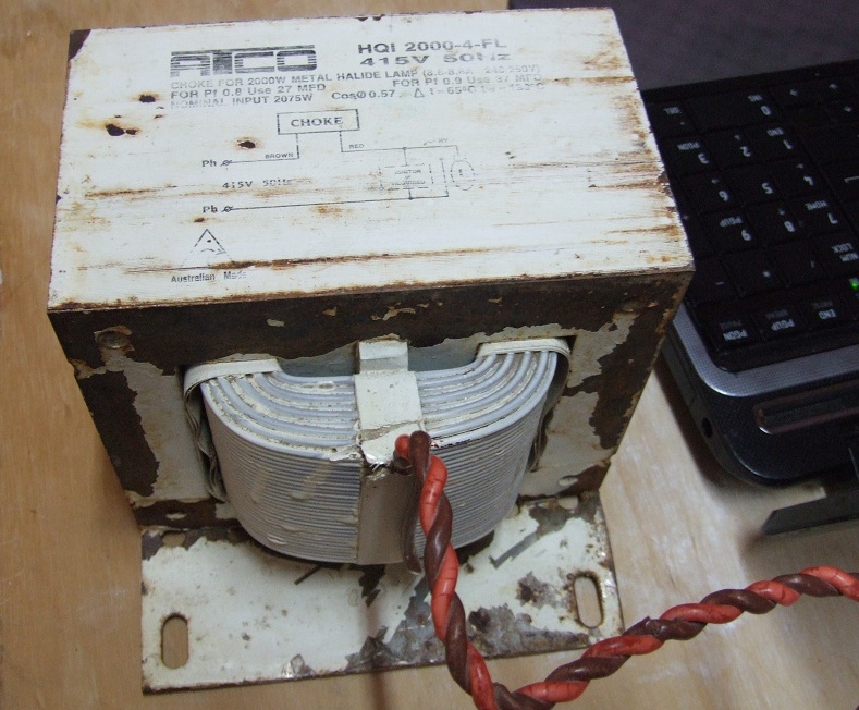

I have wound my own, but there are sources of usable chokes. Sometimes old power transformers. Resistance is a factor, no less for powering an SS class A power amp.Could you point me in the direction of something to use here? Did you wind your own? What is a suitable value?
Lighting ballasts are a good source and I have many for various purposes. I happen to have a pair of these (pictured) which I currently use. I'm sure I don't need them to be this large but they work well. Resistance is 1/4 ohm, L is 100mH.

There is no need to go over the top with lighting ballast chokes and the like.

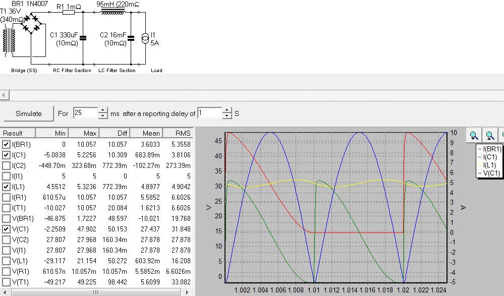

Even if you have vast amounts of money chokes don't really help. I dare say the JLH can reject some power rail noise. Someone might know how much. I doubt enough to work with this idea.
BTW. The oscilloscope agrees with the spectral graph. If using a regulator don't use RMS values as you need peak to peak. The lamps are tough and cheap. I calibrated them first on a lab PSU.

Here is an example choke input supply (ignore the first capacitor, it is too small to be filtering). This supply gives 26mV of clean sinusoidal ripple.. so LC alone is just about quiet enough to use. In addition I like to take an RC to each stage for multiple reasons.. so I can easily get the ripple down to the milliVolt level without resorting to regulators.The purpose in using these is to blunt saw tooth elements
