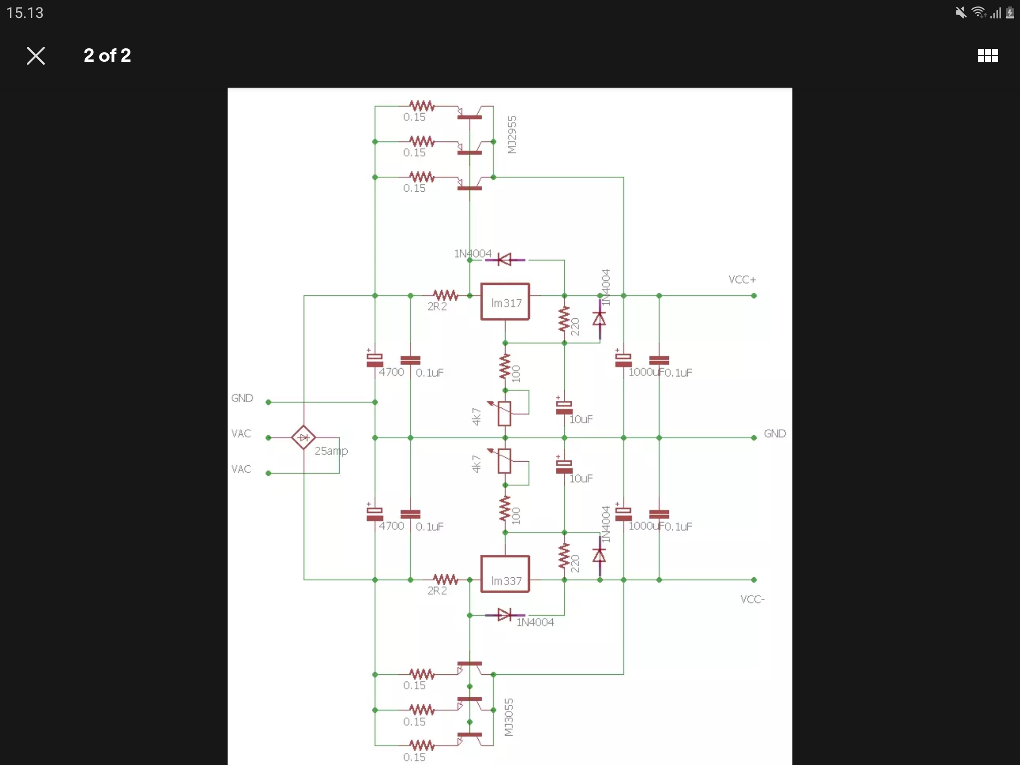

I think a regulator circuit requiring multiple devices is getting a bit too complex and messy for the simple job of powering a simple, low power amplifier. By complex, I mean too much to fine tune or troubleshoot when all doesn't go to plan. You also need at least 2 of them for a dual rail, stereo pair. As Nigel points out, you need good instruments to troubleshhoot supplies and these don't come cheap, nor does some background in linear supplies to know what to do when power circuits don't do what the designer intended.
For an idea of what a relatively basic LM723 application with a single reg. kit looks like, see - link to a currently available kit but the 14 pin DIL chip dates back to 1976.

The problem of using the LM723 as a double positive PSU joined like batteries is it's complex and mildly worrying.
I suspect the Darlingtons will do 5 amps quite well. With a couple of RC filters you could have two sets cheaply. 22 000 uF 0R33 ( x 2 ) 4700 uF ( x 2 ) TIP 142 ( x 2 ) TIP 147 ( x 2 ). The filters not only filter they split the PSU. I think that will sound better. 2 amps current when 0R33 is 0.66V loss. It's also a place to measure idle current. Myself, 2 amps is a bit more than you need. If 1.5 amps used one set should be OK. It is almost impossible to get a non feedback Darlington to work badly.

I like the idea of simple. I am thinking of copying the version linked above.
What is a reasonable target for psu ripple is an amp like this? <1mV?
Any ideas of approx ripple I would get from the LM338? If I understand correctly, assuming something like a 2.5V2ripple after the rectifier, attenuation of around 80db would acheive this. At least as a starting point. I wish I had access to a scope...

Your link shows a rather massive and likely expensive assembly. In the proximity of hot heatsinks, wood is not a good idea for the housing or structural assembly either. If you shop around the aluminium sellers such as awning, window and caravan suppliers, you can often pick up affordable short lengths of aluminium in useful thicker sections like channels, angle and flat bar forms and these can be used to make the whole box and even the heatsinks when fastened with csk screws or even pop rivets if you're in a hurry to begin. I have found some nicely profiled and great looking sections over the years I've been tinkering with DIY builds. I've had to wait months for the right sections to come along though.
Regarding the reg. noise attentuation, there is also the noise of the reg. itself to consider and LDO type regs like LM338 aren't as quiet as some standard types. https://e2e.ti.com/blogs_/b/powerhouse/archive/2017/06/14/ldo-basics-noise-part-1

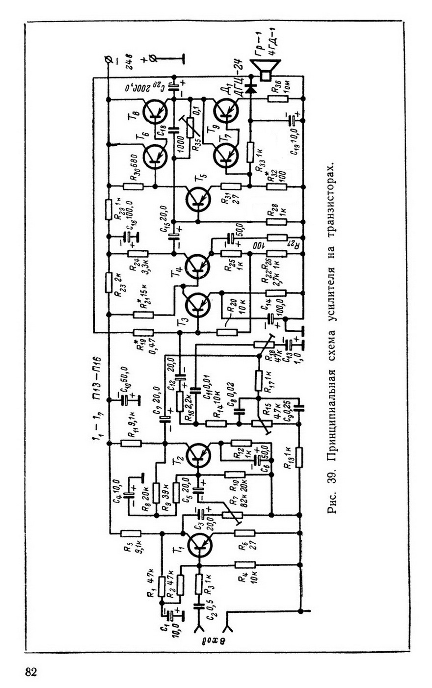

I dug up a 1965 circuit DIY with a floating quiescent current on Ge.
Class A 10 W. Current without input signal 20% of nominal. Phase splitter and darlingtons PNP GE. The current depends on the output signal.

An interesting circuit. Germanium usually meant PNP. I notice primitive Darlington's and AC coupling from the voltage amplifier. If anyone needs to fix such an amplifier MOSFETs work well on lower bias. BUZ 900 or 905. In the shown circuit less likely. Leak or similar perhaps.
