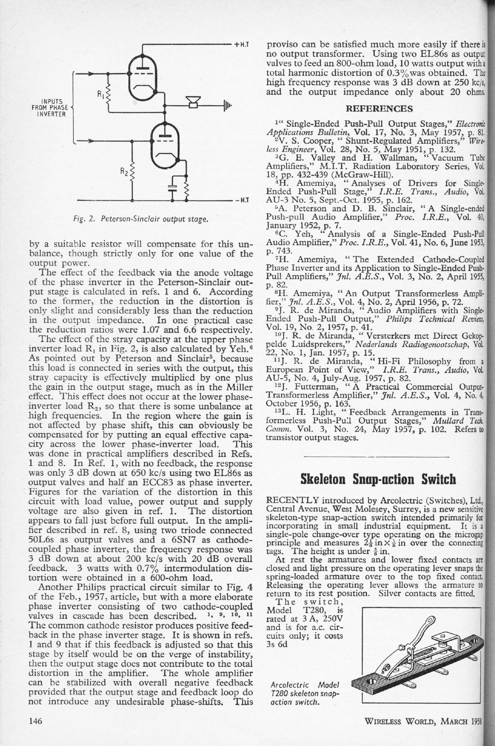

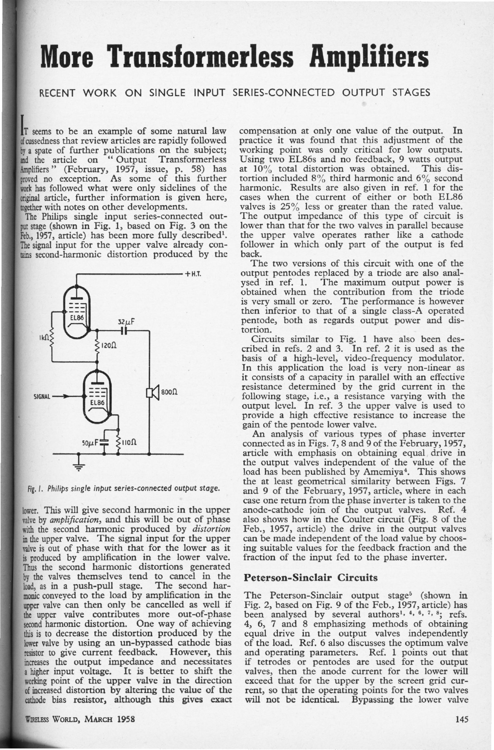

http://douglas-self.com/ampins/wwarchive/More transformerless amplifiers Mar58 p1.jpg
http://douglas-self.com/ampins/wwarchive/More transformerless amplifiers Mar58 p2.jpg
This is a valve JLH in a way. A very famous circuit that almost is a good idea. Take a pentode valve to be very like a transistor. One critical advantage a valve has is it's a depletion device as are JFETs ( mostly, silicon carbide even ) . This means a single resistor can set the current. Sadly the JLH is not as easy to describe. Valves actually auto rest using this single resistor when they age. That's magic! The reasons it works is exactly like a JLH in most ways.
