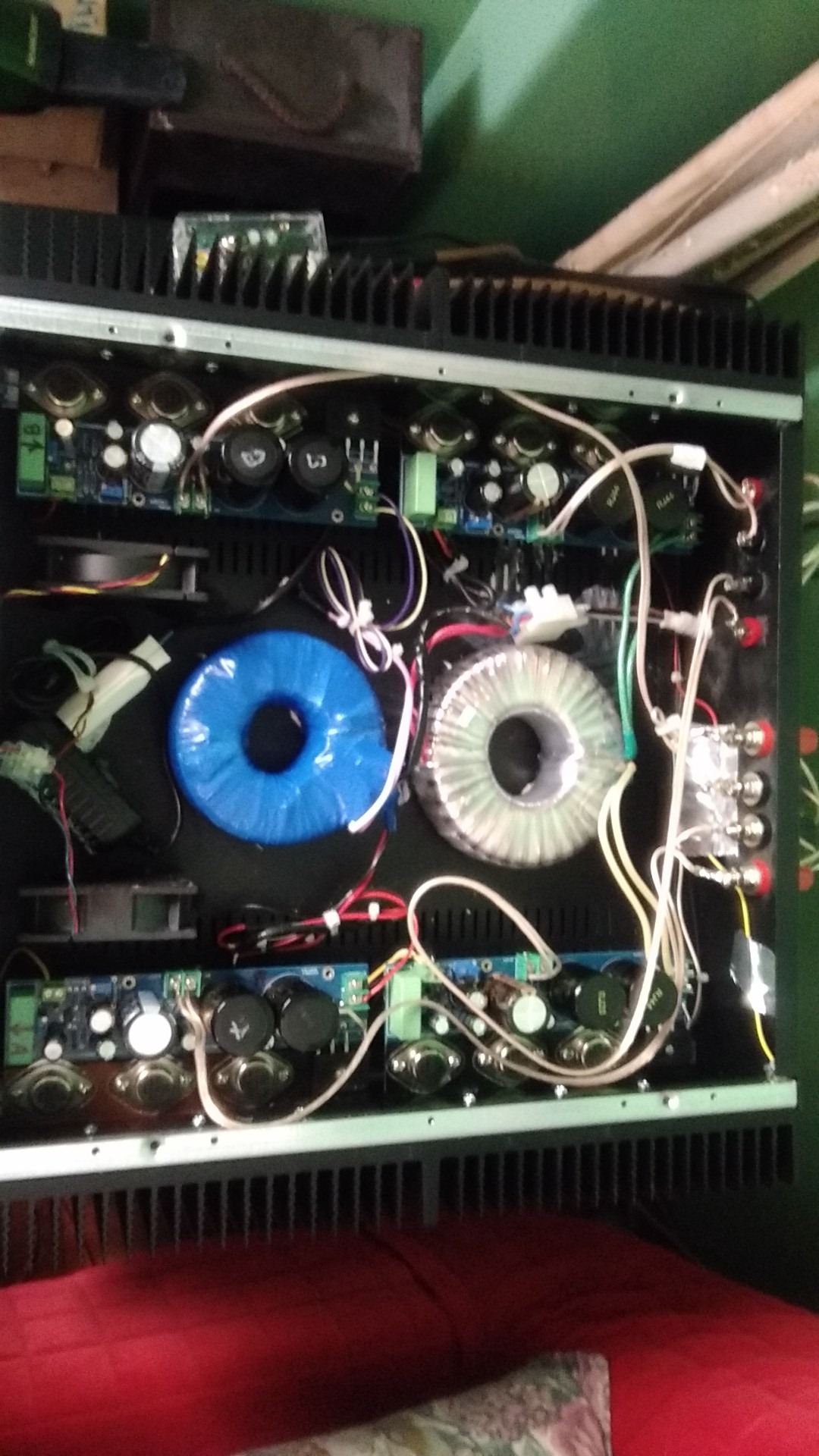

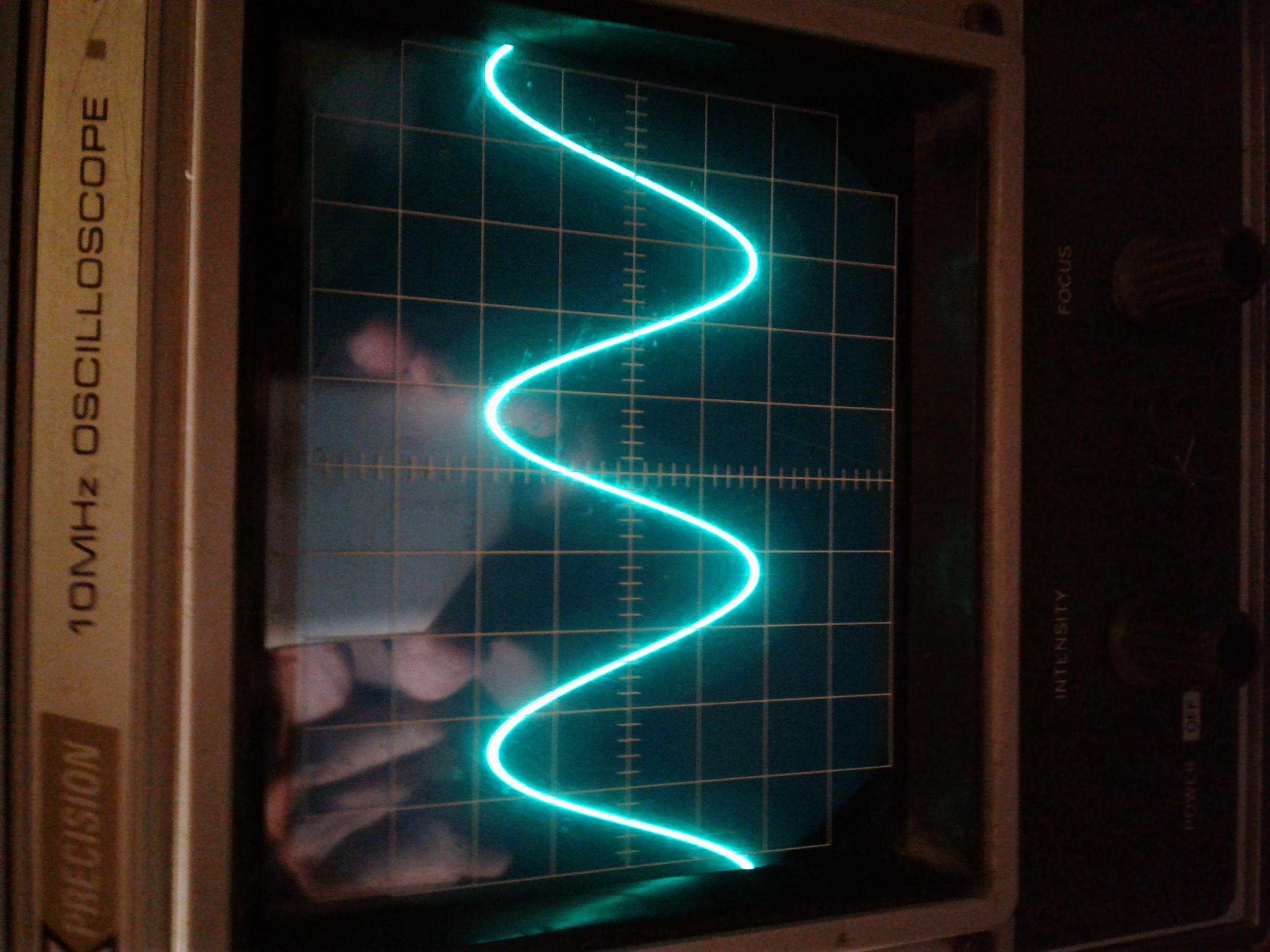

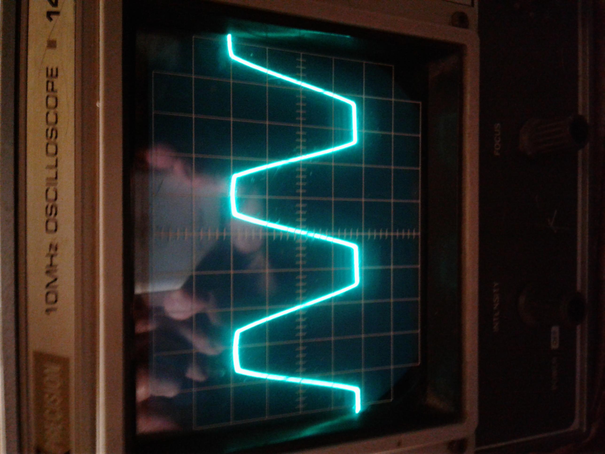

Adjusted to 24v and used the scope to balance the clipping to be equal . The amp is driving a set of will burrow betsy speakers. Bass starts to drop on scope about 100hz. Quite quiet when set to 24 volts. Hiss at 22v when full volume no signal. I listen at 60 to 80 db and sounds fine. Speakers with wide impedance curves will be a problem. The amp did not do well with the model 15 Altecs I tried. I do not know why the wave forms posted vertical.

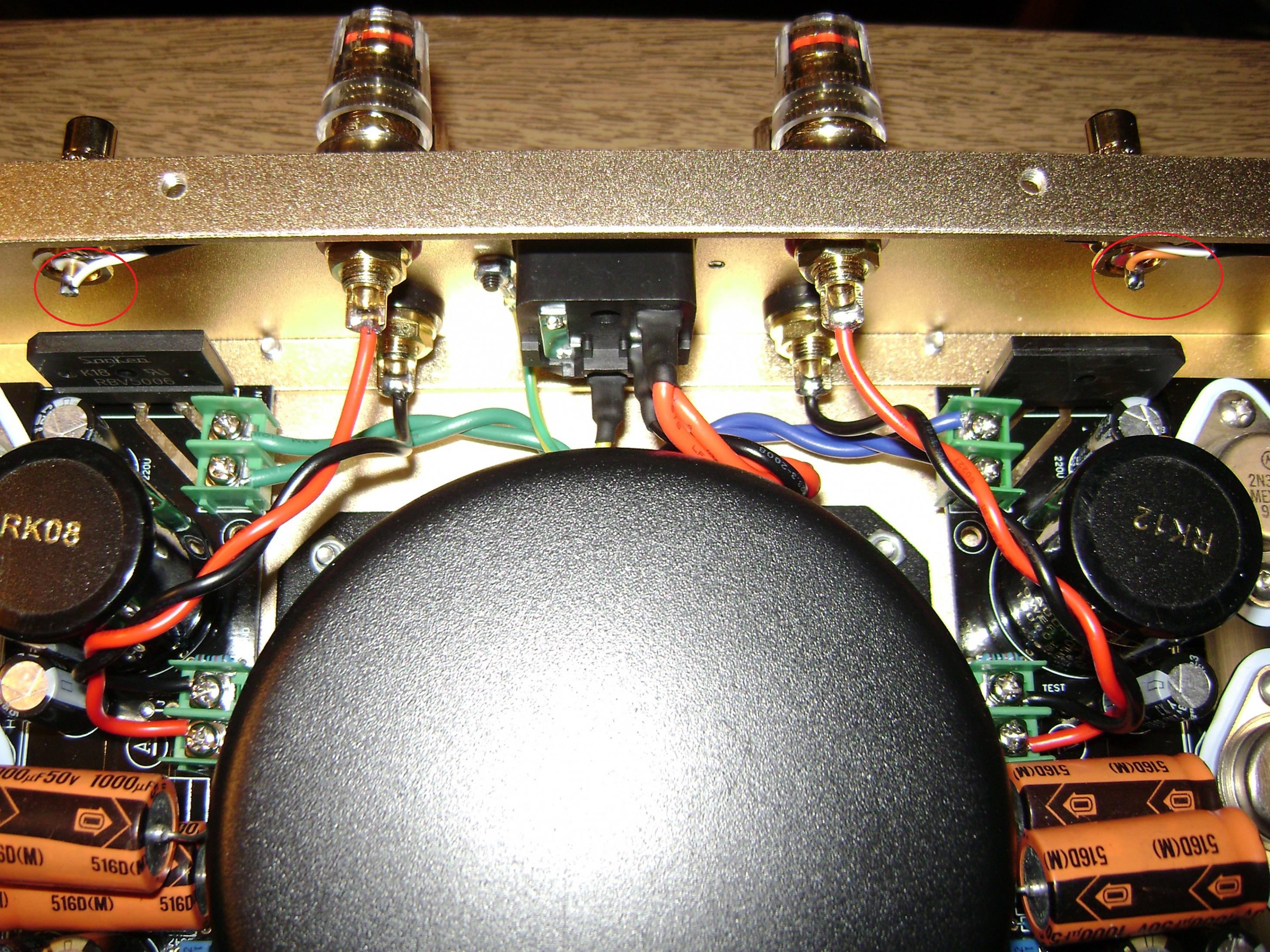

That looks like the "Gold Seal" Chinese built JLH version with some different output caps. For the record, I have a similar one and its nice to use - even has a faked ALPS RK27 volume pot. Perhaps all the component brands are faked but its it's still a nice sounding and very simple little amp., provided you weren't expecting to get the power needed for low impedance, low sensitivity speakers.
Heat's a problem with the small chassis too - the whole thing, including the volume knob goes over 50C in summer and that's not so good for pots or even the gold finish.
