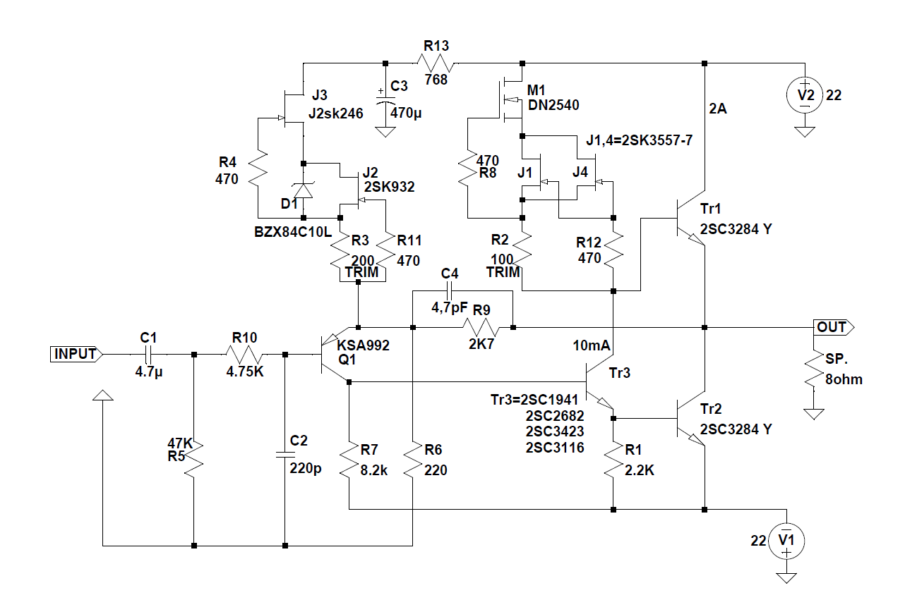

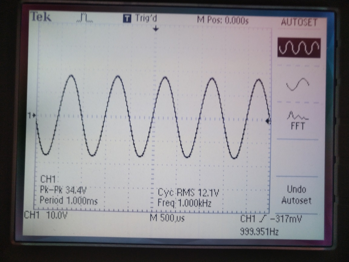

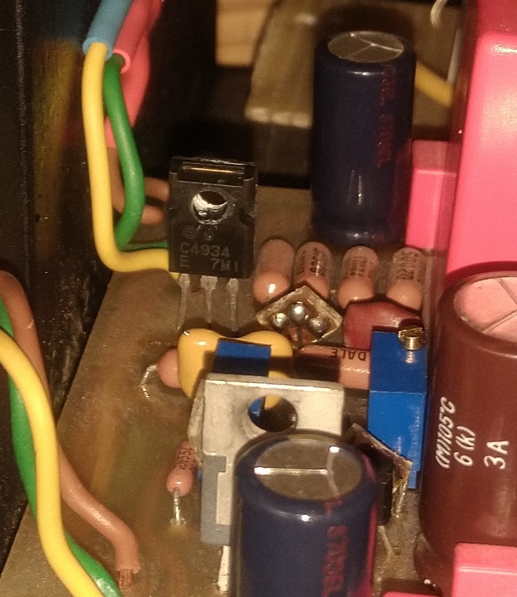

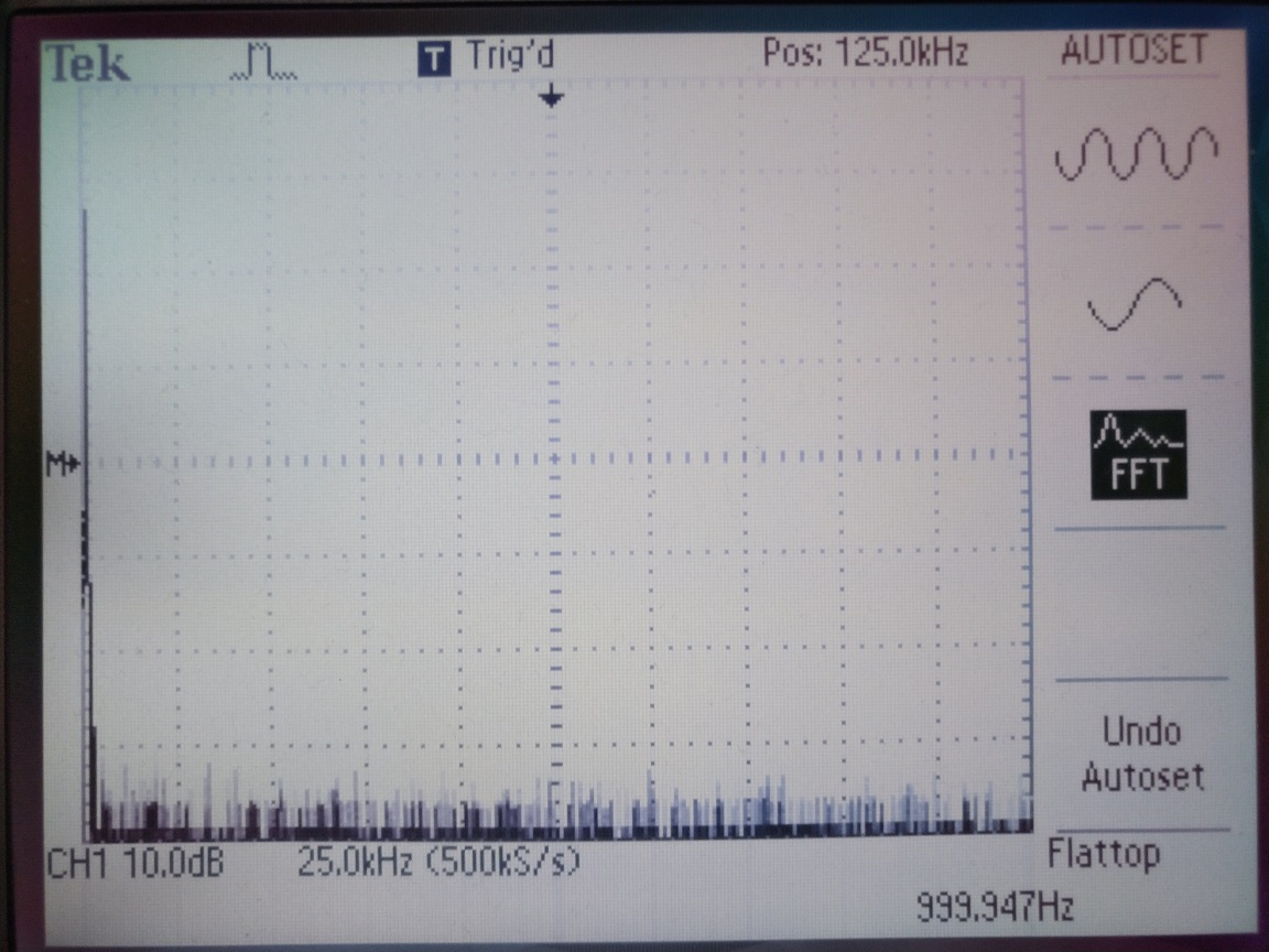

When I talk about fast transistors for JLH69 I didn’t get to that overnight. It took more than a year of desoldering - soldering transistors, oscilloscope testing and hearing tests.
The scheme I used is for dual power supply with two CCS added. JLH himself wrote somewhere that it would be good to try FET as CCS for the input transistor, that's where it all started. For Tr3 due to the higher current I used DN2540. It should be noted that Tr3 is the most important transistor in JLH69 and must be with a higher hFE and a smaller Cob.
The figure shows only one part of the transistors tested for Tr3, the other figure is the test with 2SC4934 as Tr3 and the final circuit.
Use of FET
The attached file shows one example by JLH this was for a phono stage with +/- 50 volt supply rails which is no typing mistake. The FET working voltage needed to be 50 volts. The 2N5460 is not that good but I have used it for illustration. He used some other variations in audio instrument designs.

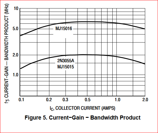

https://cpc.farnell.com/on-semiconductor/mj15016g/transistor-pnp-to-3/dp/SC09270?st=transistors
This is very close to MJL3281 in everything at a bargain price. It would be a PNP version. The MJ15015 NPN is a bit boring. 18 Mhz and good Cob.

The working capital is the gain bandwidth product - like how much to devote to closed loop gain and how much to allow for negative feedback - so if the closed loop gain is increased that reduces the level of feedback.
As far as MJ15016 is concerned the gbp is not 18MHz as the table suggests. At 1A it is 6MHz according to the accompanying graph.
