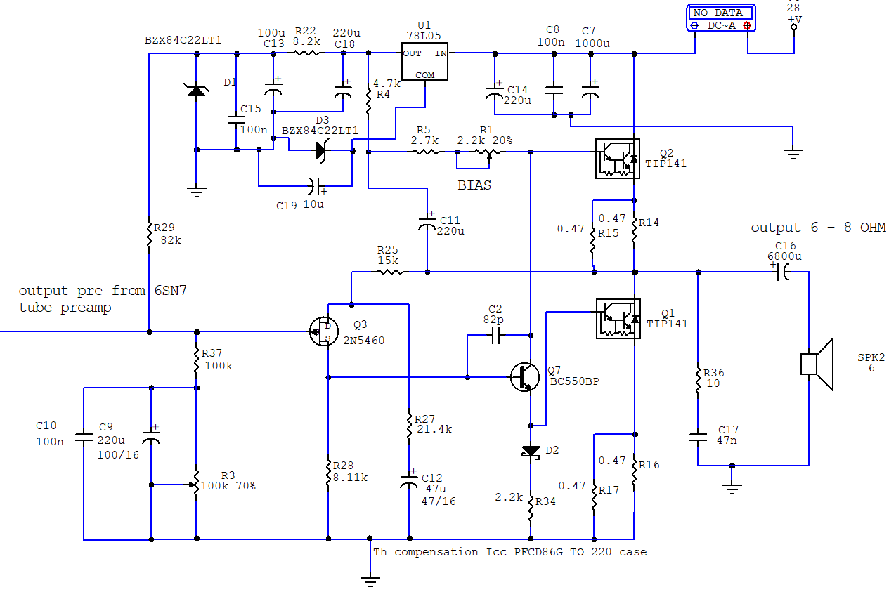

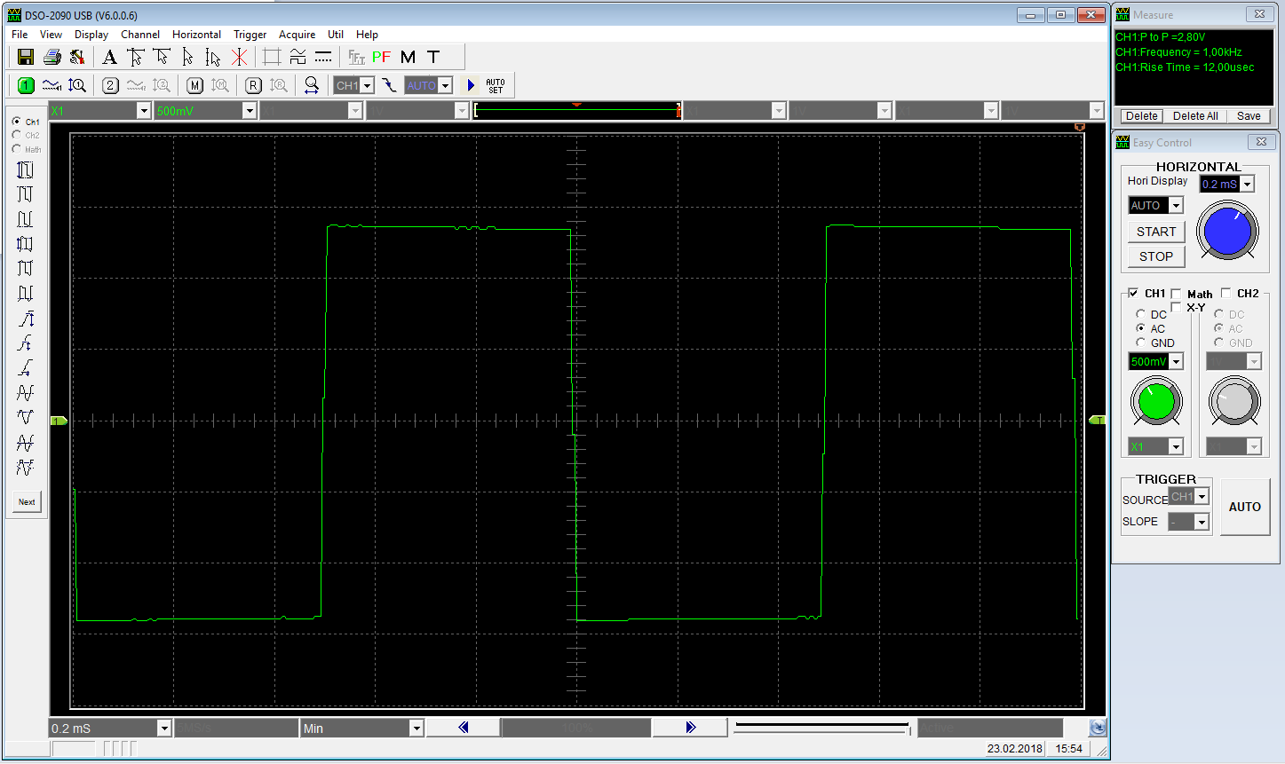

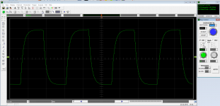

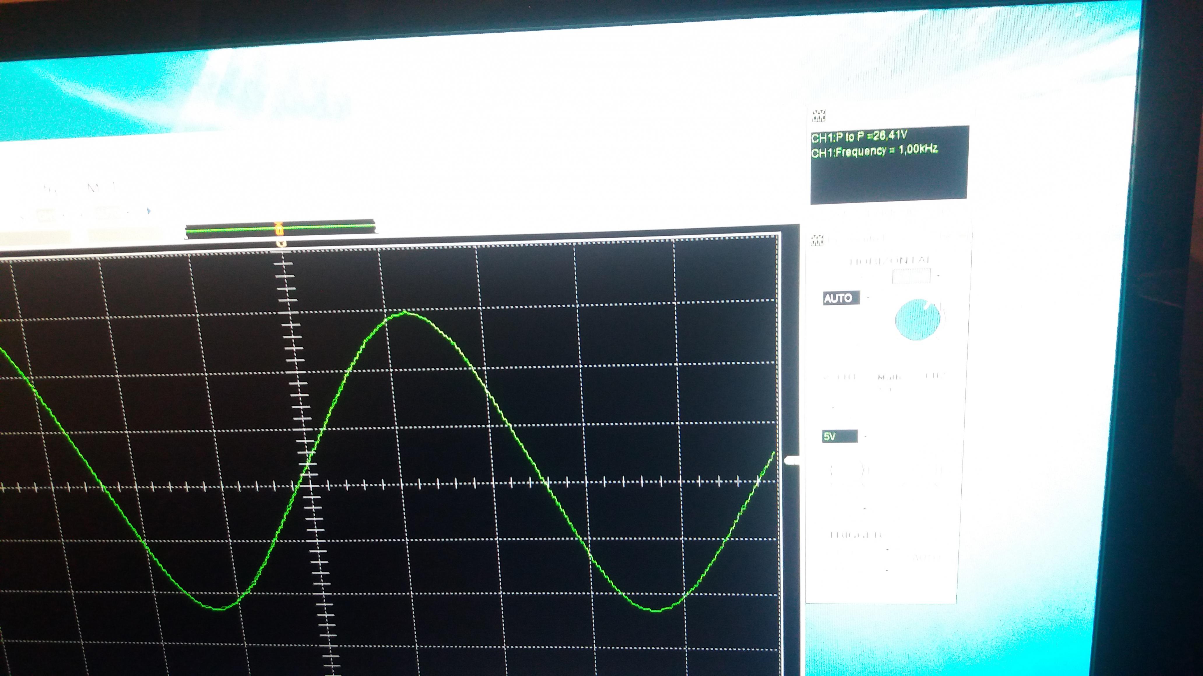

Hello 🙂
Here is my first post.
My name is Mike and I'd like to show You my version of JLH.
I wonder your opinion about this.
Regards. Mike
spec.
- Icc = 1.2A
- U = 28.6V

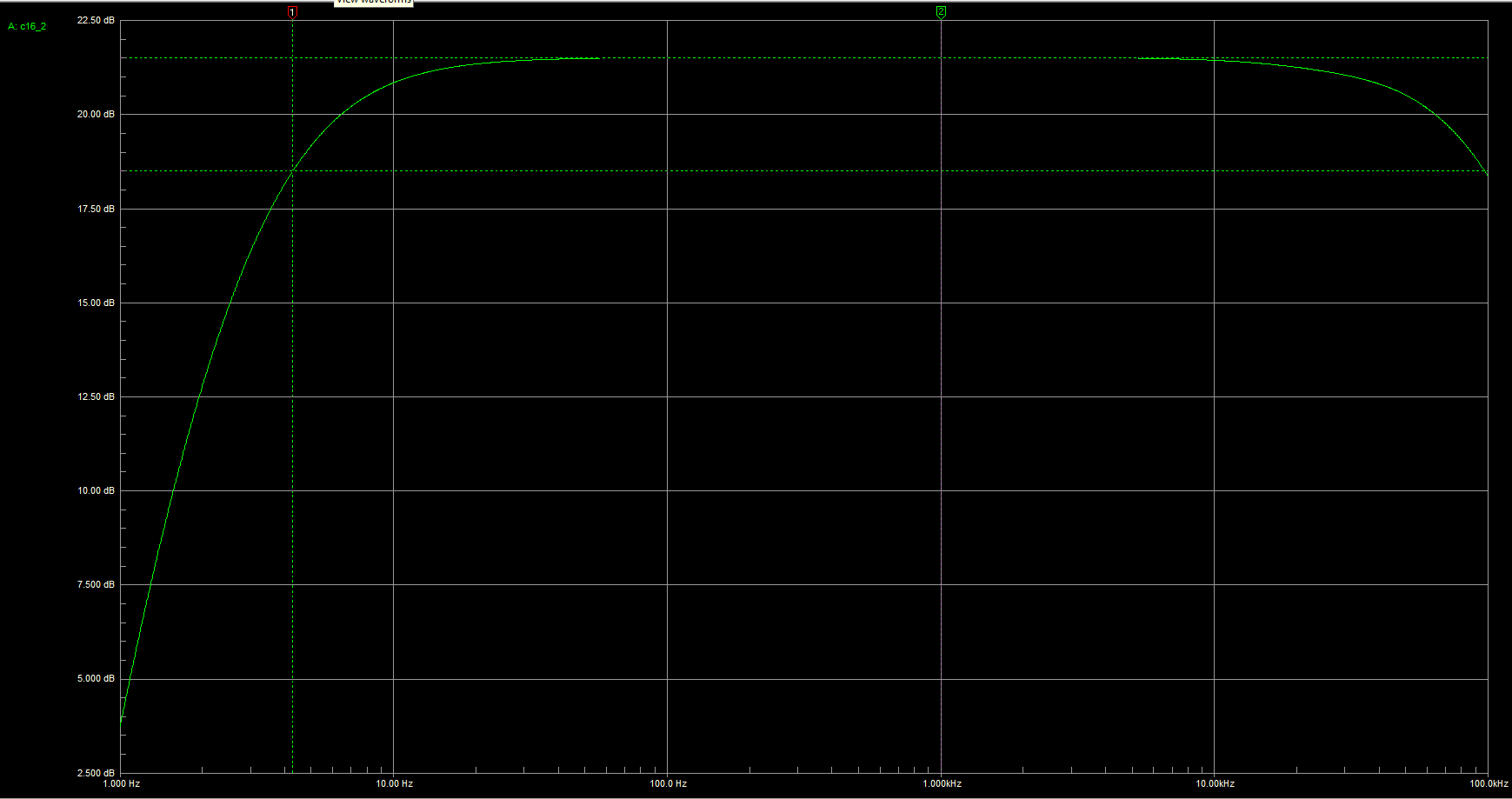

- bandwidth -3dB 4Hz to 95kHz.

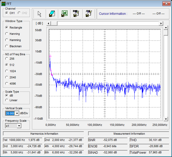

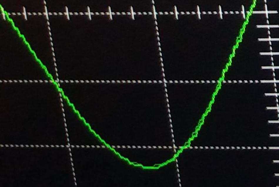

You need to determine whether all this 'noise' and 'hash' is a measurement artefact or whether its real. Until that is sorted out then I suspect you can not go any further.
The applied input voltage should look absolutely perfectly clean.

RE your schematic: are you really using a 5V or is it a 15V regulator?
And the diode in the bottom Darlington: is it a current-mirror or a thermal compensation (or a simple "give me a PN drop because of another BE junction in the Darlington")?
there is a 5 volt regulator with 22V zener diode to ground. It give me a 27V stable voltage.
A diode on the bottom darlington works like a thermal compensation and drops 0.4 volt decrease Ube TIP141. It works good.

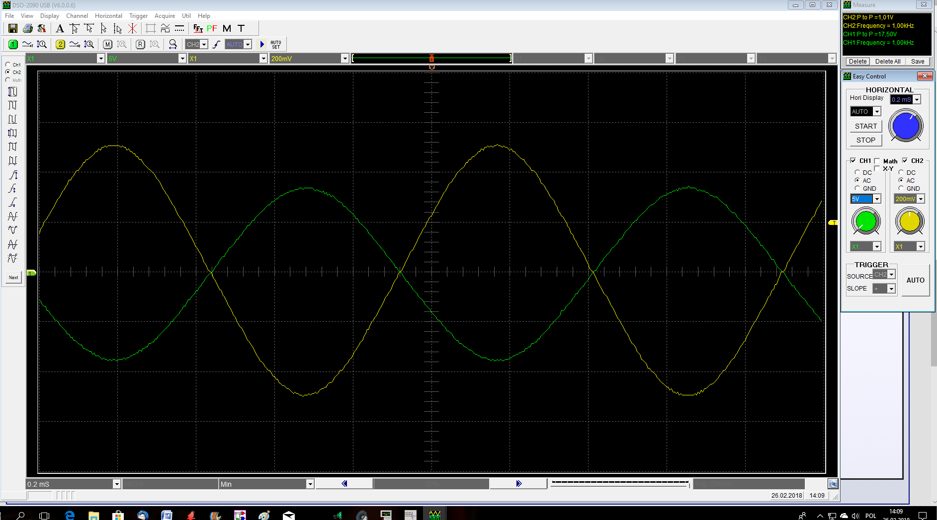

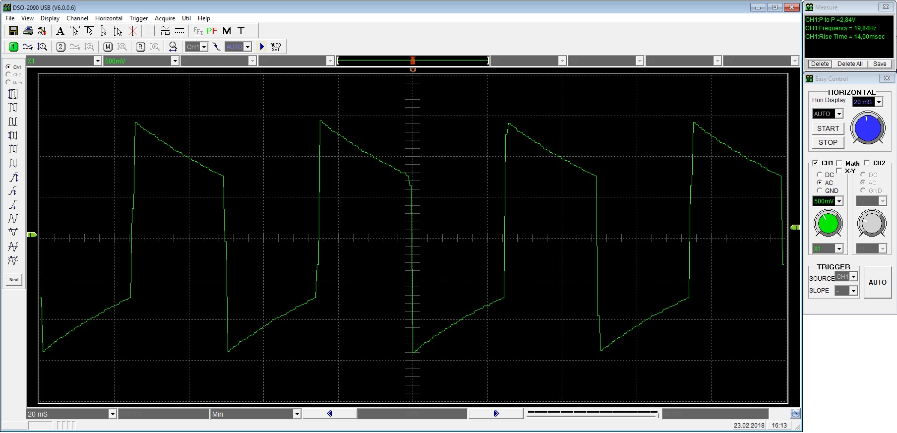

I can't really see how you can make a distortion judgement based on the fact that the signals are so noisy.
Also, your screenshot of the scope shows 1.01v p/p and 17.5v p/p which I take to be input and output voltages. I can't reconcile those figures with the gain of the amp as configured in your circuit diagram. The gain is primarily set by R25 and R27, unless you are including a stage we can not see before the power amp.
