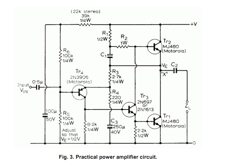

You could use the JLH as Follower (input base Tr 2) or as "single gain" (input base Tr 1)
I prophesy, it will sound much much cleaner than the original JLH;-! The Follower will sound best;-!!! Pure stressless - compared with the amp/s;-)))
Bootstrap remove;-!!!

I know. I minimized the circuit and used it as a line buffer. Would imagine it works for headphones and speakers as well.

Hi cumbb,
Can you show your schematic? Thank you.
The original JLH.
"This" follower sounds better than others! Reason, less complex "drive-supply.circuit", bipolar-transes, no power-resistor. A dream. Amp too;-)

Lets say JLH did listen to the sonic problems of time constants. I guess the best results will be close to his choices. However, you can listen for yourself. If you buy new speakers always try a retune.
The JLH as a follower could work. It would have very low distortion. What might be interesting is to give the amp a gain close to two. That is 2K7 as usual, 2K2 to replace 220R and 22uF 100V polyester to replace 220uF. We now have the option of feeding music into the 22uF which could just about get to full output from a good op amp. Say 24Vpk to pk = 8.4Vrms x 2700/2200 = 11.34 Vrms. That's 16 watts 8 ohms. The output signal inverts so either build an inverting buffer to the volume control or swap speaker plus and minus. It makes a small difference to be in correct phase. The inverting buffer is nice.

The standard non inverting input would have a gain of 1+ ( 2700/2000) = 2.23. That needs 5V rms. The advantage here is the volume control gets both gain and a buffer. It is most likely not the best idea for this style of amplifier. All the same a nice idea if wanting a complete collection of options. I suspect it would need a VAS capacitor ( collector to base on the driver NPN ). 68pF might be where to start. Fit a Zoble circuit of 100nF 4R7 3watt. If the resistor gets hot borrow a scope. I think it will need 33 pF regardless. I tried different ways to do that. The boring VAS cap was easiest.
Below is a headphome amplifier that could do a good job as a volume control buffer. It should do 8Vrms into 2K. The green resistor is an SE class A option for the op amp. As BC337-40 is high gain the op amp will be in PP class A. I tried the dreaded LM358 and saw no crossover distortion just as the makers say into high resistance. It should work with any op amp you like and drive headphones. You would have a input coupling capacitor which I haven't drawn. I did this years ago. This idea could be scaled up to be a power amplifer. Set the gain as suits best. Input resistor can be changed from 10K to a higher value to suit the volume control. If 20 K log I would guess 33K input about right ( 22K min ). Hiss is the problem. Hiss is better than a squashed sound. My instinct is less is more and this gets to be slightly more complicated than I like.

In your headphone amp, best way to place the class-A pull resistor would be between B-E of the upper BJT which makes it a quasi CCS (been there). The way you have it now would on the other hand make it a "Class-RXD", haha - isn't the Class XD a fancy and super smart voltage-controlled CCS? Ohm's law dictates a simple resistor is a simple and stupid voltage dependant current sink.

I can see plenty of ways to make a better version. For a start use 2 x 1N4148 both sides. When the CCS was replaced by a resistor it was great. The green resistor can be to -ve or +ve. 10K would be fine. The data is not bad.
"Class RDX" works wonder with opamps. If psu quality permits, it's easy to sneak 0805 pull resistors into existing circuits (speaking of existing tru-hole designs).
But realistically with opamp+follower circuits, I always try to maintain hygiene and include a couple-ten pF cap between opamp output and -input, corner set at couple 100kHz to keep the transistor out of the nfb at higher frequencies.

I have read in here about op-amps and line-buffers and so on. Could you construct Tr 4 as differential-amp?
Or which points in the JLH circuit we could use for balancing;-?
