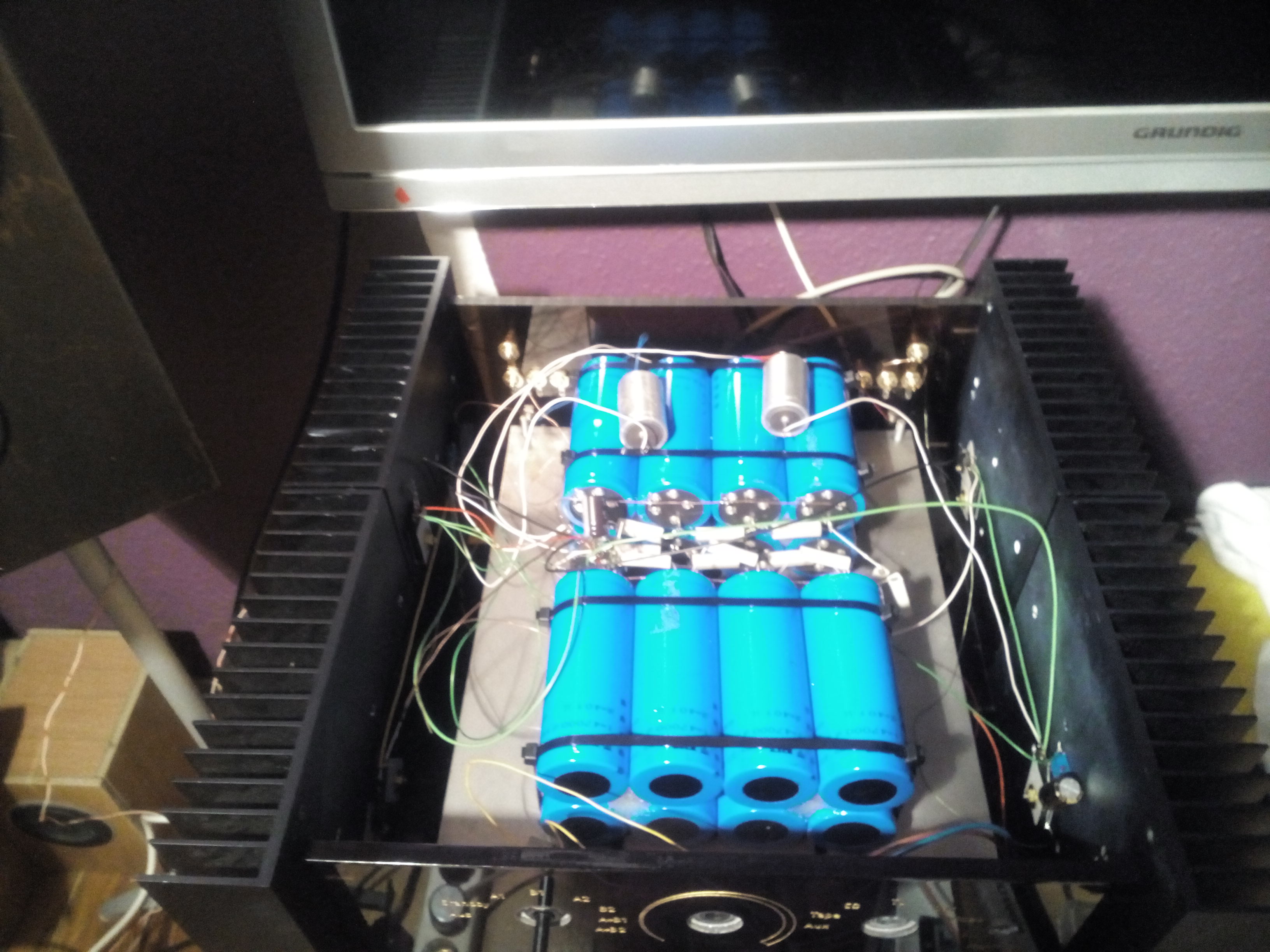

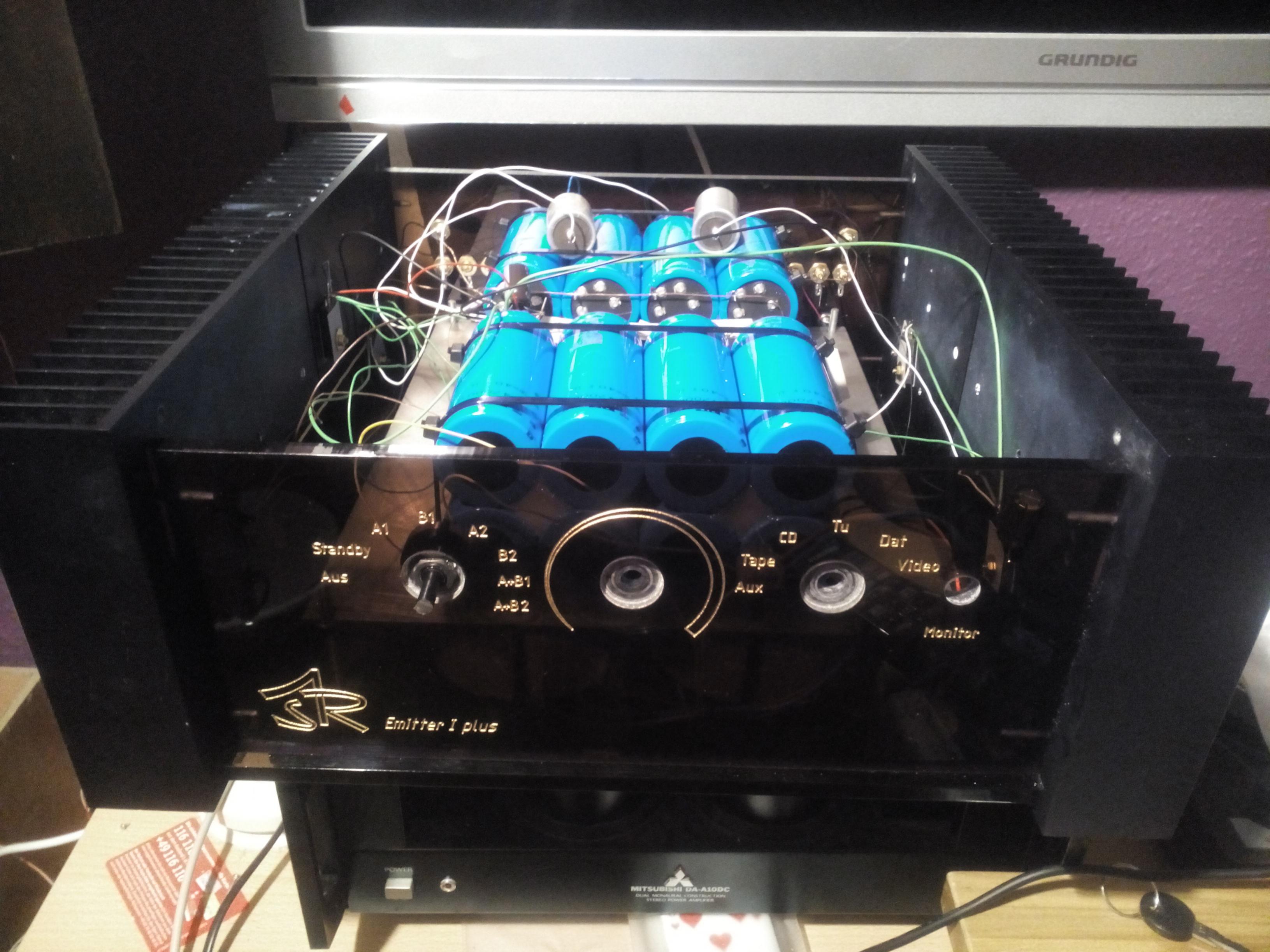

Have build in a REAL EMITTER, 2SC1381 (or so) in the Emitter-casing. A friends amp. May be, the only emitter in the "Emitter" - terrible amp of "S & R" - on earth;-)
Sounds great. Wide, open, clean, relaxed. And so on;-)
Not finished yet.
Not finished yet.
