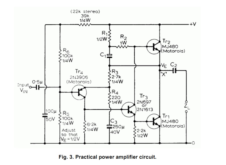

I can't really see how you can make a distortion judgement based on the fact that the signals are so noisy.

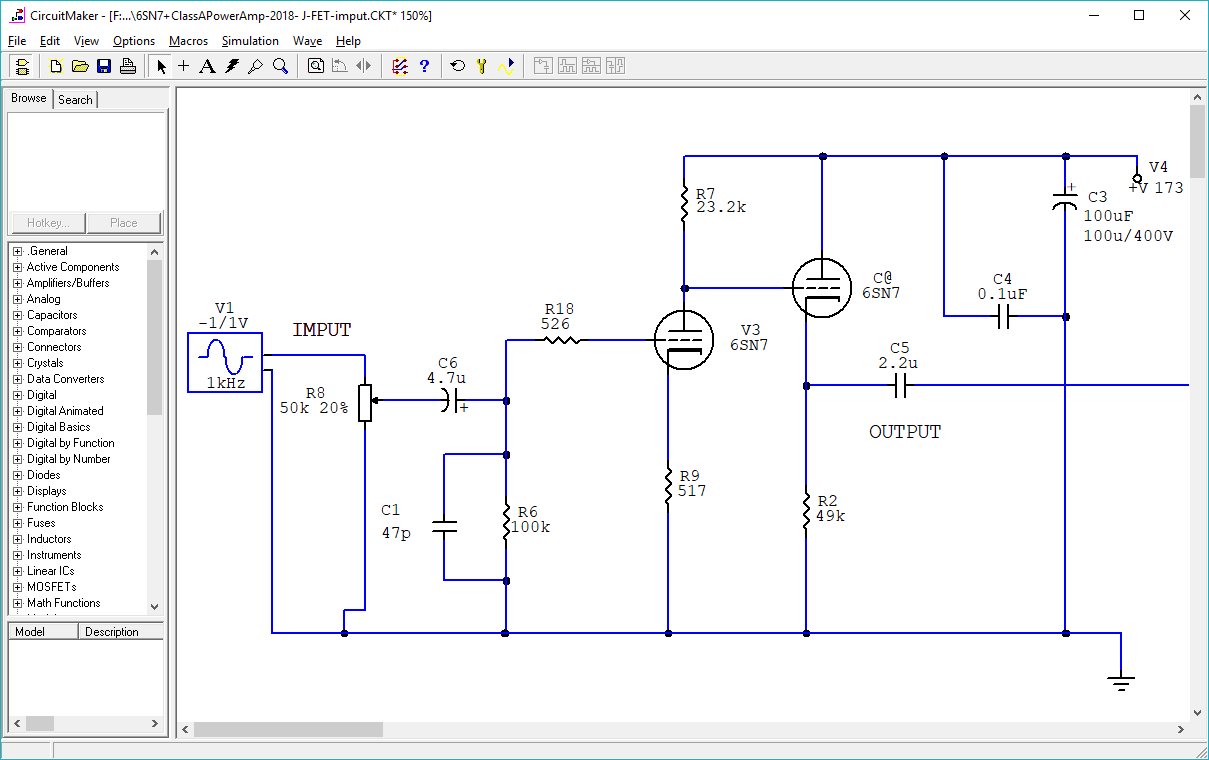

Also, your screenshot of the scope shows 1.01v p/p and 17.5v p/p which I take to be input and output voltages. I can't reconcile those figures with the gain of the amp as configured in your circuit diagram. The gain is primarily set by R25 and R27, unless you are including a stage we can not see before the power amp.
All gain depends on the tube preamplifier increase signal to 17.5dB. J-Fet voltage and power stage of this amp make 4dB more. Whole gain is 21.5dB
