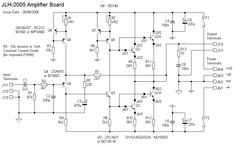

The JLH 2005: There are a lot of things, that prevent a inky, black, deep and depth sound - the most misunderstand as "bass". I would try a lot to get more focus, contour, less noise, less stress.
I would start with removing of C4, C5, C6, C7. And listen;-)
And with the new-solder, as shown below: The "solder-joints with the hole"-) Minimal diameter, minimal material;-!!! And listen;-)
You could continue, to better a little little bit, per cutting the holes;-) And listen;-)
All these works: the complete amp and all your sources. And so on;-)
And listen, listen, listen;-) Compare the amp with itself. The sources too - with itselfs. Not with others. That do much much later;-)))

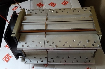

MEGA HEATSINK FOR MY HIGH POWER JLH
I won this mini heatsink on ebay for £50 a couple of weeks ago (without the fan).
It has 8 heatsinks isolated from one another and the frame with Tufnol spacers so I have mounted the 8, MJ802Gs without insulators with just a smear of heatsink paste. With fan its probably okay upto 500watts.
Quick question:
The dual psus using 18-0-18 v 220va transformers with 22mf per rail, are located in a separate box with umbilicals of about 1m long using XLR connectors. (otherwise the amp would be too heavy for me to lift)
In the amp case, there will be a further set of 47mfd caps per rail.
I may fit capacitance multipliers but does it matter whether they are in the psu box, or in the amplifier case?
Personally I took out my cap multipliers and replaced them with big caps (10000 uF in series with 0.15 Ohm in series with 22000 uF per rail per channel).
That learnt me how my amp sounded "shut in" with the cap multipliers. After reading some more up on those I suggest that you can put the multiplier anywhere you like as long as you put some serious caps close to the amplifier board (eg 10000 uF per rail per channel).
The only reason to fit cap multipliers is a cheaper method of hum reduction so they will be a last resort.
I don't think enough consideration is given to inserting active devices in series with the supply rails as they are effectively in series with the amp's output devices and of course, the load so its no surprise that they have an audible effect.

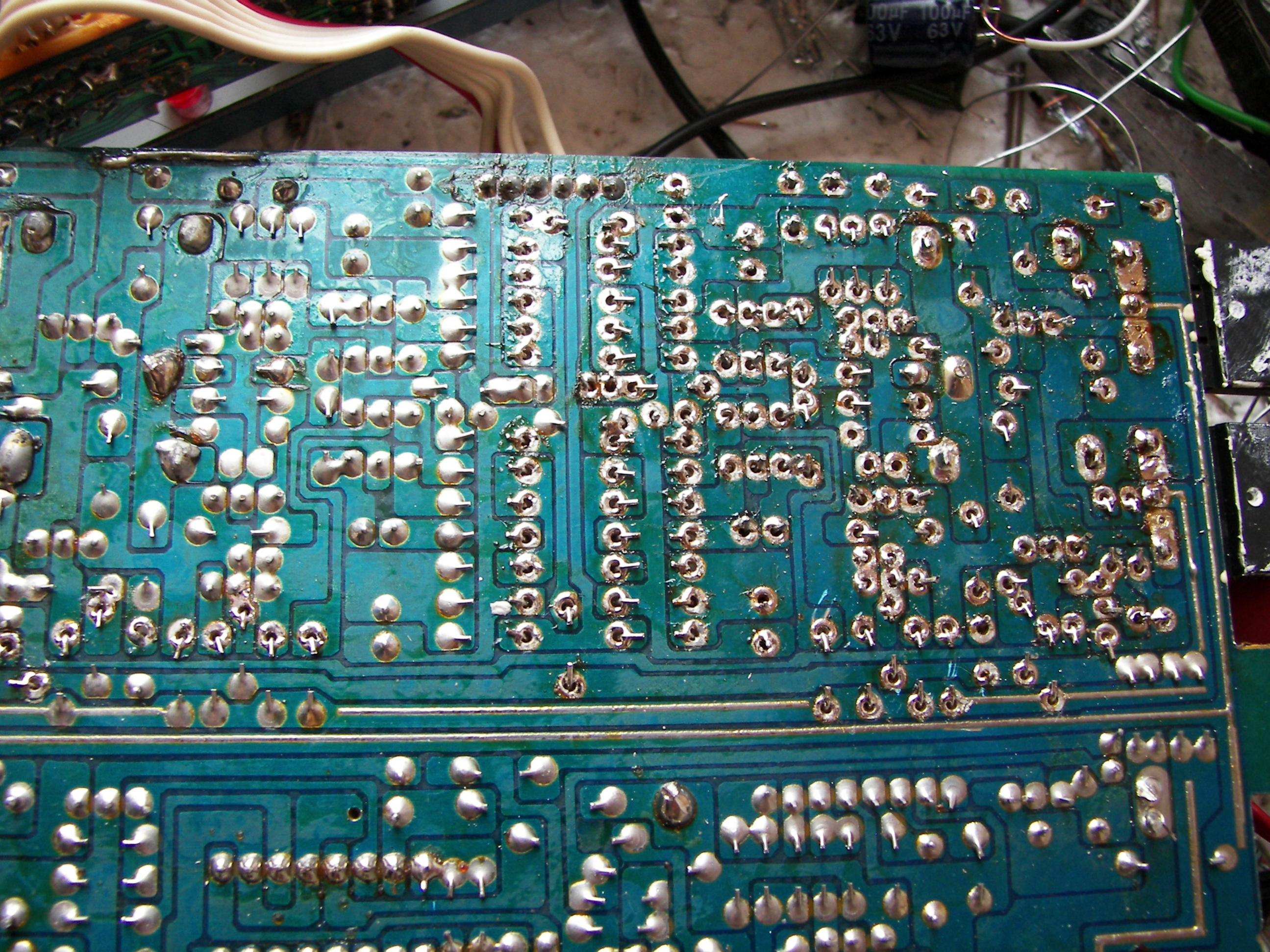

Right, more bits are in and it's going together. One problem I am having is with dry joints, or more specifically the solder not wetting out on the board. It's as if it's oily, but I have degreased it with meths. My soldering technique is OK (it certainly used to be back in the day) but I am finding the solder is going onto the lead but isn't wetting onto the board. It sits in a round bead on the lead instead. The solder is old stock Altai or similar, so it's good stuff. Am I missing something WRT board cleaning?
Sorry for the stupid question, I ought to be able to solder, and normally I can. I'm just not getting those nice tapered joints that I should.
If you are heating both component leg and pcb pad at same time and it s not soldering right then could be pcb is contaminated and needs cleaning with proper pcb cleaner.
Are the pads shiny ? if not then it sounds like the pads are contaminated.
