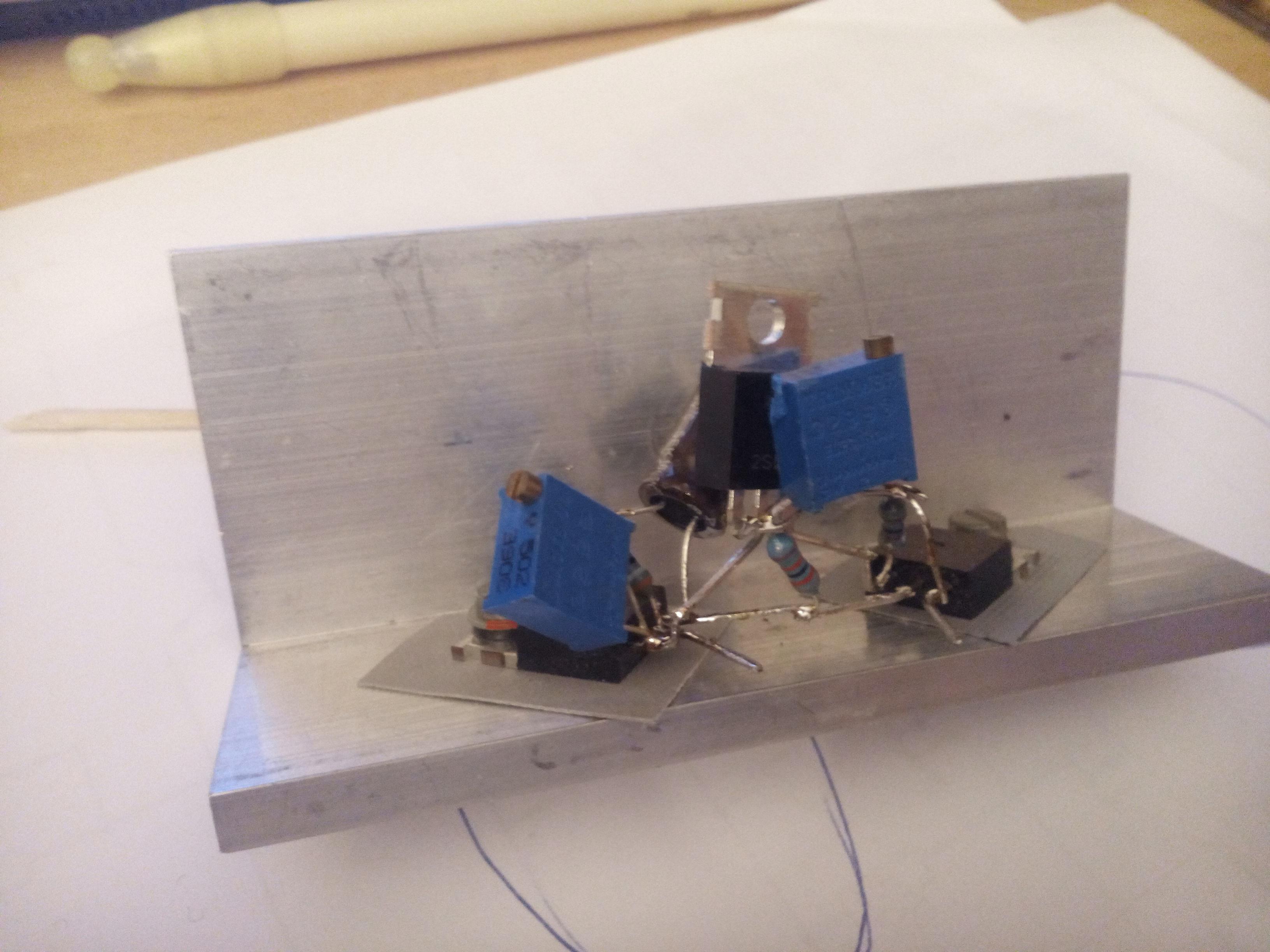

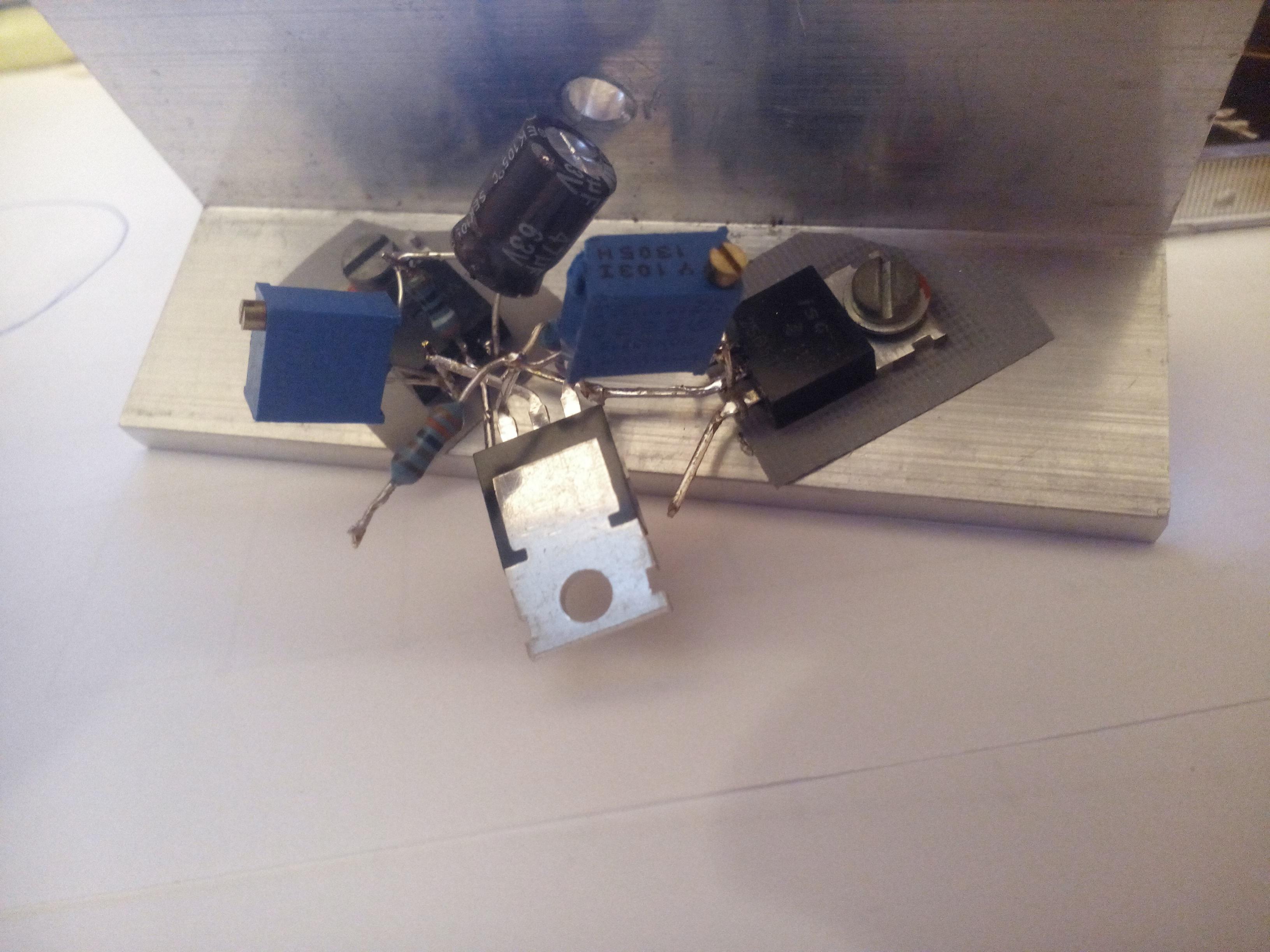

JLH without the first transistor. And shortening of some parts. 10 minutes to do. Sounds ... wonderful;-)
You do not need a board! Sounds ugly! Unnecessary materials and horrible solder jounts and resonances and paths ...-(
Now TO-220-transistors.
May be, christmas I will finish.-))))

Any TO-220 or TO-247 I would use.
LG
A little bit better;-)

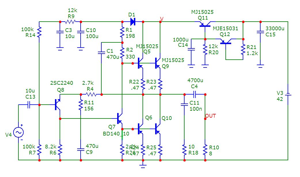

Here is the power supply I shall use for the data. Any idea what current I should set the output stage to? 42V is about where the lowest ouput voltage sits ( with RC filtering 40V ? ). My heatsink at a guess is 0.25C/W. It takes 8 T03. If 1amp and stereo I guess it would sit at 50C max. I have two heat sinks if required. My friend has a Krell and BBC LS5/9. She won't mind if the JLH is better. That's the plan. The bigger plan is to use the cheap switchmode SMPS. I have data somewhere on that PSU. For very little money I made it work well. Alas I have no idea where I put that data ( file name ). It was a true class B working at constant power after me being fed up with class D repairability. Using the SMPS for the first time in my life I got full class B efficiency. The transistors TIP35/36. The thing I didn't think of was the power supply was at high current all the time just like class A. That's all the data I need. It was a very reactive load. It was great to see the SMPS have a think about the load, the little protection LED slightly dims on starting. When the linear supply goodness knows what the starting current was ( far less than 1R initial load ). The TIP35/36 are tough. All the same I prefer the junctons don't need to prove it. Sorry to talk about the 303 so much. Often the 303 and JLH are the benchmarks of the era.
LRS-100-48 | Mean Well 110.4W Embedded Switch Mode Power Supply SMPS, 0 → 2.3A, 48V dc | Mean Well
This is from TubeCad I think ? This will be my starting point as the starting values are useful. I suspect the current limiter of the SMPS will keep me out of danger. For many reasons Christmas day is not the best for me. I will cook a meal and the usual. Starting this project will be an excellent distraction. Any circuit observations?
I might do a PSU test first if I can find a large resistor for a load. If I can I will post noise to 400 kHz and ripple. I am going to try a very JLH type voltage regulator idea. I only have 2V to play with so wish me luck. I suspect it will have to be the amplifier itself. 14R 60 watt.
