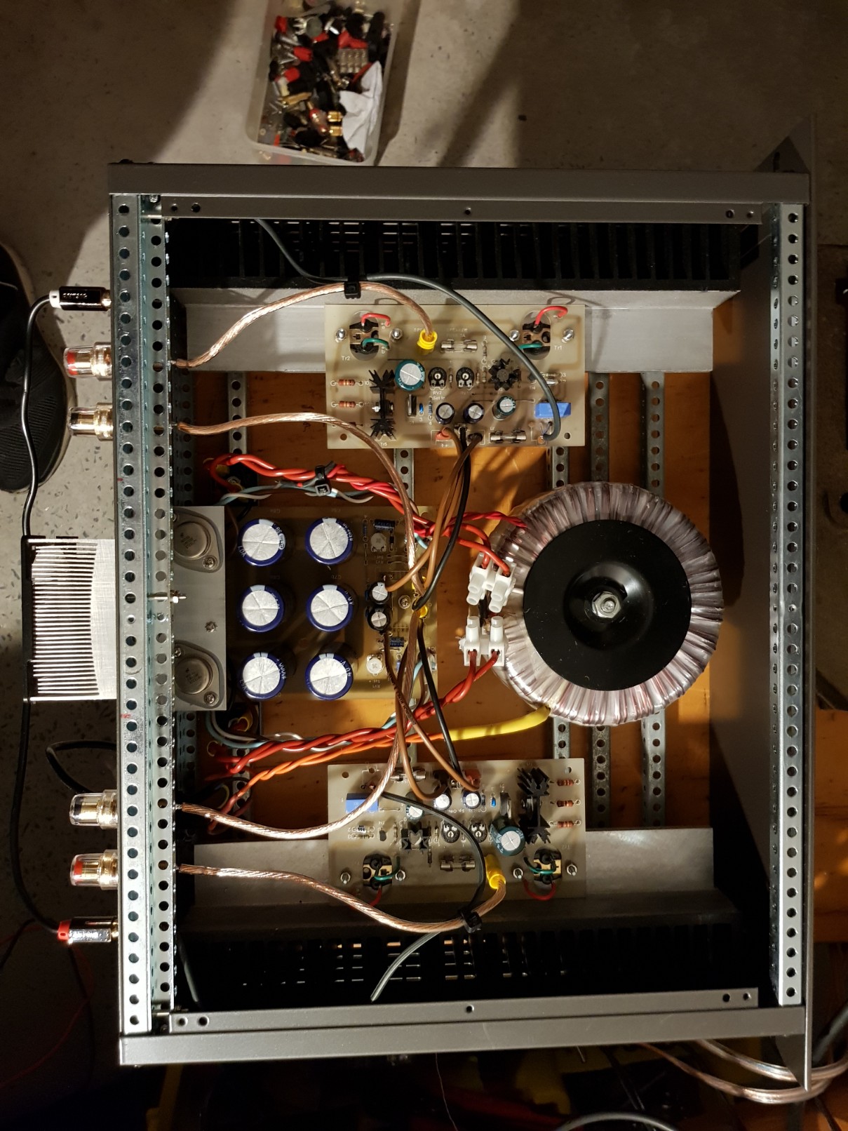

Here is my build of the 1996 circuit with MJ15003 output stage. and LM338K regulated supply running 22V rails @ 2A bias continuous.
Xfrmr is 625VA
Running about 30,000uF per rail
-Dan

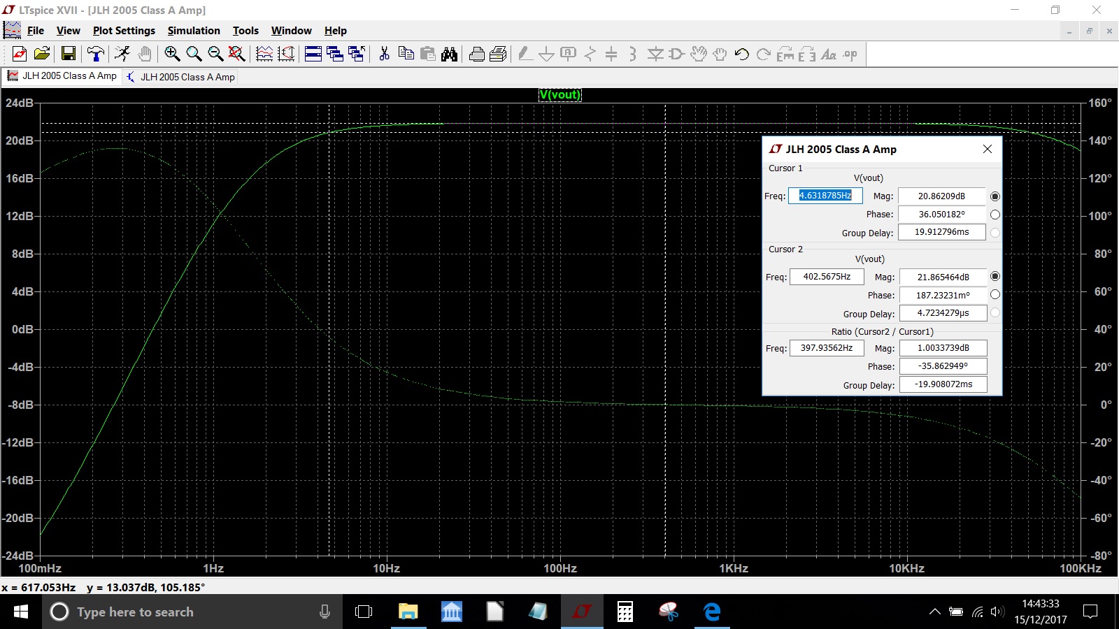

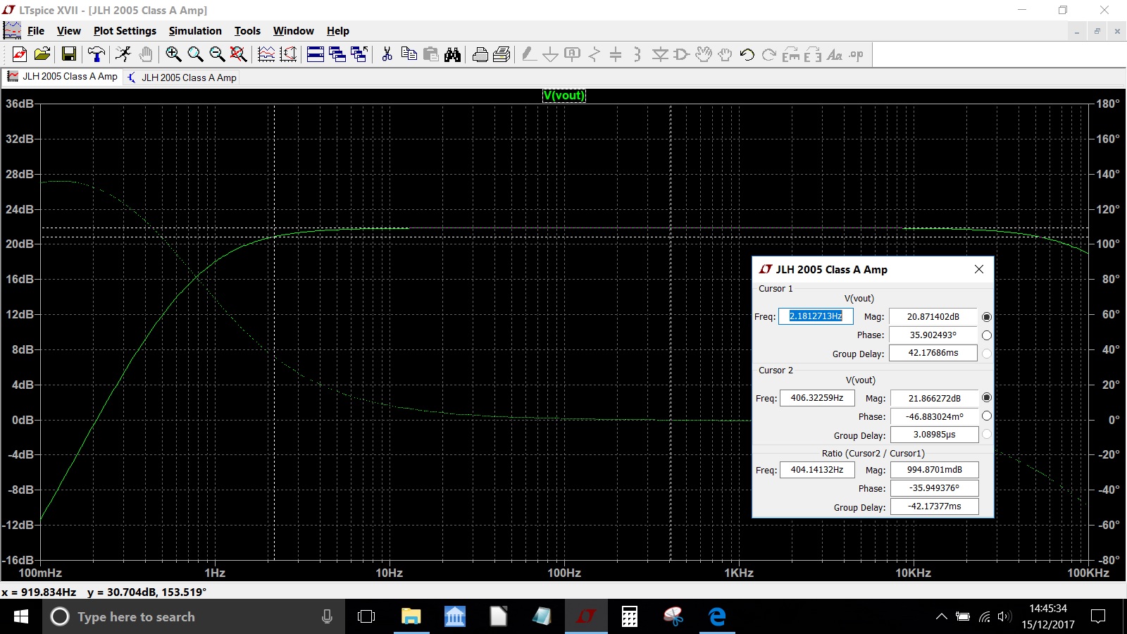

Iq will not affect the frequency response. In the circuit you posted earlier, C1 and C3 are the only ones to affect response.
As it stands with 2.2uF and 470uF the response is -1db down at 4.6Hz. Make those caps 4.7uF and 1000uF and you get to 2.1Hz approximately.

Hi Mooly,
thanks for the very precise and detailed information, it will mean that I will try to work on those 2 capacitors to get an improvement.
However, I would also be content with the theoretical results you expressed if it were not that in practice what results in my case does not satisfy me.
Thanks anyway, ensuring that my next intervention will be aimed at C1 and C3.
