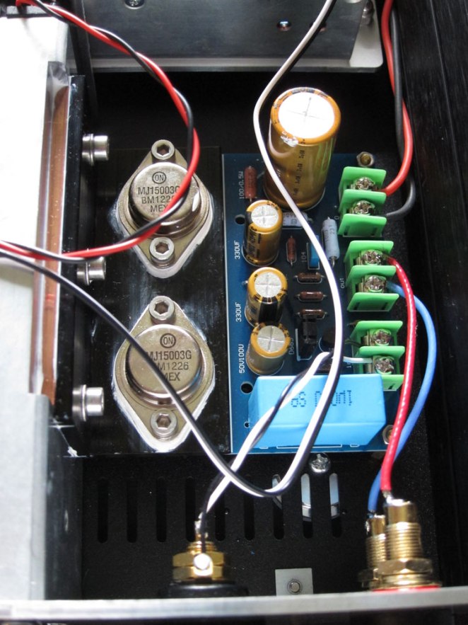

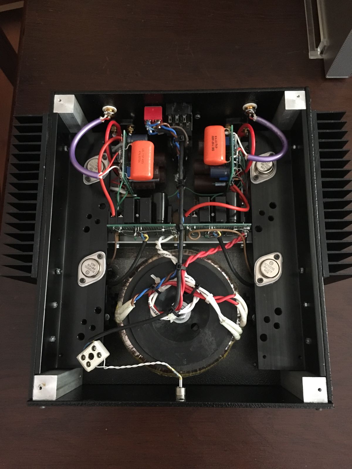

Hi everybody,
This is my latest DIY and IMHO, with the right speakers, is also one of the finest sounding amplifiers for the DIY hobbyists.
Thanks for JLH.
It is JLH 1969 single supply.
I built the circuit point-to-point on four double sided fiberglass perfboards, two for capacitance multiplier and two for signal circuits.
Transformer is toroidal 300VA 2 x 18V.
Capacitance multiplier is exactly Rod Elliott’s recommended circuit.
No noise, no hum, one of the most silent amplifiers that I used but keep in mind that I am mostly into tubes.
The only drawback with Capacitance multiplier is voltage drop. With the same transformer for Gainclone etc..I usually get 24V-25V B+ with CRC Power Supply. Now B+ is 22V with Capacitance Multiplier.
Transistors are modern versions;
BC560 for input, 2N1711 for driver and MJ15003G for output.
Capacitance Multiplier transistors are BD139 and TIP35
All signal board electrolytic capacitors are Elna Silmic II, output bypass and zobel caps are Vishay MKP1837. Input caps are Orange Drop 716P.
All PS electrolytic capacitors are Panasonic 105oC.
With 22V B+ and 1.45Amps bias, I am guessing around 7 Watt output.
The case is my old tube preamp case, I rebuilt it and drilled many holes etc..Paint is electrostatic with some granules or particules in it (sorry I don’t know the terminology of this paint).
Front is natural Rosewood.
I chose this version for originality, simplicity and speaker DC protection by output capacitors.
I am using it in my secondary system with New Large Advents. I also tried it in my main system with Triangle Octant dipoles.
It is like Denon DL103 cartridge of amplifiers.Full bass FQ, big, bold and a little bit warm sounding but also naturally detailed and dynamic.Also spatially good.
It is also relatively inexpensive to build and if you have highly efficient speakers with benign load an excellent amplifier to live with.
Now it is time to complete First Watt F6 project until summer.
Hakan
PS:I don’t know if it’s because using modern high FQ transistors or not, at first, amplifier oscillated a bit, especially with the tube preamp.
Then, I put Zobel 100nF + 10R and 2uH coil parallel to 10R at the output.Plus Low pass filter in addition to input cap + R(high pass).
Now amplifier is stable with my any preamp (passive or active) and speakers.
For this one, many thanks to AndrewT for his writings on this subject.

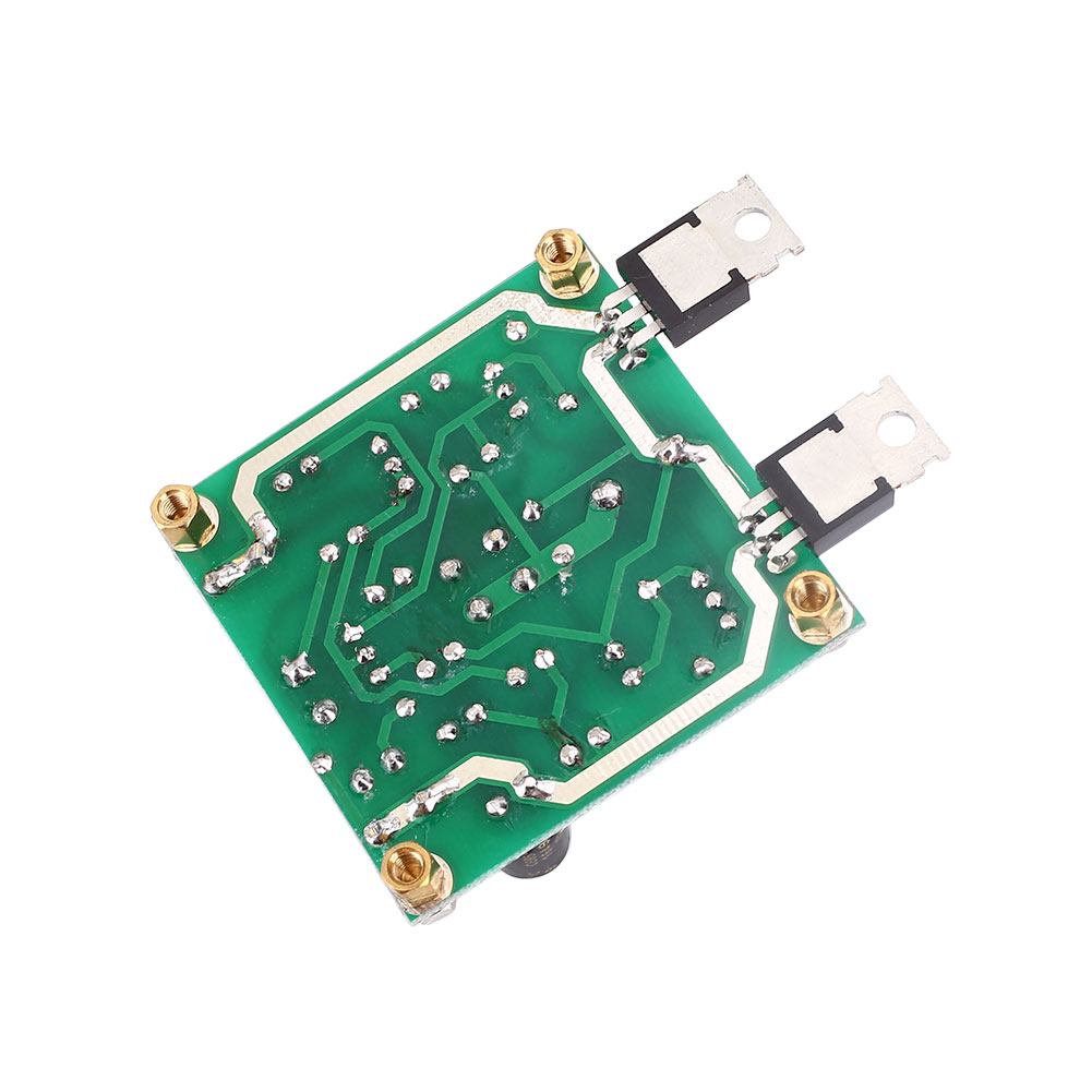

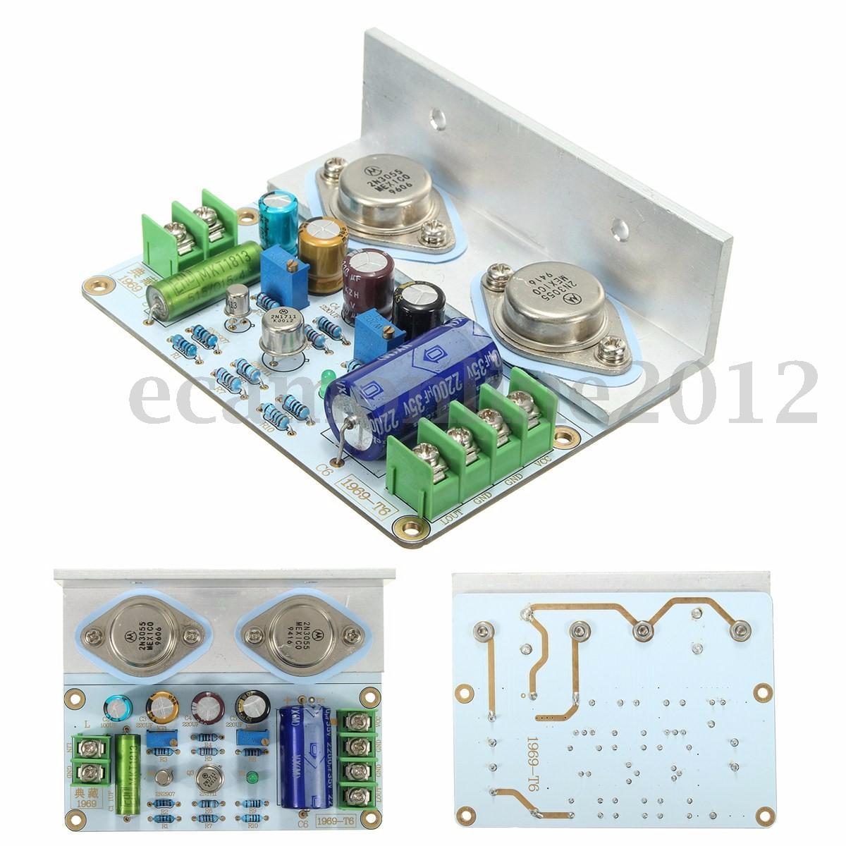

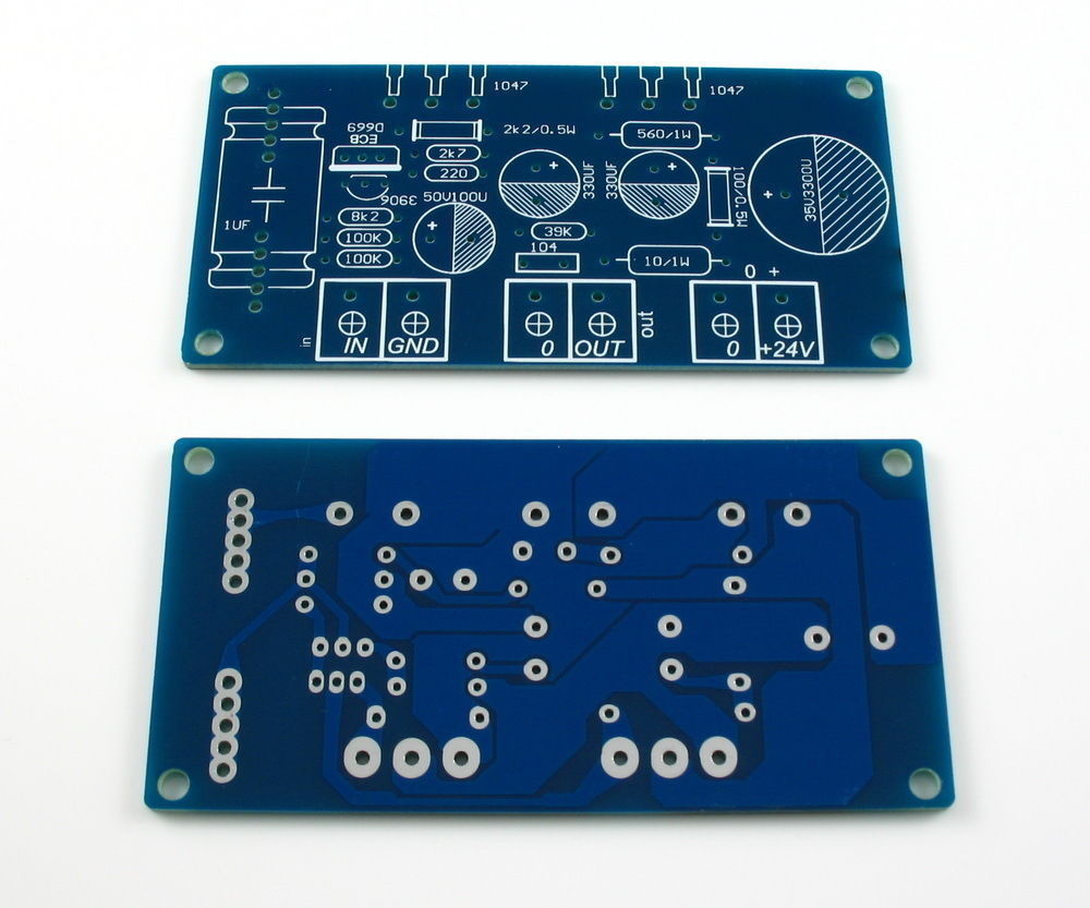

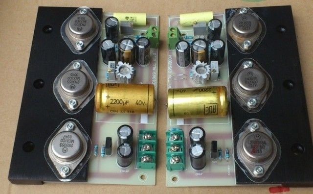

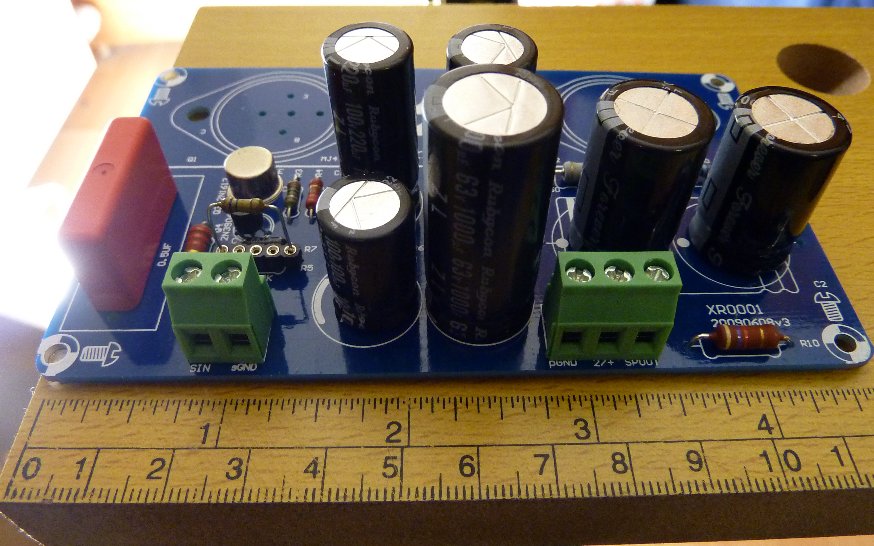

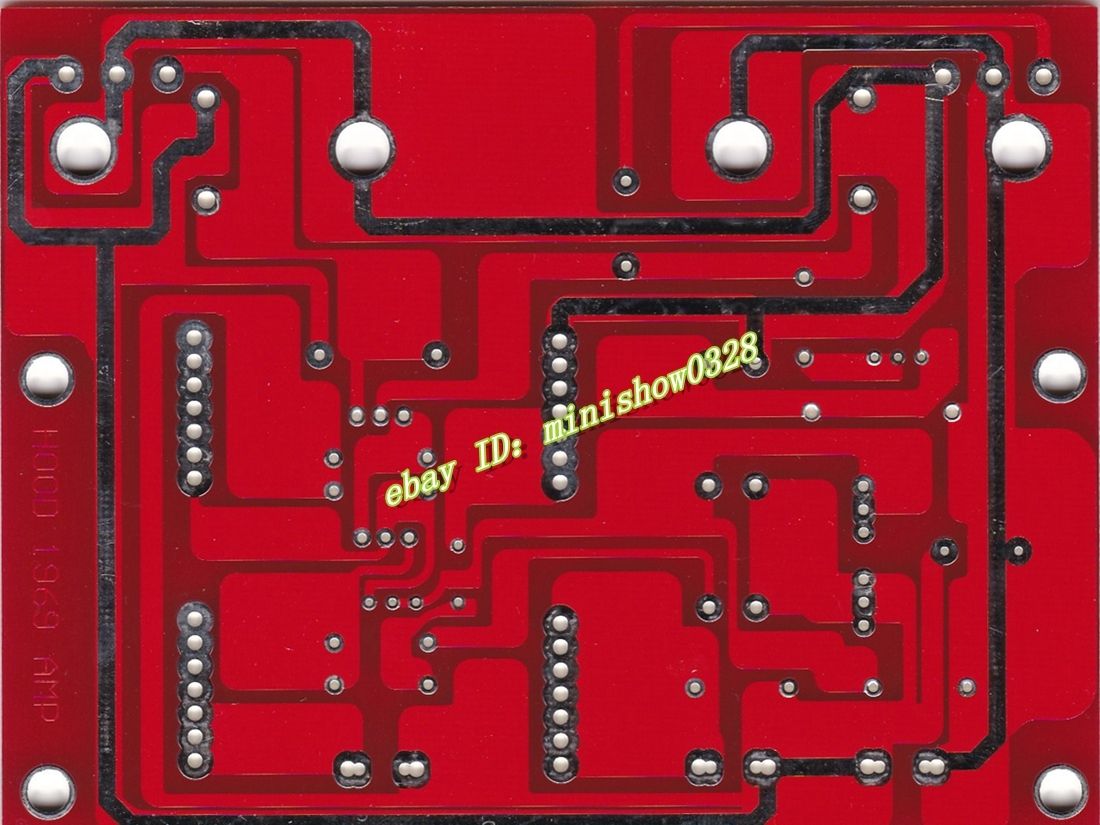

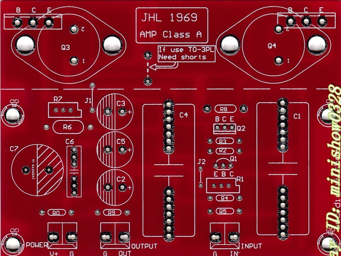

JLH 1969 class a PCBs
JLH seems a great way to get into low power Class A!
And the simplicity (single ended, one ps) and safety (output capacitor) of JLH 1969 Class A, s i m p l y begs for ... investigation.
Given that parts can be upgraded (and can fit in most PCB footprints); which of these PCB layouts is the most ideal / optimized (regardless of parts selection):
TIP41C-JLH1969 Single-Ended Class A Power Amplifier Board Panel Kit (2 Channel) | eBay
"TIP41C-JLH1969 Single-Ended Class A Power Amplifier Board Panel Kit (2 Channel)"
and another Zero Zone PCB for larger trans with good spacing:
still looking for an underside pic ...
or

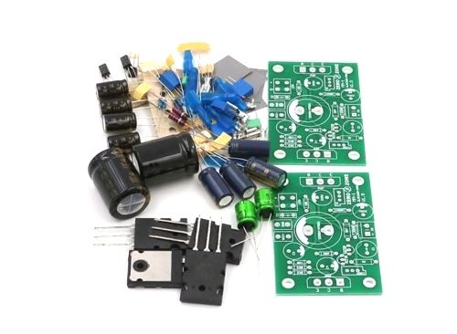

1 Pair JLH 1969 Two Channels Amplifier Kit Class A | eBay
"1 Pair JLH 1969 Two Channels Amplifier Kit Class A"
...slash
SC HOOD JLH 1969 10W+10W Class A amplifier kit | eBay
"SC HOOD JLH 1969 10W+10W Class A amplifier kit"
or

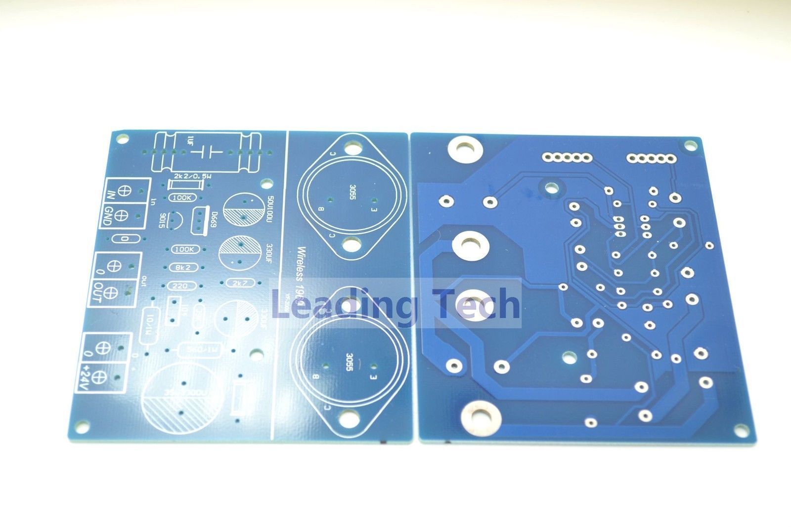

JLH 1969 class A Amplifier Board Left Channel PCB Assembled MOT/2N3055 10-15W | eBay
"JLH 1969 class A Amplifier Board Left Channel PCB Assembled MOT/2N3055 10-15W"
Please add any others PCBs that are easy to get.
What thinks you ... with justification.
Thanks,
Jeff

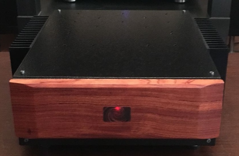

I love that timber front. Is there a rectangular window in it? Or is it perhaps a reflective badge and the red light is in front of the amp?
eLarson;
"I love that timber front. Is there a rectangular window in it? Or is it perhaps a reflective badge and the red light is in front of the amp?"
Thank you.It has a round window because it is my old tube preamp case so there is a hole for volume pot. I stick rectangular semi-transparent film for good appearance.

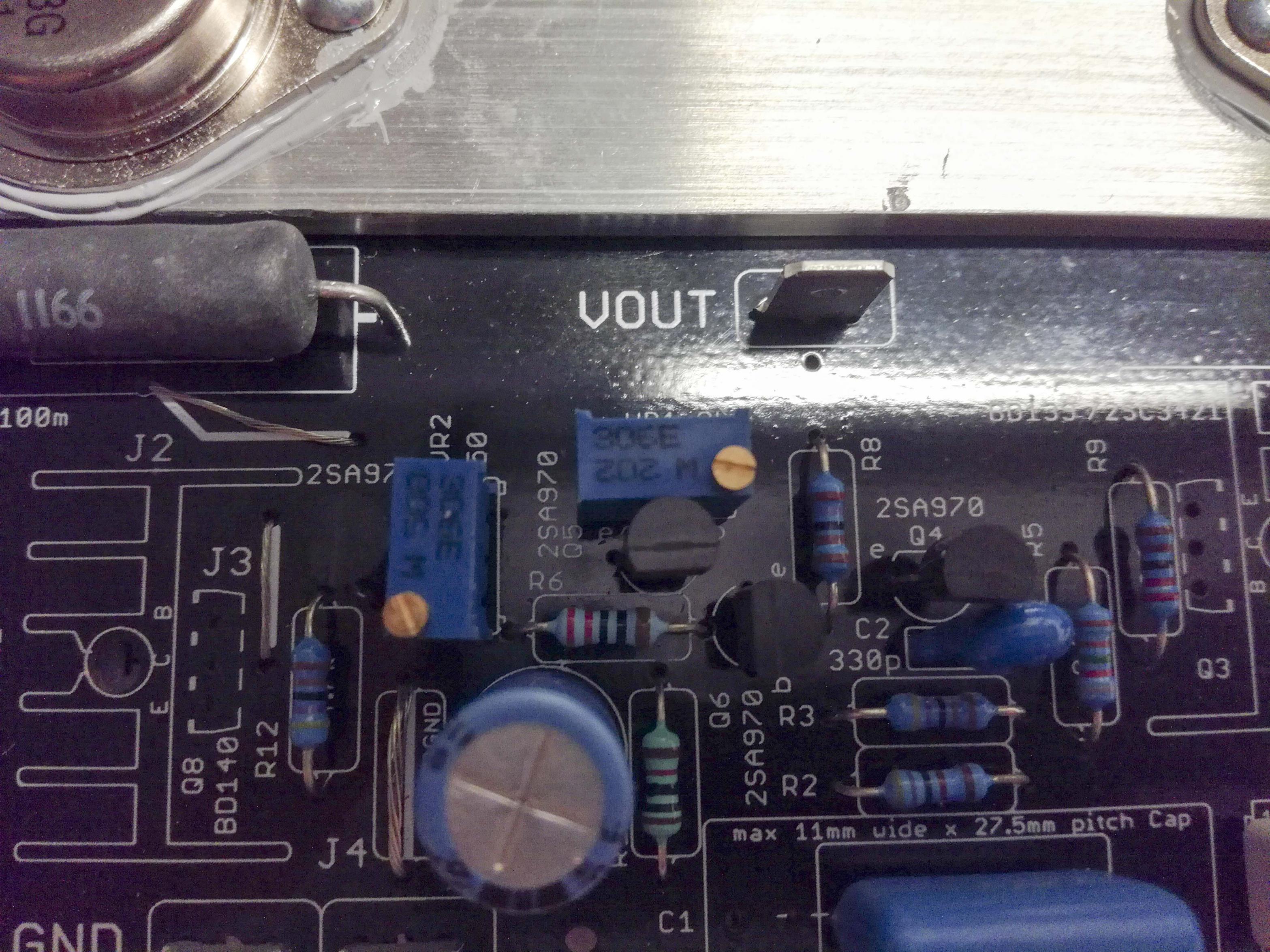

Here are the final files, PDFs , Gerber's and stuffing guides for this amp.
Hello Gabor, Thimios, potepuh,
There is a slight mistake on the device pin out for the 2SA970.
I have used bce device whereas 2SA970 is a ecb device.
So installing the devices opposite to silk will work.
So please be careful whenever you build it. I have marked b and e of the devices on silk, so install your device accordingly.
I am so sorry for the silly mistake😱😱😱😱.
regards
Prasi
