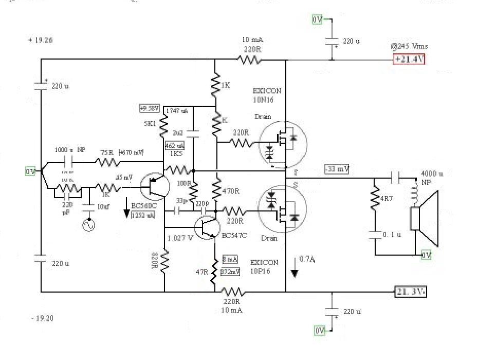

The circuit with MOS FET's was just over the last page.

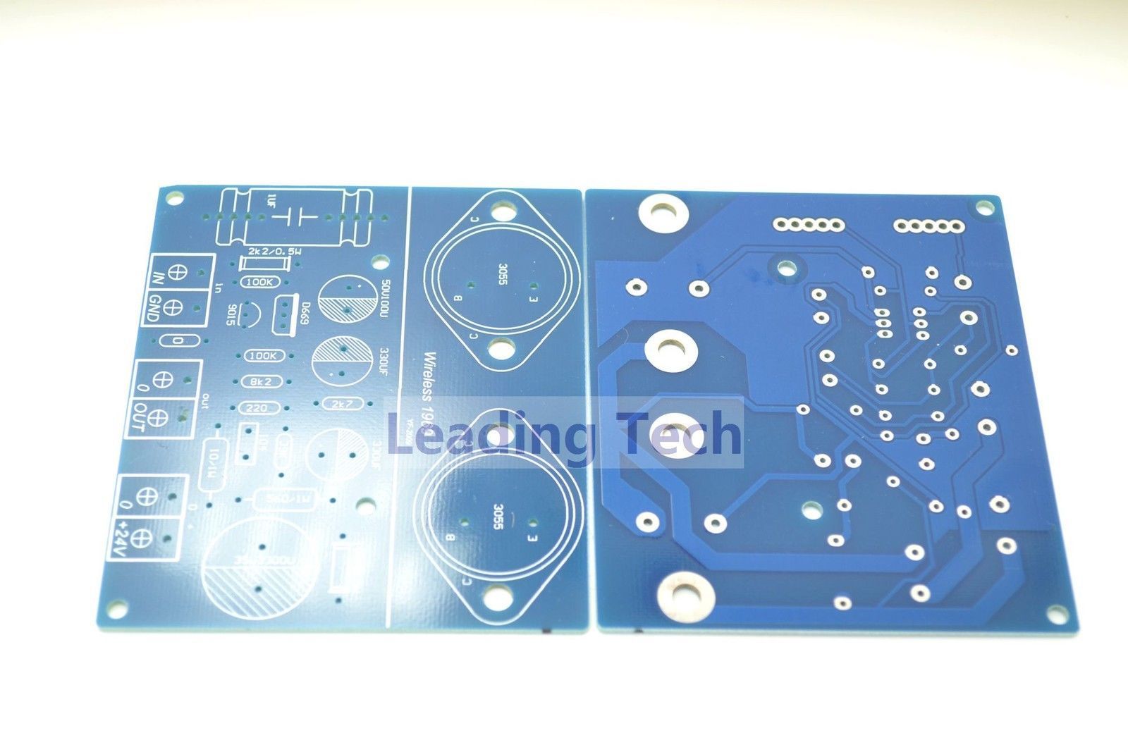

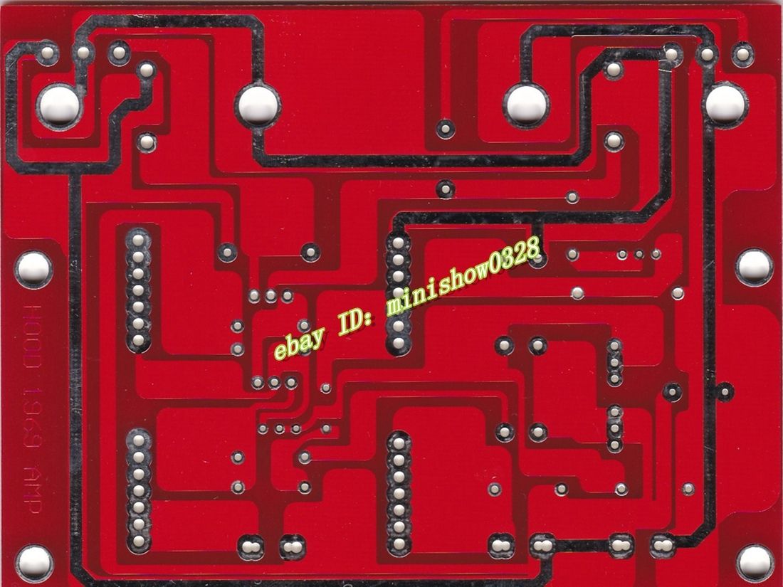

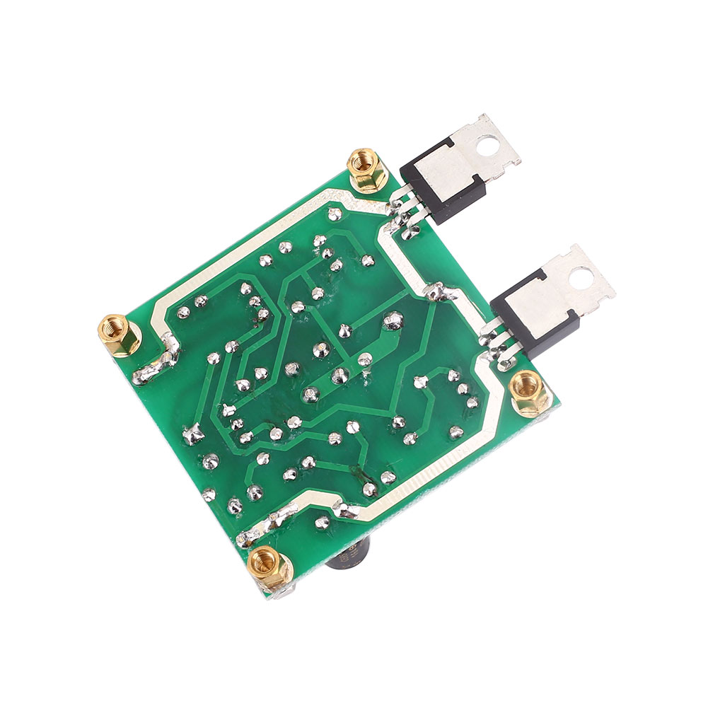

JLH seems a great way to get into low power Class A!
And the simplicity (single ended, one ps) and safety (output capacitor) of JLH 1969 Class A, s i m p l y begs for ... investigation.

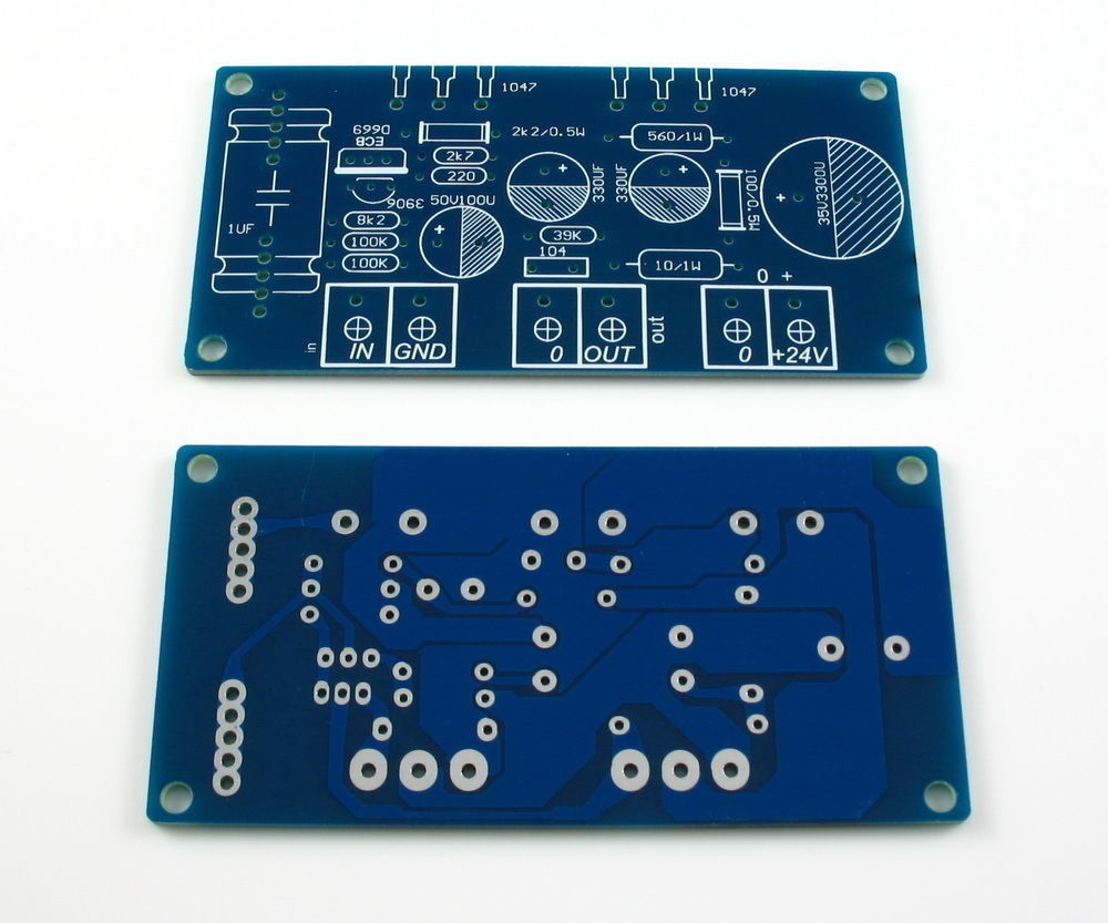

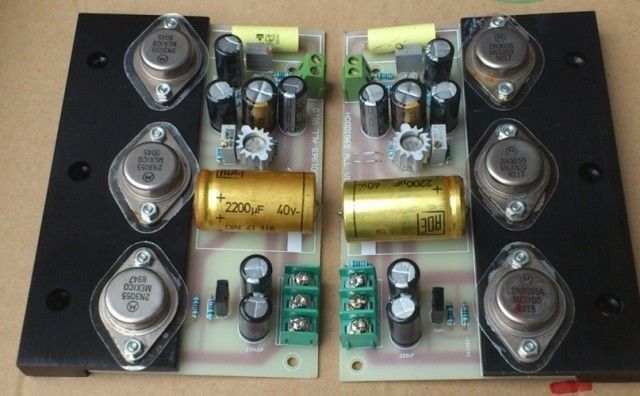

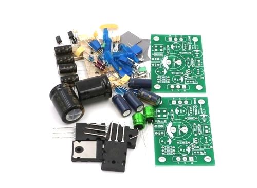

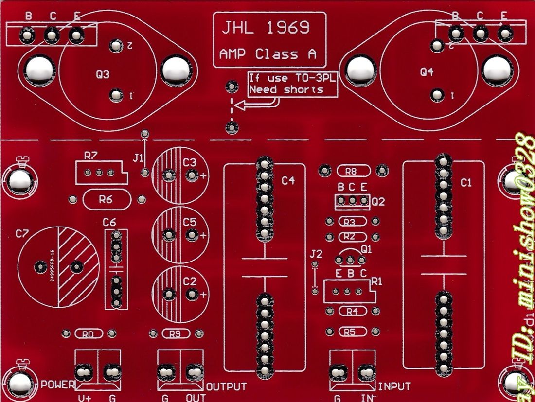

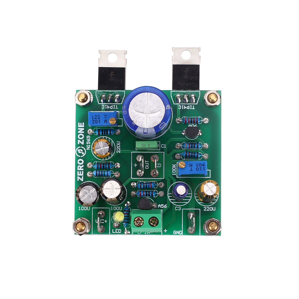

Given that parts can be upgraded (and can fit in most PCB footprints); which of these PCB layouts is the most ideal / optimized (regardless of parts selection):
TIP41C-JLH1969 Single-Ended Class A Power Amplifier Board Panel Kit (2 Channel) | eBay
"TIP41C-JLH1969 Single-Ended Class A Power Amplifier Board Panel Kit (2 Channel)"
and another Zero Zone PCB for larger trans with good spacing:
still looking for an underside pic ...

1 Pair JLH 1969 Two Channels Amplifier Kit Class A | eBay
"1 Pair JLH 1969 Two Channels Amplifier Kit Class A"

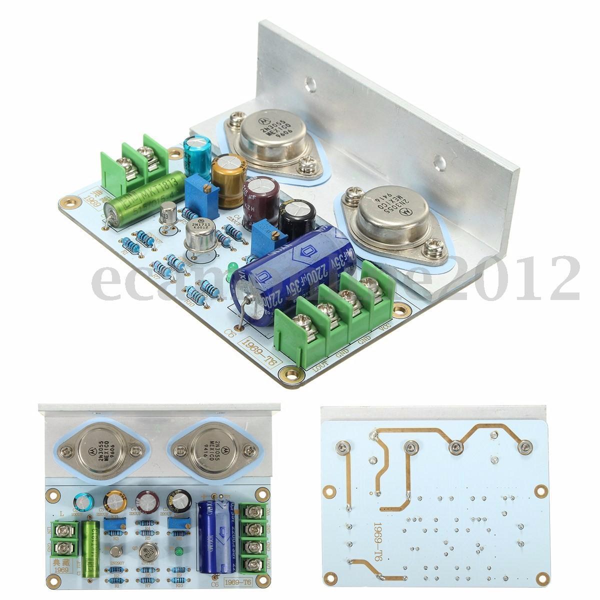

JLH 1969 class A Amplifier Board Left Channel PCB Assembled MOT/2N3055 10-15W | eBay
"JLH 1969 class A Amplifier Board Left Channel PCB Assembled MOT/2N3055 10-15W"
Please add any others PCBs that are easy to get.
What thinks you ... with justification.
Thanks,
Jeff

Anyone have any comments / preference on these PCB layouts?

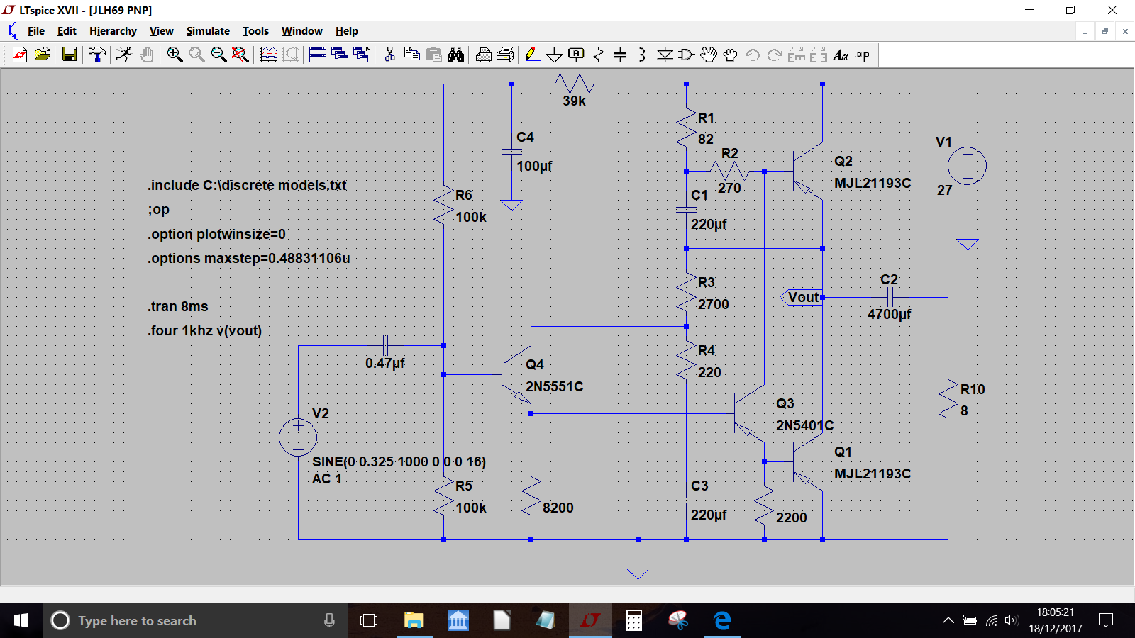

The main concerns (I won't call these "problems") I have with the original JLH is that the concept relies on base-current sharing. I give JLH credit for the circuit; it is a neat idea, but transistors at the time had such massive current gain non-linearities that the quiescent current had to be based on the value of base current needed to achieve peak output. JLH nearly, but did not quite manage, to give this as the reason the actual Iq needed to be higher than the "theoretical" value of half the peak. Simple illustration: if peak output is 2A and the gain in the OP transistors are 20, base current needed is 100mA. Since this comes from one transistor being turned off (almost) then the driver quiescent current will be 50mA. At say 1A, the gain of the OPT's might be 30, so instead of 1A you actually have 1.5A, or nearly, you get the idea. JLH I think realised this but did not make the explanation explicit.
A simulation using BD139 driver, 2N3715 OPT I get THD=0.3% at 20kHz, 10W. With BC337-40 it reduces to 0.2%. WIth MJL3821A output (AC's model) it falls to 0.05% (and the Iq reduces to nearer 1A; needs higher value load resistors in the driver/bootstrap stage) and one more "tuning" - the 220 ohm resistor in the feedback network limits the OLG by making the input stage gain 5mA/V. Using 100 ohms (and reduction in Rf to 1.2k) reduces the (simulated) distortion to 0.025%. Uses a 47pF compensation capacitor.
If you look at JLH's original article, most of the THD figures refer to 15 ohm loads. In fact, the OPT comparison he did with different gains never reached the target THD figure with 8 ohm loads. No surprise that the distortion is higher for 8 ohms as that pushed the current swing in the transistors up.
So it seems the new high speed transistors are preferable, but I am still wary of the high base capacitances, and think that needs a little more investigation.
Thanks,
Jeff
i like this one
and this one
http://www.diyaudio.com/forums/atta...525313t-jlh-10-watt-class-amplifier-l1600-jpg
for simplicity and high quality
this one
http://www.diyaudio.com/forums/atta...3524979t-jlh-10-watt-class-amplifier-l500-jpg
for small size pcb
and this one for pcb quality
SC HOOD JLH 1969 10W+10W Class A amplifier kit | eBay
I have them all assembled and all kept
Thanks everyone. Just the right tonic for winter. Be a bit careful of my 4046 design ( nichoch, thanks , add 1K to the VAS load as it seems to be missing if it's not my screen ). I had a familly crisis at the time so not really finished. I was starting to like it. The 470R between FET's is ball park value for that batch. The 47R resistor to the BC547 emitter can be tuned ( 16R might be good, 47R softer, 0R more punch ). Be very sure DC offset is stable before risking speakers. I used 4 x 1000uF non polar for safety. The way I do the DC adjustment it is not my best design moment. All the same better has greater risks. One way to do that is use a long tail pair input and use the Naim trick. That is to use different resistors on the collectors that force the second harmonic distortion to be like a single input transistor. If you feed the signal into the feedback arm you might well win all your design goals. DC offset would be low.
