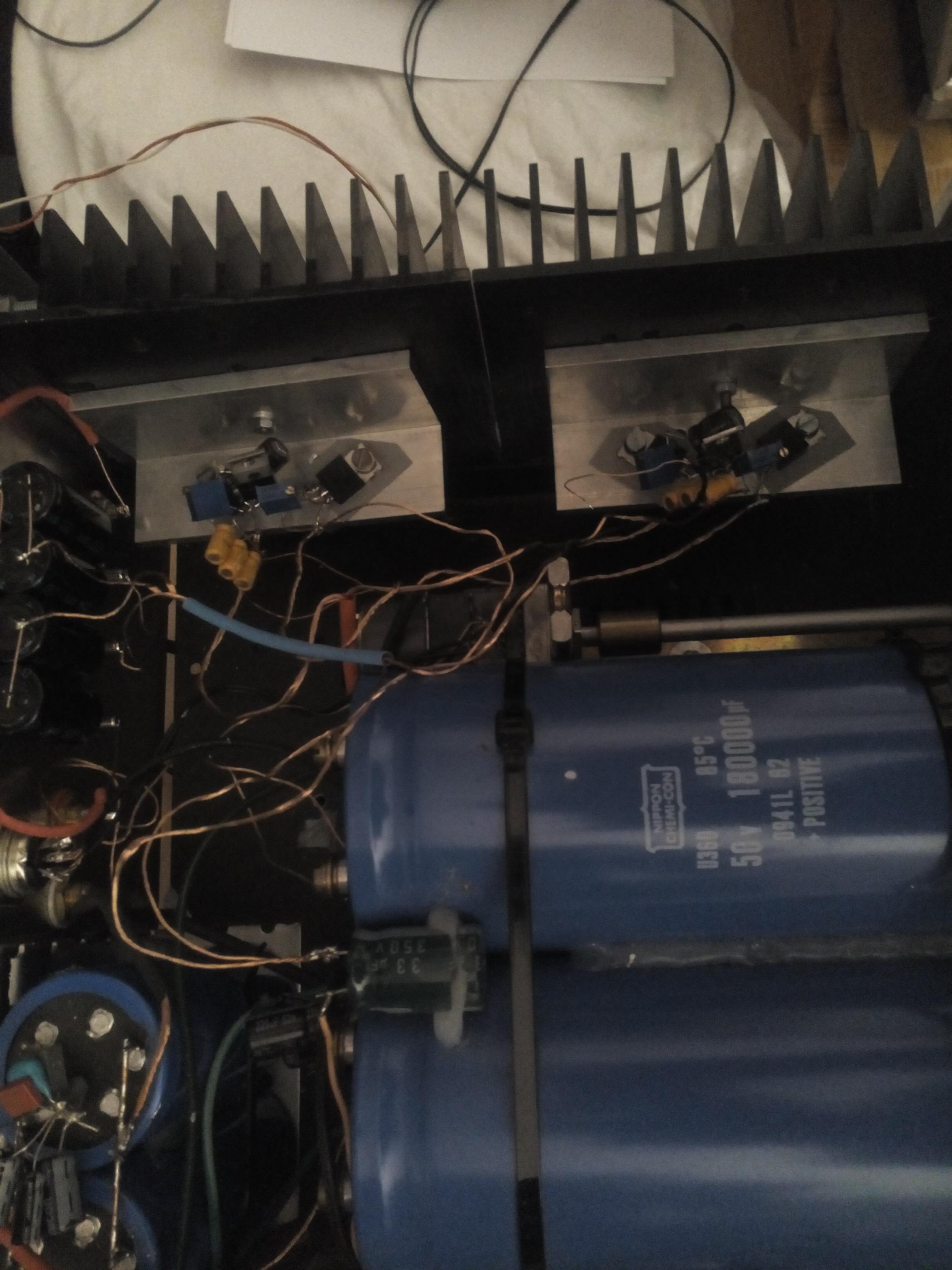

Update on BC327/337/2N3055. No 4100. It is remarkably stable both AC and DC wise. The PSU I'm using is reasonably good so gives noise at -102 dBV ( It should be far better as LM723 is used which could give -112dB ref below 1Vrms ) and hum at -83 dBV at 1.2 amps. Hiss is only -90 dBV as I have no preamp to shunt it yet. The input impedance circa 55K. Most interesting is the switch on surge is only 1.7A ( 1.2A after 1 minute ) and seems mostly related to DC points as hot or cold it's the same. I speculate the PNP and NPN devices are doing more than we think.
You may wonder why I use very low grade 2N3055 and BC327/337-40. Reading JLH it seems to be he is saying it will best that way. If so these devices are available and highly unlikely to be fakes. It is very hard to fake a ultra high gain device. I strongly doubt my 2N3055 are really 2N3055. I suspect they are any OK device in a TO3 case. They seem to have very nice gain. I would think they are > 1MHz. Indications are more like a 2N3055H.
To get perfect balance needs 100K upper and 120K lower DC setting resistors ( perfectly with the maths ). This will vary with device and grade. My BC327/337 show> 400 on cheap hfe tester.
My shed had show last night and was at only 5C. The house at 17C and rising. DC mid point virtually identical shed or house. For a class A amp that's rather good. I wonder if JLH went into enough detail over the maths, I think he did many calculations to get to the ideal design. It looks to me this design is far more sophisticated than it seems. I wonder if the Folk Law of the current setting being very dependant on all things being right is in fact the truth in action. If the heat sink is too small it will be trouble. For me it has been rock solid. My heat sink at a guess is 0.25C/W. I have two so might not change anything. If you do the maths what do you gain to double the watts? 10 times is where it starts to matter. Even then it's the PSU one is forced to have that helps.
I have some doubts I am too lazy to check. Some say the open loop gain is 60 dB. That implies circa 35 dB to control distortion. Seeing how hard the BC337( 2N697 ) works it seems unlikely. Open loop without the 2N3055's perhaps.
I now have a big problem. I can't find my test gear. I do have a digital device which is terrible although great for power tests. What I might do is build a multipole filter at 1 kHz and 10 kHz. Sometimes these are not as good as they should be. I need 0.0003% THD to know. A NE5532 might be OK. One way I can do it is the 1820 method ( Fourier ). That is to look at in and out and say what has changed. Even so it needs to be lower distortion than what I have to hand. I do have a RA53 thermistor which sweet spots with 680R. If I build a sine cosine two stage Wien Bridge I should be somewhere near my target, I hope to have a bit of common mode distortion nullling . Output at 1V rms should be fine. 2 x PP3 batteries to help hum levels. BTW. A small lamp can be made to work in a Wien. Even ones with very low initial resistance. Christmas tree lamps can work. It needs to be the opposite way to the long obsolete RA53 in feedback arm as it has the opposite resistance current responce.

I built one of these amps using the Siliconray boards some years ago which hasn't been used. I recently ran it for a few days and had problems with the L channel blowing the pcb fuse. Having checked it over it seems that I can't now get the dc offset down and my light bulb tester is glowing brightly when the L channel only is connected (dual mono double psu design)
I Built the board using TIP3055 transistors. My electronics knowledge has increased a little since I built that amp and I have a few questions I wonder if anyone can answer.
I used the TIP 3055's in both positions on the board, but now wonder whether they should both be the same or whether one of them should have been a P channel 2955. I am probably going to replace all the output transistors on both boards and wondered which ones would be favourite for the board's interpretation of the JLH amp.

no.
all output transistor are N
this amp is hard to adjust and stabilize.
first, check BD 139/140 and avoid high gain.
I took mine a long time ago because it worked less than my 69 or 96 but he never blown a fuse
