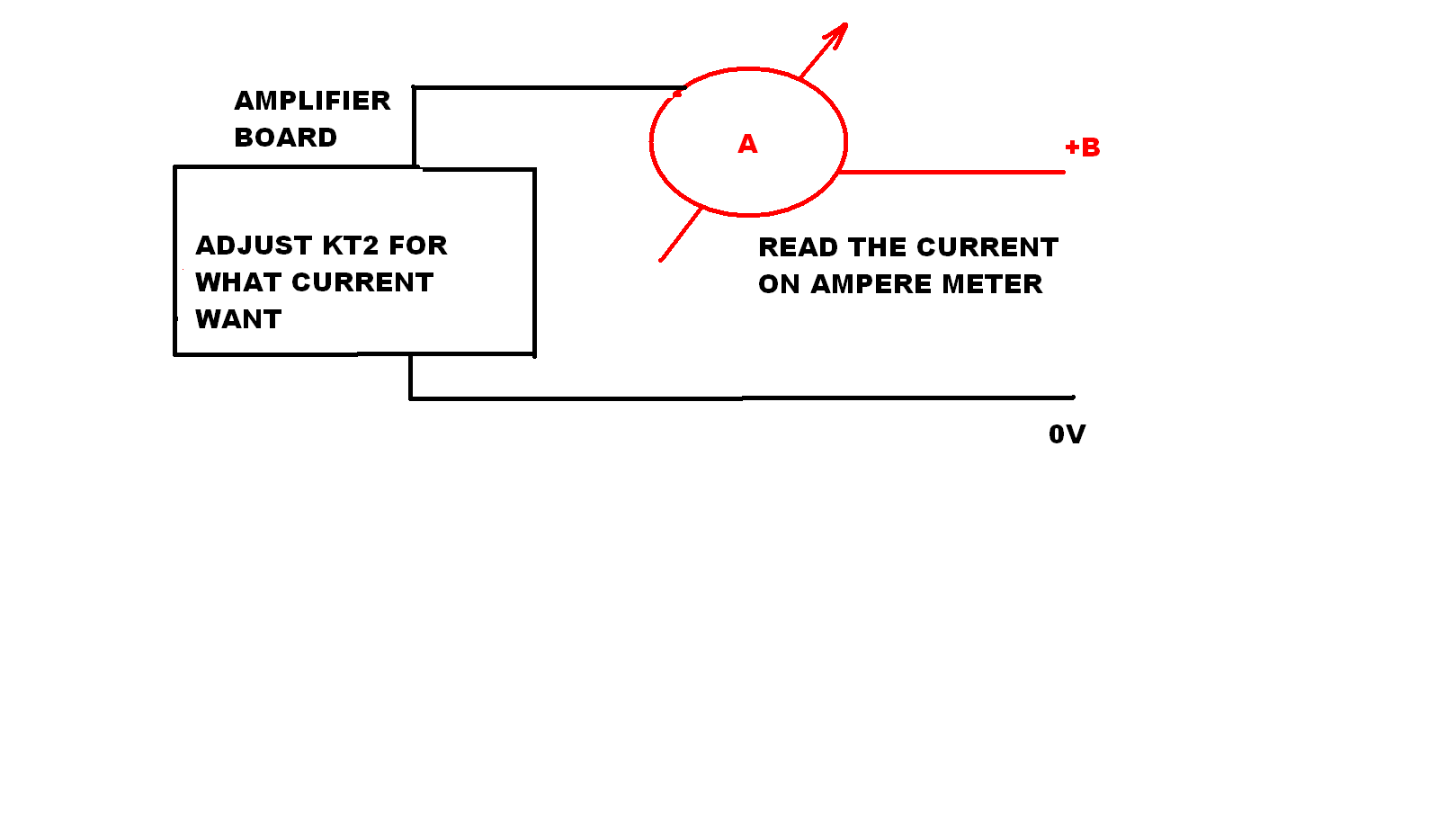

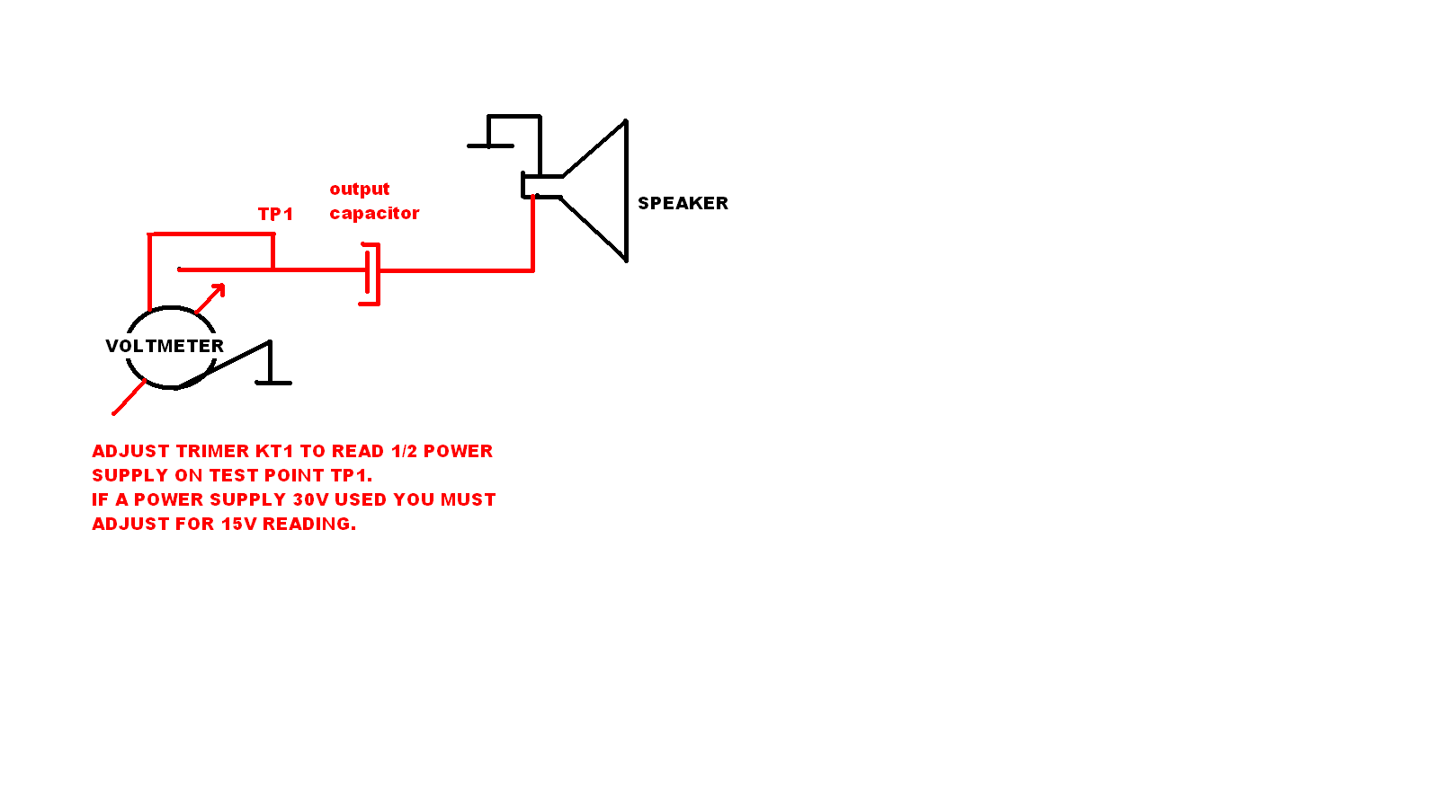

yes !I hope this will be useful
in first,adjust the mid point of the supply
in 2nd,ajust the quiescent current with ampermeter to 1.2A (with no signal input)
re-ajust the mid point of the supply
and re control the quiescent current after one hour
