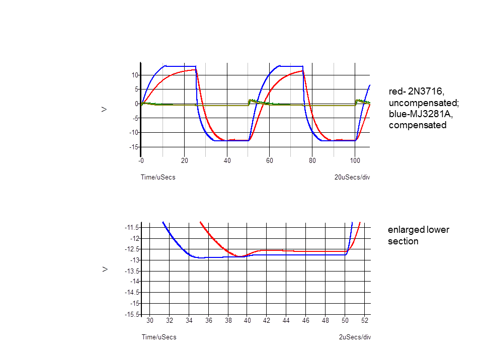

Here are some simulation pictures.
Paraphrasing Doug Self it is probably cruel to subject a JLH10-watter to a 20kHz square wave with a 1 uF load (in parallel withh 8 ohms).
The "original" circuit (2N3716 output) shows a high degree of asymmetry. On the rising edge, the slew rate is limited by the bootstrapped 3716. It does not even reach the peak output voltage in the half-period. On the falling edge, the response is quicker (hence my earlier point that a driver in front of the output device can help).
The 3281a output stage is faster - the peaks are reached within 10us, but the rising edge is still limited by the output's own bootstrap pull-up.
Looking at the second image the negative output signal shows a "transient" overshoot on both but the effect is worse on the 3716 variant.
I have a concern that a good transient performance could be worse if an additional RC network is added since this makes a 4 ohm load (or thereabouts) whereas the JLH amplifier is current limited (to the standing current), unlike a class AB amp.
The other point to note is that the central traces plot the emitter-base voltage of the input transistor. Clearly during the rising edge of the output the transistor is completely cut off. This is in fact the origin of Otala's "transient intermodulation distortion". It affects both amplifier variants but the 3821A model recovers more quickly. Whether real life signals cause this or not is an open question that I have not seen fully addressed. The moral of this story is don't use capacitor speakers!
If a good transient response is needed for 20kHz (and probably isn't) into a capacitive load the standing current would have to be in the order of 20A.
I re-read JLH's original article and the only square wave signal published that I saw was the 50 kHz resistive load. There is a very slight overshoot in the 3821A variant but this does reduce with a slightly larger compensation capacitor (e.g. 47pF). I would still recommend 33pF as this seemed to be the smallest my actual amplifiers were happy with.
John

Interesting points John.
Hood's article was written at a time when the memory of the valve era was comparatively recent and there were two valve amplifiers - the Williamson and the Quad 2 - among the group of amplifiers auditioned by his listening group.
That would possibly account for his inclusion of a 50 KHz square wave test - he did this also for his Class AB amplifier published in Wireless World in 1970. It wasn't used for his later designs.
With regard to square wave testing, 10kHz is sufficient since the rise time of a step wave form is so brief that there is no point in going to 20kHz even with higher powered amplifiers.
Hood subjected his later and more powerful designs to more severe tests with 8 ohm//2uF as his standard.
Low power amplifiers put less voltage and current into a speaker load and in theory the reactivity element should not be so great.
Music signals have lower magnitude above 10 kHz, so all-in-all a 1uF capacitor may suffice instead of 2uF.
I have simulated this amplifier and seen how the square wave can morph into a half banana shape.
The amplifier cannot increase the current delivery with increasing signal input so that this will happen is inevitable at some point. Increasing the output current mitigates to some extent.
I have cranked this up to a little over 900 m.a. with some radical changes to the bootstrap resistor values.
I would be much more comfortable if the heat factor on the devices causes the output current to increase. It would be interesting to receive some feedback from builders on this question.
In Hood's words - the optimum performance of the output stage is given when the current swing does not take either output transistor into current cut -off.
For 10 watts into 8R he specified 1.2A - to get to that level the improved current control published in Wireless World in December 1970 may be necessary for low current gain output transistors. This modification does work - I know this having built the 1996 version of the amplifier which which uses this in combination with 2N3055 outputs.

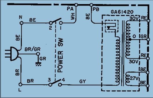

The AC power input terminal has no markings on it so I don’t know what wires I am attaching to which screw…
And here is a diagram of the transformer I am using attached below
Can I use the 27V secondaries in the diagram?
I am used to SMPS and basic class D modules, so excuse my ignorance
Playing at low power is the worst possible state for a Class A amp. The more power you pump into the load, the less is dissipated by the amp.
A 27 volt transformer (make sure it is rated sufficiently) will give over 35 volts DC under heavy current draw as here. That is OK as long as:

Re adequately rated can you post a photo with some reference to size - like a ruler. If you have accurate kitchen scales you could also weigh it.
I suspect the 27 volt winding serves a low power auxilliary purpose to the other winding pair - the diagram looks old.
One thing you could do is measure the resistance in each winding. It the 27 volt one measures the highest it will be a no goer.
It mentions 350VA and 400W (for Australia), so it's likely that you have >300VA
The centre tapped secondary is 300VA/60Vac = ~5Aac
You can't take a full VA from just one half of the centre tapped winding.
Can you access the centre tap?
Is it possible to separate the two wires that form the centre tap?
If so, then you can separate and parallel the two half windings. This way you get the full VA for the paralleled winding.
I would not use this transformer as a permanent installation.
However for a temporary test the centre tap can be a ground with the positive tab of the supply cap connecting to this - with each 30 volt a.c. winding connected to the positive (banded end) of a rectifier diode with the opposite diode ends joined at the capacitor negative tab. (I am assuming a negative rail set up)
You would need a suitable value resistor to reduce the current draw and the appropriate to reduce the voltage of the supply - this in series with the individual module under test.
The two diode rectifier scheme reduces the supply efficiency by 50 %. Don't try running two modules at the same time.
