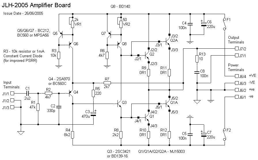

I bought a pair of bare pcbs from an Ebay seller a few years ago.
They were the high power design with two pairs of output transistors. Probably a copy from the schematic above.
Be worth a look?
I got a PM asking for these and found I couldn't add attachments to my reply. So here are the files. The Gerbers are in the Fabrication-Files folder. Be sure to read the readme file there and the other readme file in the main folder.I have information from Geoff including PCB fab files and a suggested bias adjustment procedure for any that are interested. I built this version and have enjoyed it immensely.

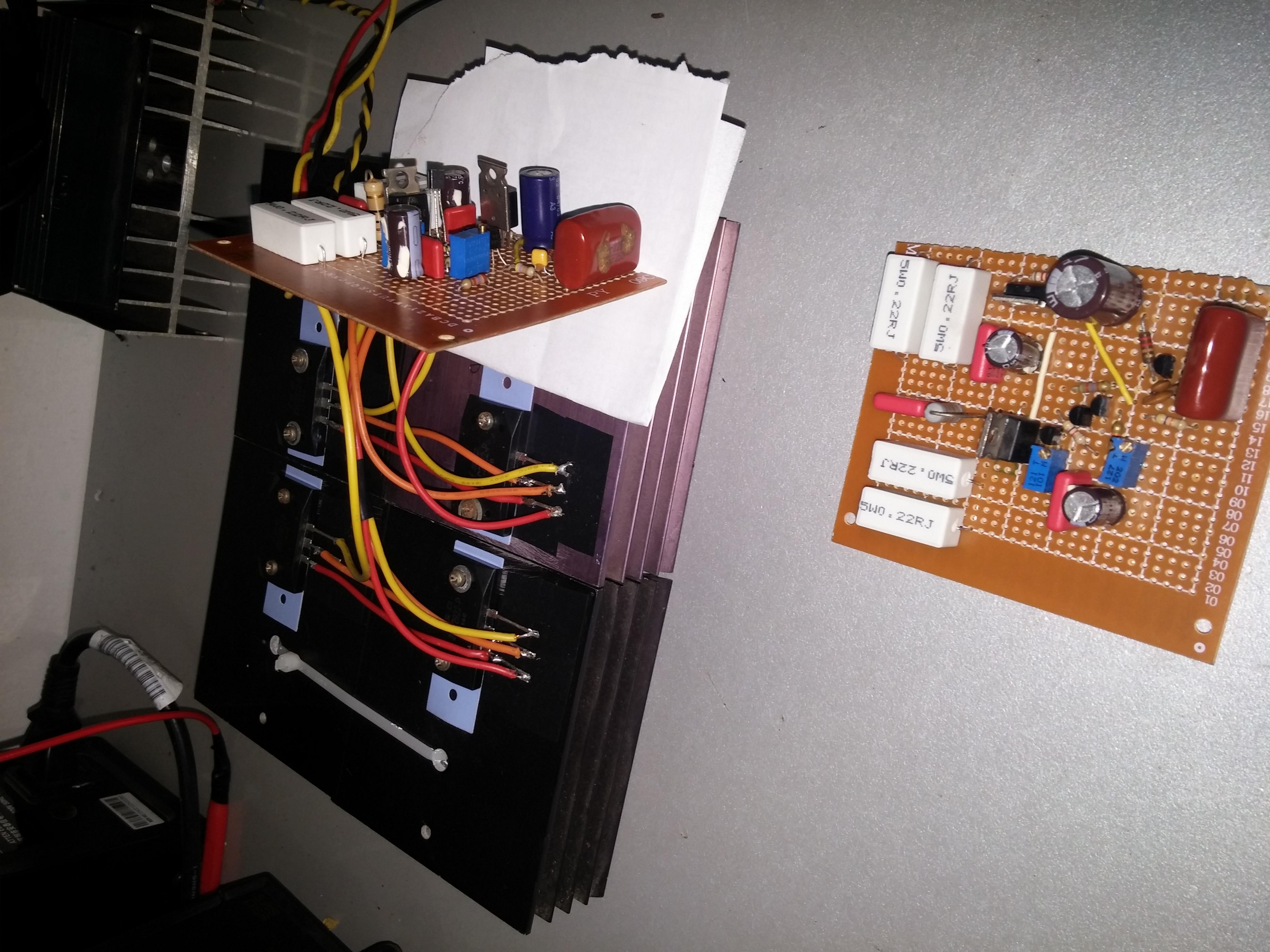

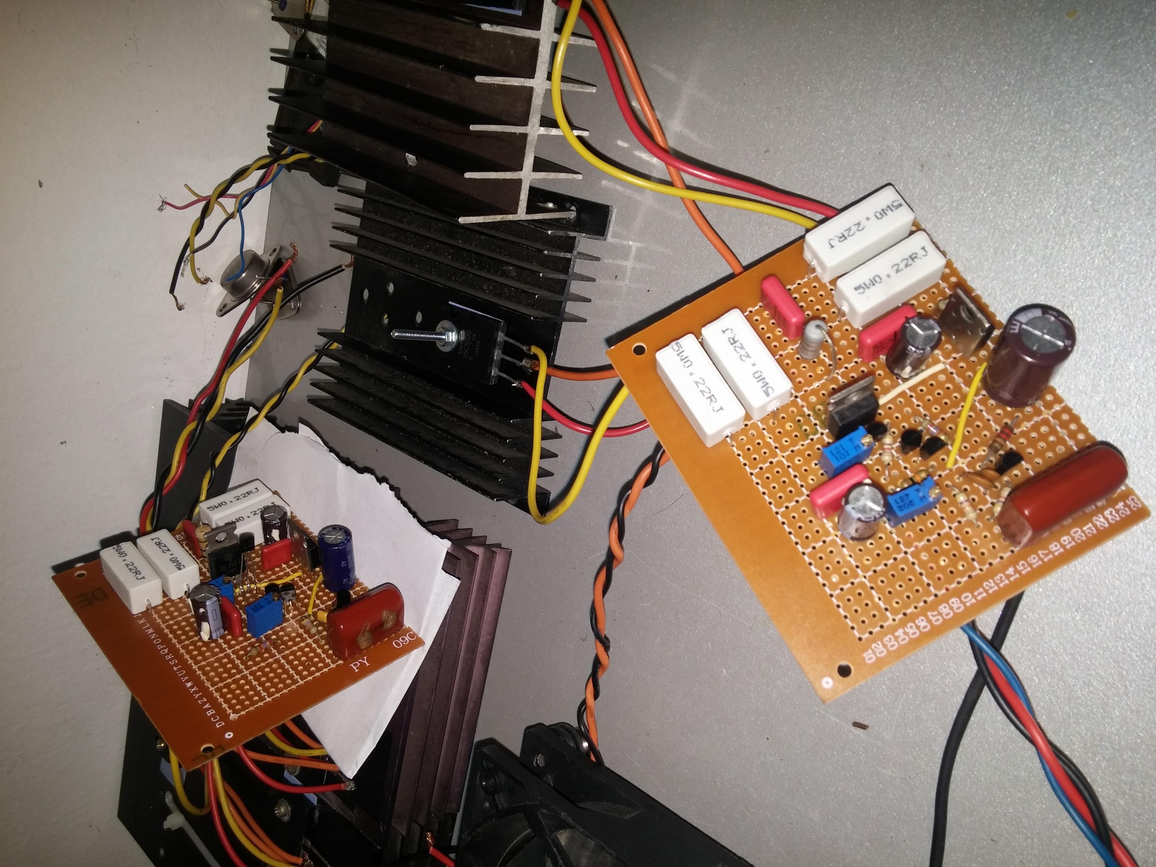

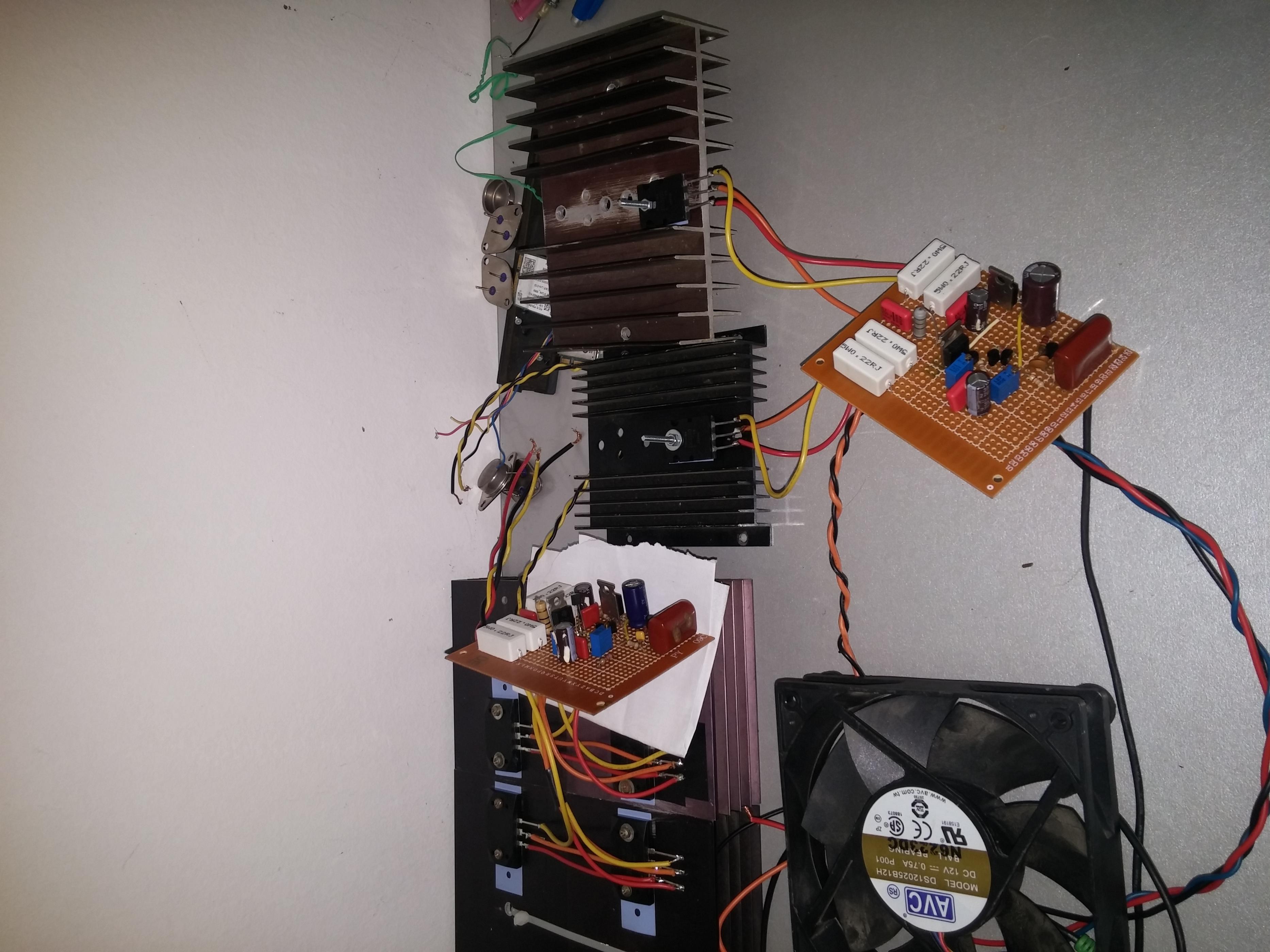

I finished both channels of my JLH 2005 and tests went well, even tried one channel with 2sc5200 (one pair only) and sound is not good as with isc 2sc2922 (2 pairs). I guess that's because they are cheap copies from ebay 🙂. Now I need to find some nice heatsinks and make some housing for this jewel.
Some pics:
(I hope I can do test in stereo tonight)

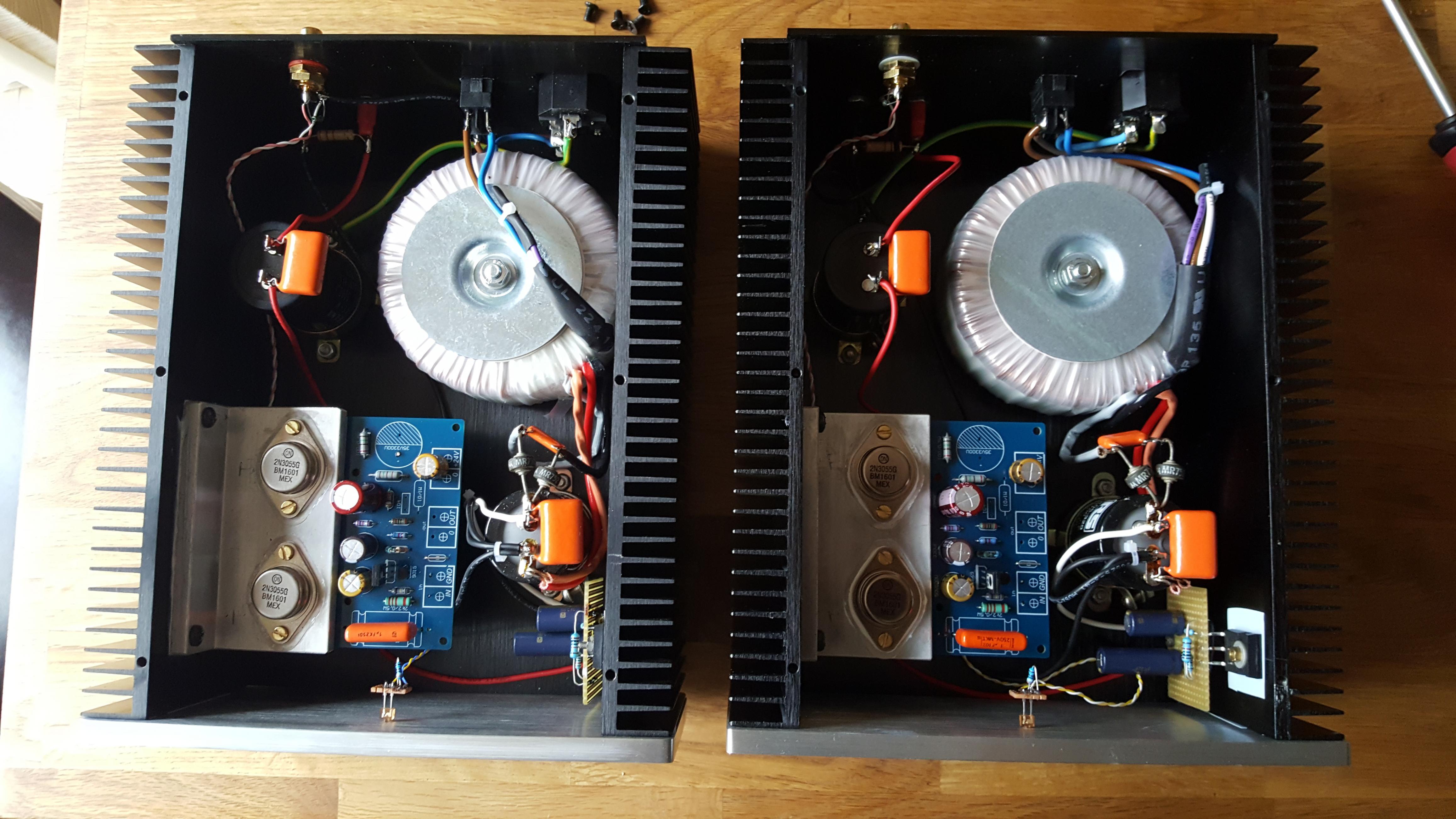

Nice setup, JLH 1969 has sweet sound indeed. I'm waiting mj15003g from Farnell to replace 3055's - can't wait to hear the difference.
(Are those 3055's originals or China fakes?)
Just finished my JLH1969 with Mosfet capacitance multiplier. Chassis and PCB from China and all other components from my old stock and also from Farmell, UK. Indeed very sweet sound.
