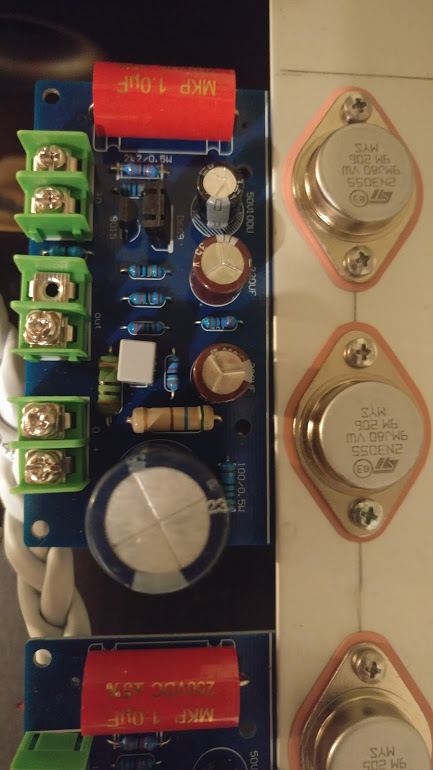

Whoa, John, this was reading scientifically already:)
You were asking which Chinese amps I have, it's these:
Well, peroz, that is an interesting picture. The output transistors appear to be genuine ST 2N3055's and fairly recent (2009?). These are NOT the old slow devices but will have a high frequency response of around 3MHz. I have built one of my better class AB 50W amplifiers using the same device and PNP complement. I measured a low frequency gain fall-off on my samples at 60kHz, which basically means that the gain starts to reduce well above the audio band.
I think that your JLH design with these will not sound too bad at all. I suspect that many people who compare MJ21194's with 2N3055's are comparing the old slow 3055 types which have not been made as such for perhaps 20 years now, but may have been used in several JLH amplifiers maybe when the MJ21194 devices appeared and would have made a big difference. However, you could try MJ21194's as they will have lower distortion due to a better gain linearity than the 3055, even though the gain will be around the same as the 3055.

These are genuine transistors. Because I destroyed the ones that came with the kit with clumsy mounting... These new ones costed more than the complete kit. :D
I'm glad I apparently don't necessarily need to change the transistors. Are there any other passive components that are worth changing to top quality? Some people here write about input caps... how would I go about that?

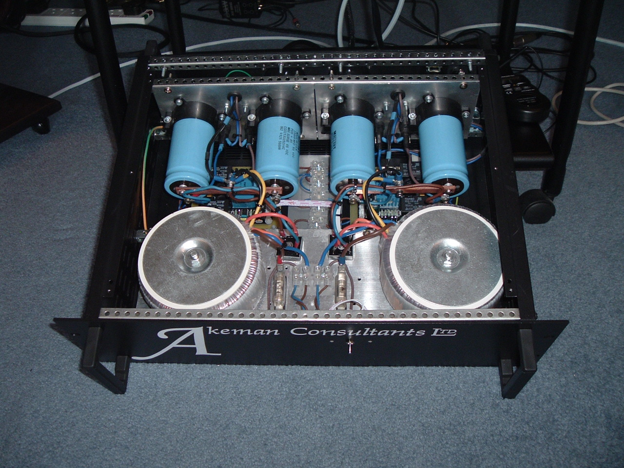

JLH Class A amp - bits and bobs

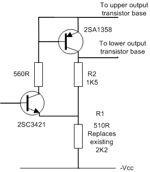

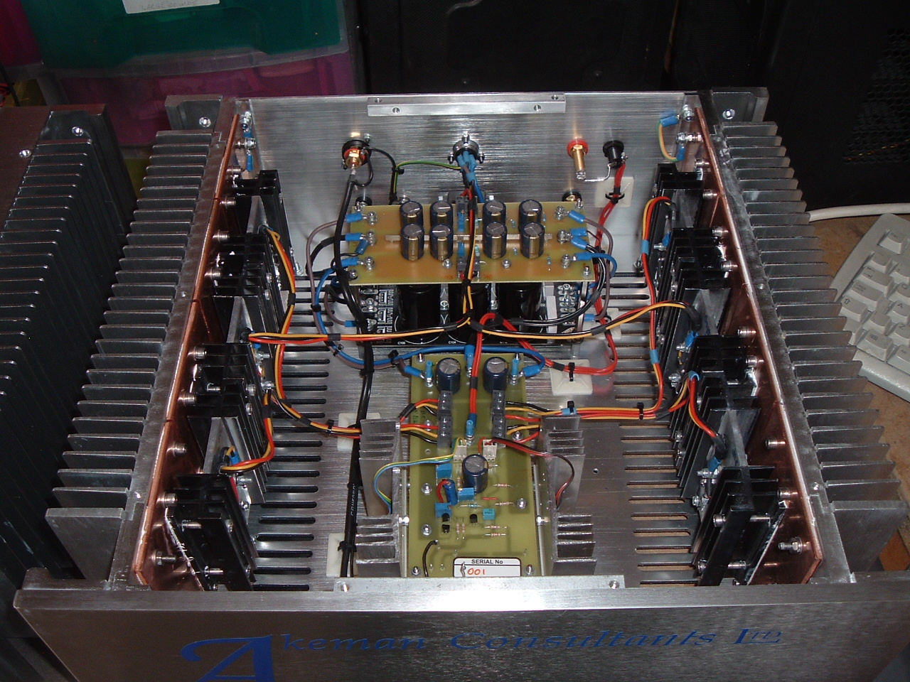

Hi All,
Having built various version of the JLH Class A amp, I thought I would contribute to the knowledge pool on this with a few suggestions that I am writing up later in a complete article.
I have experimented with the several variations of the amp and find the Geoff Moss version to be the most pleasant to my ears and the certainly the most builder friendly.
I use the high-power version that employs 4, MJ15003 transistors in the output stage and built 2 mono-blocs with independent power supplies in a separate case and connected by an umbilical cable to the amp chassis that also contains further smoothing and a capacitance multiplier.
There are a couple of modifications I have tried that can be retrofitted to the Geoff Moss version that can reduce the distortion quite radically to a point where the 2nd harmonic component is down at around 0.0035%. I can't measure the 3rd harmonic value as it is below the capability of my measuring test gear so I assume it is down in the noise somewhere.
The modification is around the Voltage Amp stage: changing that to a simple Sziklai pair with unity gain, drops the distortion down from 0.09% to 0.03%, which is quite good, however it starts to rise a bit at about 20KHz to about 0.07%
Changing the S-Pair to provide a bit of gain as in the attached diagram, then drops the distortion down and order of magnitude to about 0.0035%, again rising back up to about 0.06% at 20KHz or so. Use high Hfe devices if you can.
I have found the modification does not need any compensation and on my pcb layout is unconditionally stable with a minute overshoot on a 10KHz square wave. I did have a few problems when experimenting on my original PCB that had the mods on a small daughter board, but a 10pF from base to collector of the NPN solved that as did a new pcb layout without the 10pF cap to include the S-pair.
Kind regards
Mike

Joined 2010
Impressive size and build! - way beyond the constraints of the original design and with such low distortion, it won't be sounding much like the venerable Williamson tube amp.
When you say it's more builder-friendly, what aspects are you considering - parts availability, size, ease of access etc? It sure won't have been easy on the wallet.

Congratulations for this superb amp!
Is it JLH 2005 ?
Hi folks,
thanks for the kind words. I really do like the supportive nature of this forum. :)
It is based on the updated Geoff Moss version using transistor current sources for the Iq and Voffset adjustments and is pleasant to my ears: the amp seems to grab the speakers by the scruff of the neck and control them, particularly at the bottom end. The opening track of John Williams Jurassic Park on vinyl is something to die for. The brass and bass are just unbelievable clear and precise.
Is is build friendly in that if you use 22 turn pots for the adjustments and take your time (Also a current limited power supply during testing), it always seem to work first time. It's also simple in design and I have a pet theory that the smaller the number of amplifying stages, the better it is.
It wasn't too expensive to build. The main cost was the two Chinese cases and the transformers, but I did enjoy building it.
Best regards and happy listening
